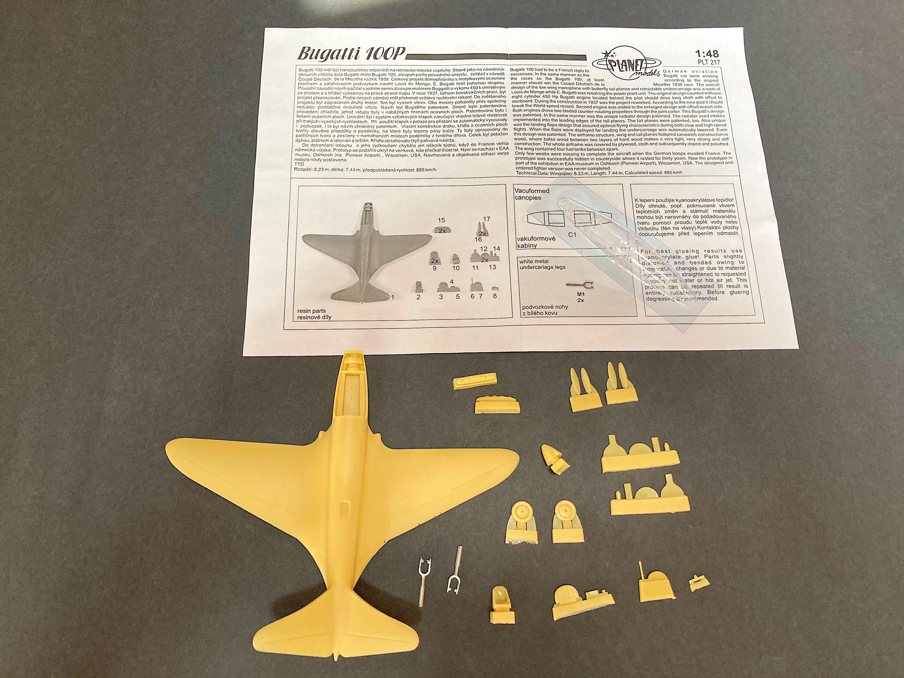

Planet Models 1:48 of the one-off racer airplane Bugatti 100P, I found at the IPMS Nationals in CO.  I haven't done a thing for a couple months, wanted to call today a vacation, and build something quick.  It's a brick, the two engines would have been fun.  No seams or gaps like the typical airplane model.   No decals, so I might finish it.  But then again, I just can't build box stock anymore.
Flickr: Stu Carr

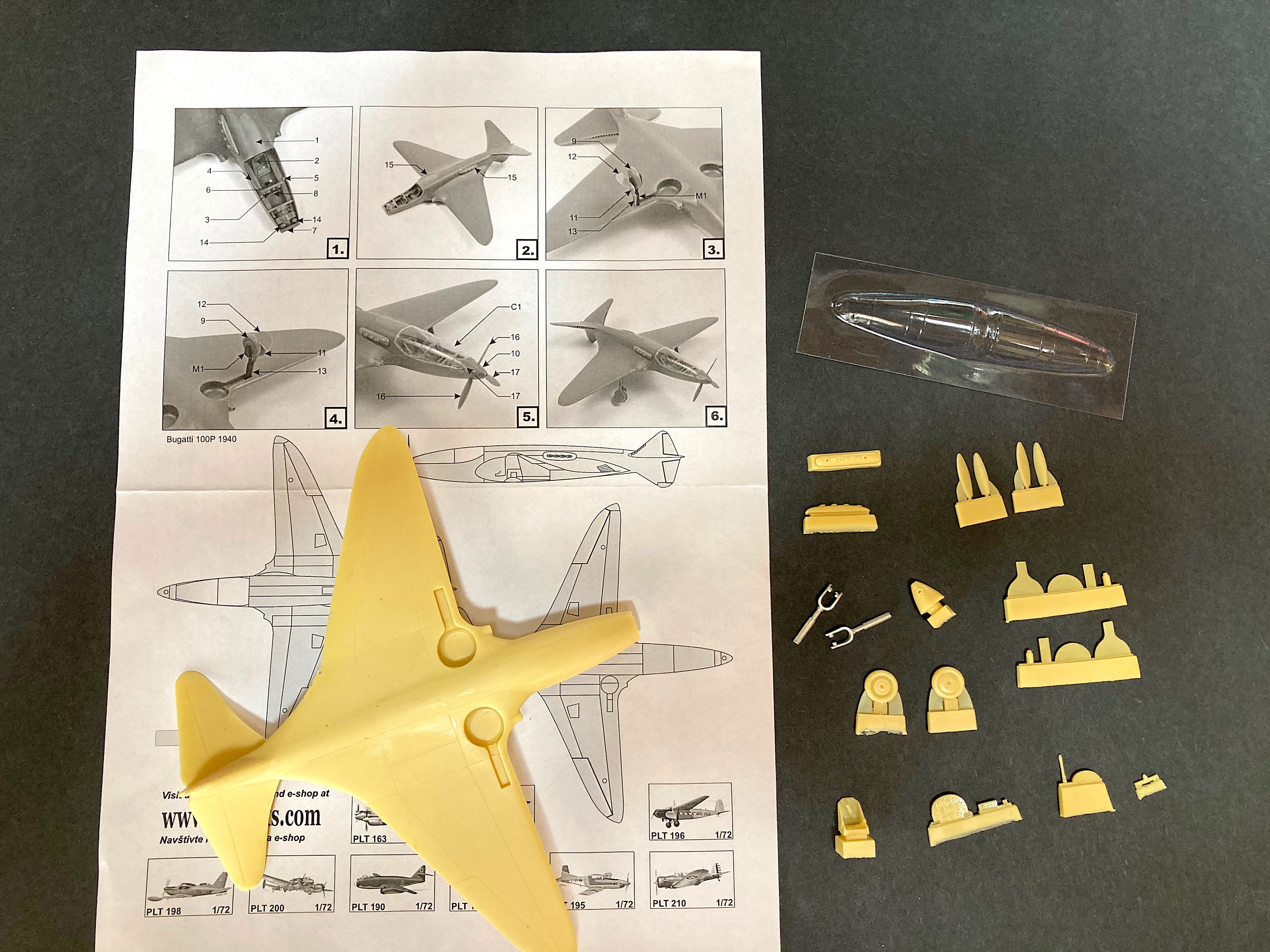

Not many parts.  The vacuum-formed canopy is duplicated, so that was nice of them.  The instructions have only blue and black for color references, but the box art is color, so I needed to figure out the interior which appears red, wheel wells must be light blue.

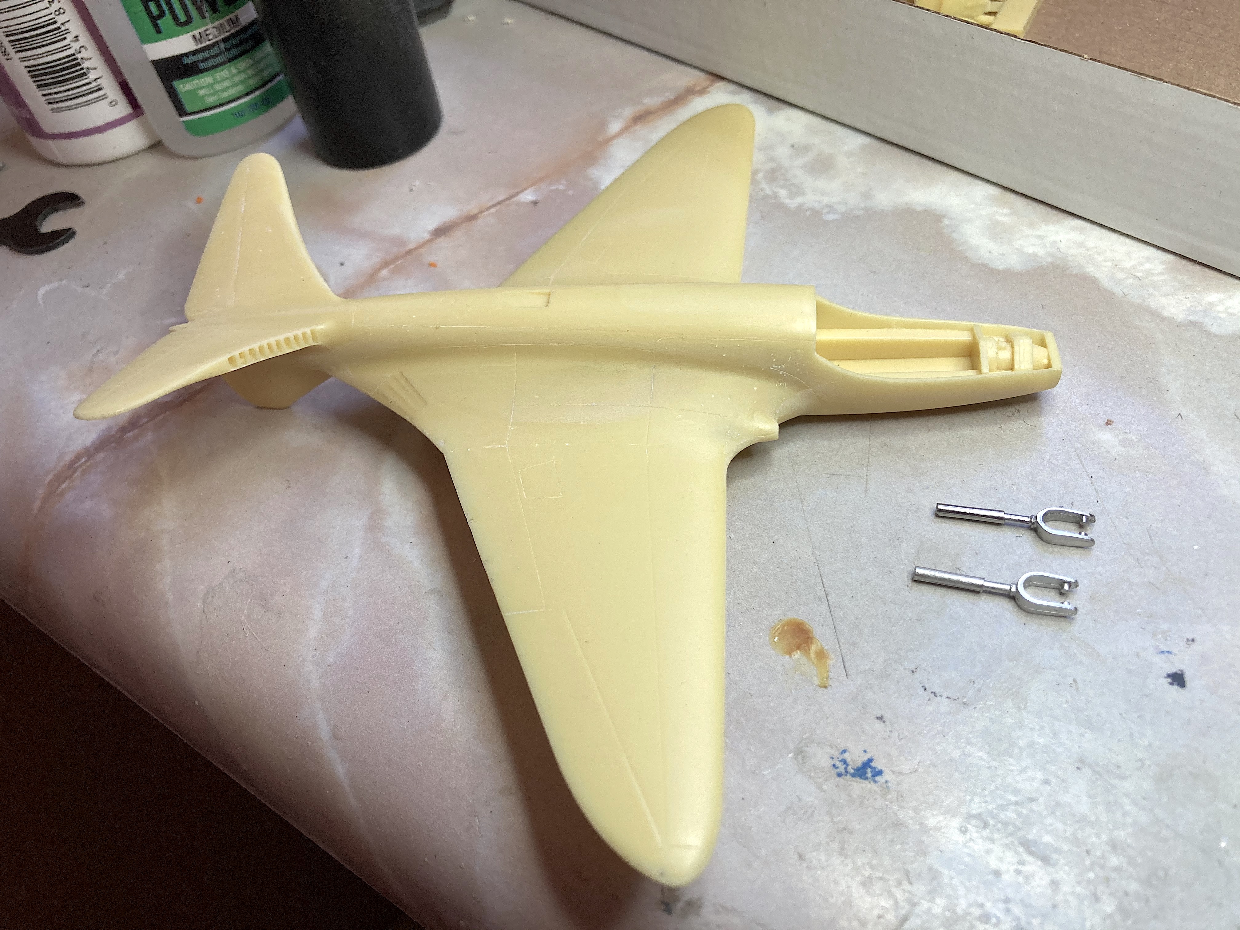

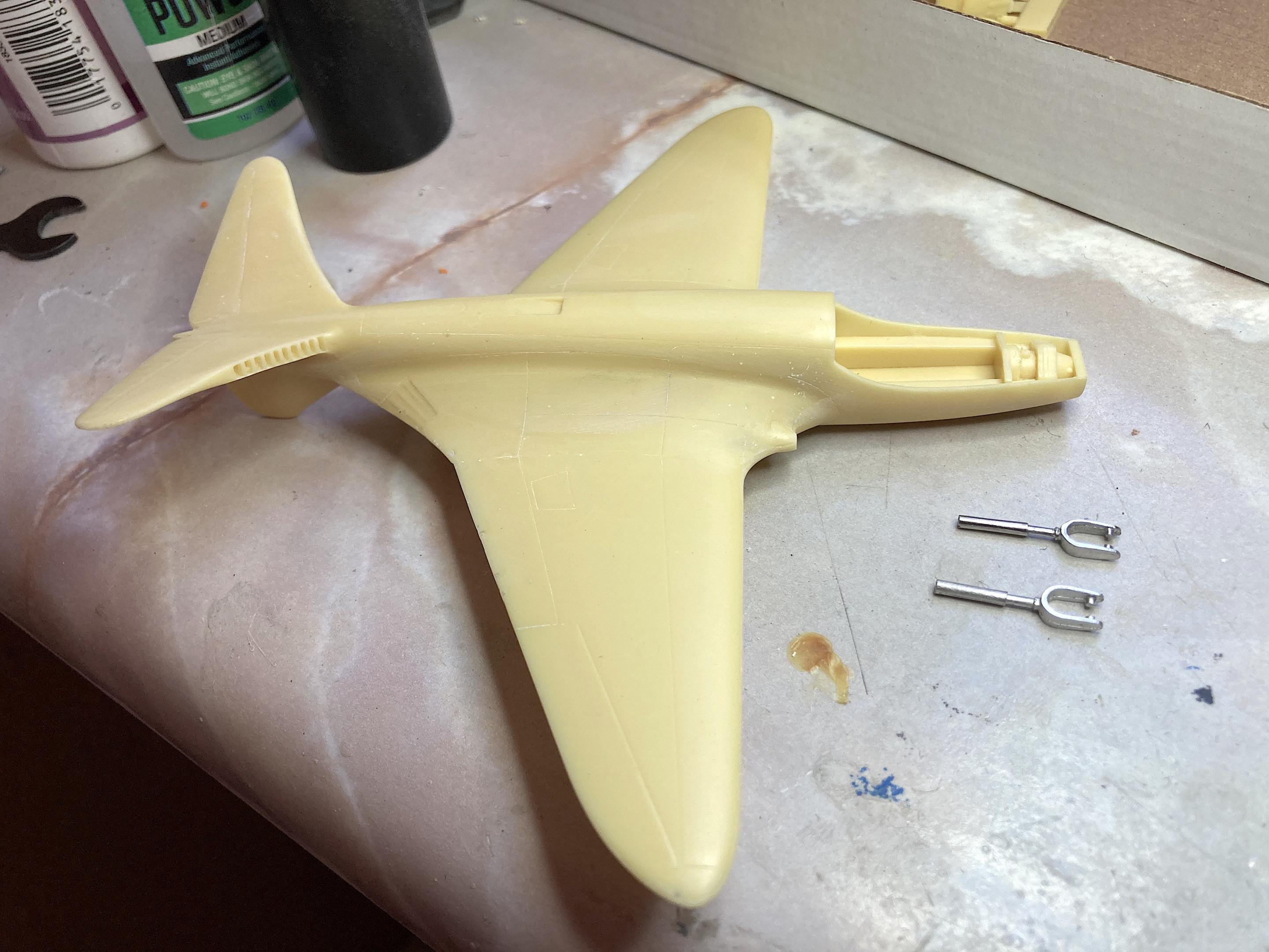

Spent some time looking for bubble holes, there are many.  The landing gear is white metal; I have filed, sanded, steel wool and Dremel wire brushed one here.

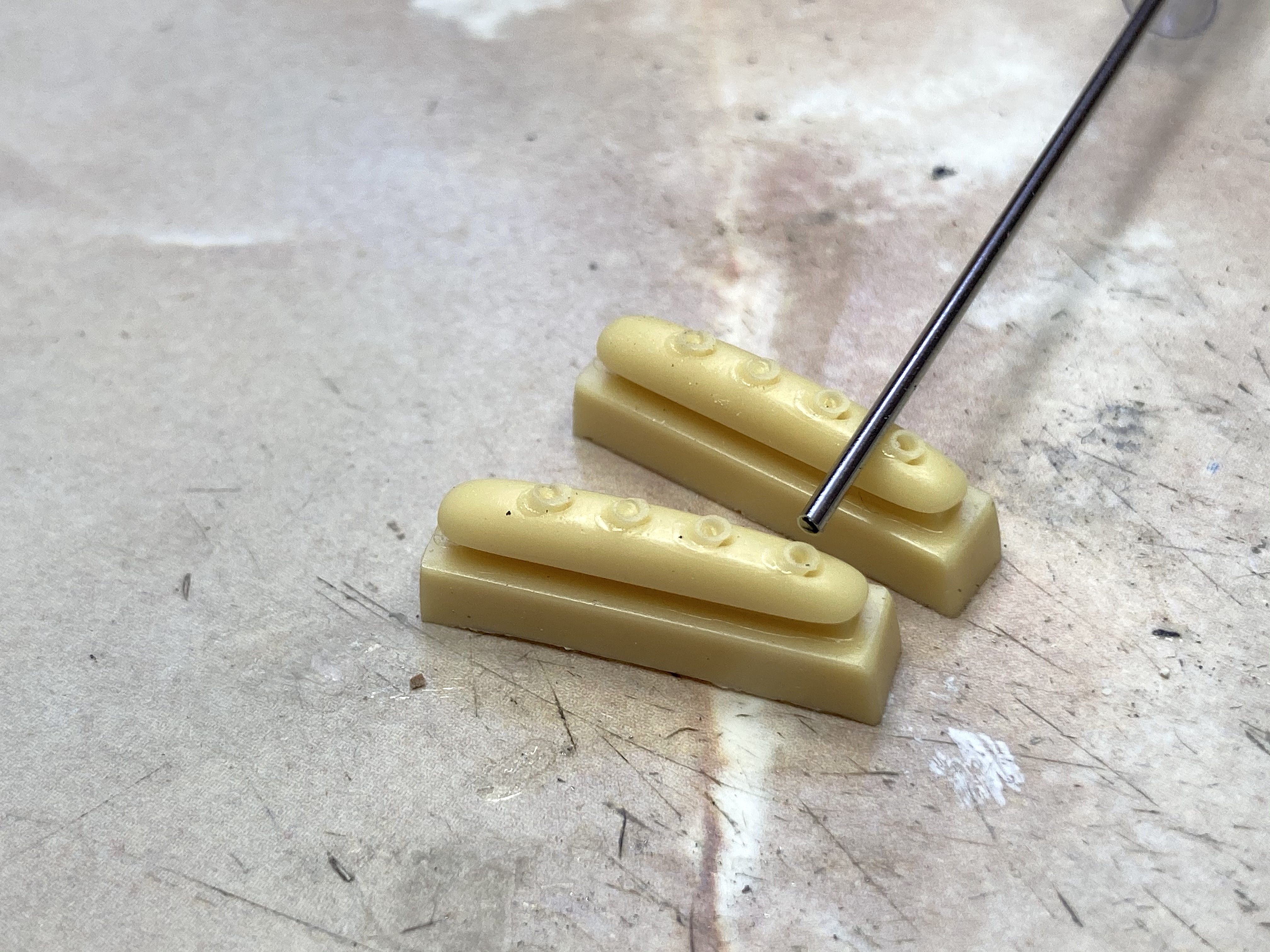

The exhausts needed to be fixed, going to use steel tubing.

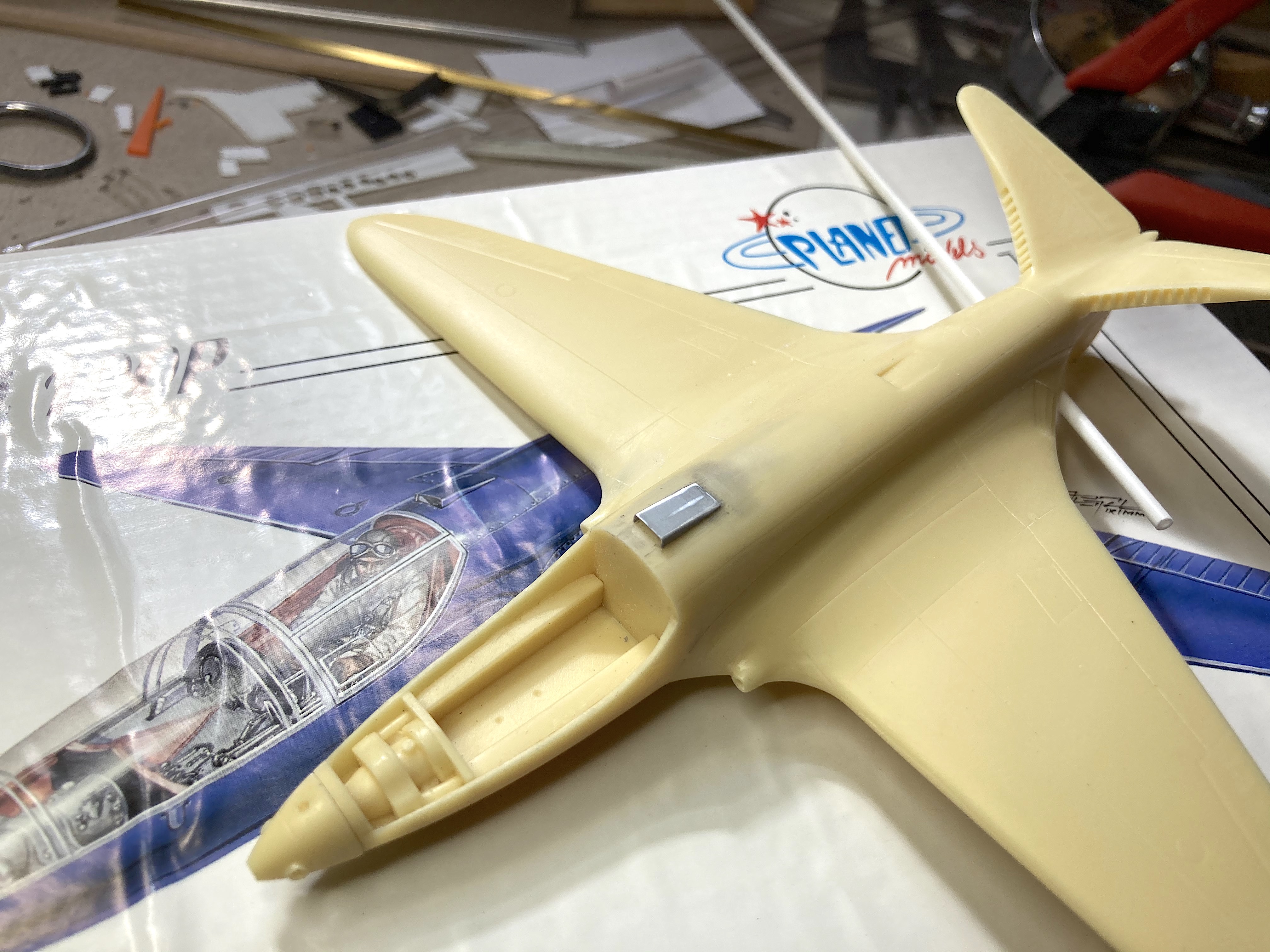

Spotted a detail that was overlooked.  How anyone can miss this, is beyond me.  The box art has it, pictures I found of the plane at the Oshkosh museum shows it.  Made from aluminum newspaper printing plate.  Also added the tailwheel.

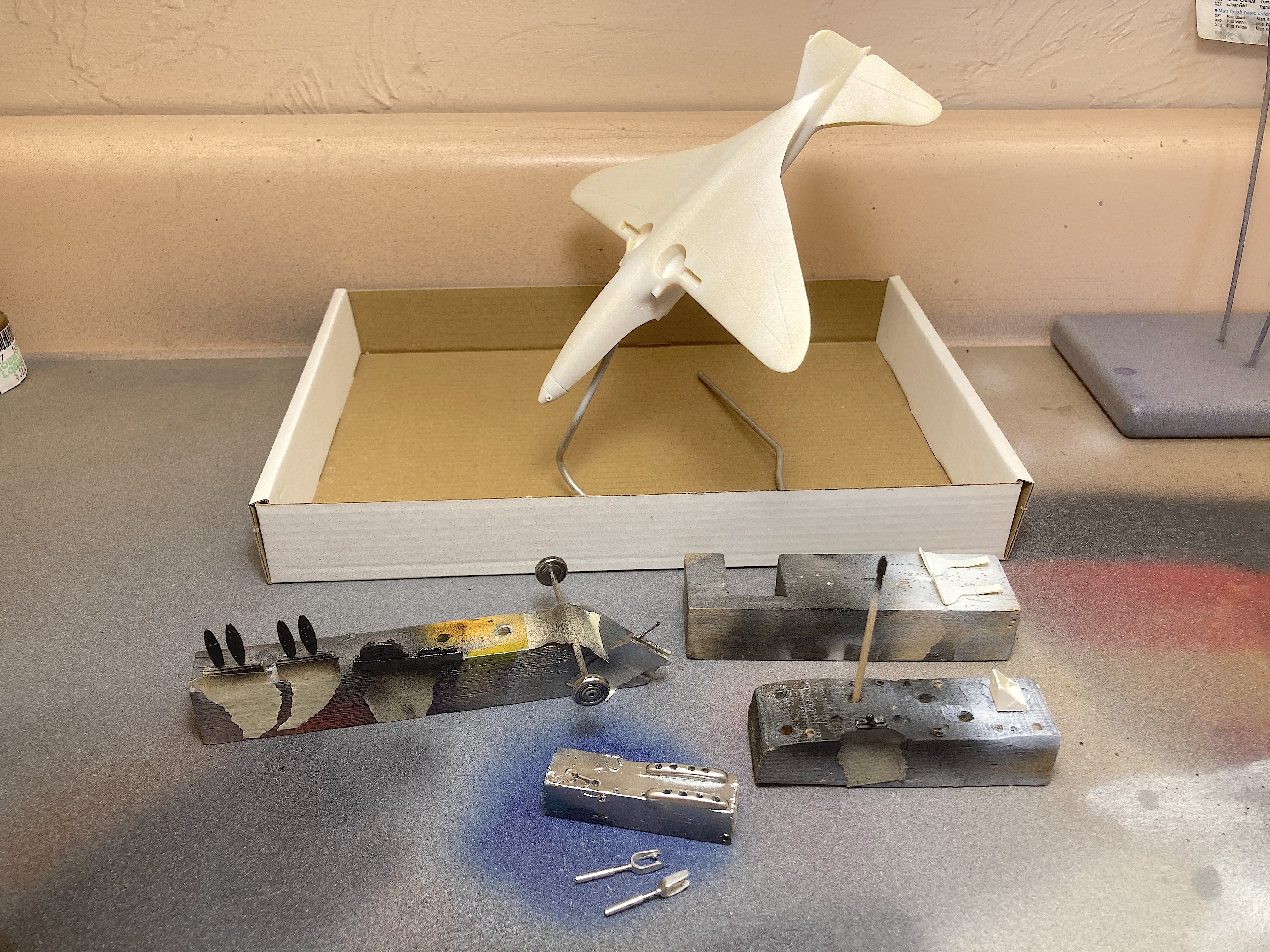

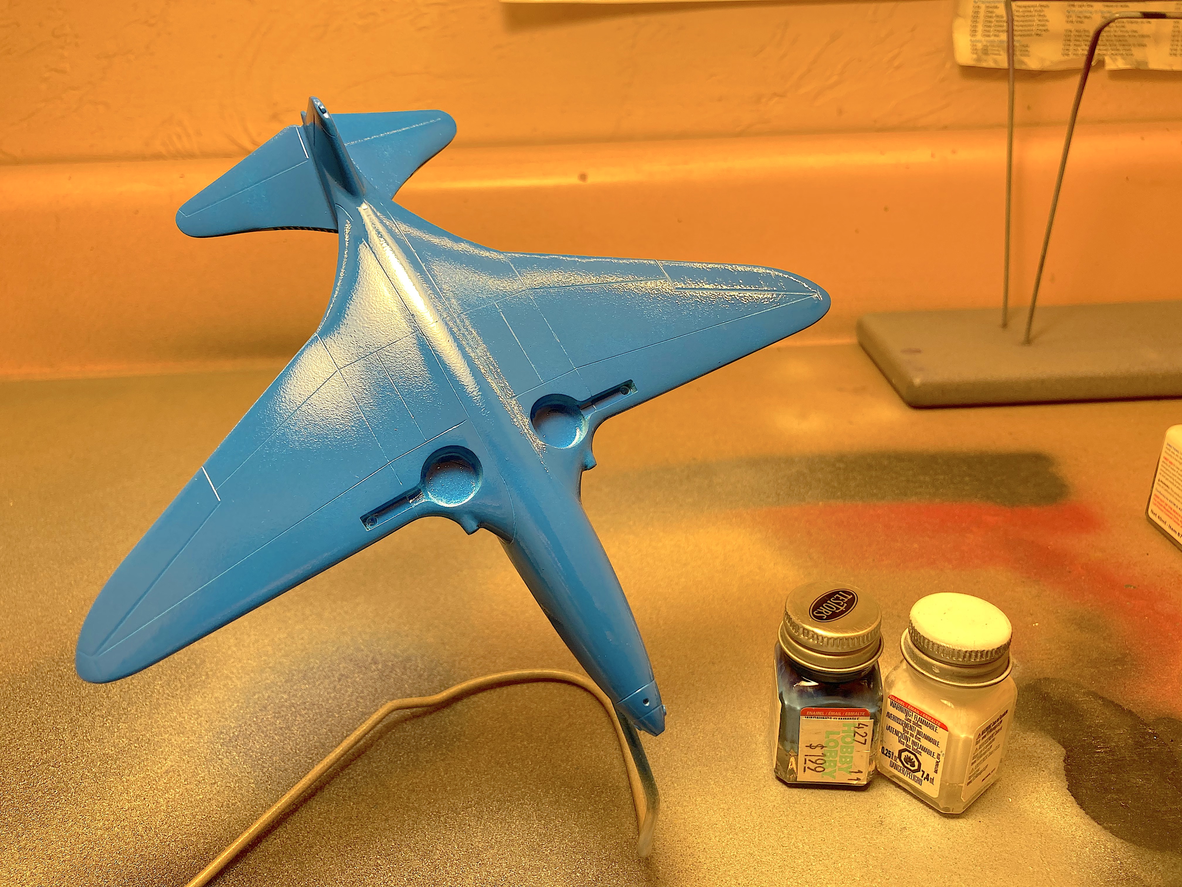

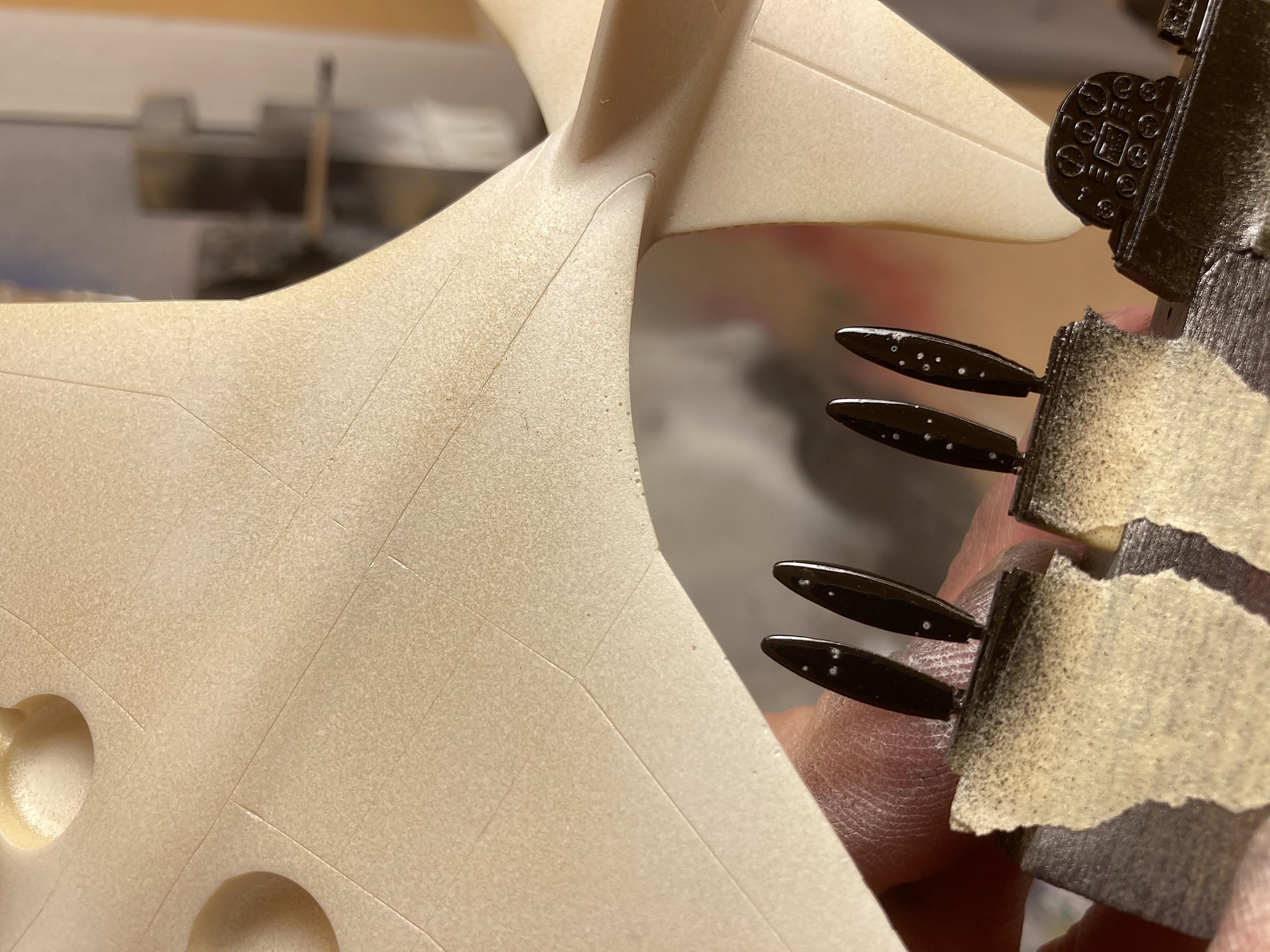

Fun to do a model that can be painted the same day.  Tamiya primer to start.  Gloss black, then Alclad polished aluminum.
Now I'm irked. ¬†I used a magnifying glass to look over the body, still missed an area. ¬†Then the propellers shouted about bubbles, on both sides.¬†ūü§¨
Enough whining, it's typical of resin.

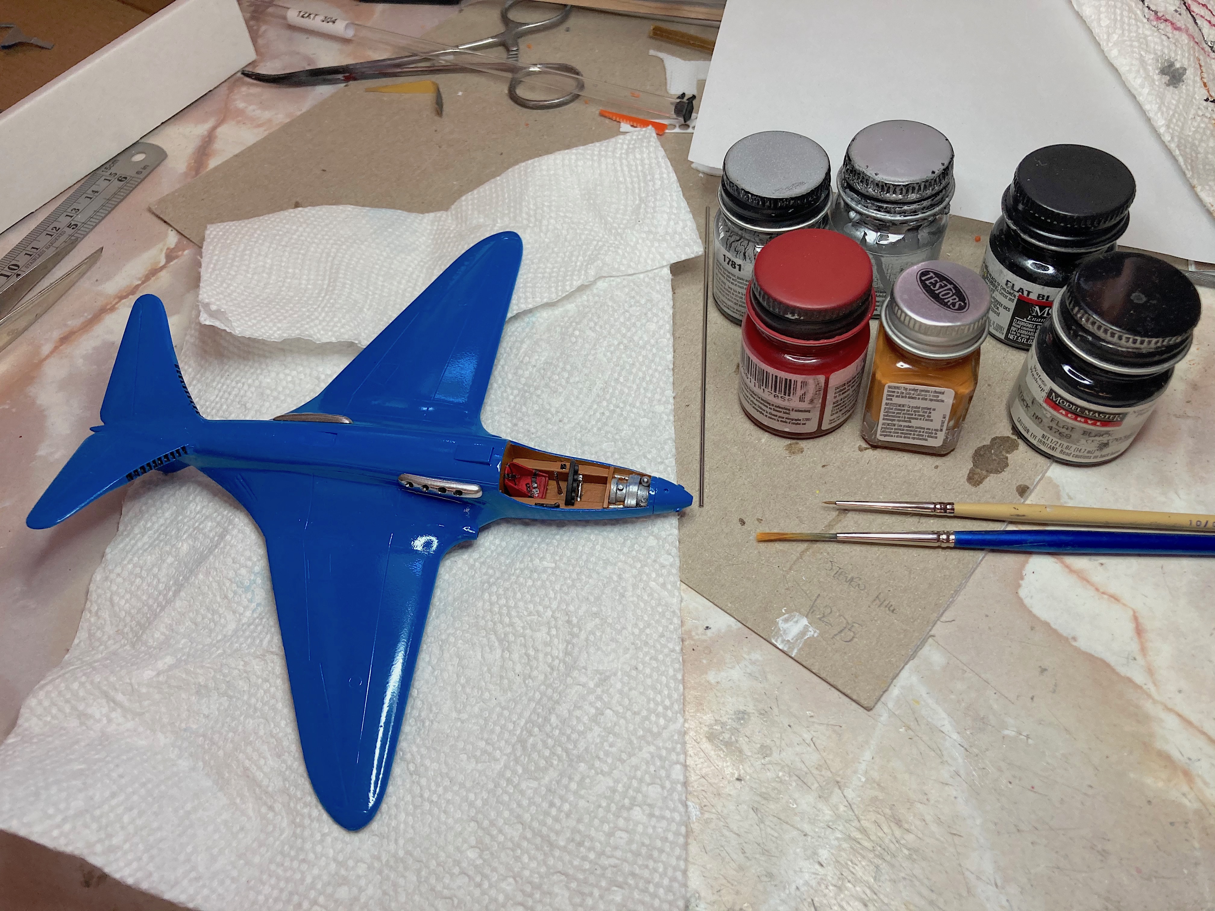

Now color of wheel bays? ¬†Interior, seat is red, looks like the whole interior tub is. ¬†Nice dash detail. ¬†Propeller gearbox molded in, thinking of aluminum brushed on, not a favorite thing for me. ¬†I'm also thinking of sacrilege,¬†racing stripes. ¬†ūü§ę

By the way, the red interior, is not period correct according to the restoration material I found somewhere.¬† The seat is correct but the rest including the wheel wells¬†should be natural wood.¬† The red is a wood preservative used to prevent any further deterioration of the original aircraft.¬† I think most people look at this and expect that it is riveted aluminum on¬†a monocoque frame.¬† The only exterior metal is the fairings¬†around the wings, the air inlet on the top of the fuselage and the prop spinner.¬† Well, the gear doors are aluminum also.¬†ūüėČ

It's one reason I posted on this forum, appreciate the information!   I knew they used wood, was thinking the wheel wells should be tan and not aluminum.  The cockpit might as well be, except the seat.  I've been noticing there are no exhaust pipes on the museum plane, figured there were no engines.

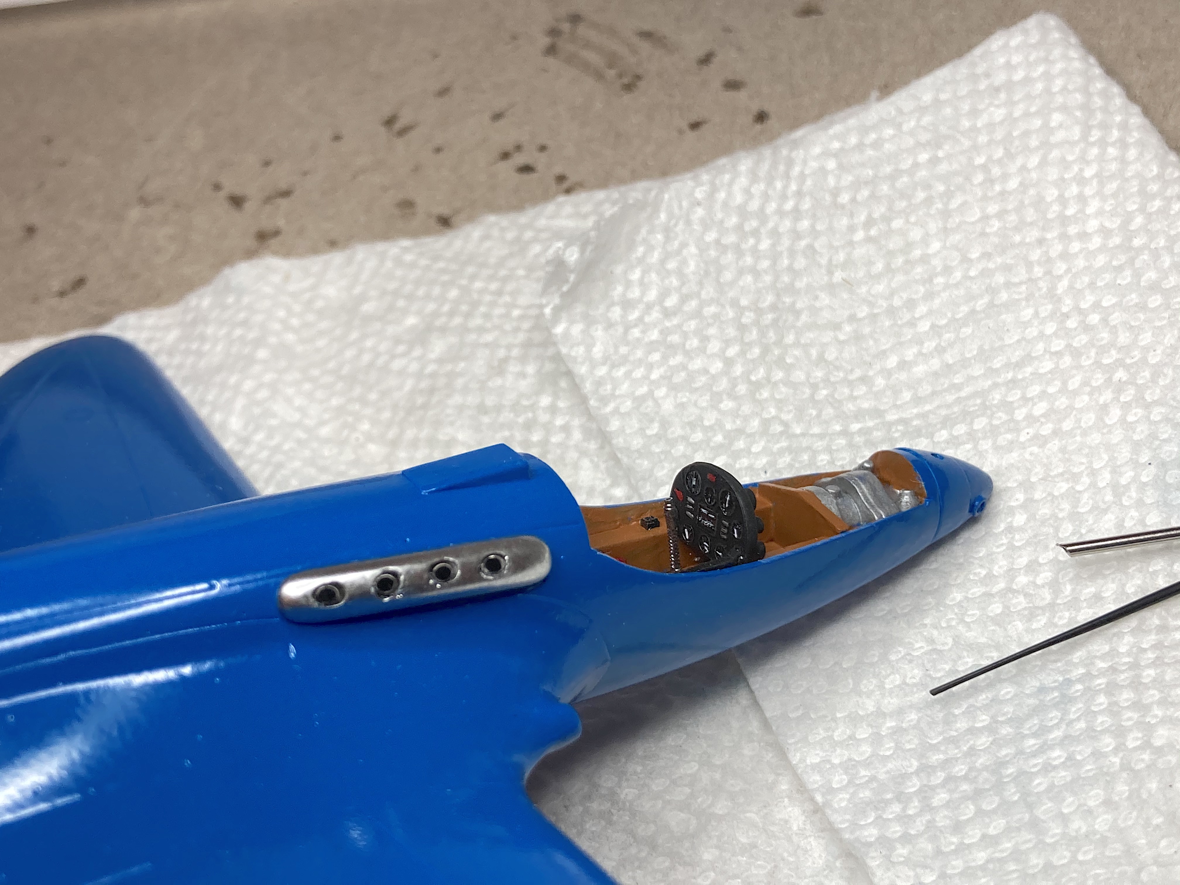

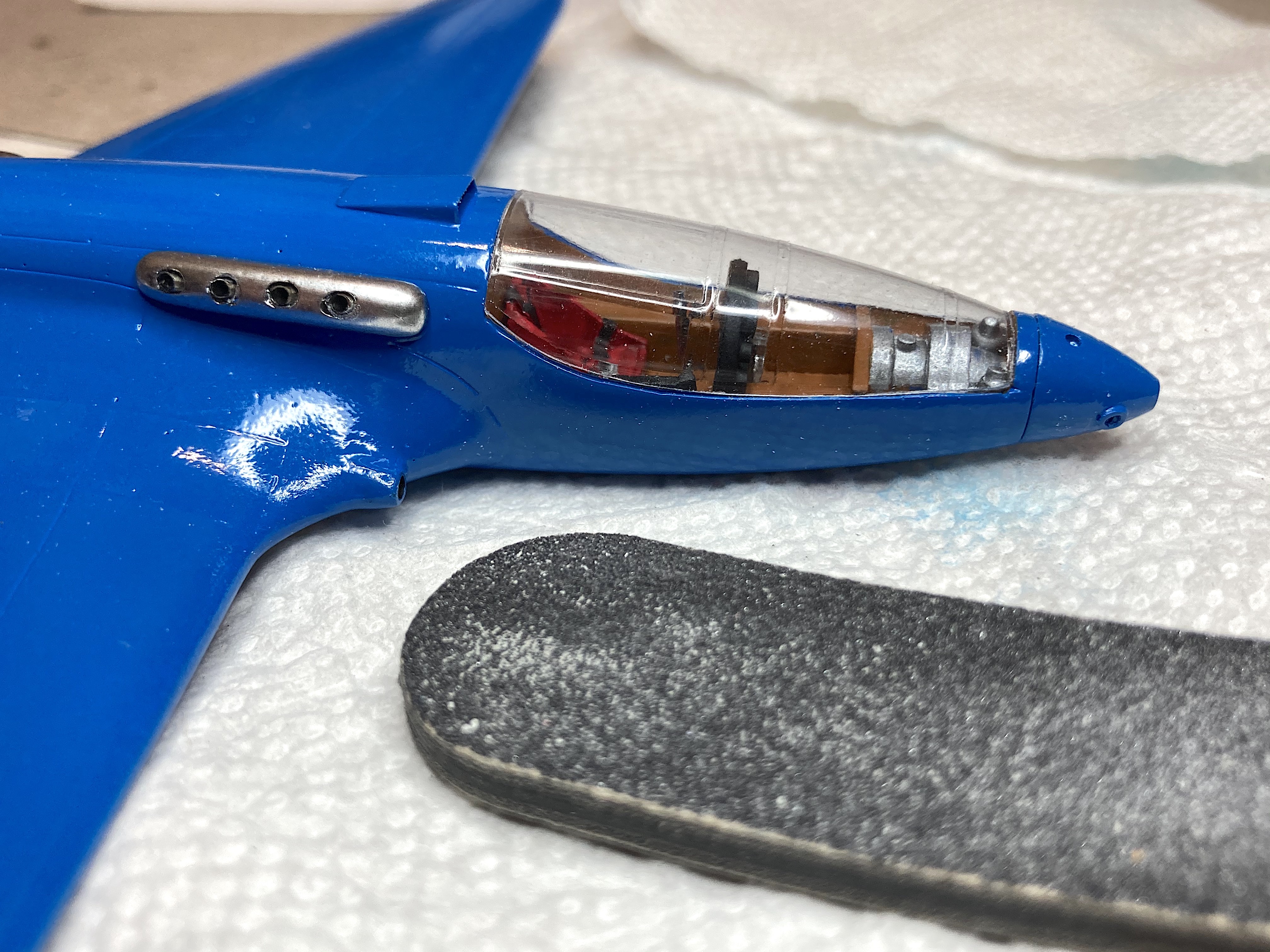

I painted a second coat, a little more thinner helped reduce orange peel.  I was hesitant to put tape on for masking, tried a purple tape that is less tacky, it's junk.  Sucked it up and brush painted the interior.

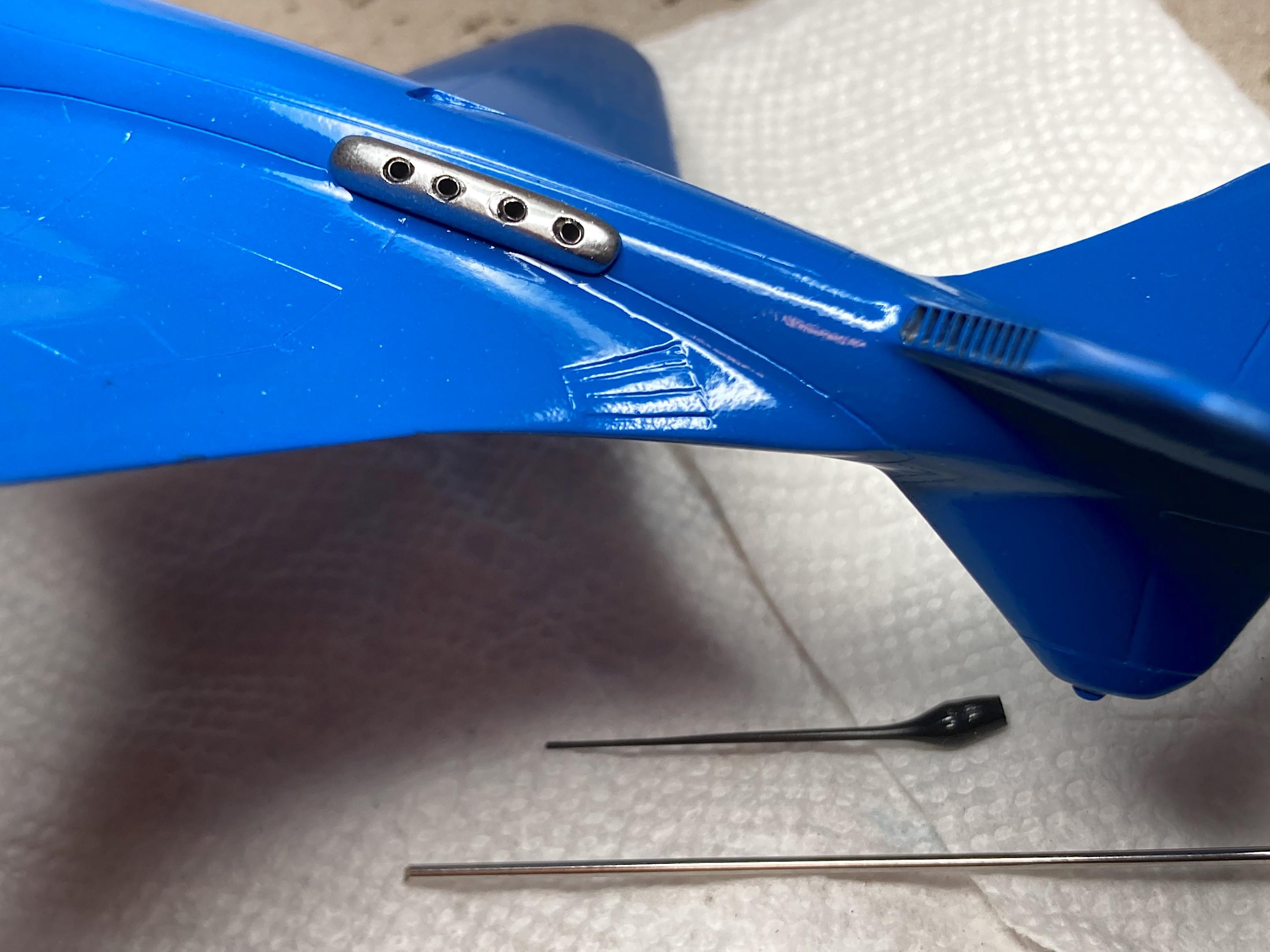

Exhaust tips are done.  Used the Dremel disk to cut.  I should have worked on the fairings more, oh well.

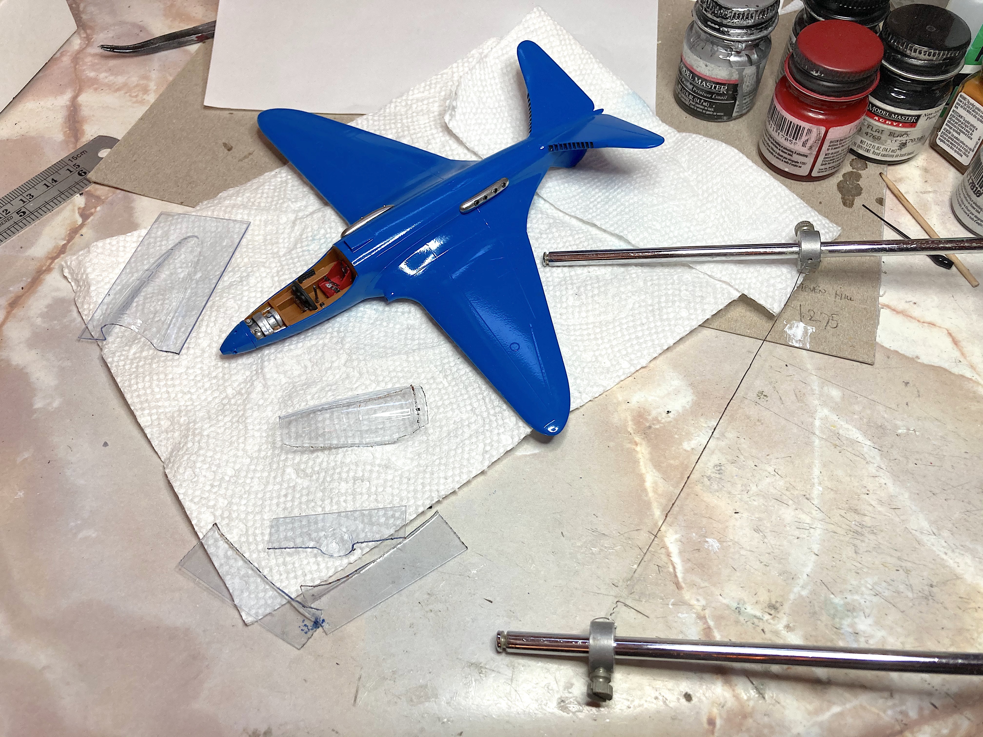

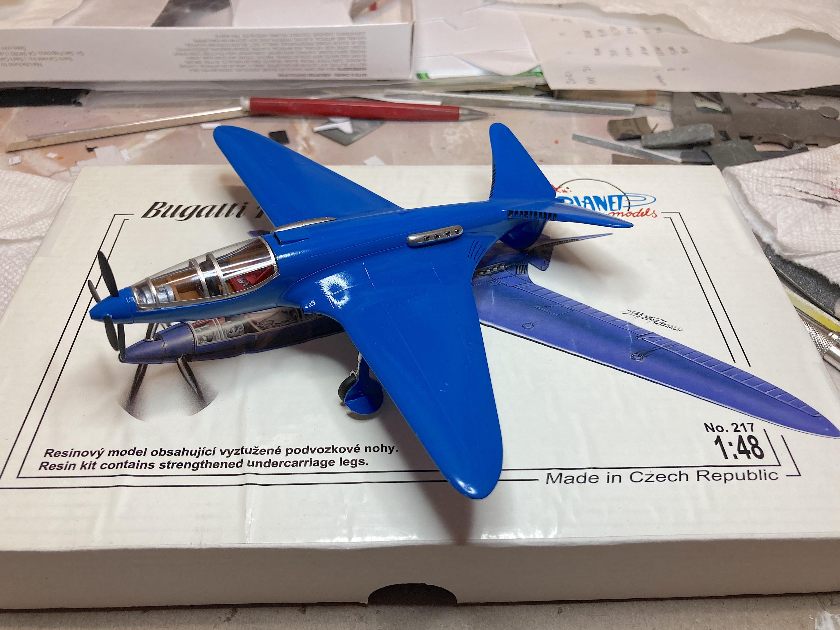

Cut the canopy out with the hot-wire.
Sanded the edges, had a good fit, I thought.

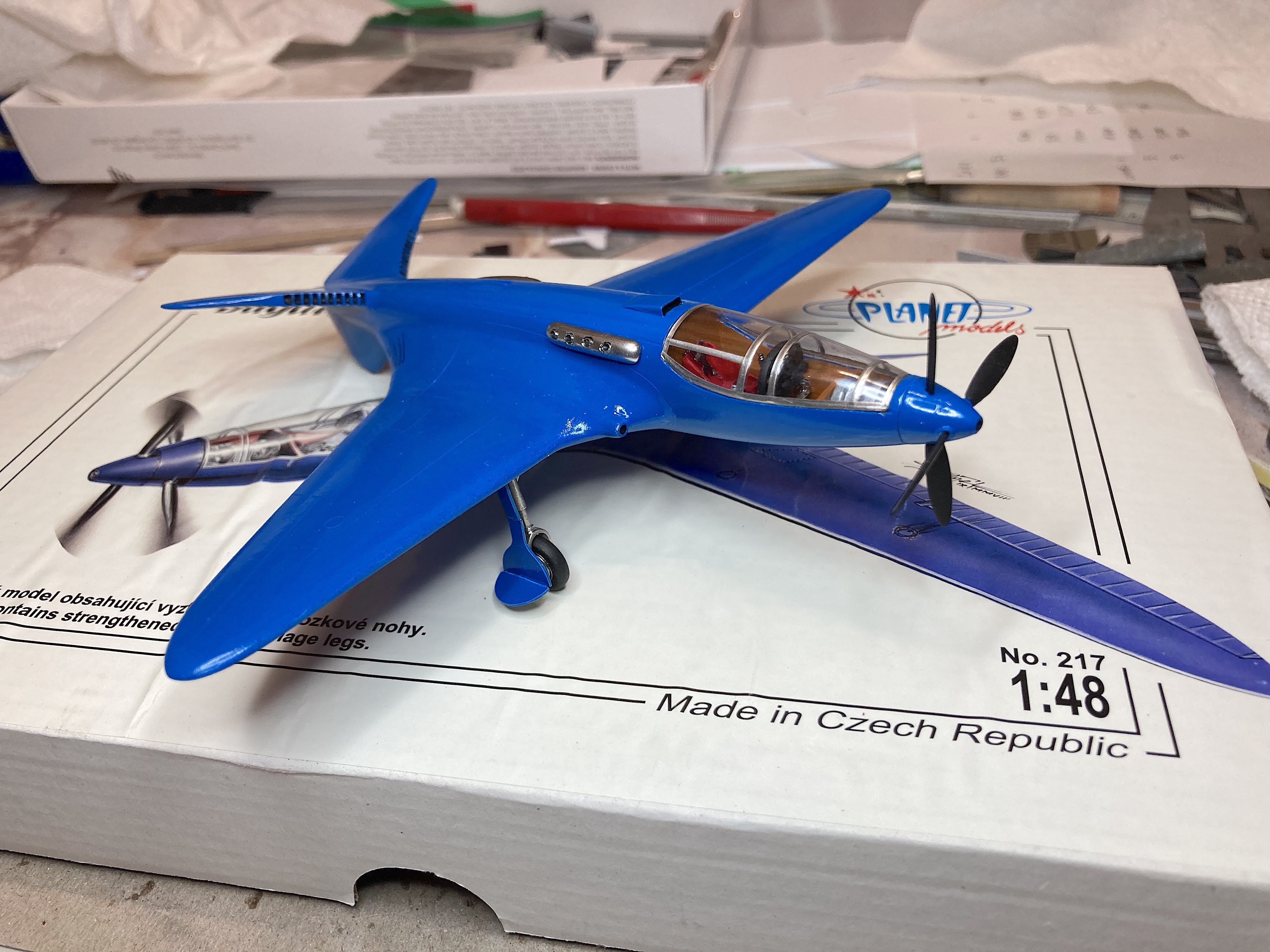

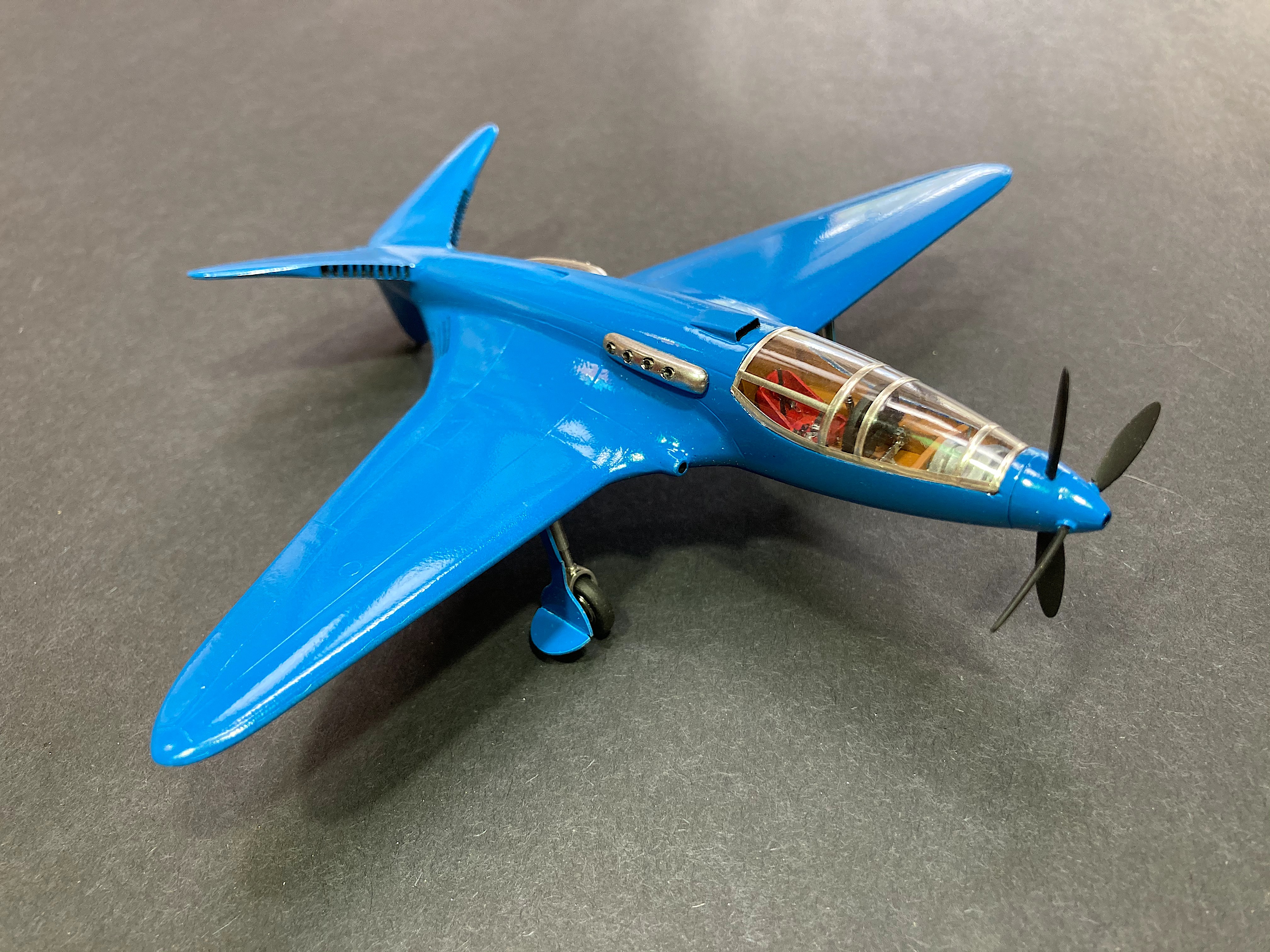

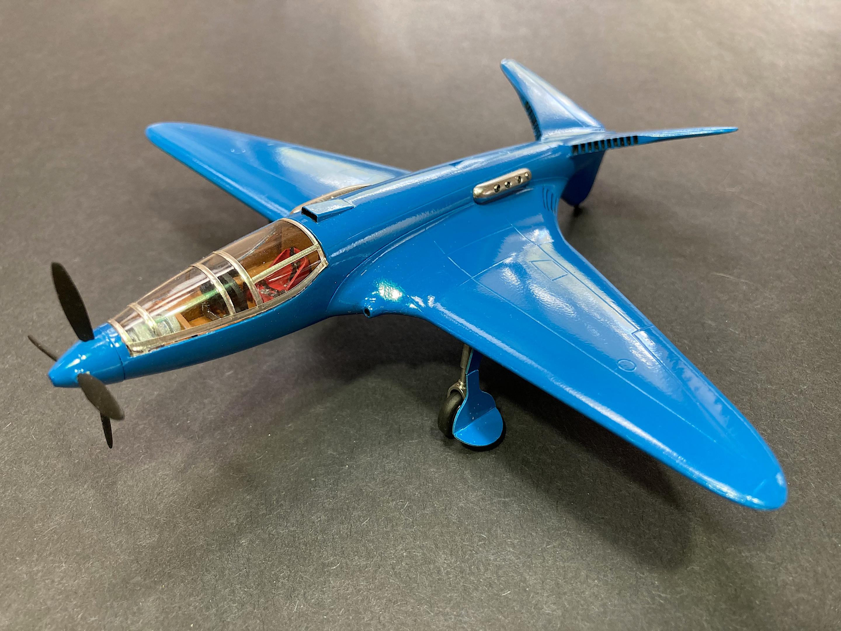

Bare Metal foil was used for the canopy frame.  Good thing it wasn't painted!  Blades were the last parts glued on.

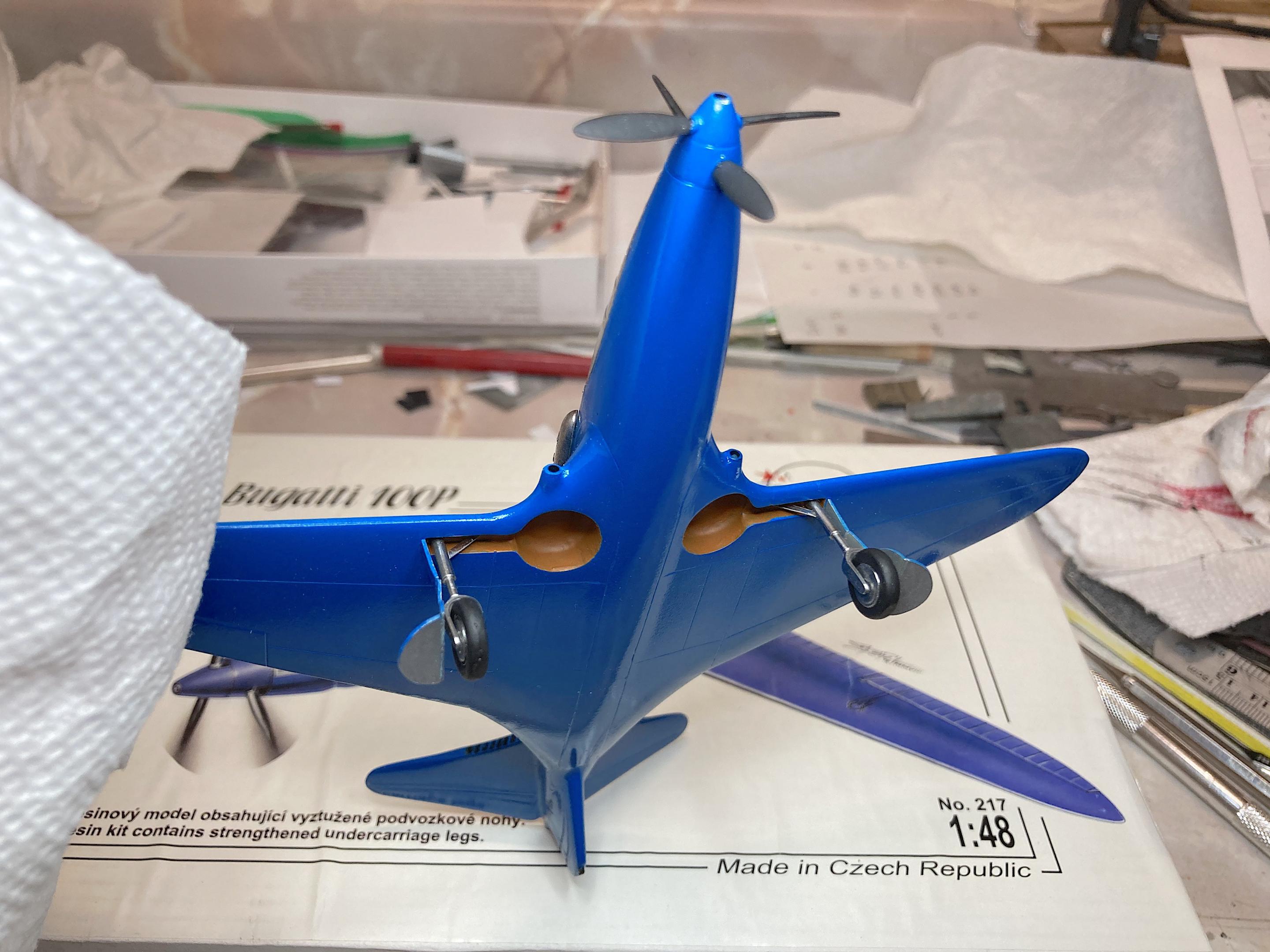

Had drilled holes for the landing gear, they expected you to just stick them on.  An annoying thing to assemble was the wheel well doors, it's just butt glued together.  Added the diagonal struts, cut coffee can steel so I wouldn't have to paint it.
That was fun, to actually finish a model after not doing anything for a couple of months.  Planes are not my forte, didn't scribe panel lines, or do the painting black before the color, or weathering.  Now that it's summer, fingerprints are the demon.  I couldn't imagine trying to land this, you have to look sideways!

Very nice finished kit.  1:48th scale???? That is tiny!  I don't think most people will get that.  It finally dawned on me when I saw the end of the sanding stick.  You should shoot a photo with a ruler so people will understand what a find build this is.  My 1:24 scale one is about the size of a regular 1: 48 scale airplane.

Thanks!  Good idea with the ruler.  You can post pictures of yours, I wold like to see it.

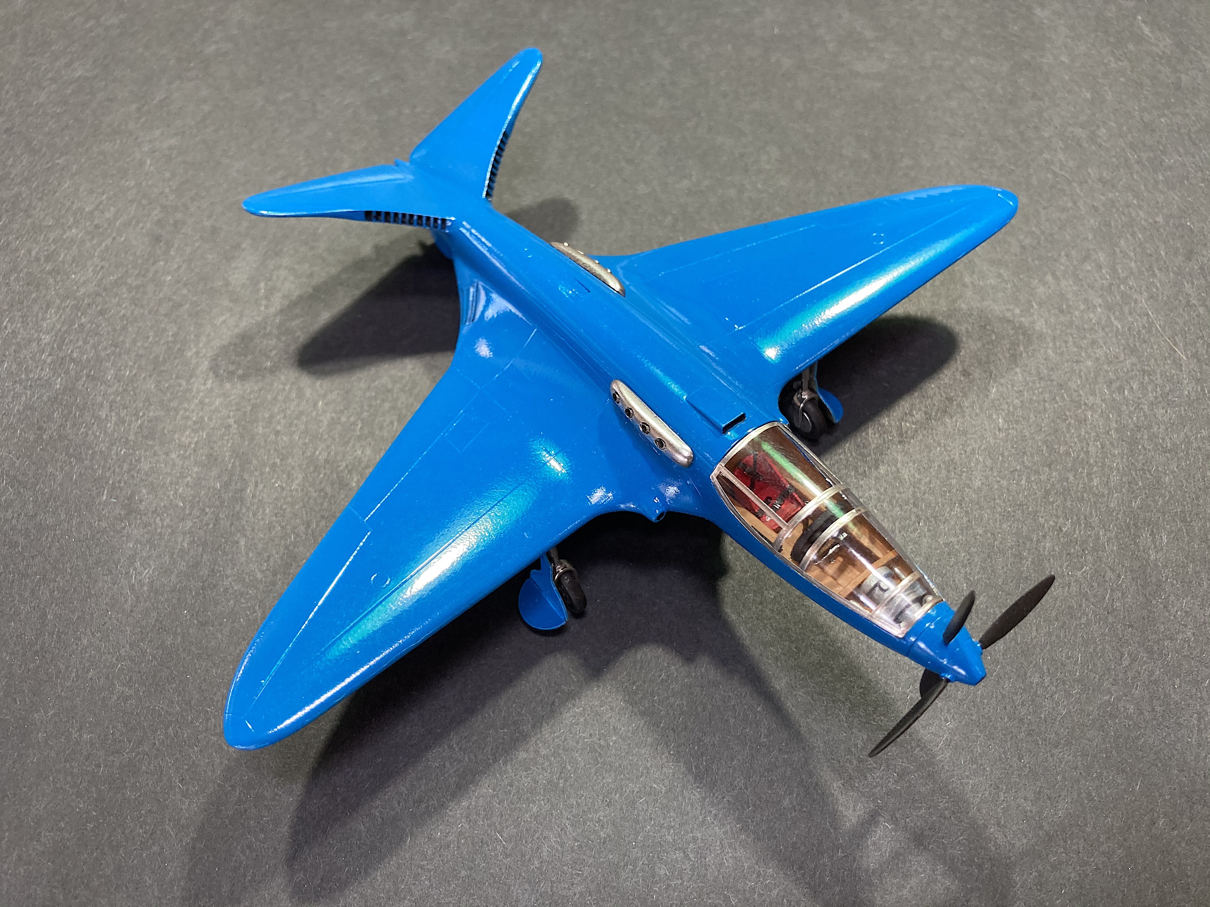

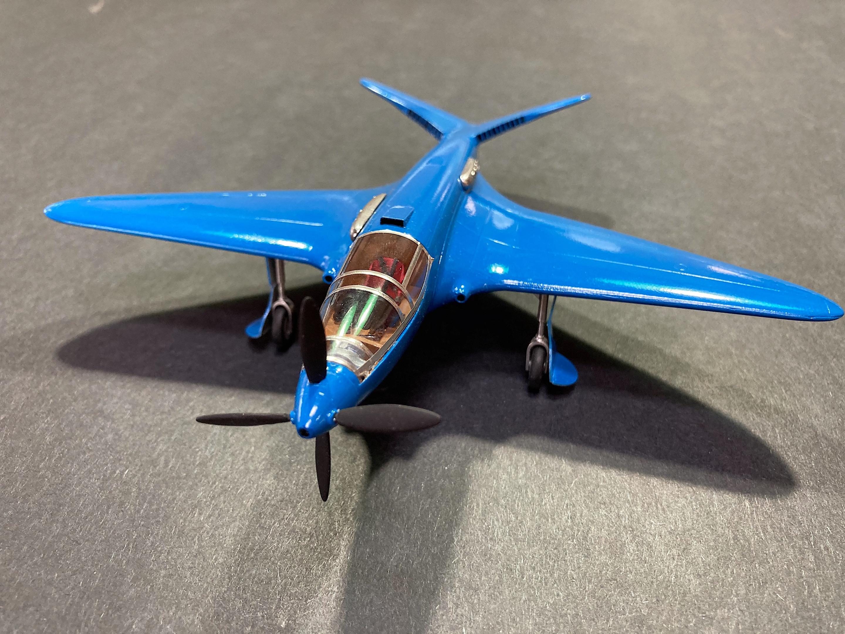

I'm wrapping up this topic with "studio" pictures. ¬†It would look really crude at an IPMS contest, bet nobody else would set one down.¬†ūüėÖ
