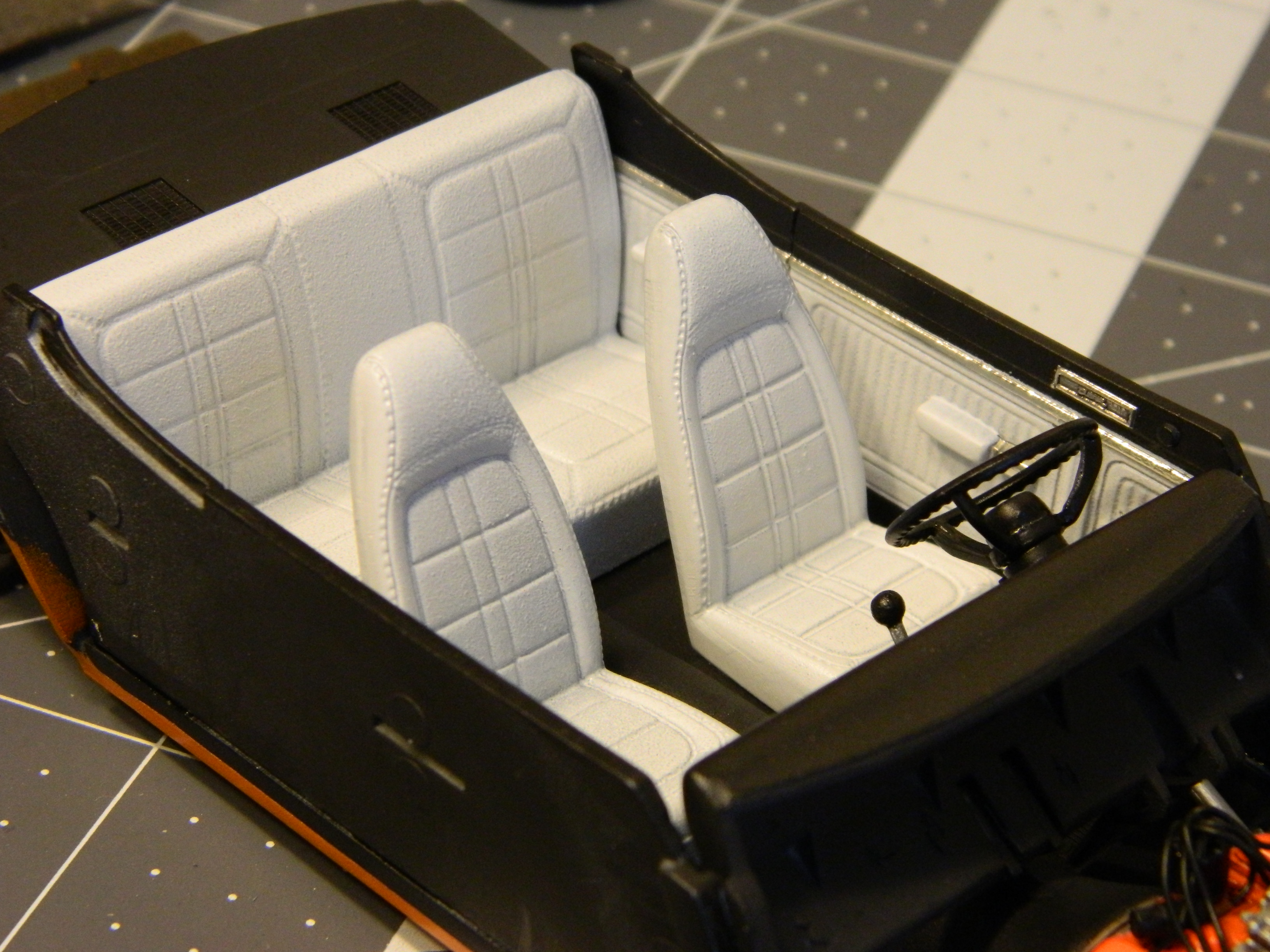

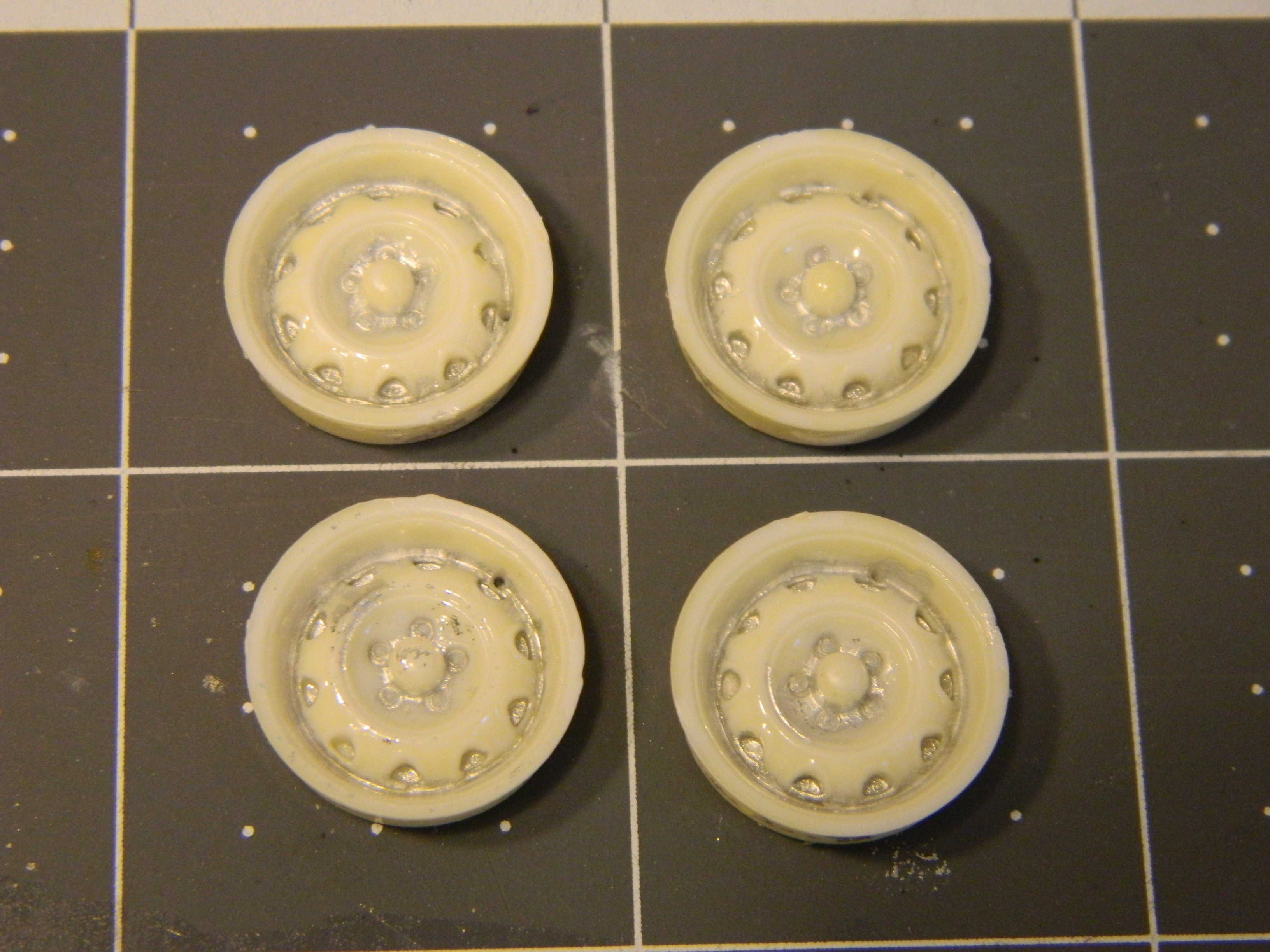

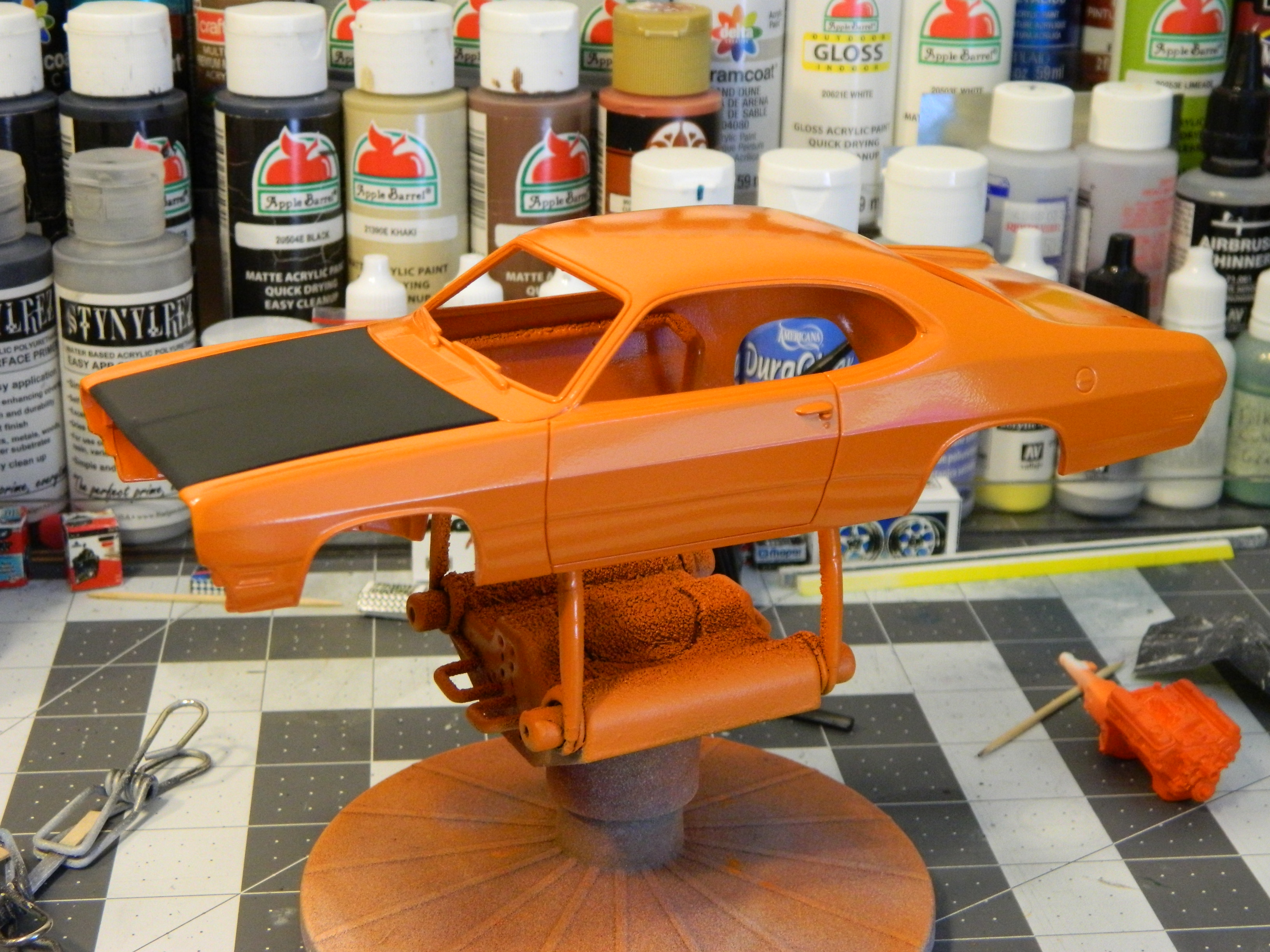

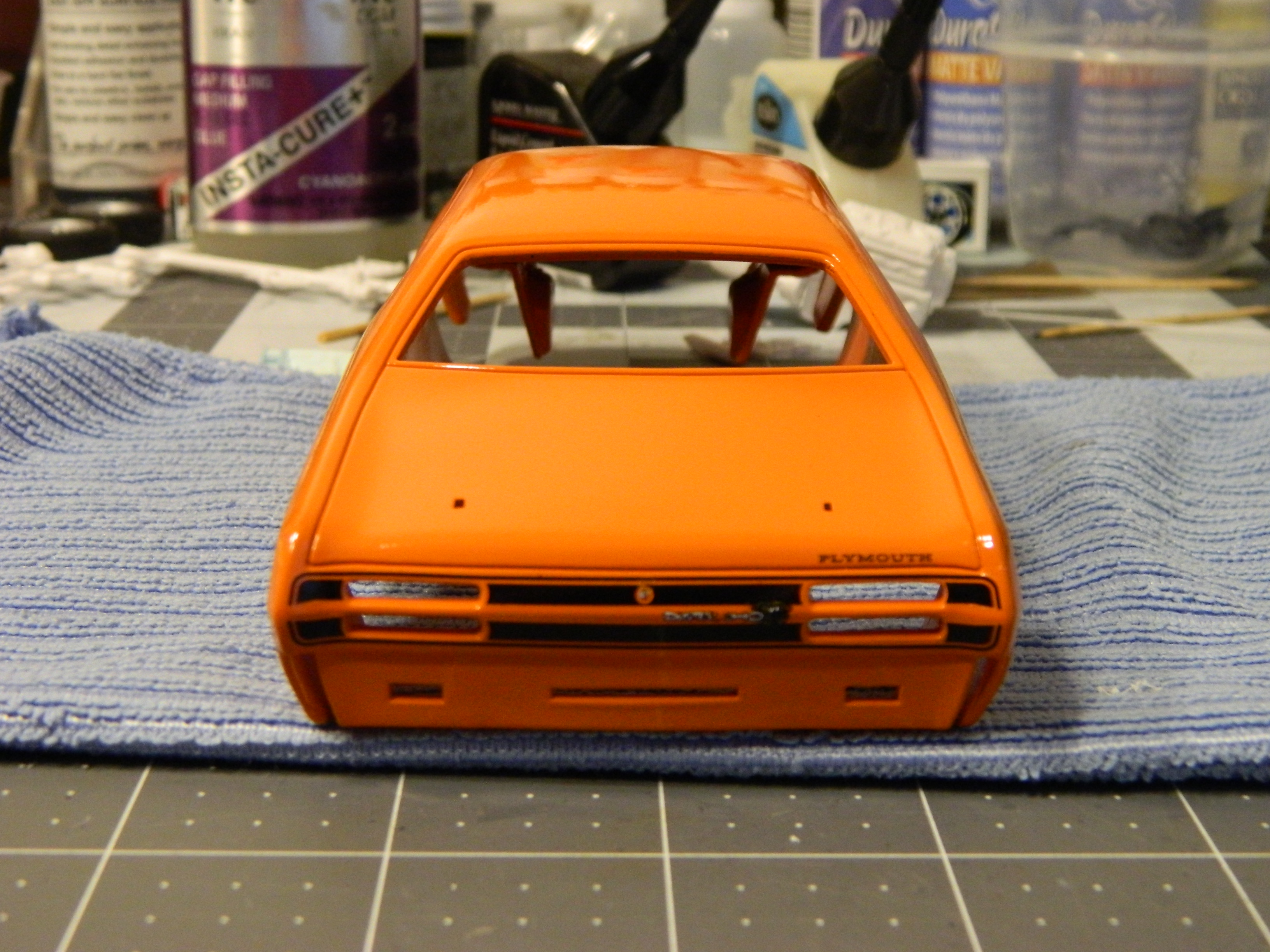

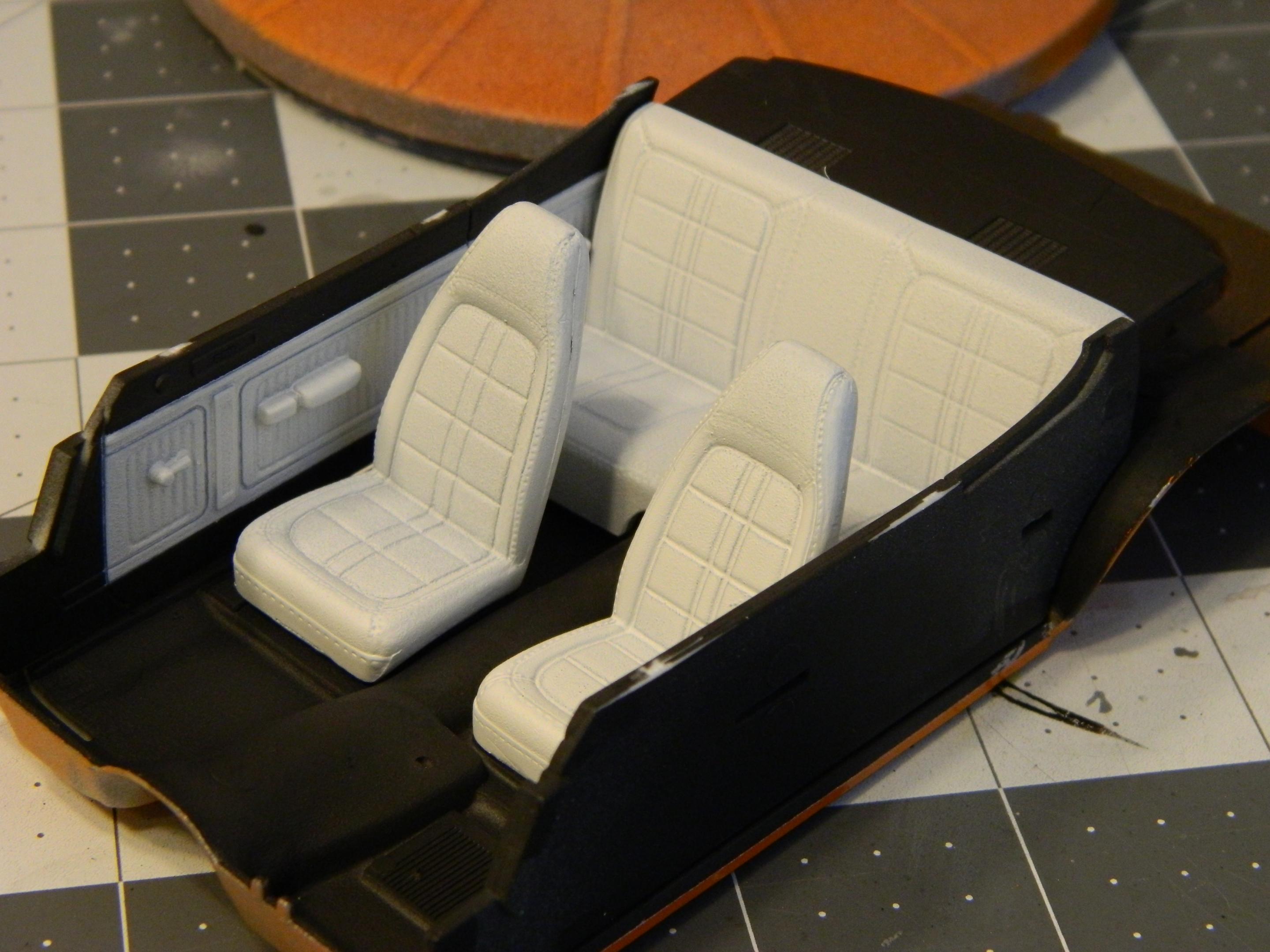

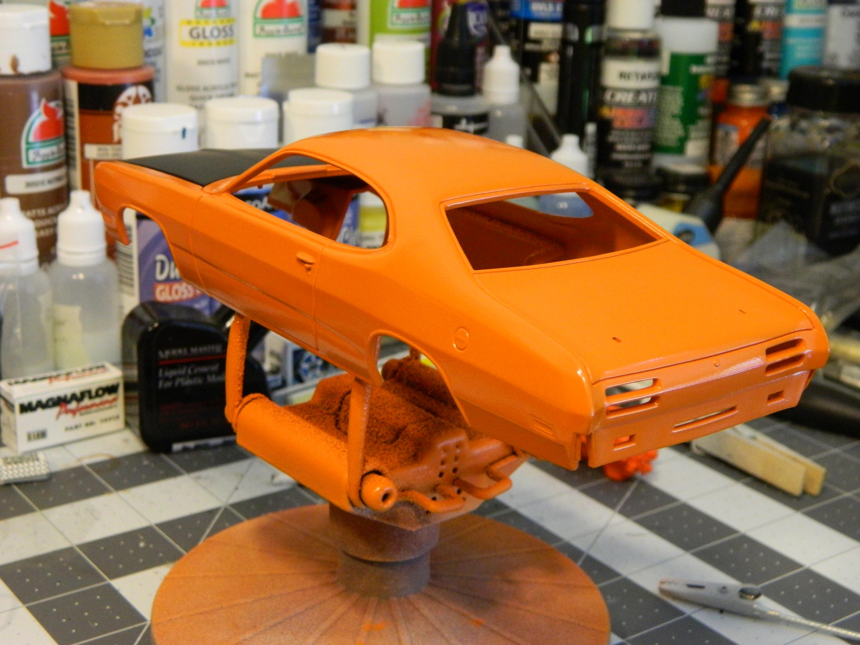

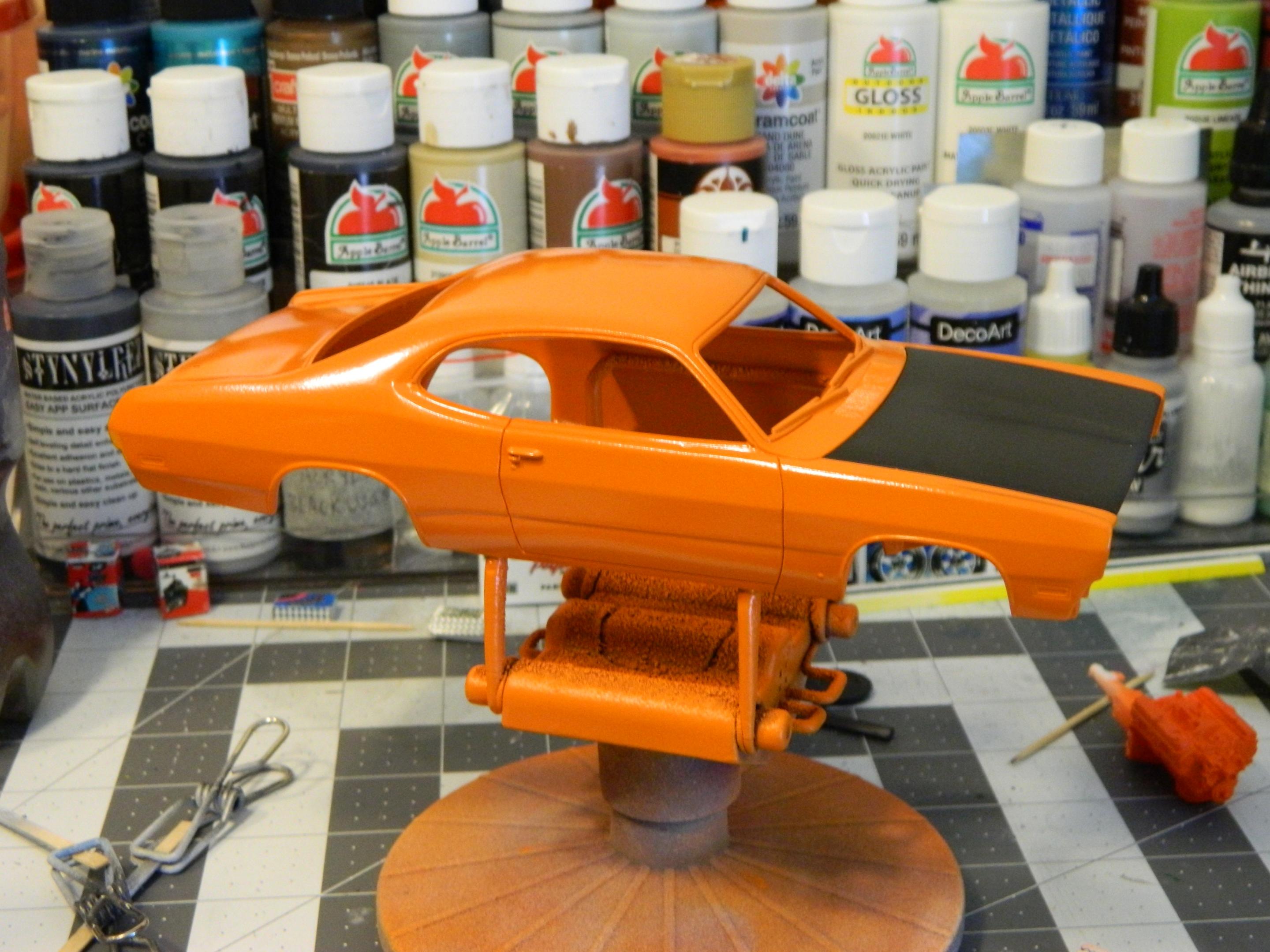

Dragonhawk1066 Posted June 13, 2021 Share Posted June 13, 2021 Here's a quick little update on this one I started last week. I primed the body, firewall, and engine in white, and the rest of the parts in black. I taped off the interior panels yesterday and painted them and the seats in white primer over the black this morning. I airbrushed the exhaust and floor pan in Vallejo Aluminum, and the steering linkage and exhaust manifolds in steel earlier today, as well as the engine in Testors Orange Acrylic. I decided to go ahead and paint the body before lunch too, and it turned out pretty good. I will color sand the orange on this one before taping off the rest of the body so I can paint the top of the fenders, door panels and around the windows black. I sprayed some dull-cote onto the wheels Friday too, but I didn't like how they looked, so I put them into a container of LA's Totally Awesome overnight. When weather permits again (rain tomorrow looks like) I'll get the wheels primed and painted in Vallejo Aluminum. 1 Quote Link to comment Share on other sites More sharing options...
bisc63 Posted June 14, 2021 Share Posted June 14, 2021 Looking good! That body looks really cool in orange. Nice detailed interior as well. Quote Link to comment Share on other sites More sharing options...
cobraman Posted June 14, 2021 Share Posted June 14, 2021 I like it. It's a pretty nice kit. I just finished mine today. Quote Link to comment Share on other sites More sharing options...
oldscool Posted June 14, 2021 Share Posted June 14, 2021 That is a perfect color for this car. Quote Link to comment Share on other sites More sharing options...

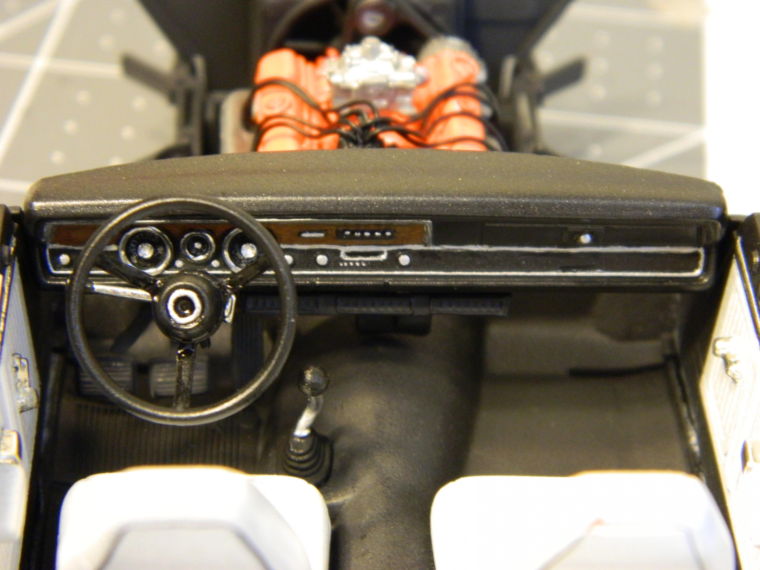

oldscool Posted June 15, 2021 Share Posted June 15, 2021 A word of advice if you haven't built one of these kits before, final assembly will go much smoother if you remove the flange from the bottom of the front windshield. It doesn't allow the interior to go up into the body far enough which in turn doesn't allow the body to fit all the way down over the chassis. You may even have to grind a little off the front of the dash as well. Quote Link to comment Share on other sites More sharing options...

slusher Posted June 15, 2021 Share Posted June 15, 2021 Beautiful paint and color choice.. Quote Link to comment Share on other sites More sharing options...

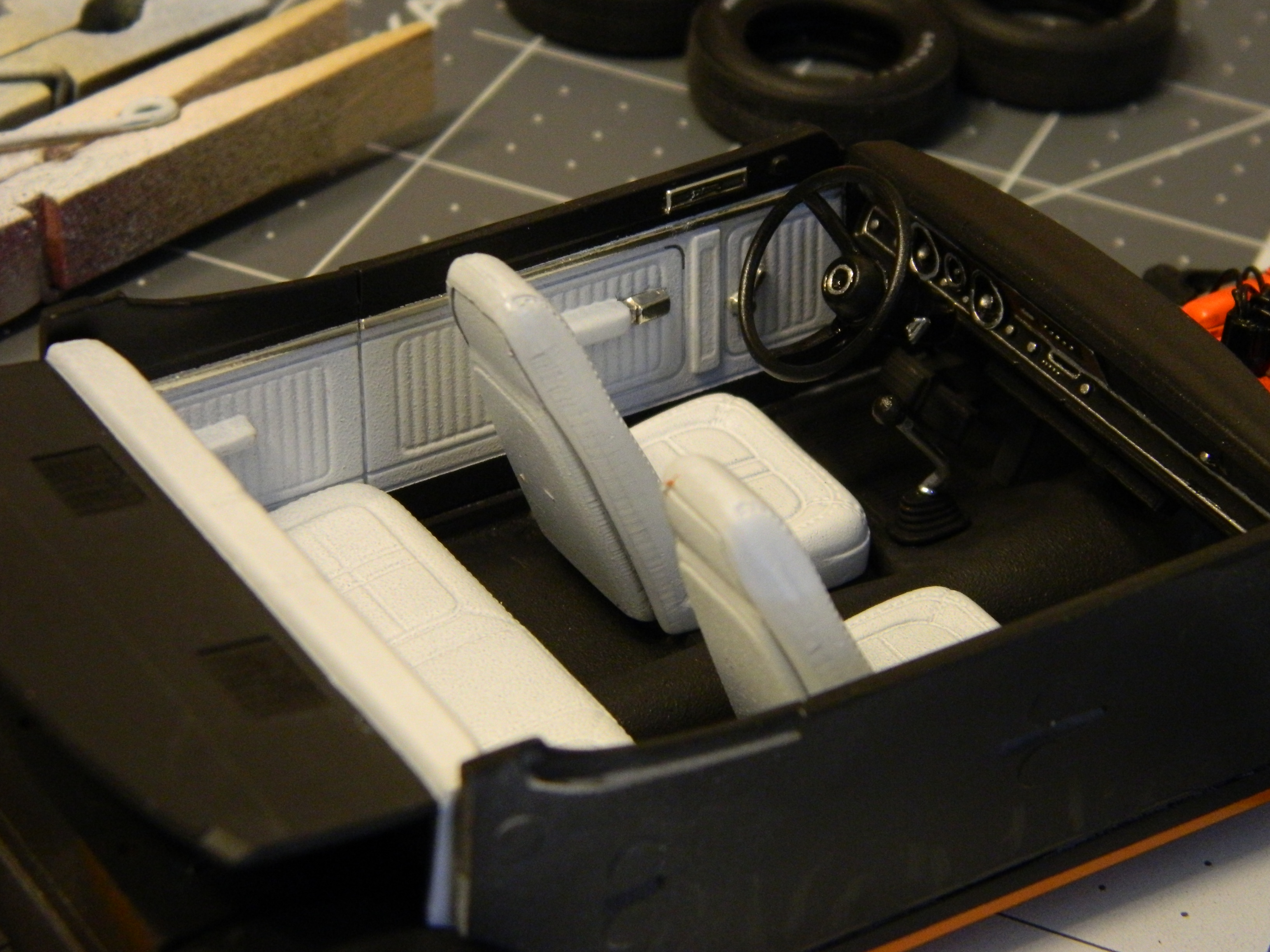

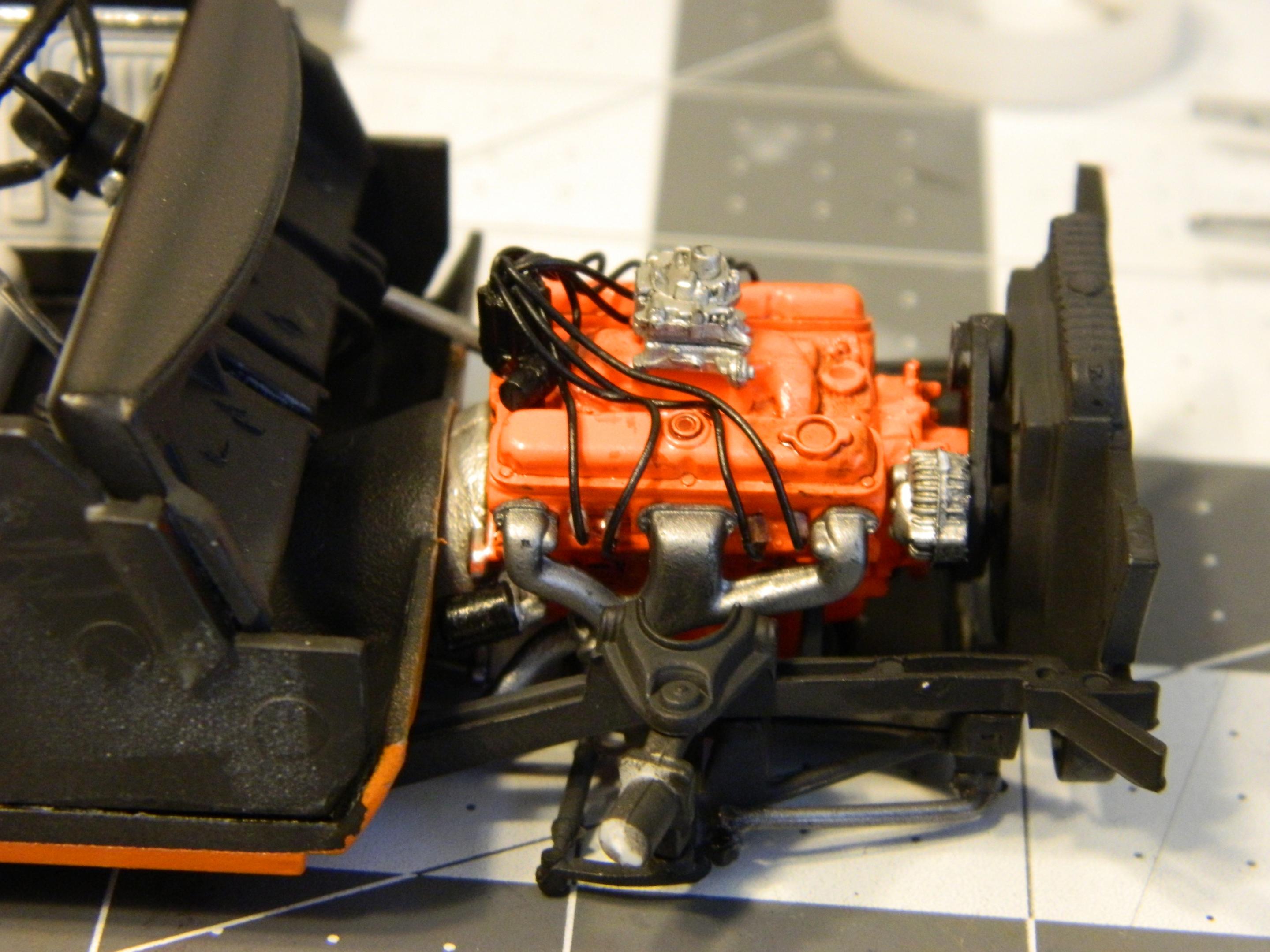

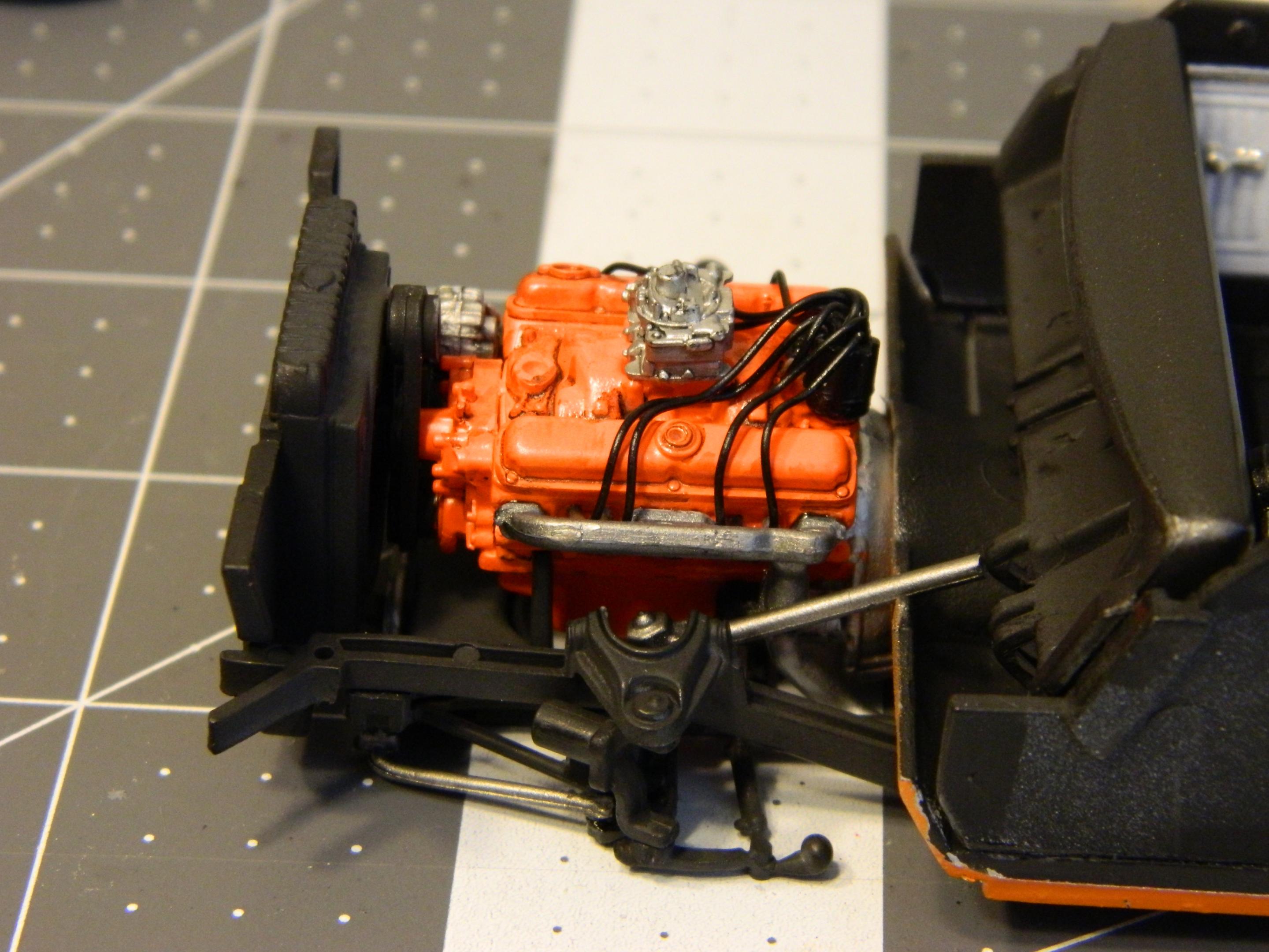

Dragonhawk1066 Posted June 17, 2021 Author Share Posted June 17, 2021 I got the interior buttoned up, the front and rear chassis done, exhaust on and engine installed. Now I just have to catch up on the body. I wet-sanded the Go Mango, and it's ready for clear, the black on top of the doors, cowl, and around the windows, decals, and foil but I have to figure out the best order in which to do it all. I'm thinking of doing the clear, wet-sanding it after a few days, then the black followed by satin clear on the black, then polishing the Go Mango with Novus #2 followed by wax, then the foil and decals last. 1 Quote Link to comment Share on other sites More sharing options...
Dragonhawk1066 Posted June 17, 2021 Author Share Posted June 17, 2021 (edited) On 6/14/2021 at 8:05 PM, oldscool said: A word of advice if you haven't built one of these kits before, final assembly will go much smoother if you remove the flange from the bottom of the front windshield. It doesn't allow the interior to go up into the body far enough which in turn doesn't allow the body to fit all the way down over the chassis. You may even have to grind a little off the front of the dash as well. Thanks again for the tip, I removed the piece from the bottom of the windshield, then did a test fit and everything fits perfectly (hope I didn't jinx it for final assembly, lol), and I did see where there would have been a problem. I may have to do the same to the rear window (I didn't have that one in for test fit). Edited June 17, 2021 by Dragonhawk1066 Quote Link to comment Share on other sites More sharing options...
oldscool Posted June 18, 2021 Share Posted June 18, 2021 1 hour ago, Dragonhawk1066 said: Thanks again for the tip, I removed the piece from the bottom of the windshield, then did a test fit and everything fits perfectly (hope I didn't jinx it for final assembly, lol), and I did see where there would have been a problem. I may have to do the same to the rear window (I didn't have that one in for test fit). Glad to be helpful. I didn't have to mess with the rear window on mine. Quote Link to comment Share on other sites More sharing options...

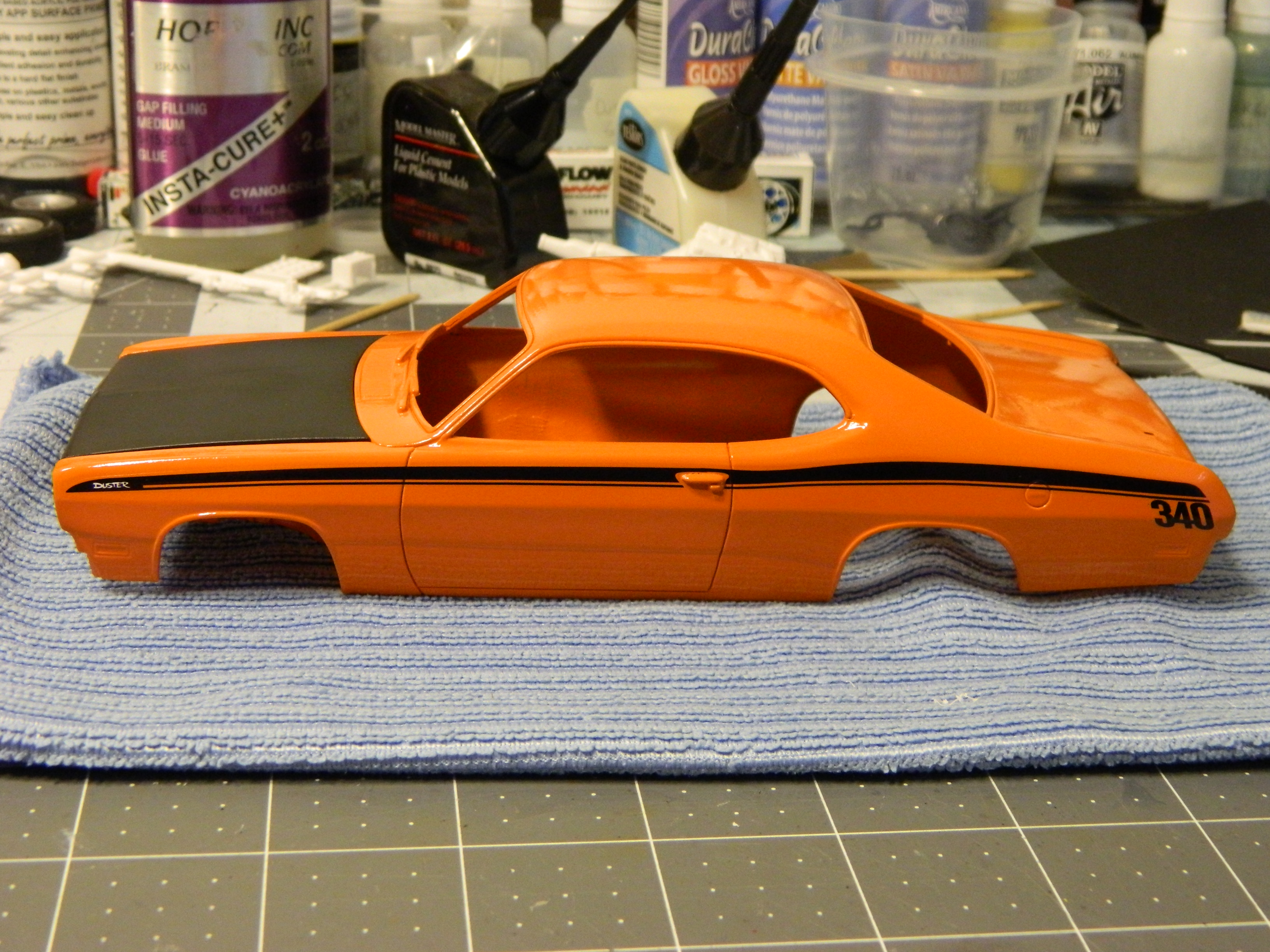

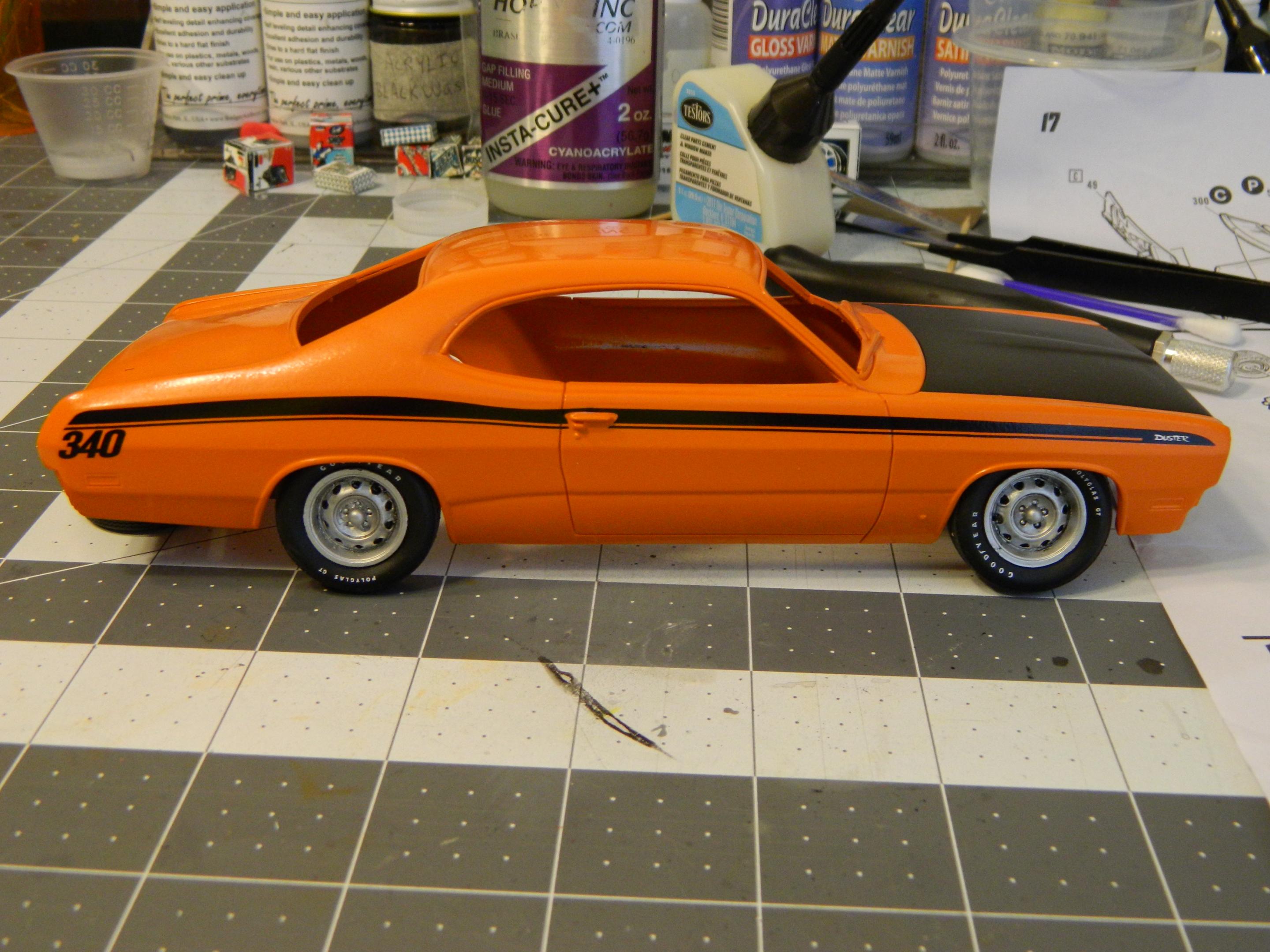

Dragonhawk1066 Posted June 18, 2021 Author Share Posted June 18, 2021 I went ahead and put the decals on this morning. Hopefully I can get the clear on tomorrow. A few days after that I'll tape off the areas for the cowl, around the door windows, and top of the fenders to be painted satin black, and then lay down some satin clear while it's still taped off. 1 Quote Link to comment Share on other sites More sharing options...
AmericanMuscleFan Posted June 18, 2021 Share Posted June 18, 2021 I love it Craig, this is one of my favorite Mopar high impact colors and it's a perfect match for this project. 👍 Quote Link to comment Share on other sites More sharing options...

slusher Posted June 20, 2021 Share Posted June 20, 2021 Great looking detailed interior. Real clean and nice work so far.. Quote Link to comment Share on other sites More sharing options...
David G. Posted June 20, 2021 Share Posted June 20, 2021 Beautiful interior and engine detailing, nice paint too. David G. Quote Link to comment Share on other sites More sharing options...

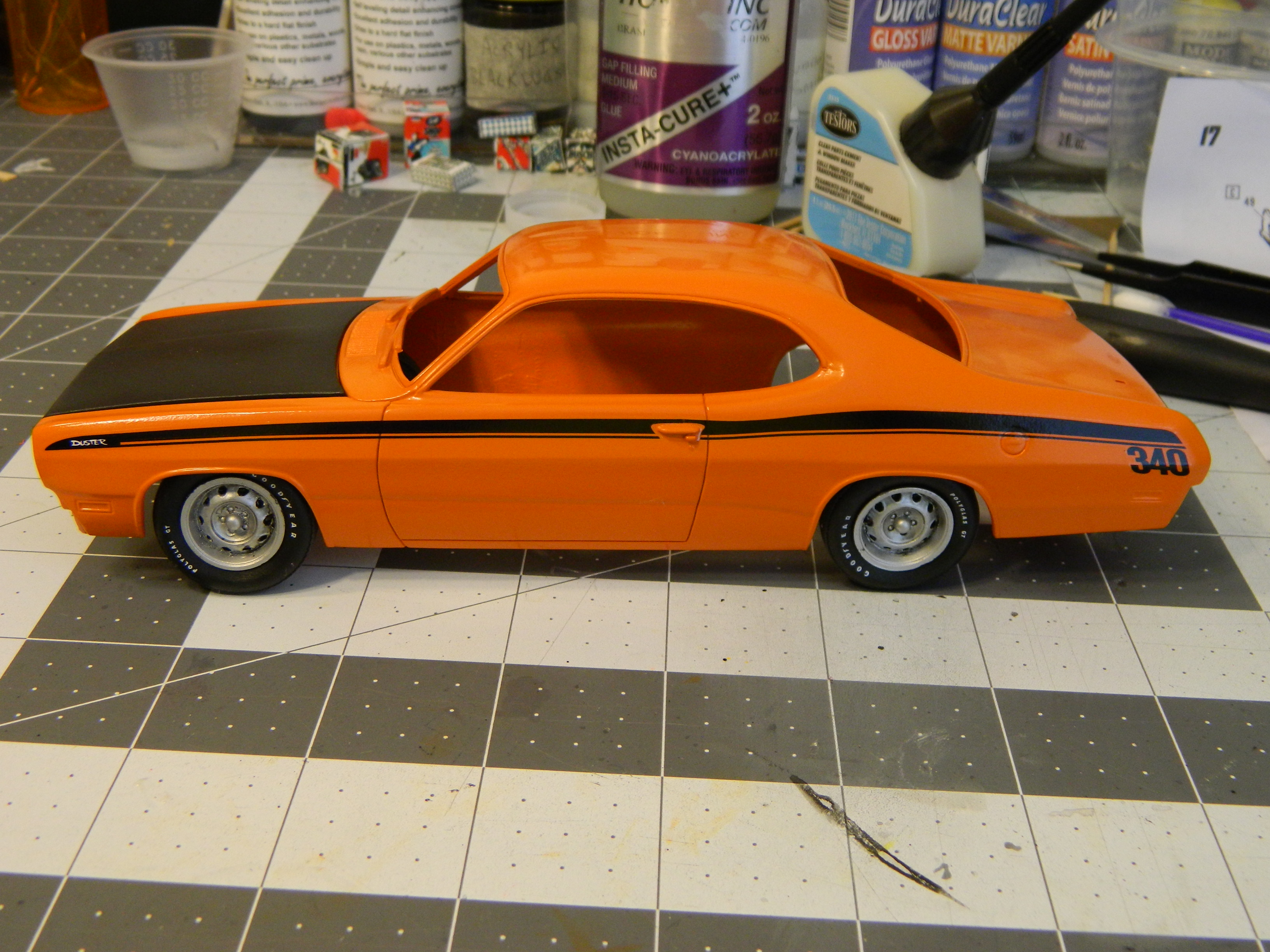

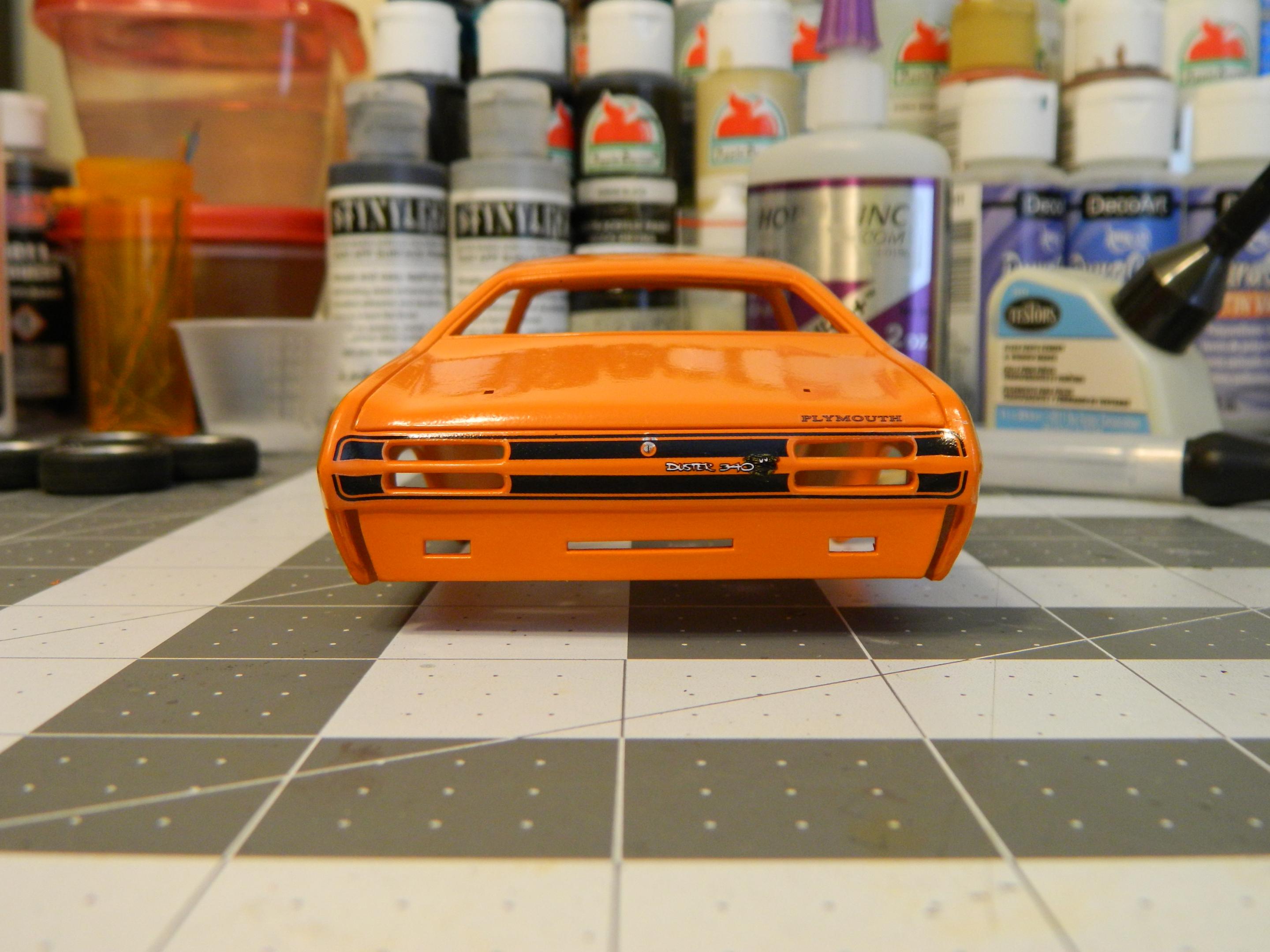

Dragonhawk1066 Posted June 21, 2021 Author Share Posted June 21, 2021 I got a nice little break in the weather yesterday and sprayed the clear on. I have to say it looks pretty darned good. I'll let it set for a couple of days before taping off to spray the black. Kind of makes me kick myself for being a little complacent on the '68 Chevelle I did before this one. I thought it looked good enough to not wet-sand the paint before clear when I really should have. Oh well, live and learn no more short cuts, but I'm very happy with it and very happy with this one so far. Quote Link to comment Share on other sites More sharing options...
slusher Posted June 22, 2021 Share Posted June 22, 2021 I think it looks fantastic! Quote Link to comment Share on other sites More sharing options...
