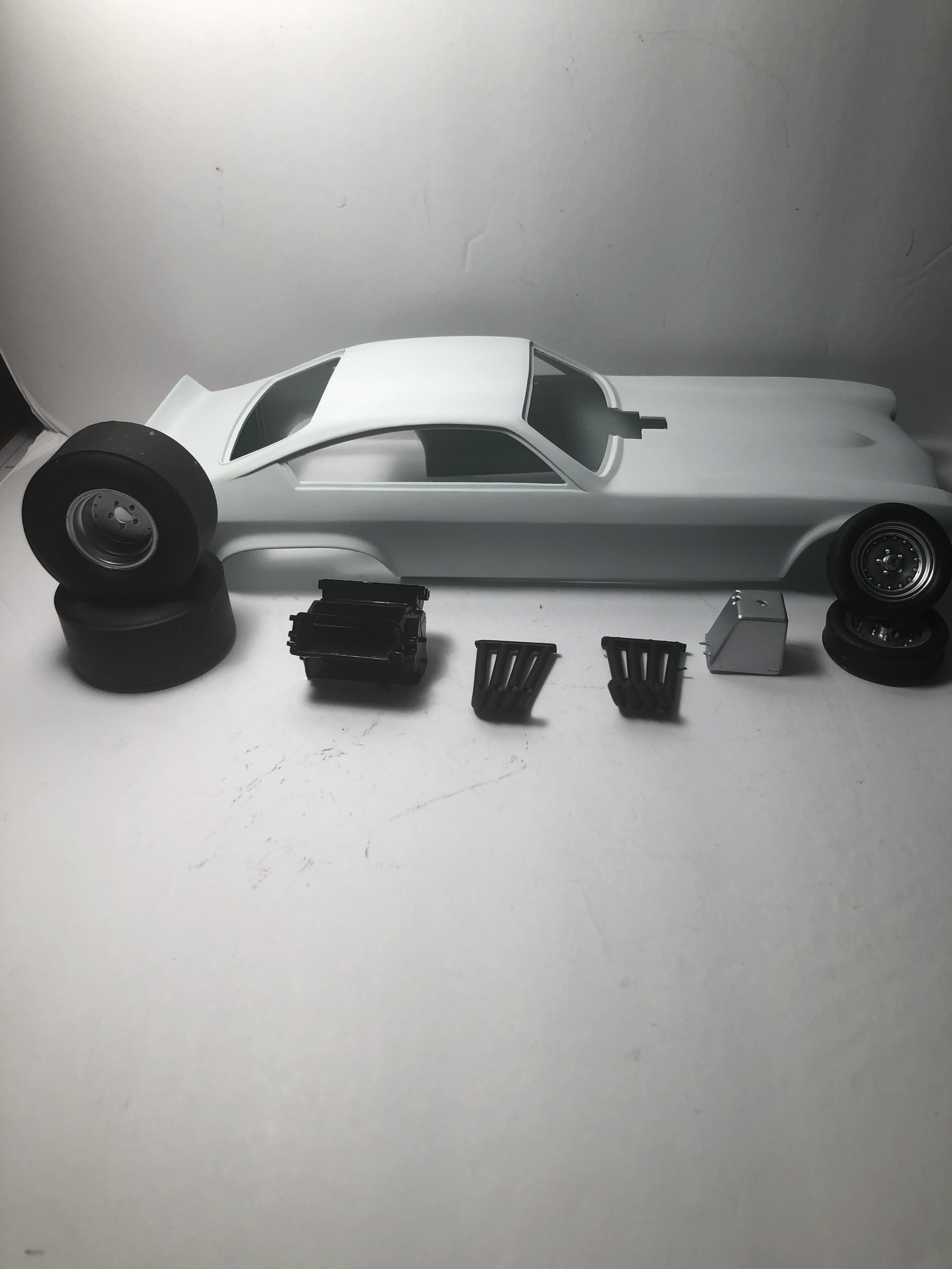

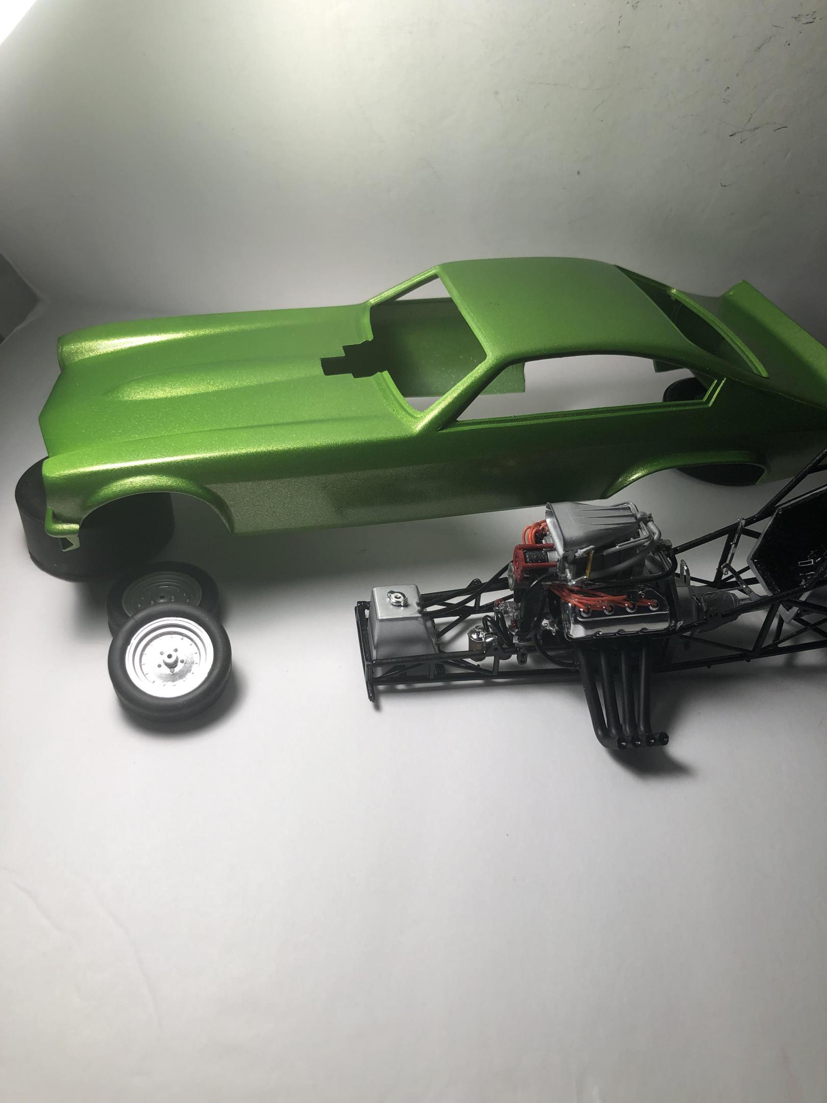

Just started this today so not much to show . Body cleaned and primed in white . Chrome wheels were treated to a coat of dullcoat . I’m sure I’m the end some colors may be wrong due to having info that doesn’t match . Will do as best I can but know some parts will be incorrect .

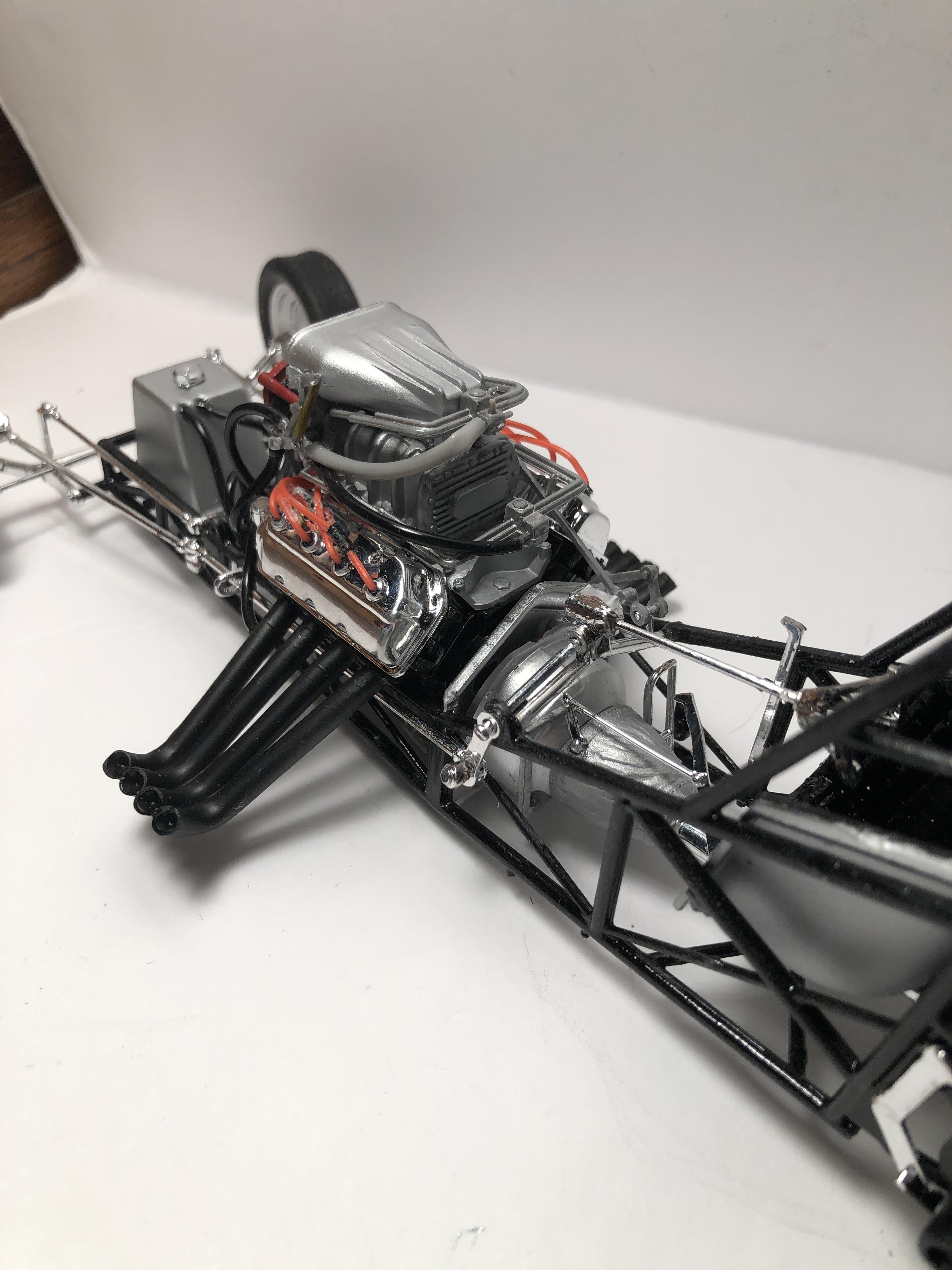

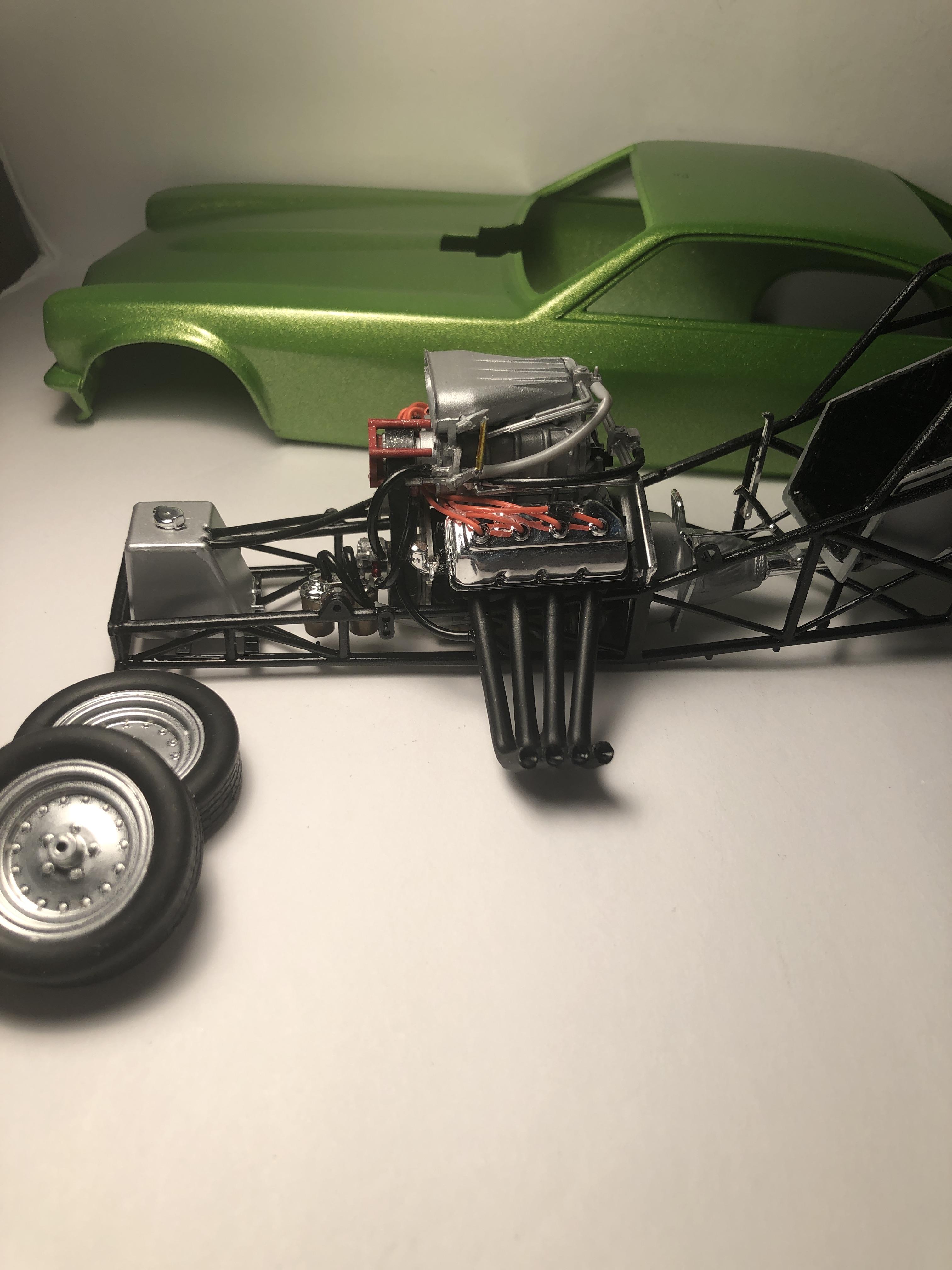

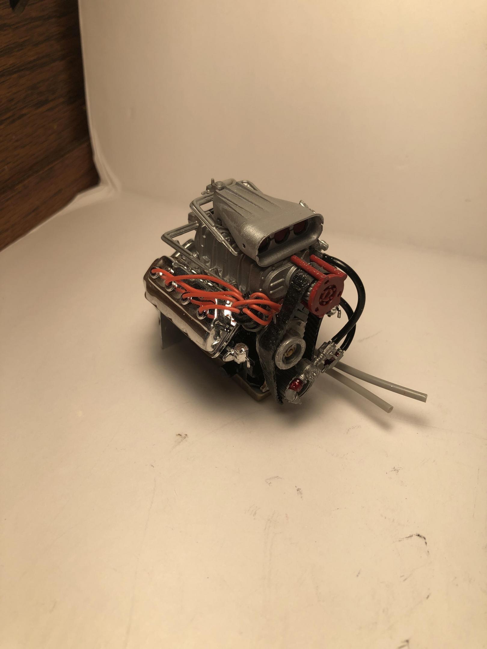

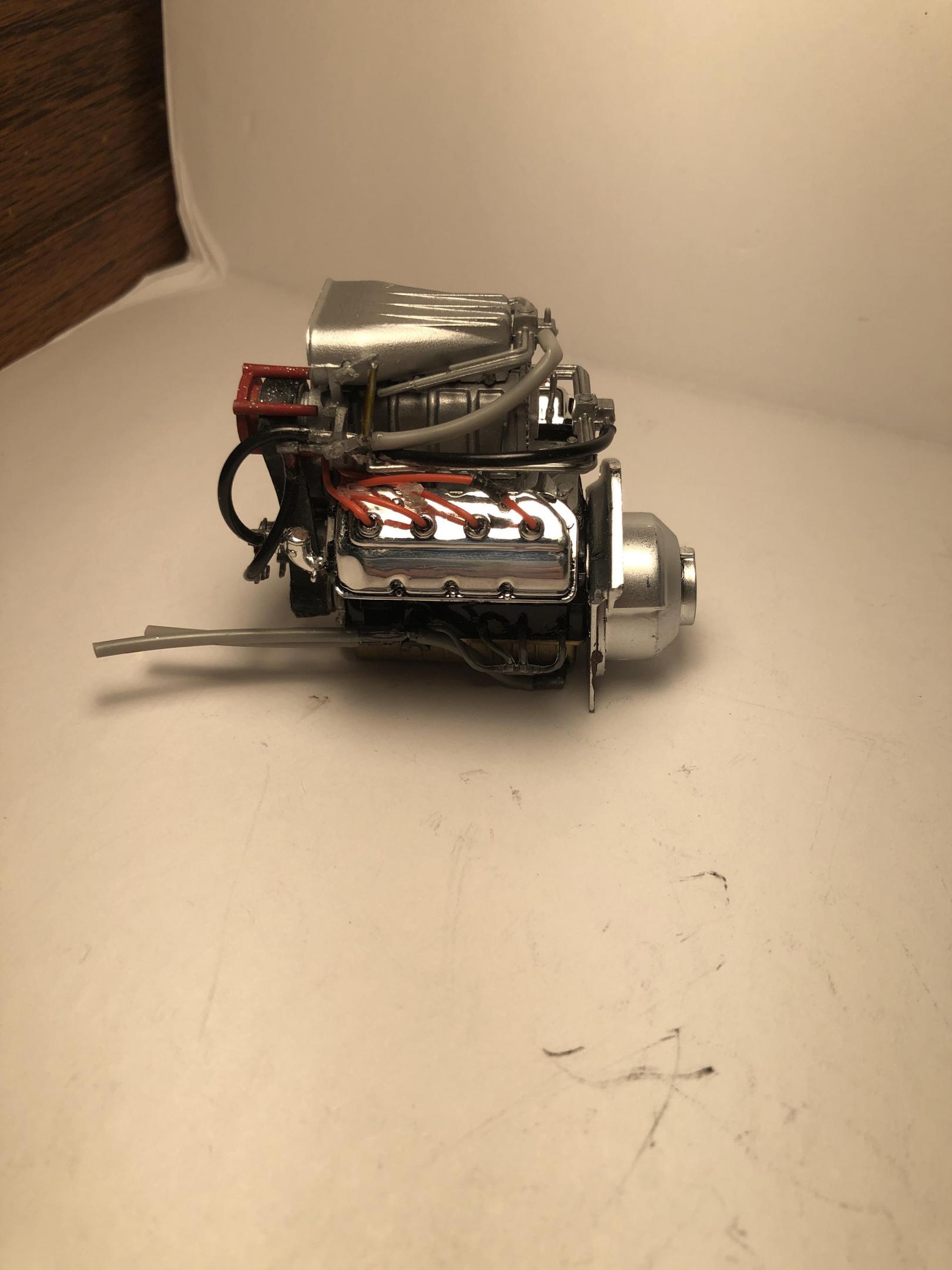

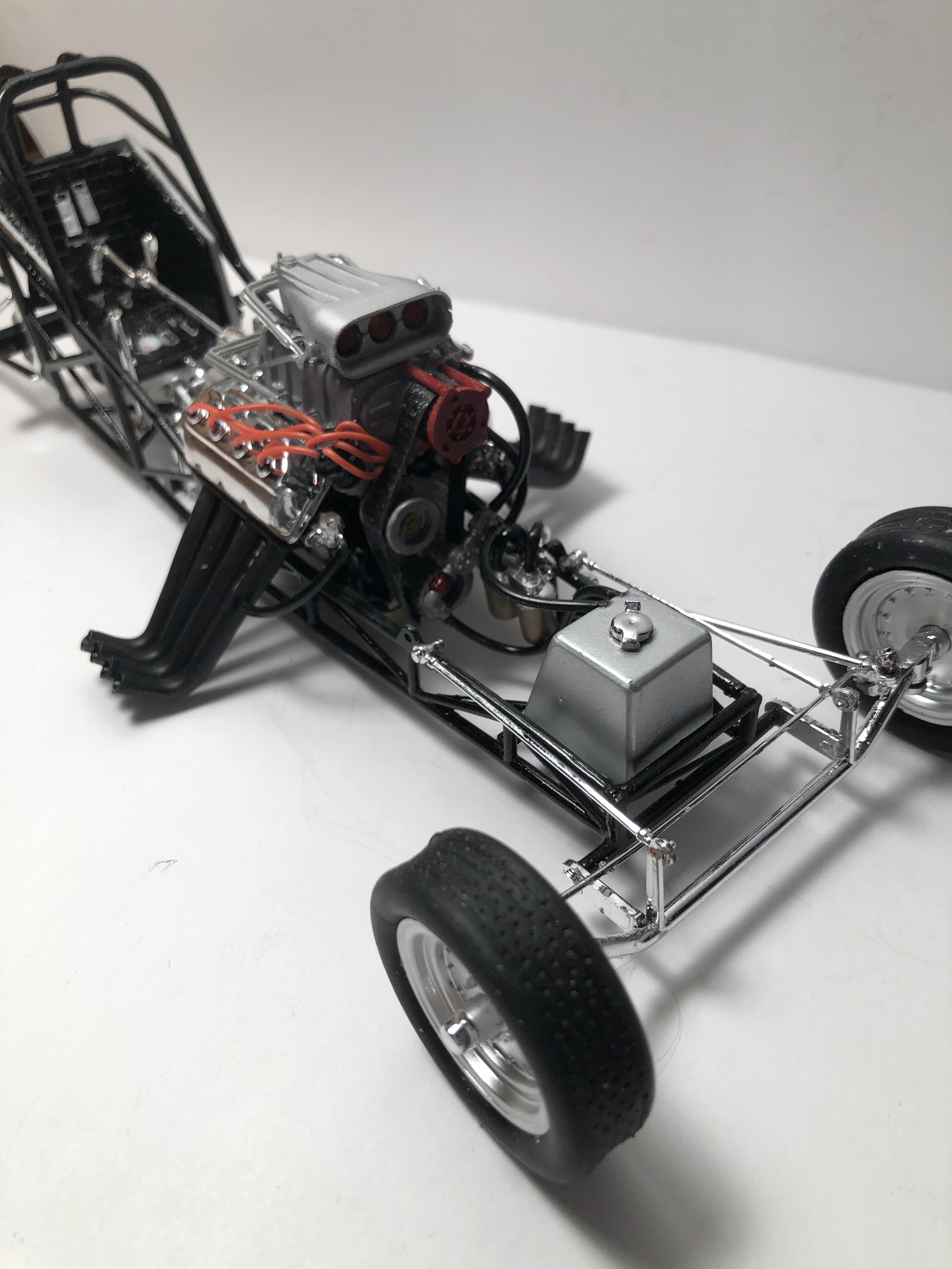

Ya know, the Lome Ice looks too light to me. I am partly color blind so there is that. Working on the engine now but need to locate a 1/16 pre wired aluminum distributor. The tube they give you in the kit is a joke. Anyone who could use that stuff and do a nice neat job of wiring the engine would get my full respect !
Link to comment
Not using much of the kit supplied hoses. To me they are too large and not very flexible. I'm using stuff I had on hand. Some may be a little out of scale but I believe better than the kit stuff.
Link to comment
You did a nice job on the engine!!  Smart decision NOT to use the kit supplies.
There needs to be a special place in hell for the guy (or girl) that came up with the plastic spark plug wires!!  I thought the Revell spark plug wires were bad!!  I think I will end up buying some from ProTech before this is all done!

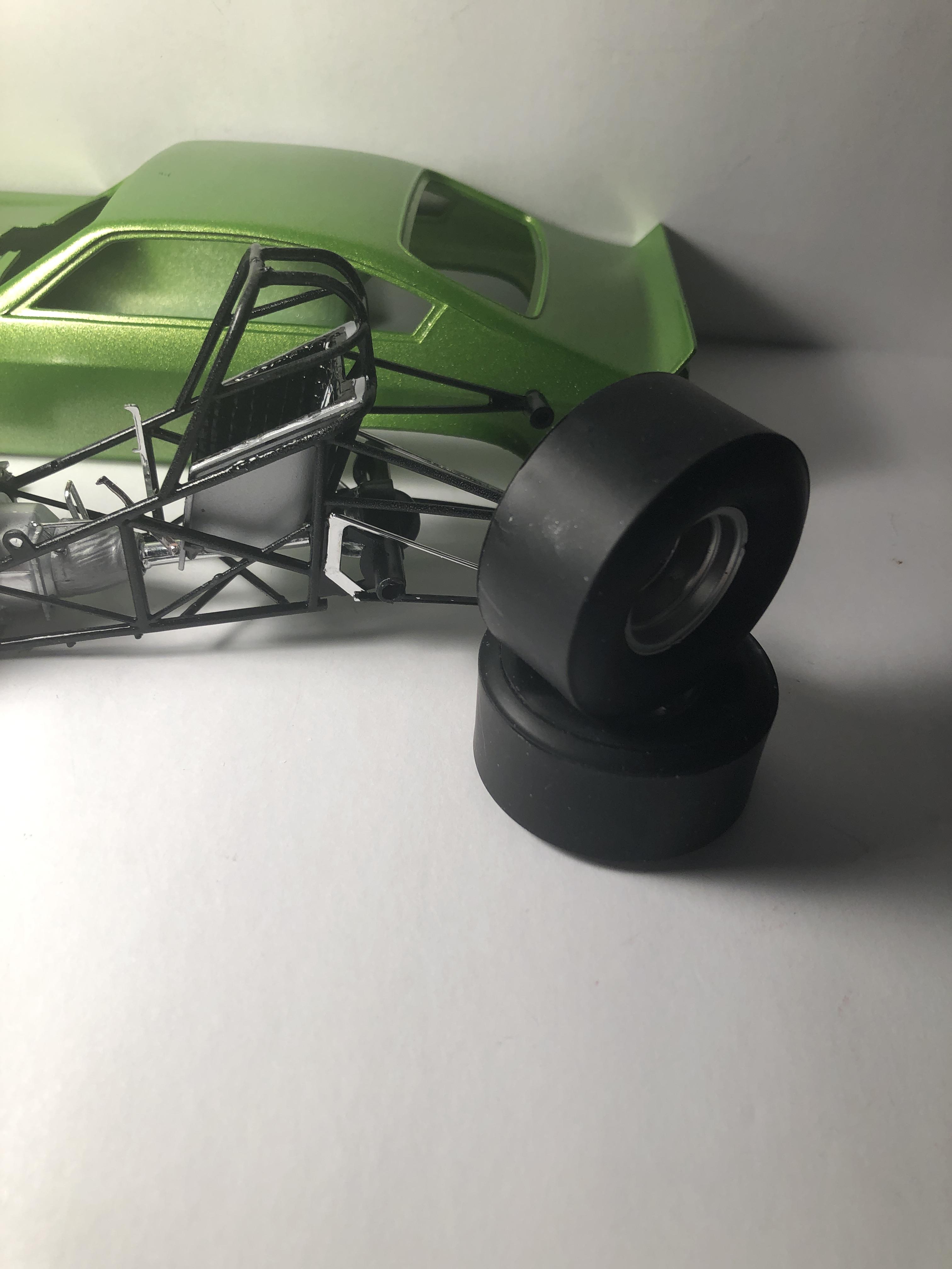

Made some more headway . Body almost ready for clear after some touch ups and then I will detail the bumpers . I did have a problem with some of the decals . They look great but I found them to be very thin and fragile . I messed up on a couple .
  • Like 1
Link to comment
5 hours ago, cobraman said:
No , the body is just sitting on the chassis and not at its final resting place . It will be lower when the body is actually mounted .
aaah, sorry that was me steps a head
Link to comment

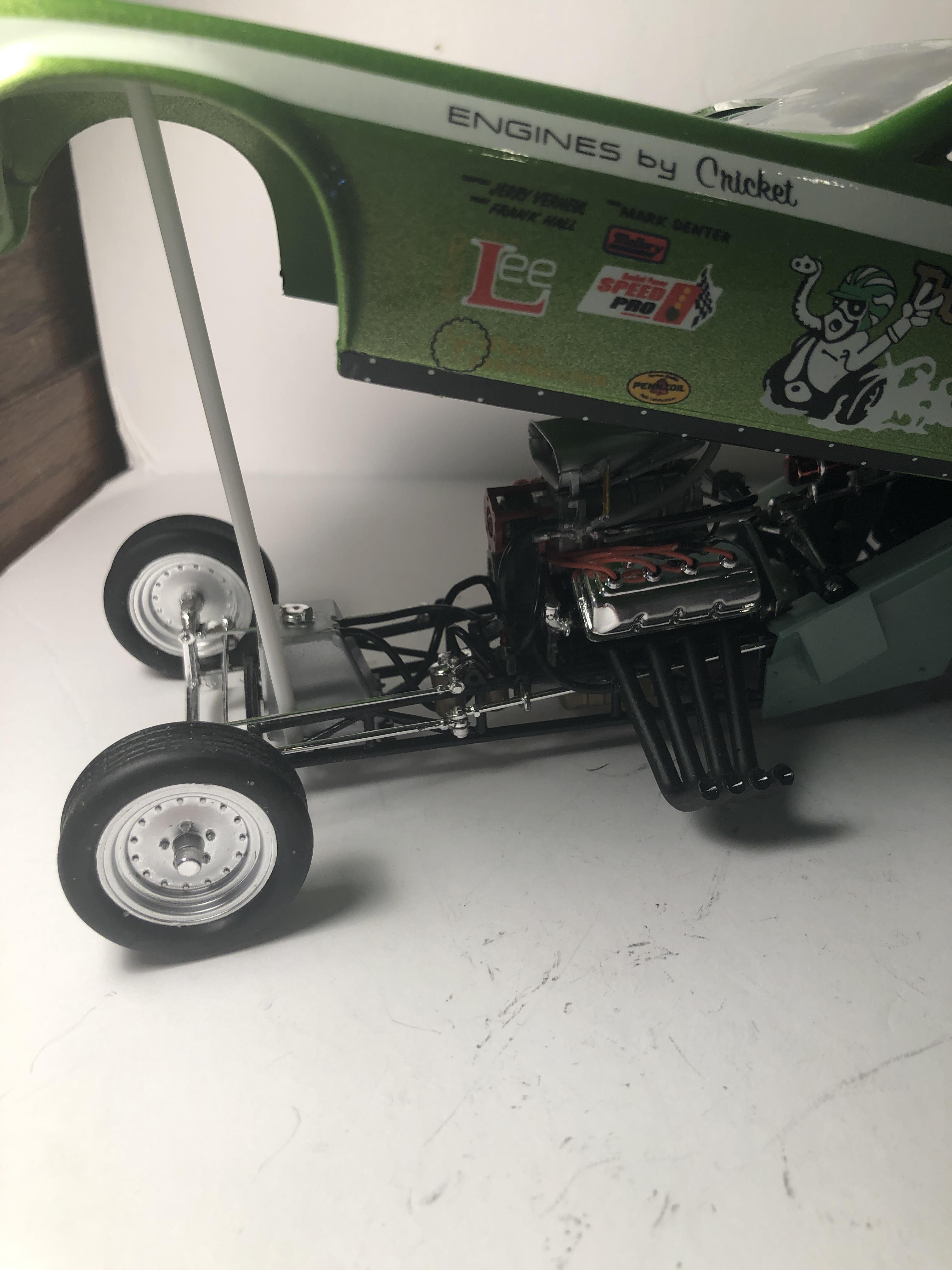

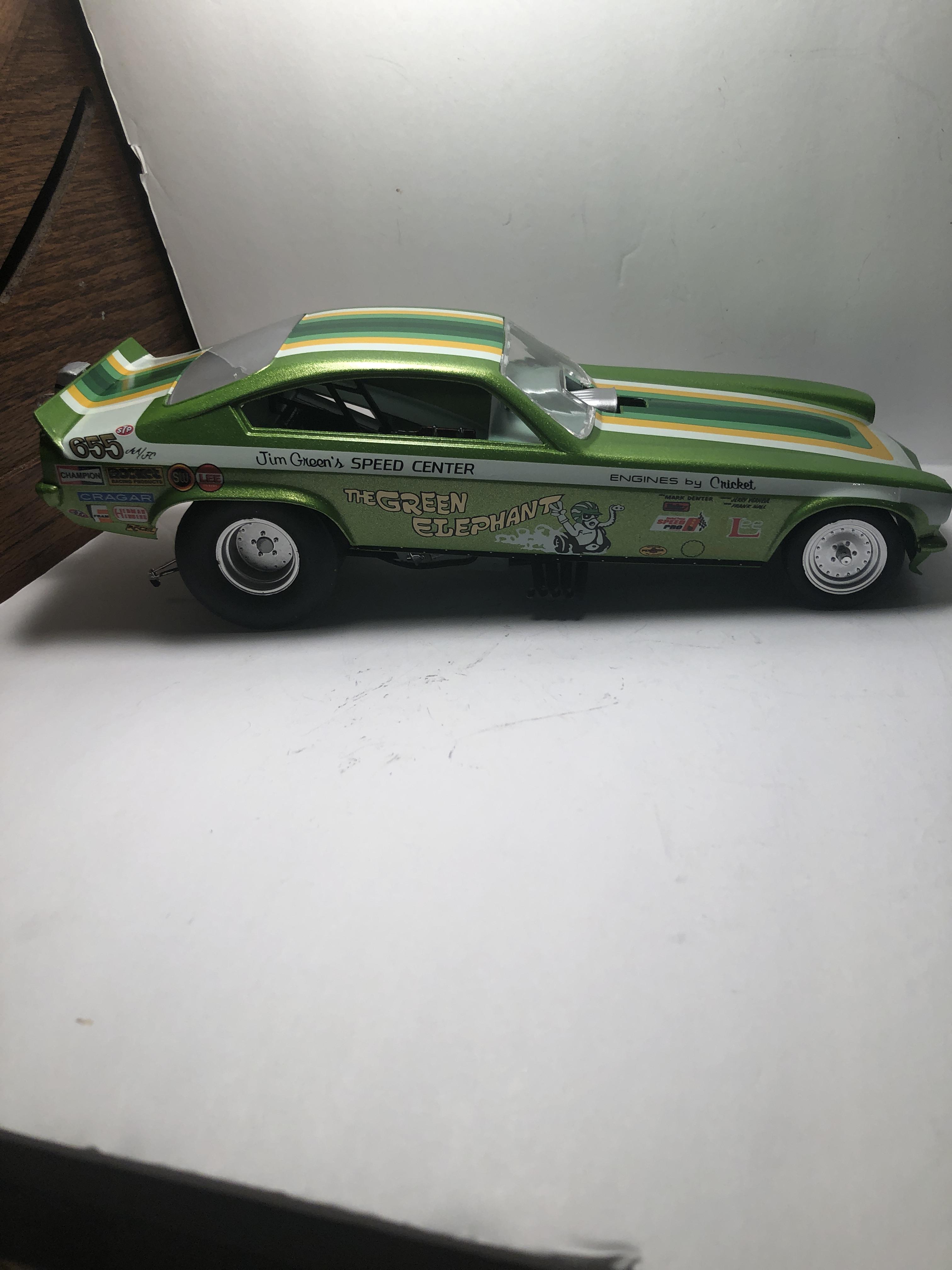

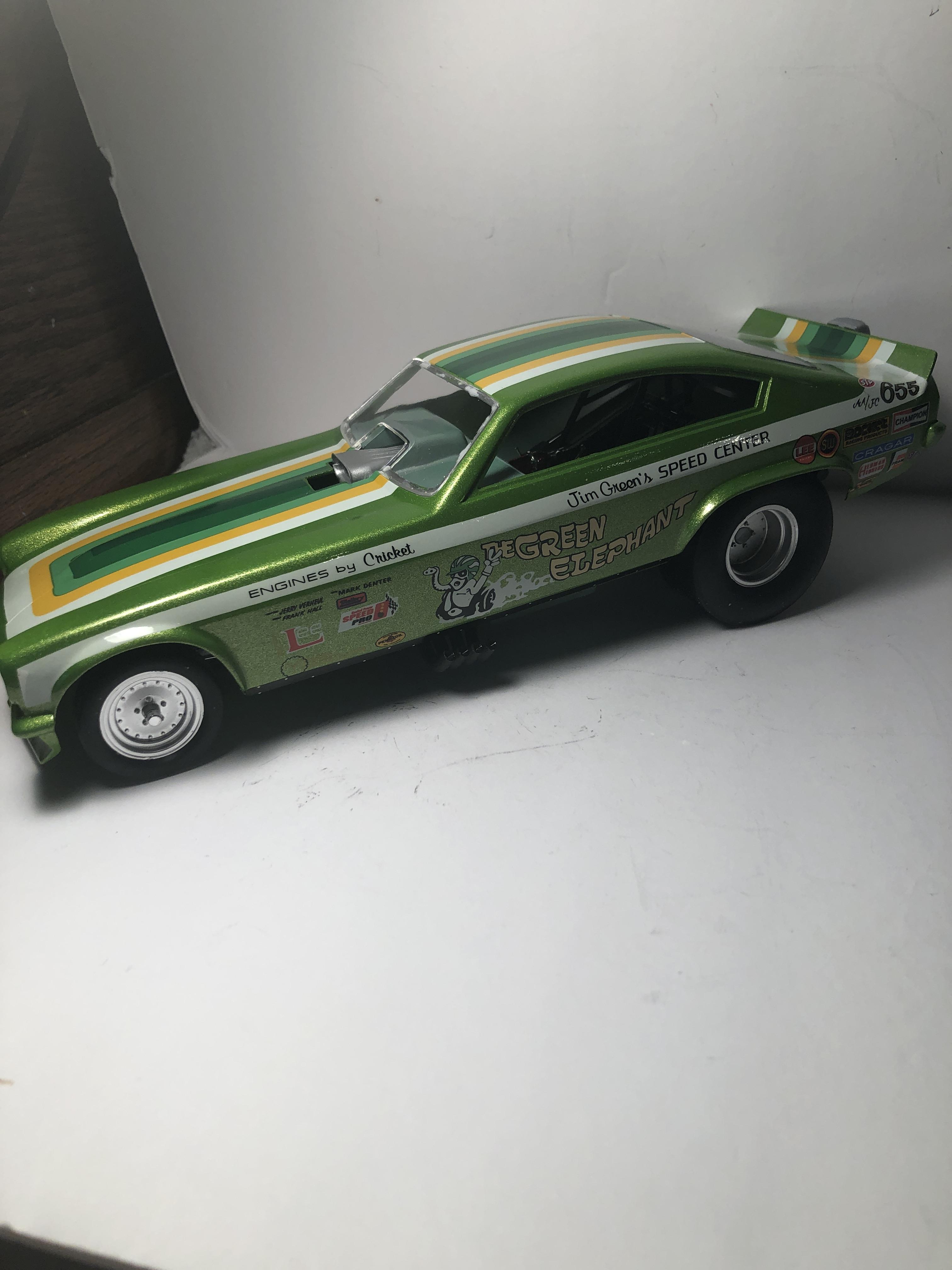

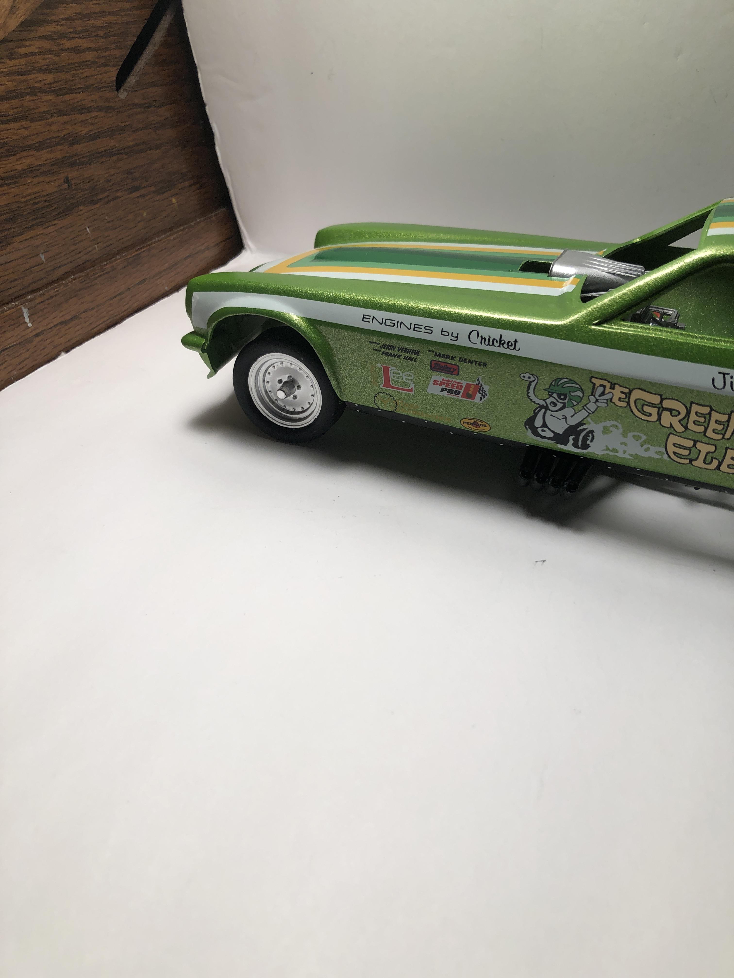

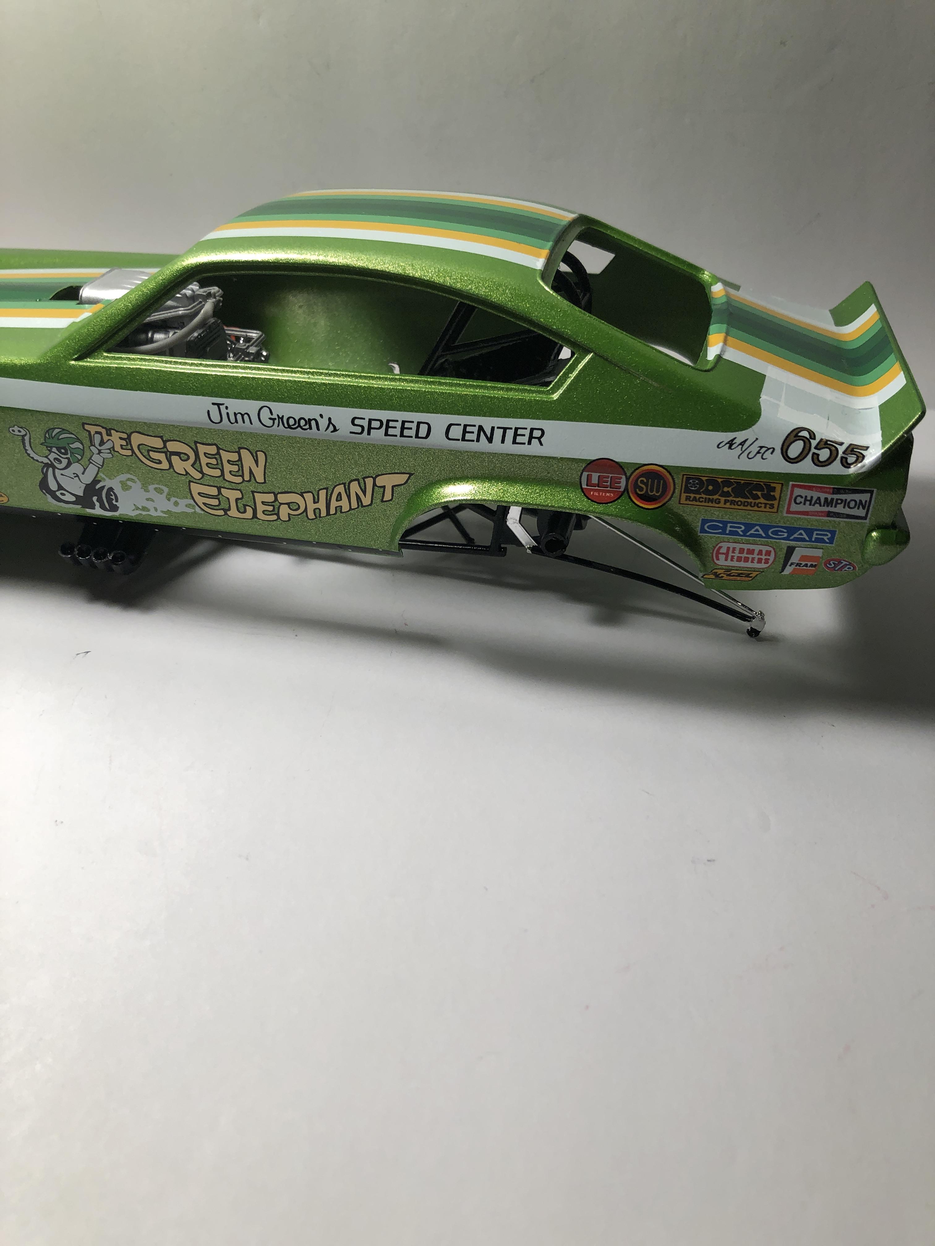

This one is almost done , probably tomorrow . I’m sure some colors are not correct . Three sources and they are sometimes at odds of each other . Maybe depends on when the car ran ?  Decals did fight me some perhaps due to the size or perhaps I just screwed up !  I will take better pics tomorrow as these are kind of dark .
