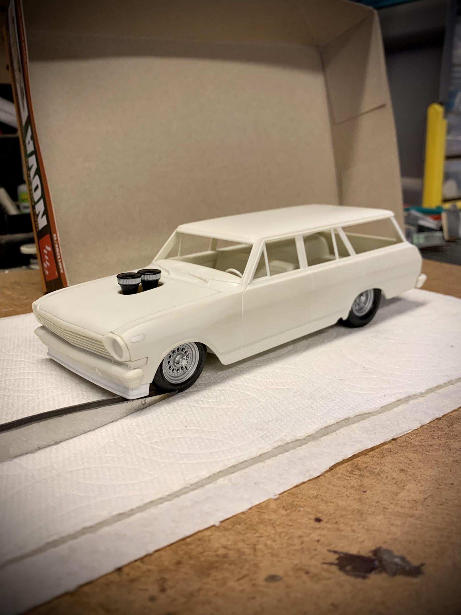

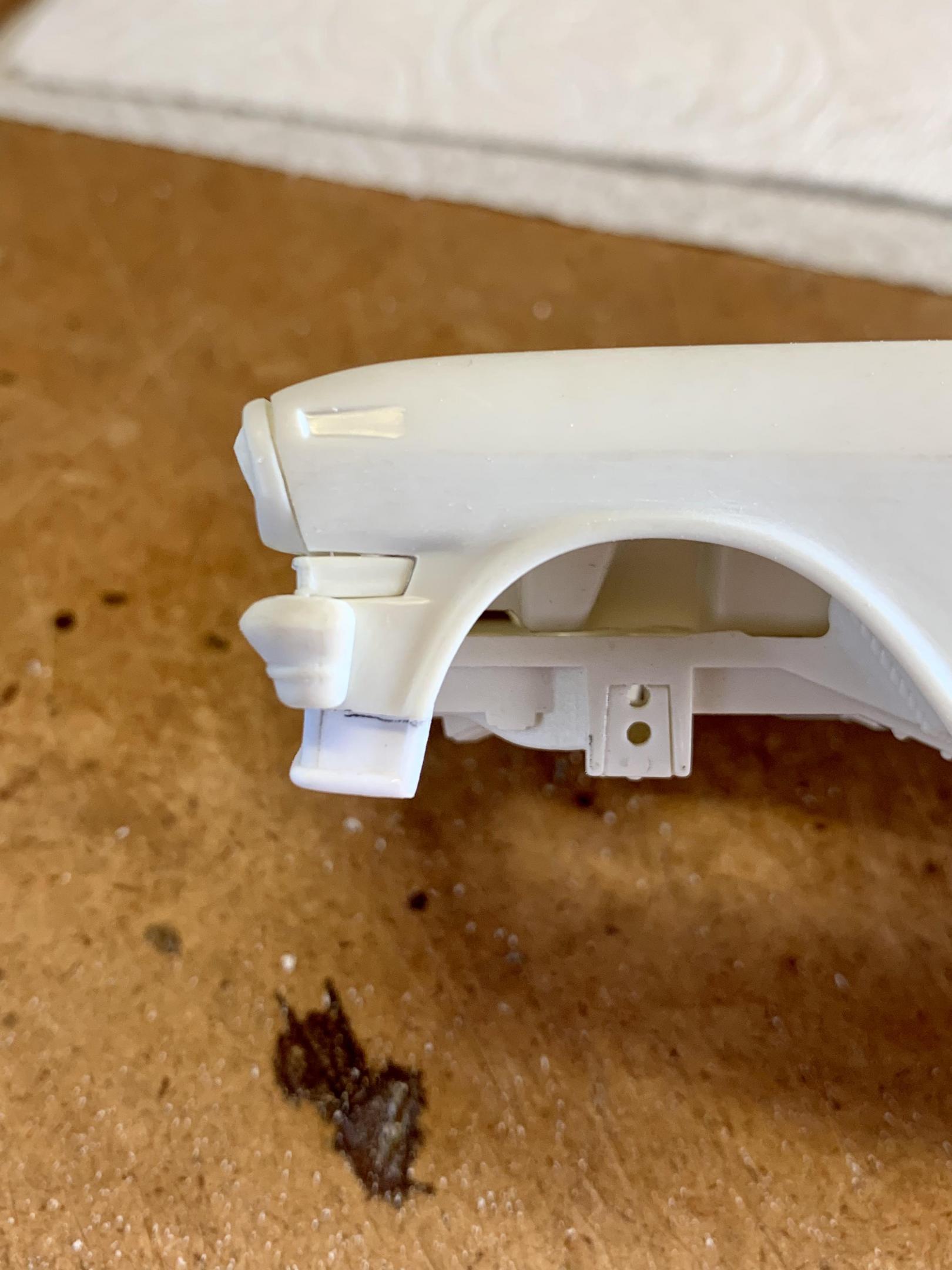

UPDATE!
 I had just enough time at the bench today to finish the rest of the exterior modifications.

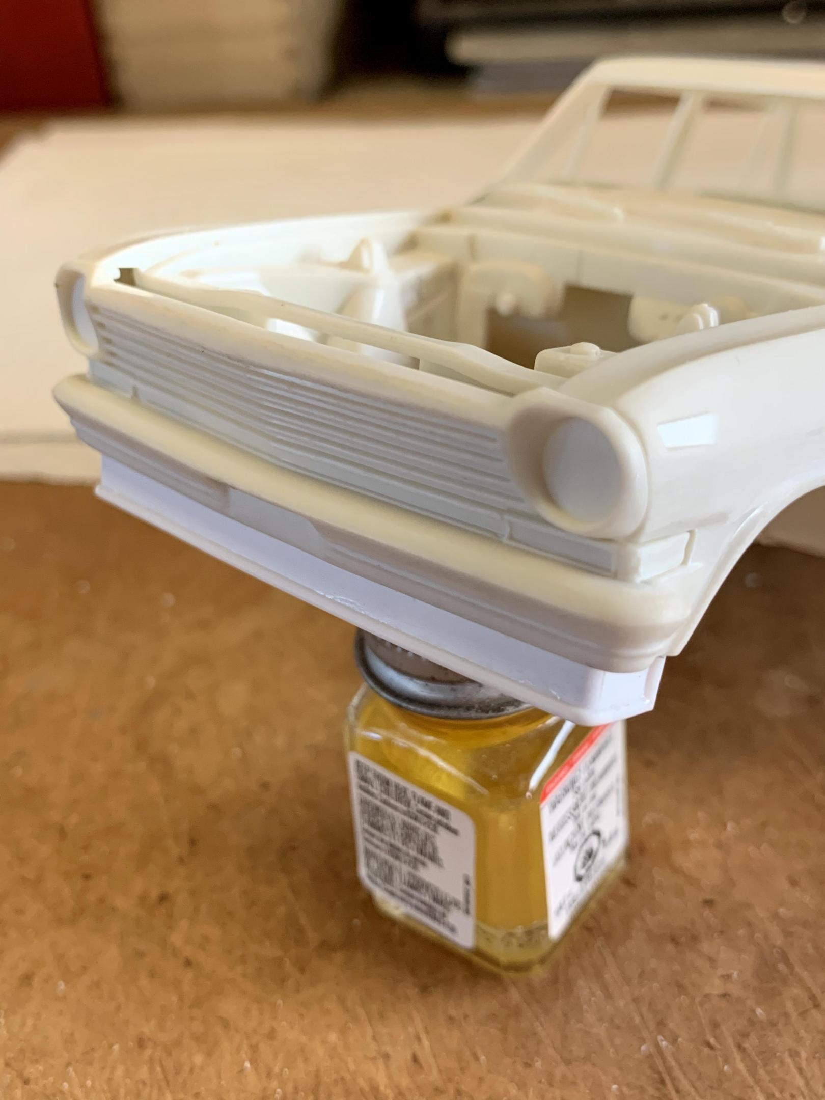

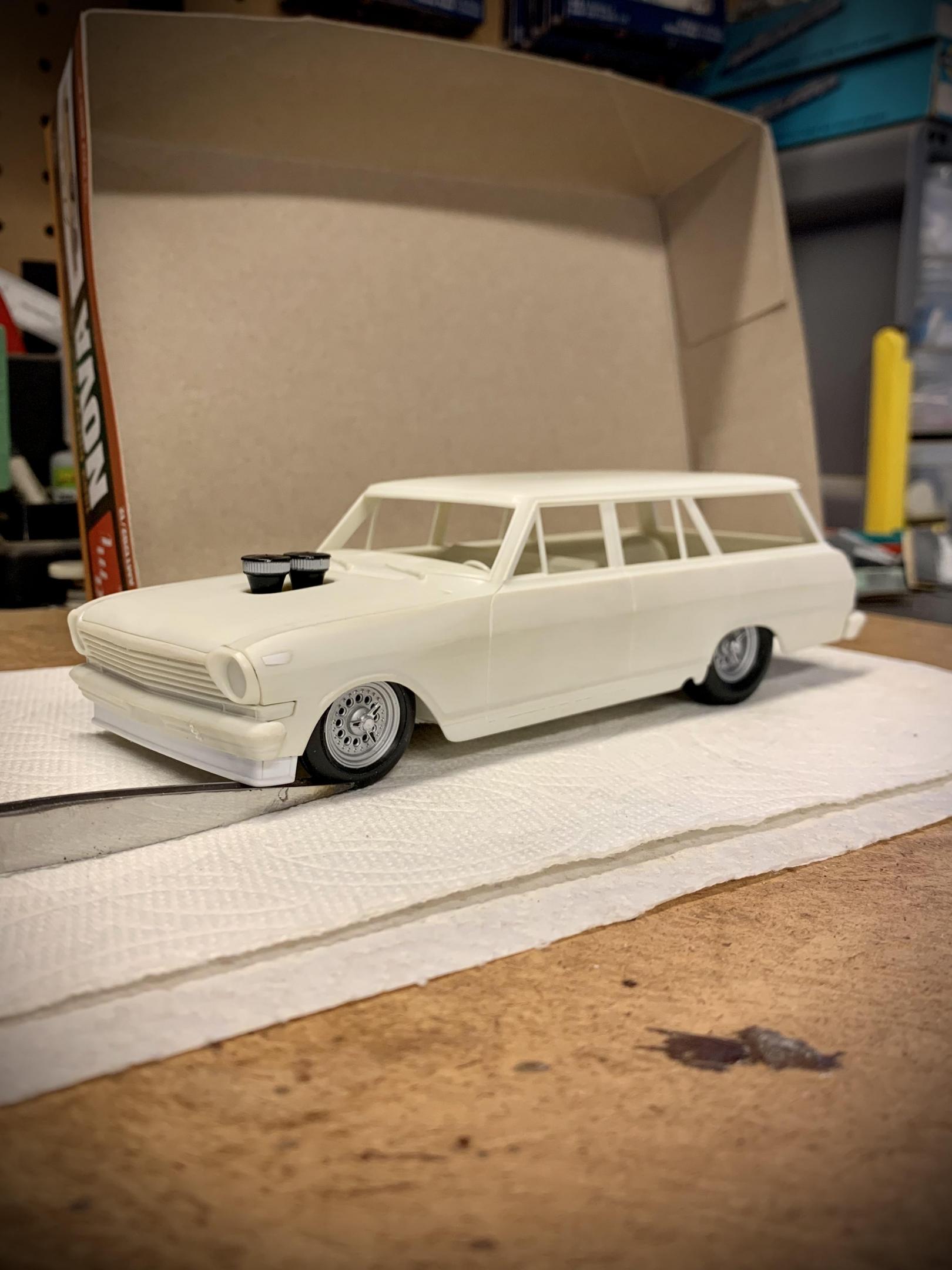

Every time I’ve had this model mocked up it’s occurred to me that there’s a lot of air below the front bumper, which is considerably higher relative to the rocker areas down the sides of the body. I decided that what the front end needed was an air dam to close the gap between the bumper and the table top.

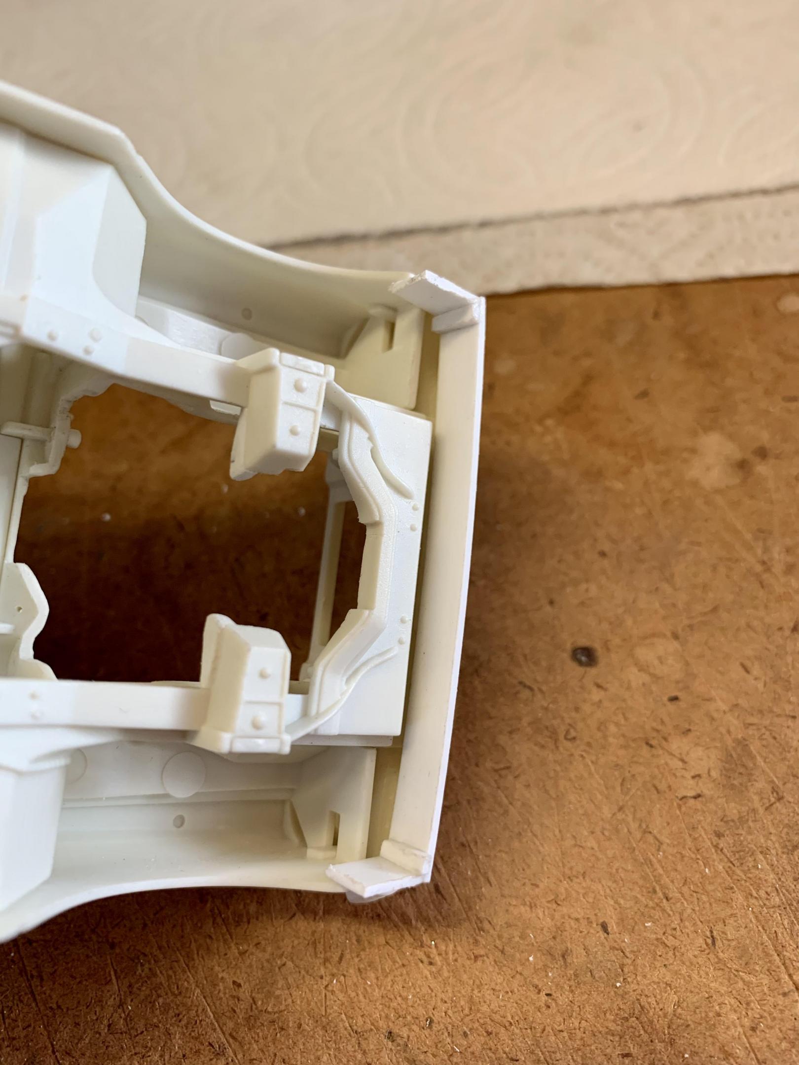

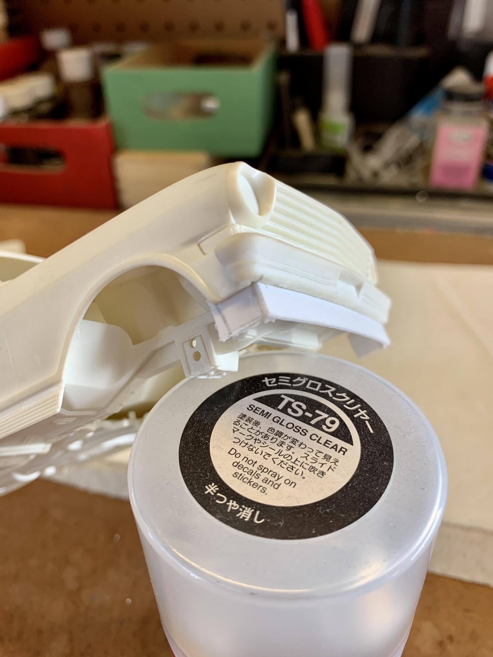

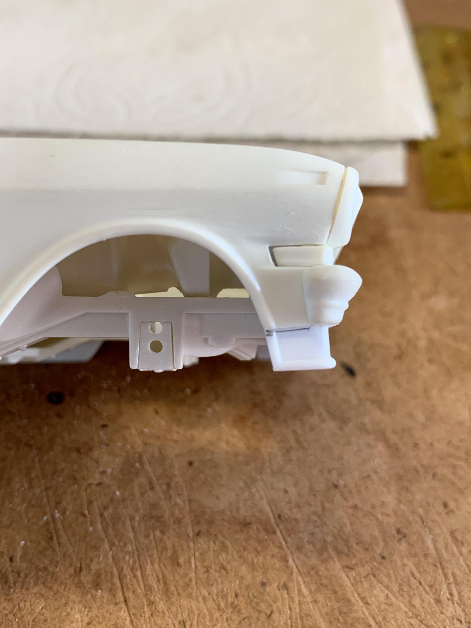

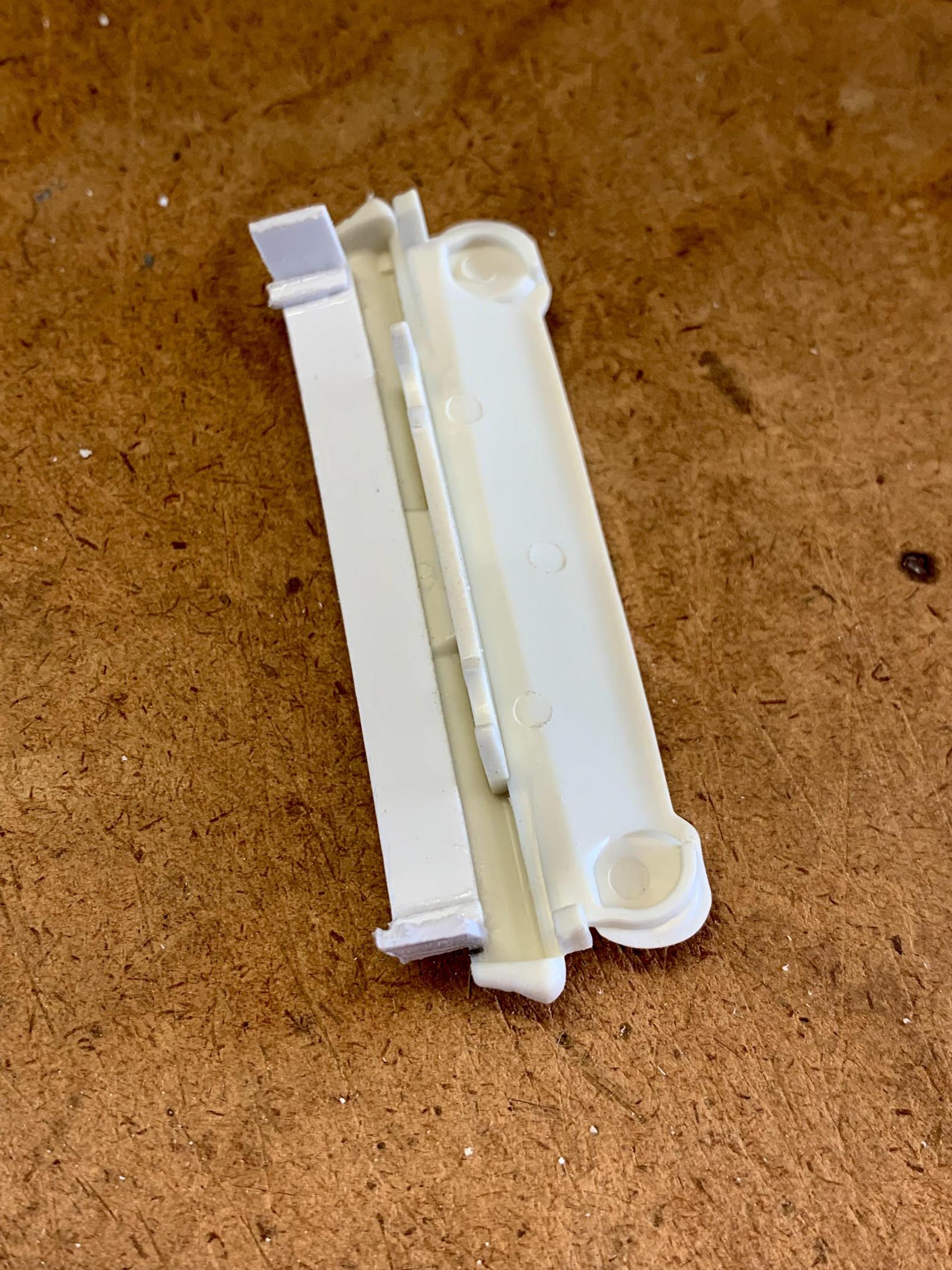

I started out with some .040” Evergreen sheet cut into a long enough strip that was 1/4” wide. I drew a line across the strip 1/16” down from one of the long edges and glued it the back edge of the bumper leaving 3/16” hanging down which is about 4.5” in scale. I then glued some 1/4” wide side extensions to the back edges of the dam, again with 1/16” up inside the front fender edges but I did not glue them to the fenders. This allows the air dam to come off with the bumper. I then added some strips to the inside corners for support.
With the basic shape and structure roughed  in I trimmed the edges of the extensions even with the wheel wells, rounded the front corners (another reason for the support strips in the corners) and then added a strip of .060” half round rod around the bottom edge and up the back edges of the extensions to match up with the raised bead on the wheel opening of the fenders.

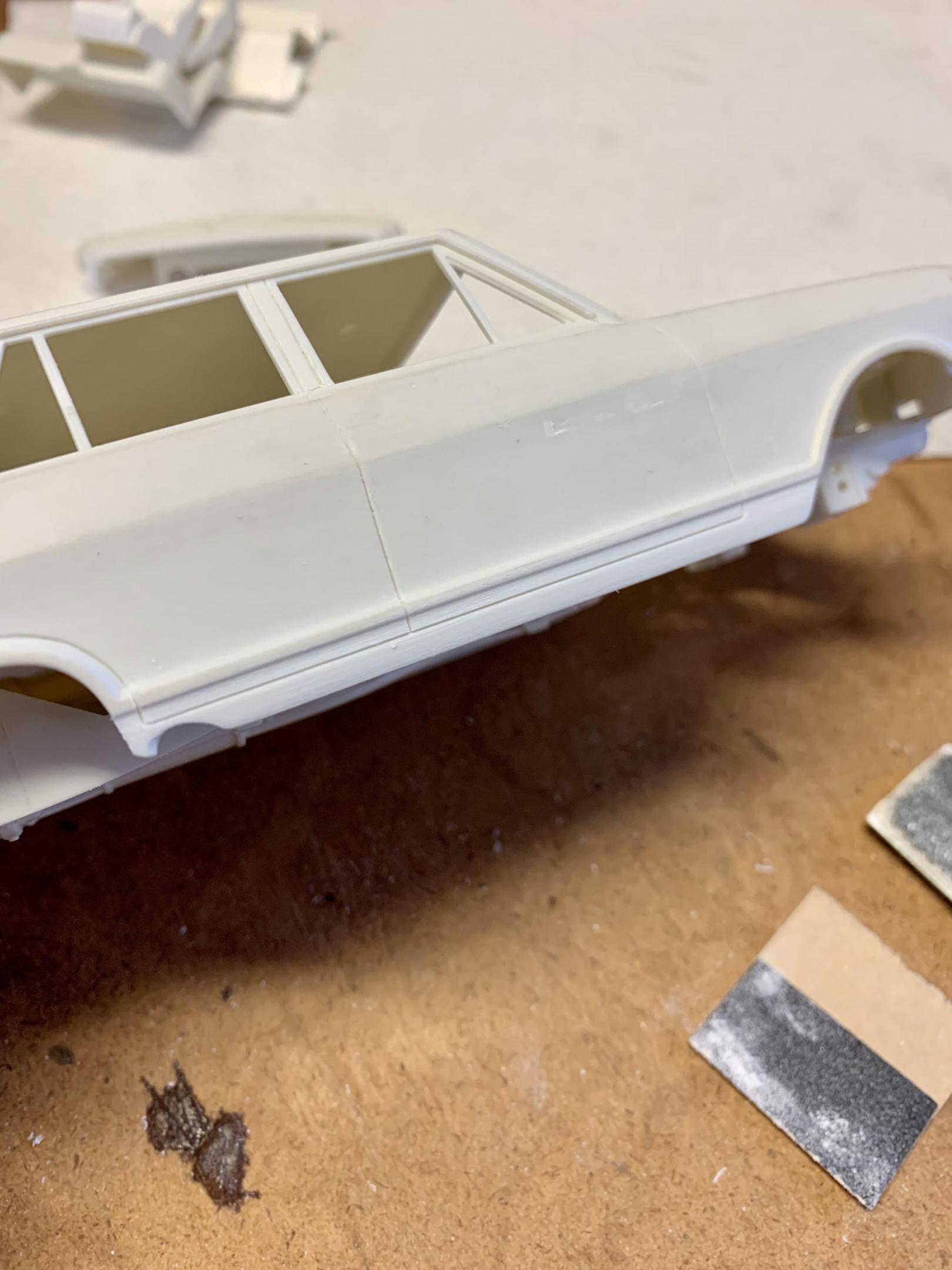

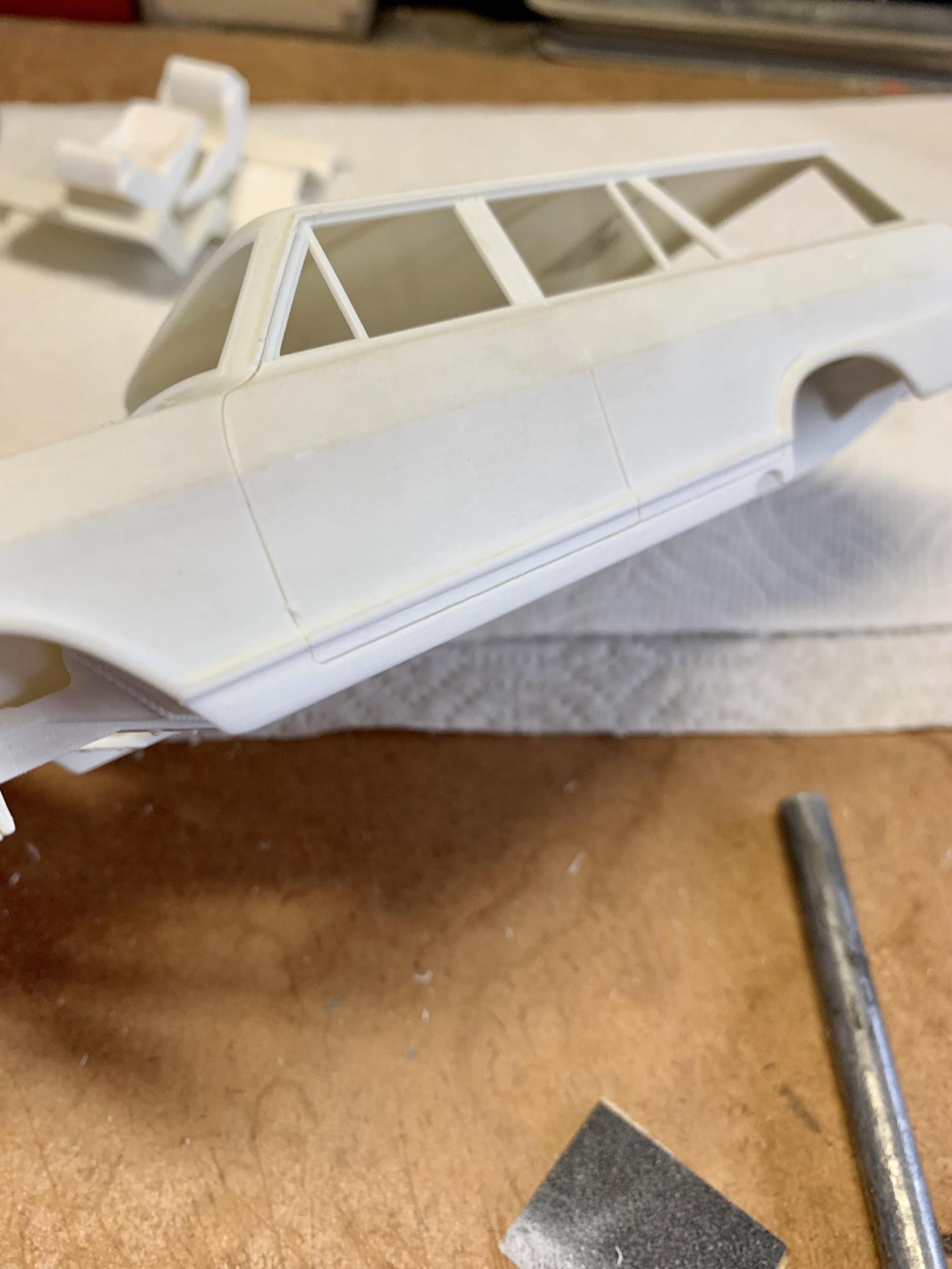

From there I scribed all of the door lines deeper with the back of a #11 blade then sanded away all of the ribbed rocker trim.
Lastly I filled the little depressions in the fenders behind the headlights since the rear of the body is smoothed out.

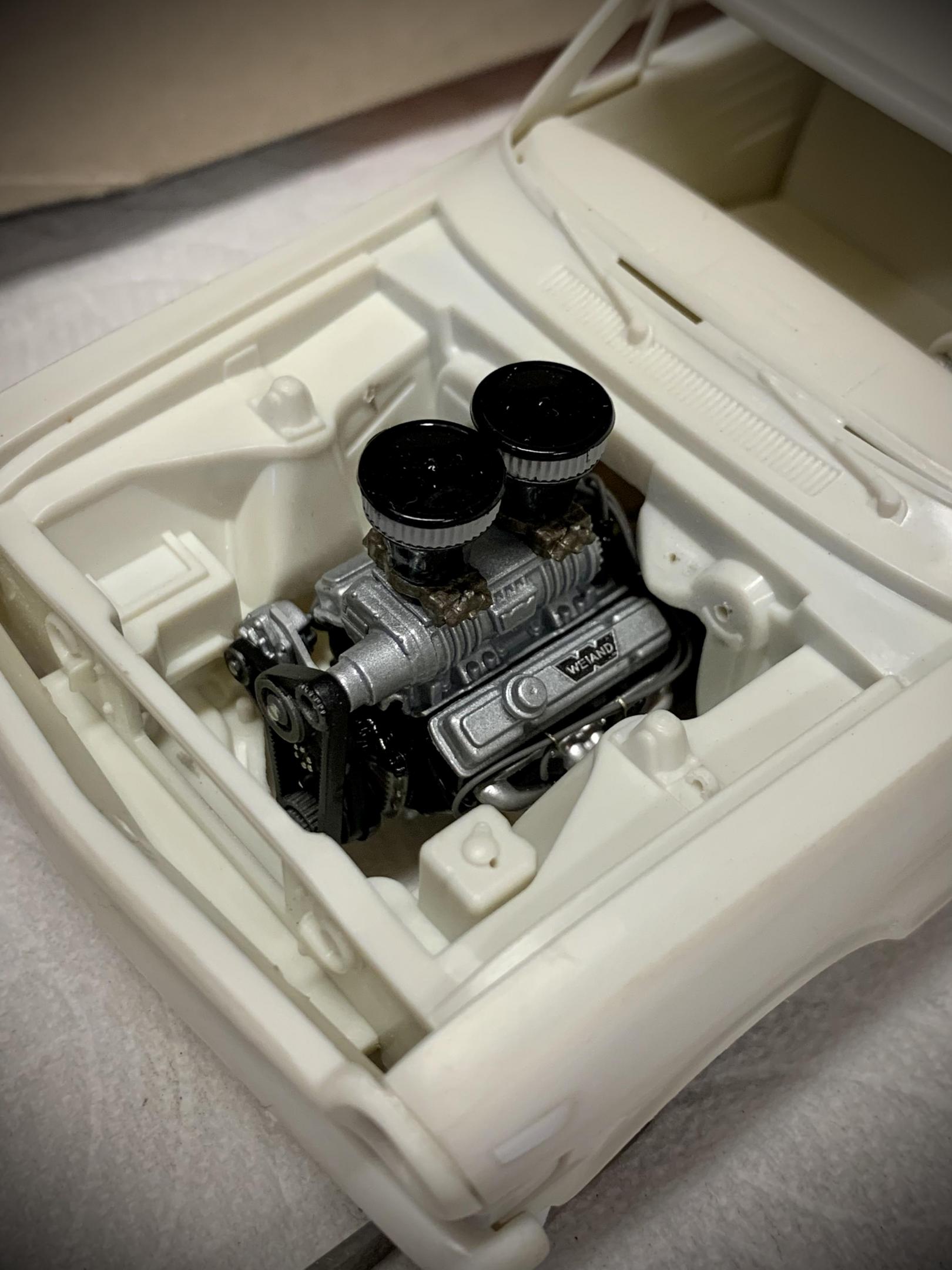

And some final mock ups with the finished exterior modifications. I set the finished engine in because the air filters sticking through the hood are a significant design element. I really wish I had hung the exhaust system for the full effect. I’m very happy with the addition of the air dam and how much aggression it adds to the car.
At this point the body and other exterior parts are ready for final clean up and onto primer. Next I’ll be focusing on a major update to the interior to bring it into the early 90’s with the rest of the car. Stay tuned!

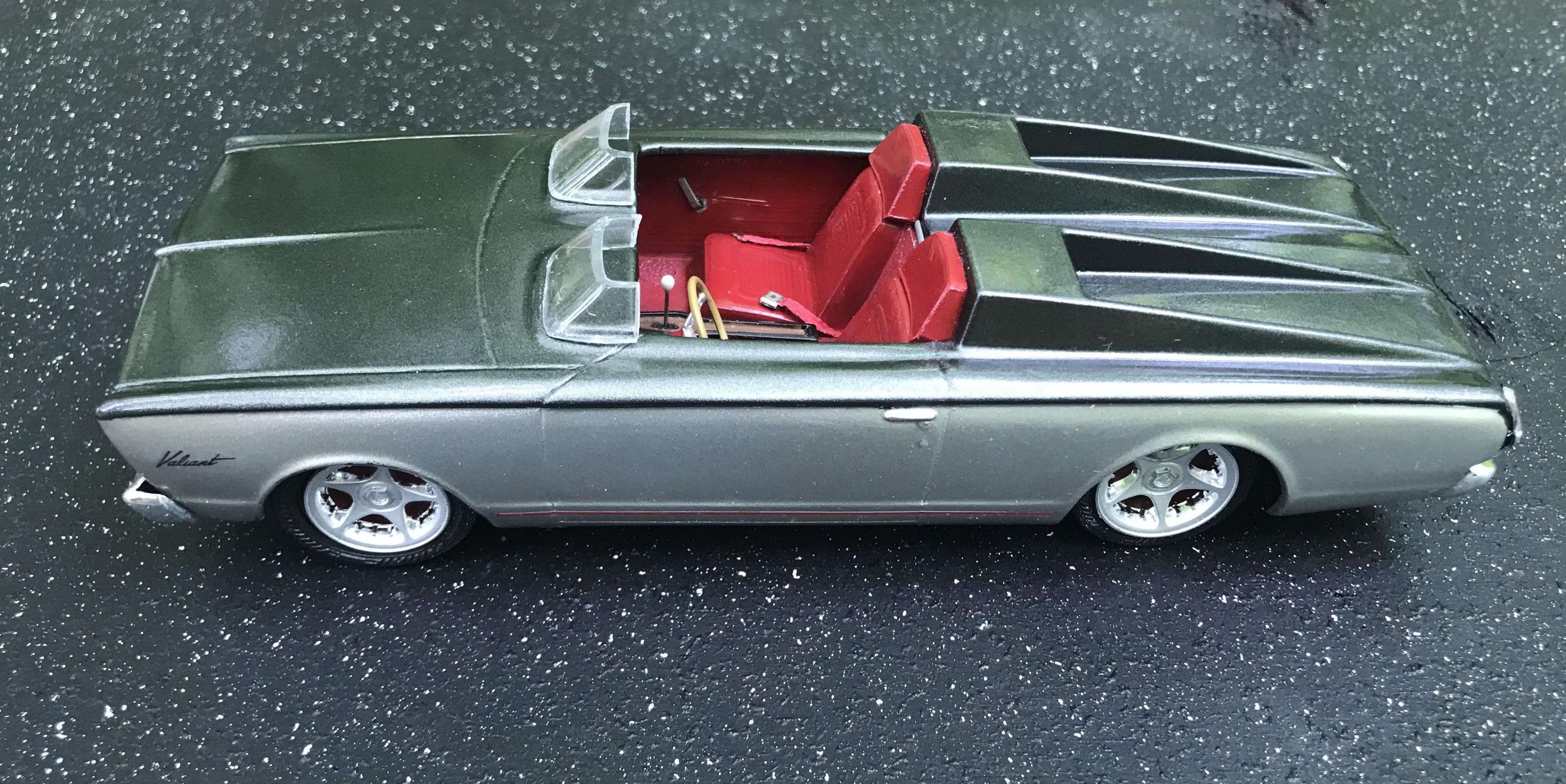

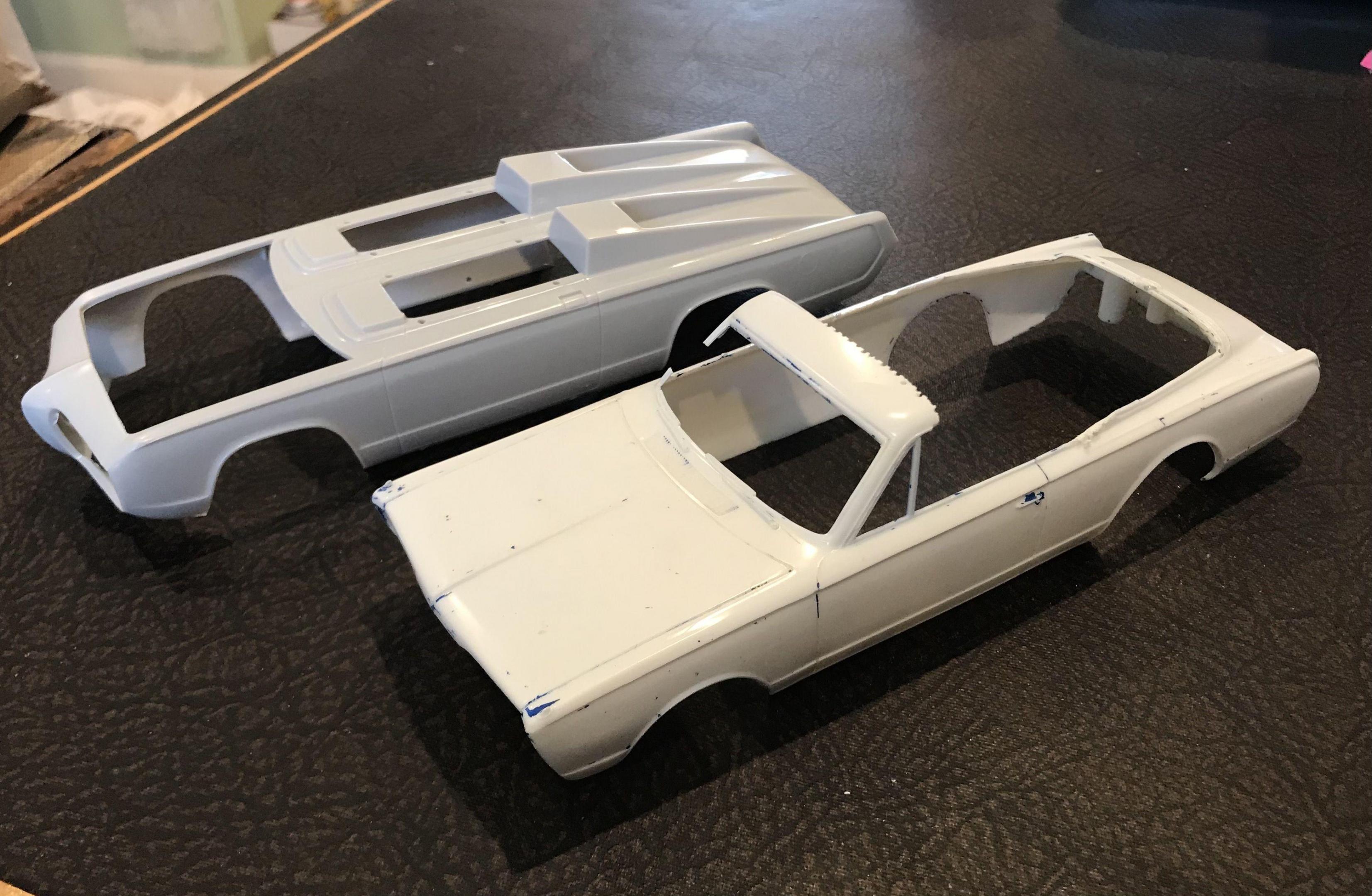

I get ya Dennis!  Still, repops open a world of possibilities.  Both the Hemi Under Glass and Fireball 500 were once $200 kits.  In fact I once had a dealer offering a Fireball 500 and Little Red Wagon for $200 each.  I offered him $300 for the pair and he started yelling at me!   Above is a photo of a repop Fireball 500 body and an original HUG I had with a broken roof.
And at $200 a kit, I wouldn't have built this one!
