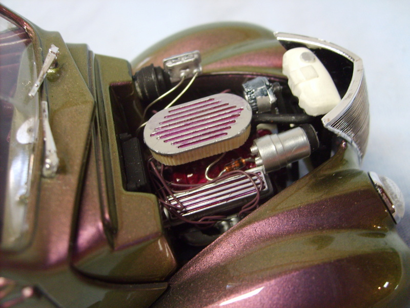

No sir, nail polish is not acrylic,  it is lacquer. Thin it with lacquer thinner to the consistency of 2% milk. Your base will heavily affect the final color as nail polish is translucent.  It will take a number of coats to get your desired depth of color.  This 37 Ford was painted in a flip flop nail polish with gray primer.  Duplicolor primer should work fine.

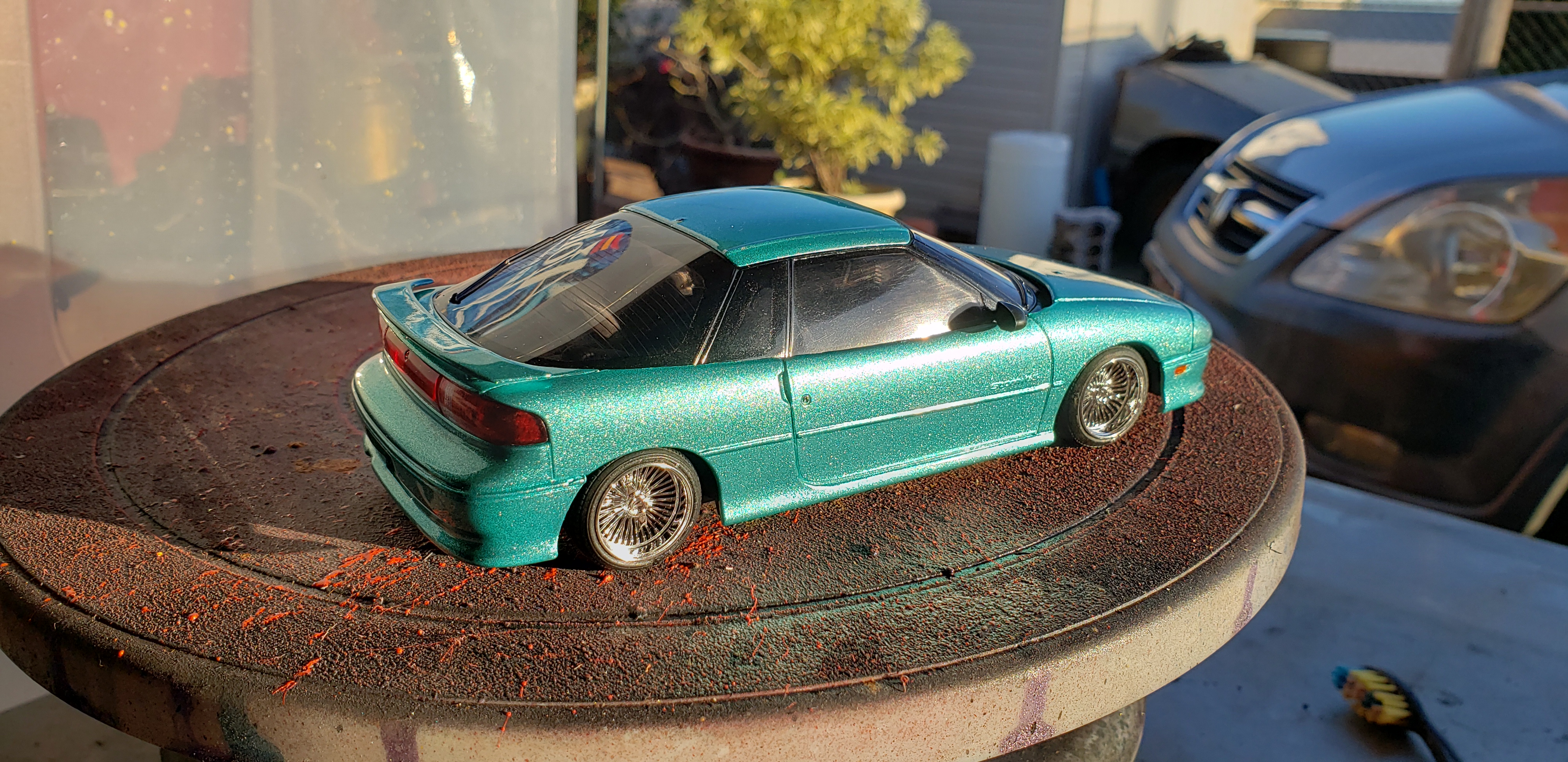

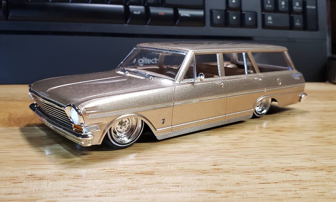

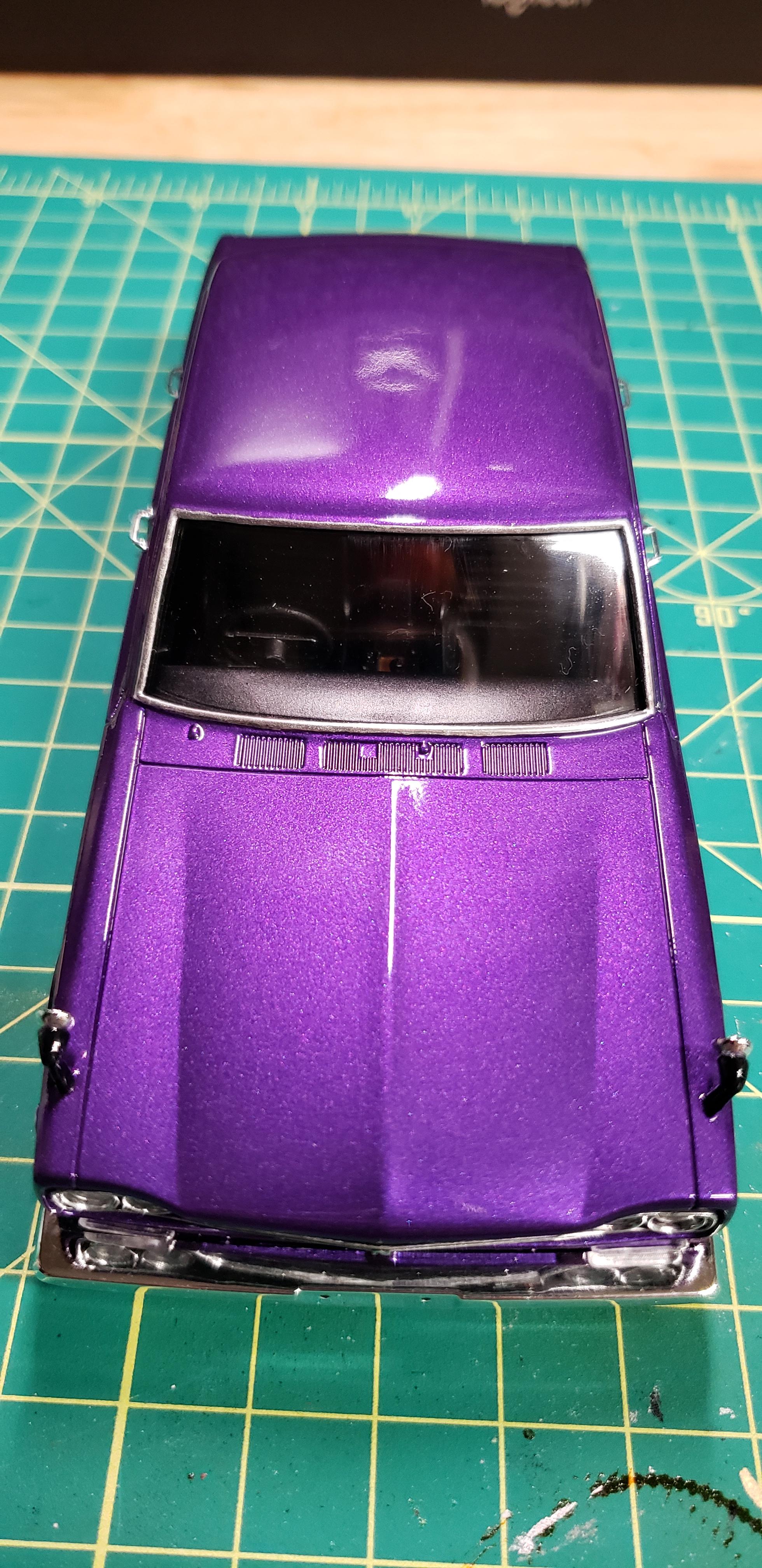

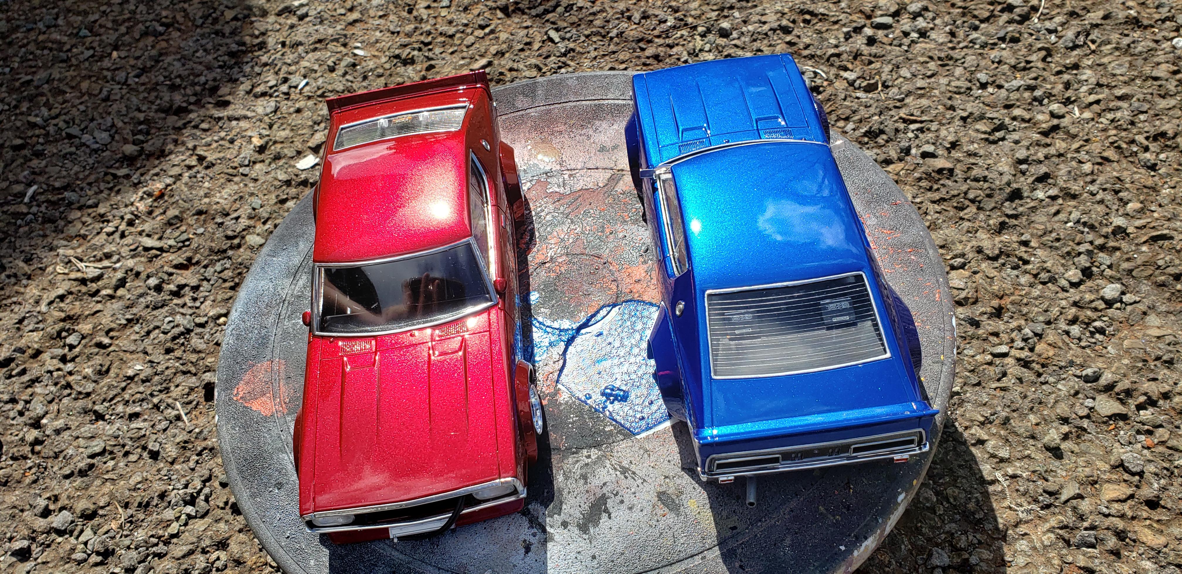

These cars all all shot with nail polish cut about 50% with lacquer thinner. Here in hawaii its harder to get nice colors, just use a good primer. Tamiya or duplicolor primer sealer works good for me
Revlon and CVS brand nail polish seems to lay pretty good. Haven't tried OPI and Essie yet

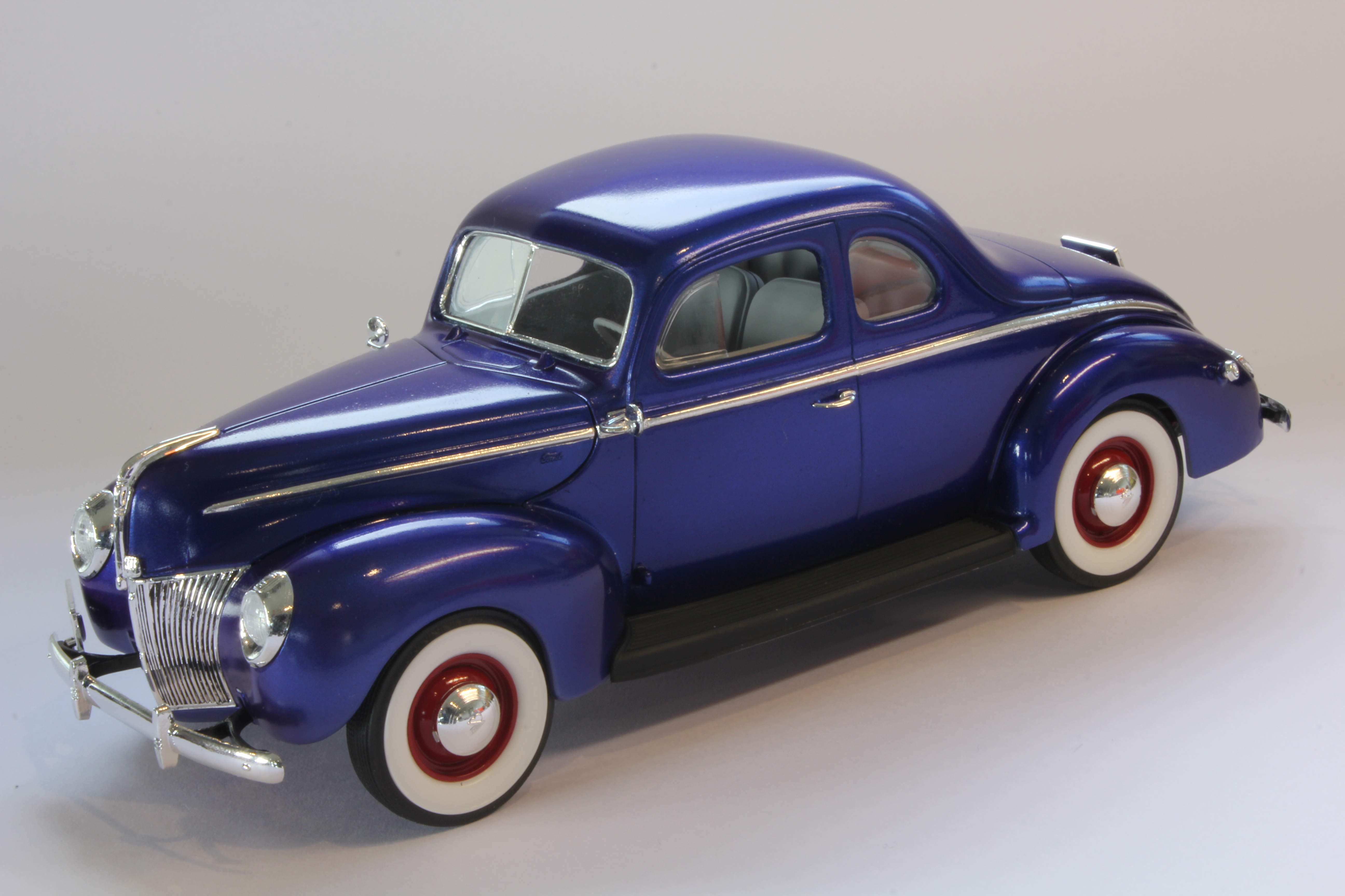

I have had good luck with nail polish, but also had one model which faded a bit. The blue colour turned purple over time on the light facing side. I also used nail polish clear on that particular model so probably didn't have the UV resistance like other models covered with 2k clear. Never left in the sun (always in covered).

True, but it wasn't when the model was finished, and few years ago the inspection stopped inspecting model cars .  ;)
