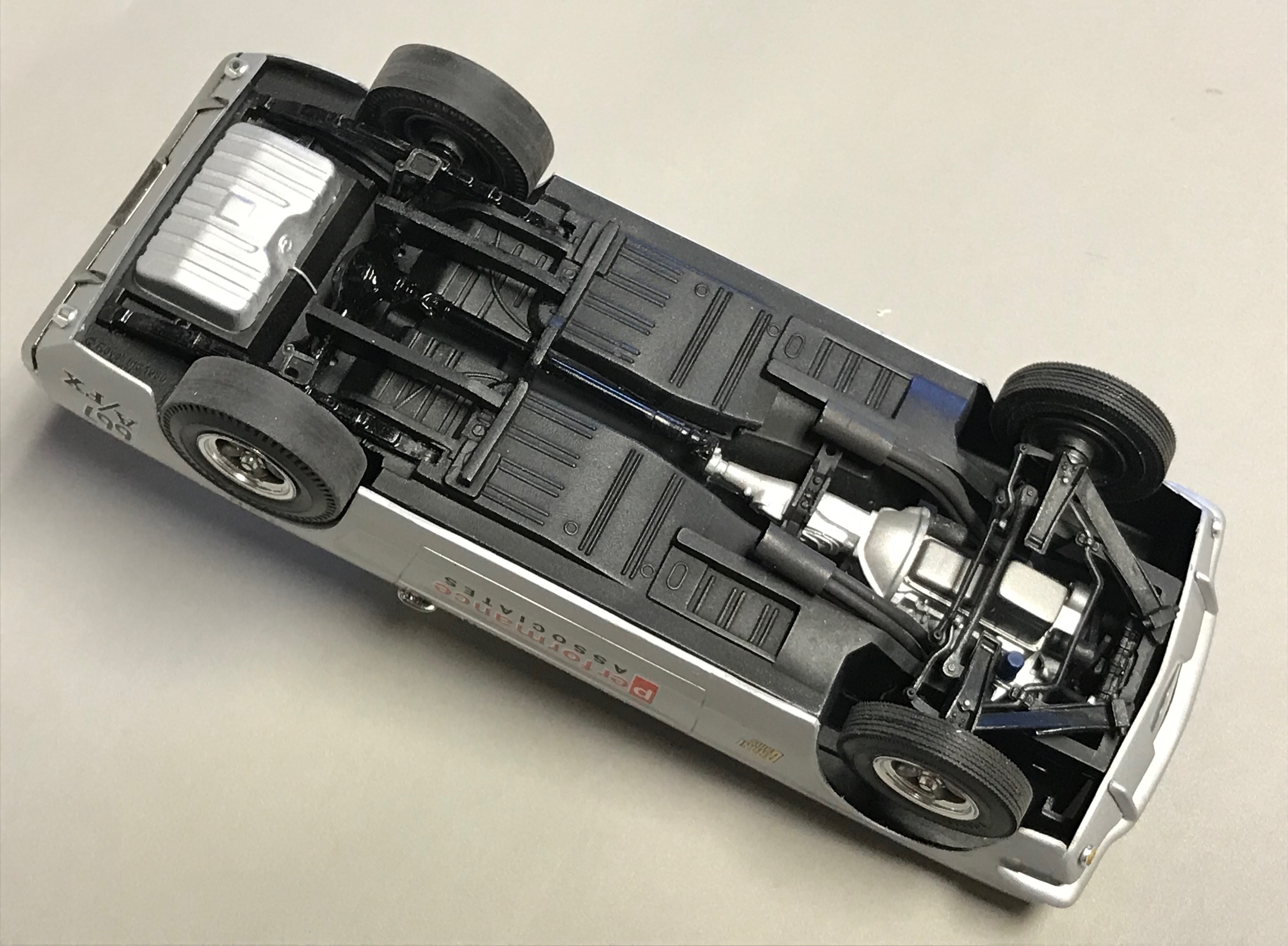

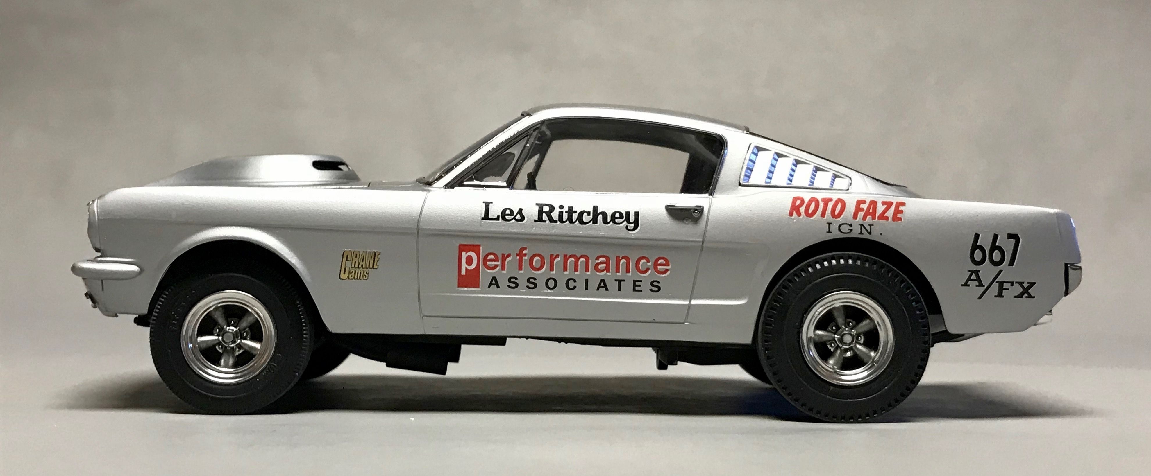

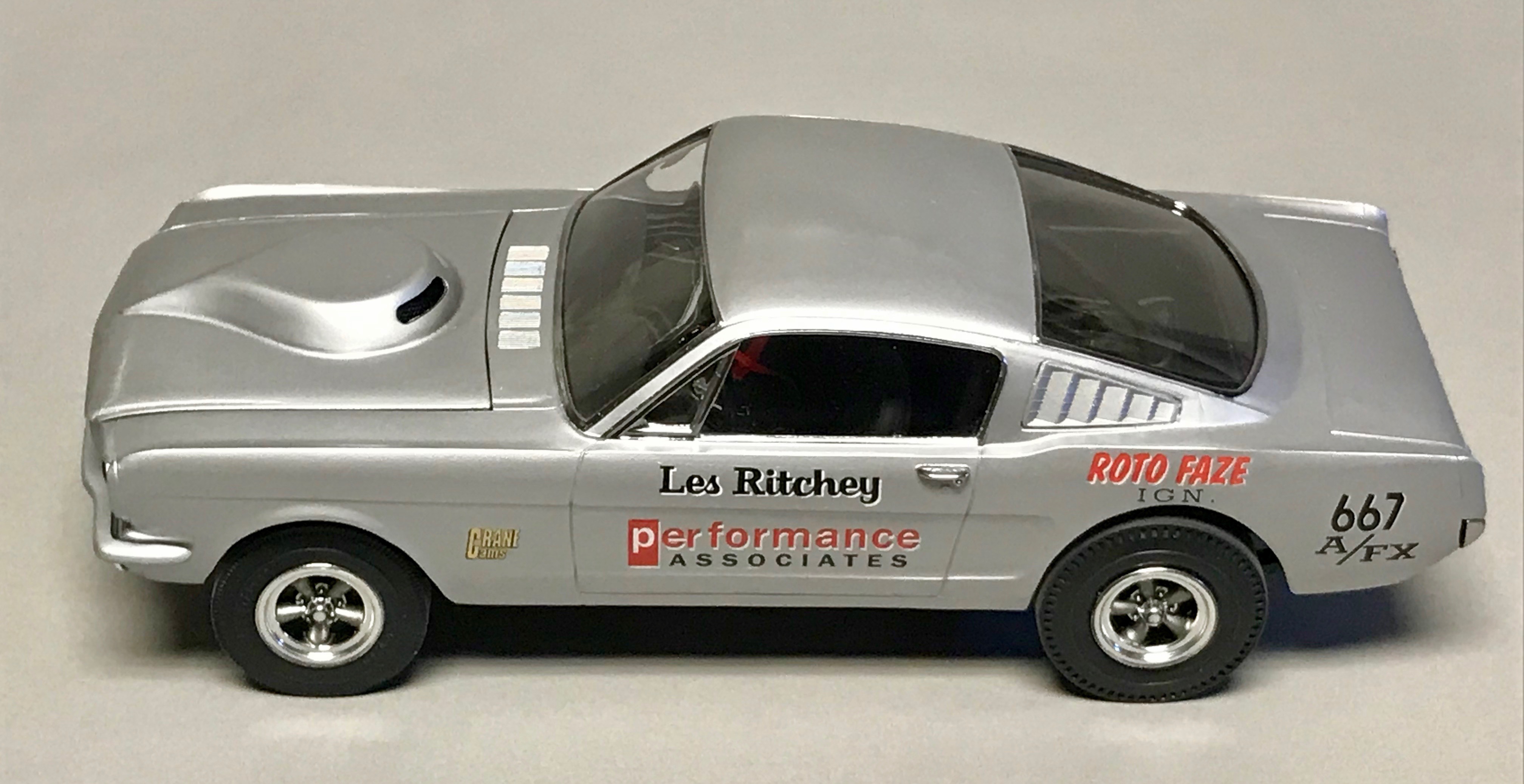

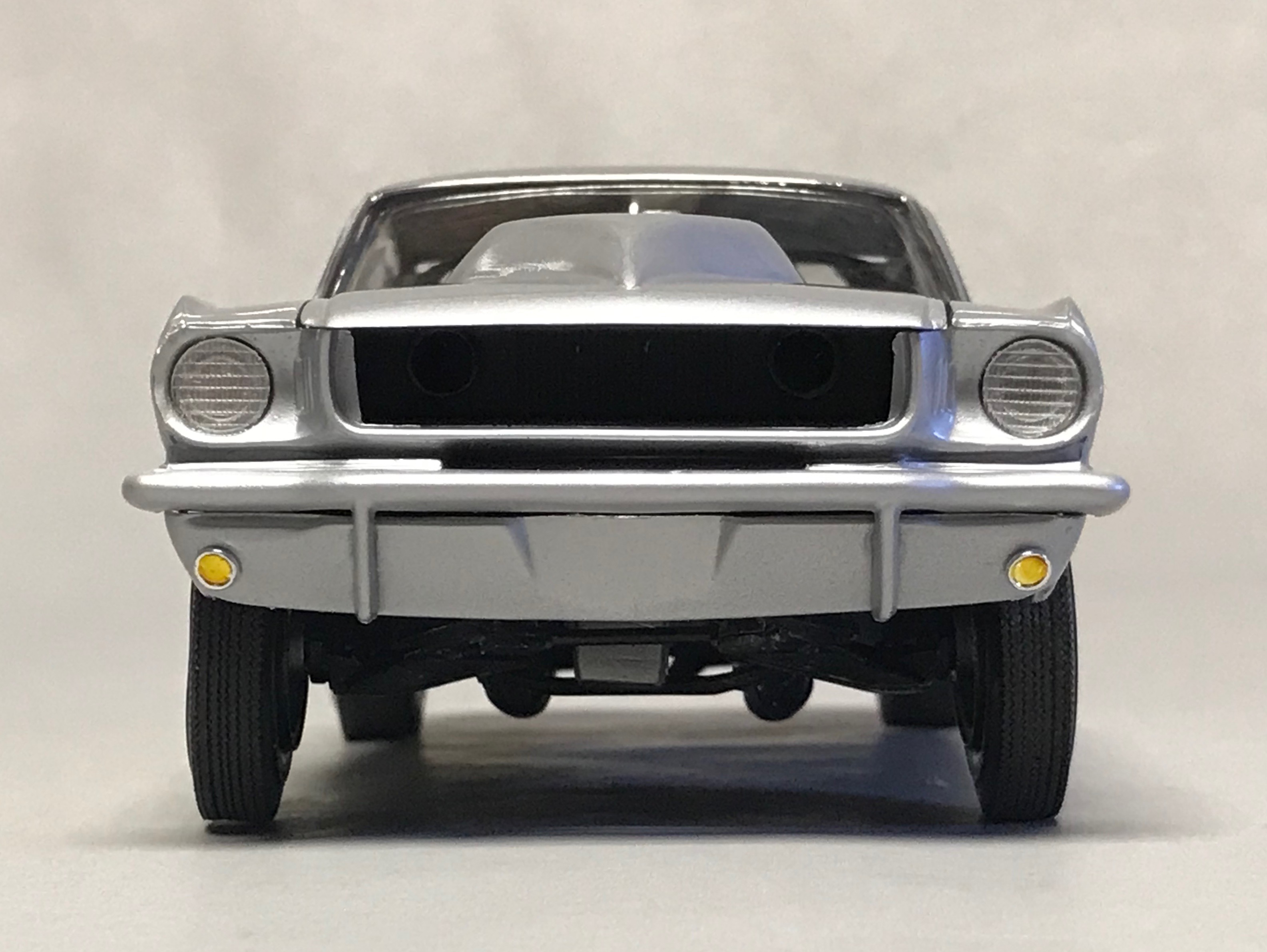

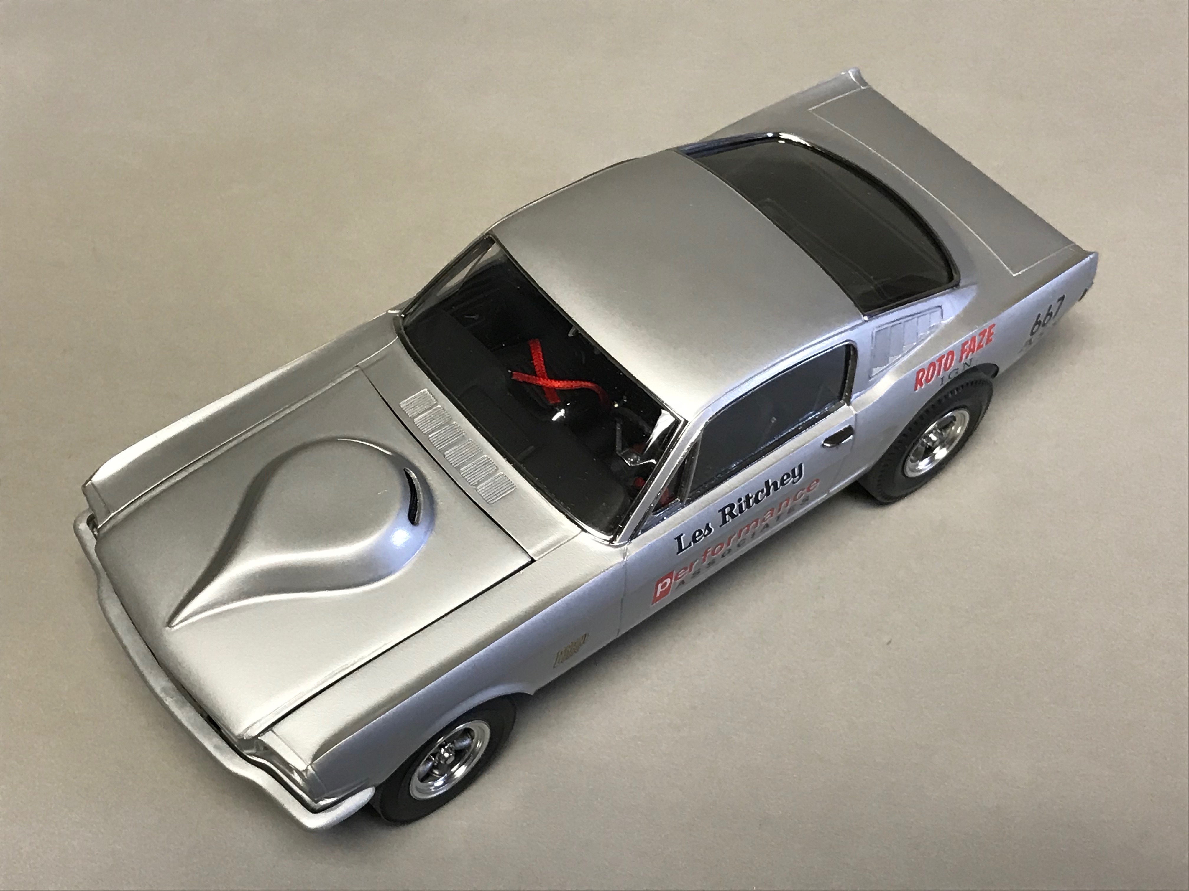

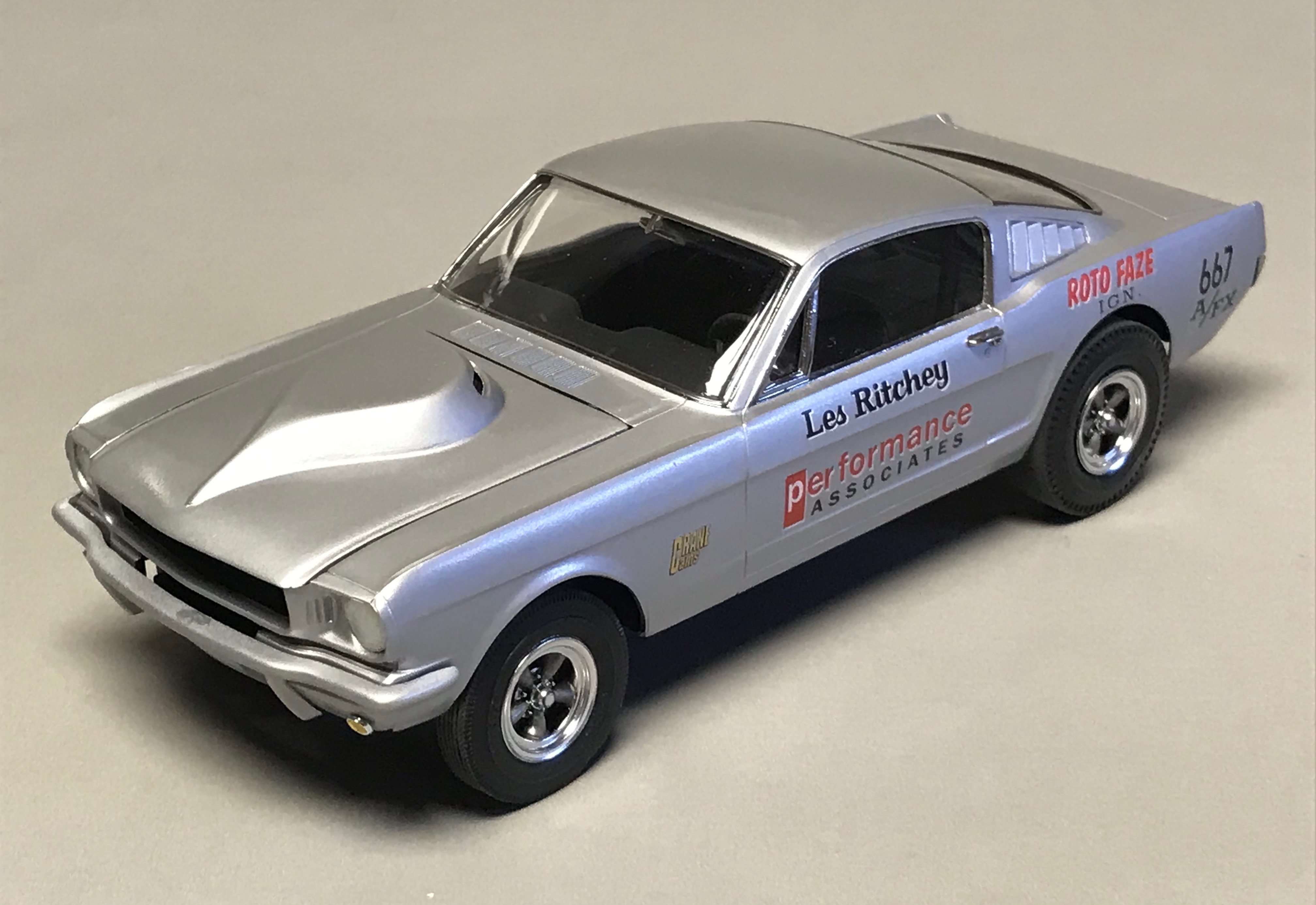

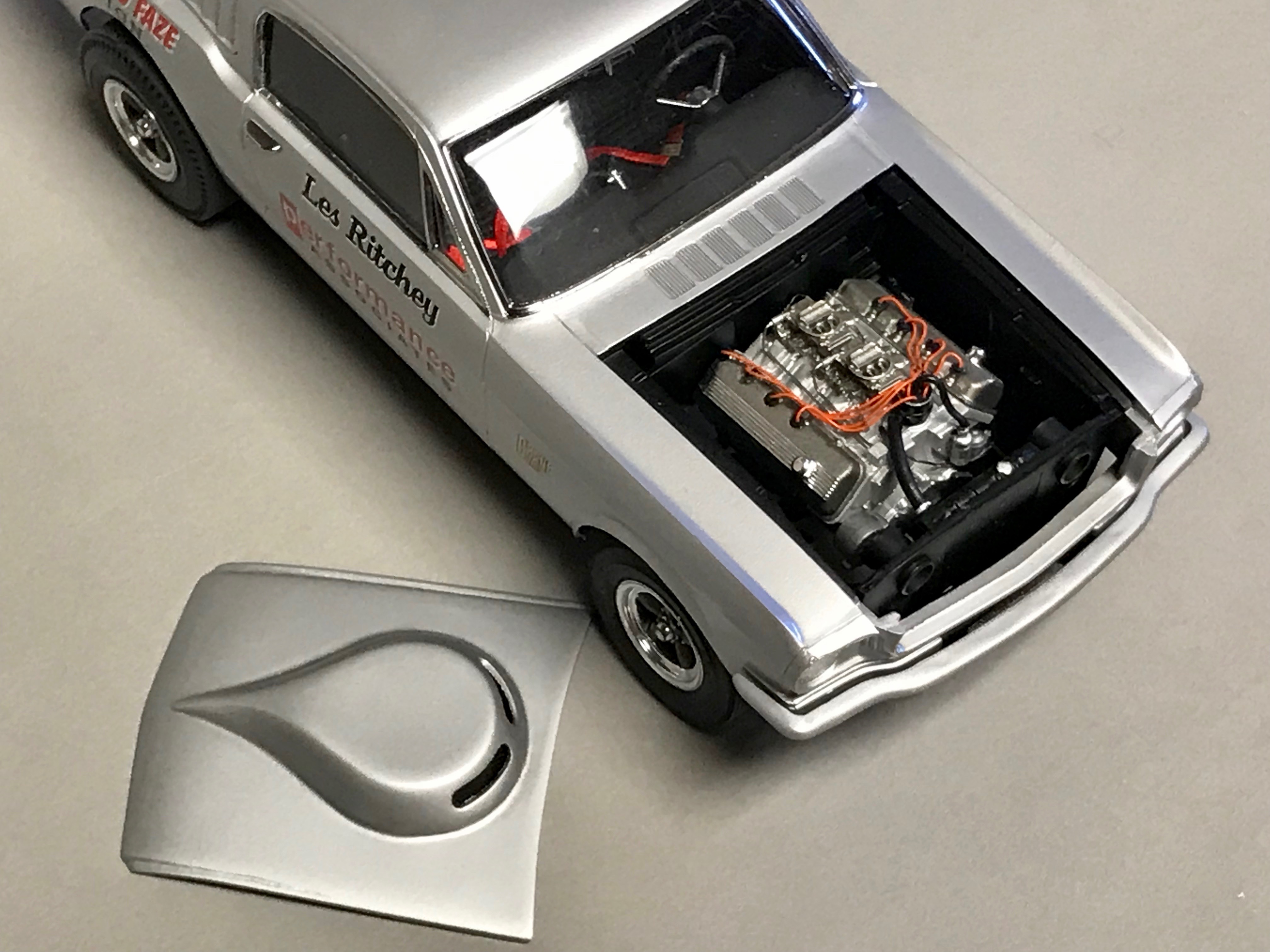

papajohn97 Posted August 11, 2021 Share Posted August 11, 2021 (edited) This is one I've been building as a part of a Mustang group build on a British modeling forum, legendary racer/ tuner Les Ritchey's '65/66 Mustang A/FX 427 SOHC screamer. It's based on Revell's 1/24 kit in which I replaced the 289 small block with a 1/25 SOHC 427 from the Moebius '65 Comet A/FX Dyno Don kit. Lot's of mods and scratch-building was required to get this engine to fit as well as to incorporate the weird front torsion/ 1/2 leaf spring suspension that replaced the stock struts and shock towers. Headers were scratch-built using solder and the rear differential/ wheel openings and wheel wells were shifted 1/8" to correspond to the 3 inch wheel base shift that was done by Holman and Moody. Rear traction bars were scratch-built using the Revell '64 Thunderbolt part as a pattern. A roll bar was made using .100" OD styrene rod and our kitchen stovetop. After market parts that I added included Fireball Holley 4160 resin carbs, Detail Master distributor/ plug wires/ looms/ linkage and misc wires and springs. The teardrop hood is a 1/24 replacement for the Revell kit made by Competition Resins. The tires and Torque Thrust mags were taken from an AMT '62 Bel Air kit. The Body was painted using Tamiya Silver Leaf lacquer with TS-13 clear coat, window frames were metallized using Alclad Chrome over gloss black enamel and other paints used were mostly Tamiya acrylics. The key to making this project happen were the fabulous decals that Joe Curtis of Fremont Racing Specialties was kind enough to custom make for me - thank you Joe!!! I'm still toying with the possibility of adding air conduits between the carbs and the radiator bulkhead (similar to the '64 Thunderbolts) but it appears to be a "project within the project" so please don't hold me to it. I've enjoyed building 1/24-1/25 super stock drag car models from the early/ mid sixtes and these A/FX Mustangs have always been somewhat of a "Holy Grail" to me. It's wishful thinking on my part but maybe someday one of the model companies will tool a more accurate version of what I've tried to build here (Revell? Moebius? Meng?). Cheers, John Edited August 11, 2021 by papajohn97 spelling correction 4 1 Quote Link to comment Share on other sites More sharing options...

echo Posted August 12, 2021 Share Posted August 12, 2021 What a nice build, your under carriage is exceptionally well done, you incorporated the changes they did to the front suspension and the subtle shift of the rear suspension. A job well done. I like the '65 A/FX Factory Mustangs and have one that I have worked on, off and on, mostly off, maybe your model will get me to finish it. Your model is probably the nicest example of a '65 Factory car that I have seen. Great Model ! Quote Link to comment Share on other sites More sharing options...

MeatMan Posted August 13, 2021 Share Posted August 13, 2021 Very nicely done! I see you fabricated those funky front springs, too. 1 Quote Link to comment Share on other sites More sharing options...
fairlane1320 Posted August 16, 2021 Share Posted August 16, 2021 (edited) Fantastic build! I don't think I've ever seen one this accurate. Nobody seems to bother getting the rear wheels where they belong, or the correct front suspension. Job well done! 🤘 I'm a huge fan of these cars, have one long-term WIP and few more in the plans. Ritchey sure knew his way around a Ford race car, and the quarter mile. It's really sad that he died so young, and in such a horrifying manner. 😟 Edited August 16, 2021 by fairlane1320 Quote Link to comment Share on other sites More sharing options...
