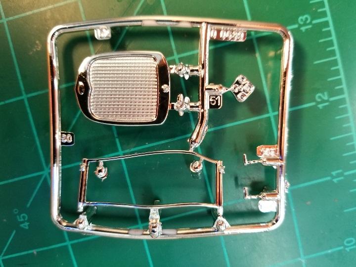

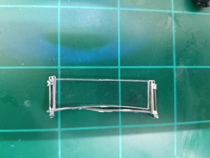

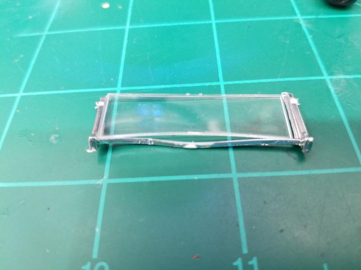

Zippi Posted September 14, 2021 Author Share Posted September 14, 2021 Had a chance to get back on the 29 this morning only to find out the windshield frame is toast. I have two kits so I pulled the other kit out and it has the same issue. Not sure just how or if I can repair these frames. Anyone have this issue on your 29 and if so how did you fix the problem? Thanks guys. Quote Link to comment Share on other sites More sharing options...
alan barton Posted September 14, 2021 Share Posted September 14, 2021 That's a real shame but I do have one suggestion. My 1:1 roadster has no frame along the top of the glass, a look I really like. I copied another roadster from the sixties that made a real impact on me when I was a teenager. If you cut the badly bent top frame away and then gently massaged the lower frame that doesn't look so bad, I reckon you could get there. I would also someone how stick the frame down to a piece of glass and then use Modge Plodge to stick the "glass" into the frame to make it one solid unit before you attach it to the body. A second version would be to cut the top and bottom frames away entirely, glue the posts to the cowl and let dry over a few days and then use thin strip or maybe polished aluminium wire to replace the horizontal elements. It's going to be one of those joyless jobs but if you get to save a kit then the smile will come back. I wonder if this is happening only to the recent re-issue? I bought six of the initial release and didn't experience this problem. Hope that helps Alan Quote Link to comment Share on other sites More sharing options...
Zippi Posted September 14, 2021 Author Share Posted September 14, 2021 27 minutes ago, alan barton said: That's a real shame but I do have one suggestion. My 1:1 roadster has no frame along the top of the glass, a look I really like. I copied another roadster from the sixties that made a real impact on me when I was a teenager. If you cut the badly bent top frame away and then gently massaged the lower frame that doesn't look so bad, I reckon you could get there. I would also someone how stick the frame down to a piece of glass and then use Modge Plodge to stick the "glass" into the frame to make it one solid unit before you attach it to the body. A second version would be to cut the top and bottom frames away entirely, glue the posts to the cowl and let dry over a few days and then use thin strip or maybe polished aluminium wire to replace the horizontal elements. It's going to be one of those joyless jobs but if you get to save a kit then the smile will come back. I wonder if this is happening only to the recent re-issue? I bought six of the initial release and didn't experience this problem. Hope that helps Alan I appreciate the info Alan but both frames are just warped to bad on the top and bottom. I hit it with a heat gun and tried to bend it a little straighter but it snapped. I know everyone says this is a nice kit but I have had nothing but problems. I had the body and frame painted (both were painted at the same time) a nice red but they are two totally different colors. I sanded the frame down on the sides and re-shot it but got the same results. Now my only option is to paint the frame black which I really don't want to do. Quote Link to comment Share on other sites More sharing options...

Varen Posted September 14, 2021 Share Posted September 14, 2021 (edited) 9 hours ago, Zippi said: Had a chance to get back on the 29 this morning only to find out the windshield frame is toast. I have two kits so I pulled the other kit out and it has the same issue. Not sure just how or if I can repair these frames. Anyone have this issue on your 29 and if so how did you fix the problem? Thanks guys. I had an issue with mine though the bottom wasn't quite as bad. I tried to straiten it with some heat to no avail. I ended up doing as Alan suggested and Removing the top bar. Edited September 14, 2021 by Varen Quote Link to comment Share on other sites More sharing options...
Zippi Posted September 15, 2021 Author Share Posted September 15, 2021 22 hours ago, Varen said: I had an issue with mine though the bottom wasn't quite as bad. I tried to straiten it with some heat to no avail. I ended up doing as Alan suggested and Removing the top bar. Thank's for the info Michael. I cut the top bar off and also tried cutting the bottom bar and gluing it back together trying to get it a little straighter but not it's not looking good. I just don't think it's going to be usable. Quote Link to comment Share on other sites More sharing options...
Zippi Posted September 17, 2021 Author Share Posted September 17, 2021 I got a response from Revell on my two warped windshields and this is what they had to say. I replyed to their email to let them know I needed two replacement windshields since they only referred to one. Dear Sirs, we will send the part free of charge to your address. Shipping information: Shipping time at the moment for USA needs up to 6 weeks and for all other Countries needs up to 3 week. Mit freundlichen Grüßen / Best regards Claudia Nörenberg --------------------------------------------------------------------------------------------------- i.A. Claudia Nörenberg Kundenservice/Consumer Service Tel.: +49 (0) 5223 965 192 Fax: +49 (0) 5223 965 195 Email: claudia.noerenberg@revell.deWeb: www.revell.deRevell GmbH Henschelstr. 20-30 D-32257 Bünde Bünde Sitz: Bünde / Amtsgericht Bad Oeynhausen HRB 10158 Geschäftsführer: Stefan Krings -------------------------------------------------------------------------------------------------- Von: Revell GmbH <service@revell.de>Gesendet: Dienstag, 14. September 2021 17:28An: Revell Service <service@revell.de>Betreff: Neue Revell Ersatzteilanfrage Quote Link to comment Share on other sites More sharing options...

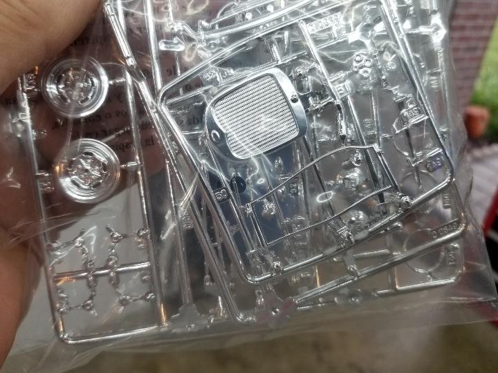

e30lover Posted September 17, 2021 Share Posted September 17, 2021 A time consuming but totally worth approach is to de-chrome all the chrome parts with bleach (Revell's chrome platings are rather too thick), fix the mold lines and other imperfections, then paint them back. I think you can match the red if you shoot it with white primer first. Quote Link to comment Share on other sites More sharing options...
Zippi Posted September 17, 2021 Author Share Posted September 17, 2021 25 minutes ago, e30lover said: A time consuming but totally worth approach is to de-chrome all the chrome parts with bleach (Revell's chrome platings are rather too thick), fix the mold lines and other imperfections, then paint them back. I think you can match the red if you shoot it with white primer first. Thanks for the info Chang. Quote Link to comment Share on other sites More sharing options...

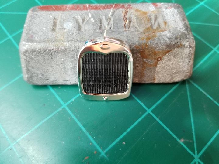

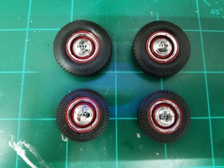

Zippi Posted September 17, 2021 Author Share Posted September 17, 2021 I got the wheels and tires glued together and the radiator. I mix up some Testors semi gloss black and lacquer thinner for the black wash. On the hubcaps I worked the black wash into the lettering with a tooth pick then cleaned it off with a fine point Qtip and lacquer thinner. For the radiator I brushed the black wash on. Came out pretty good. Quote Link to comment Share on other sites More sharing options...
