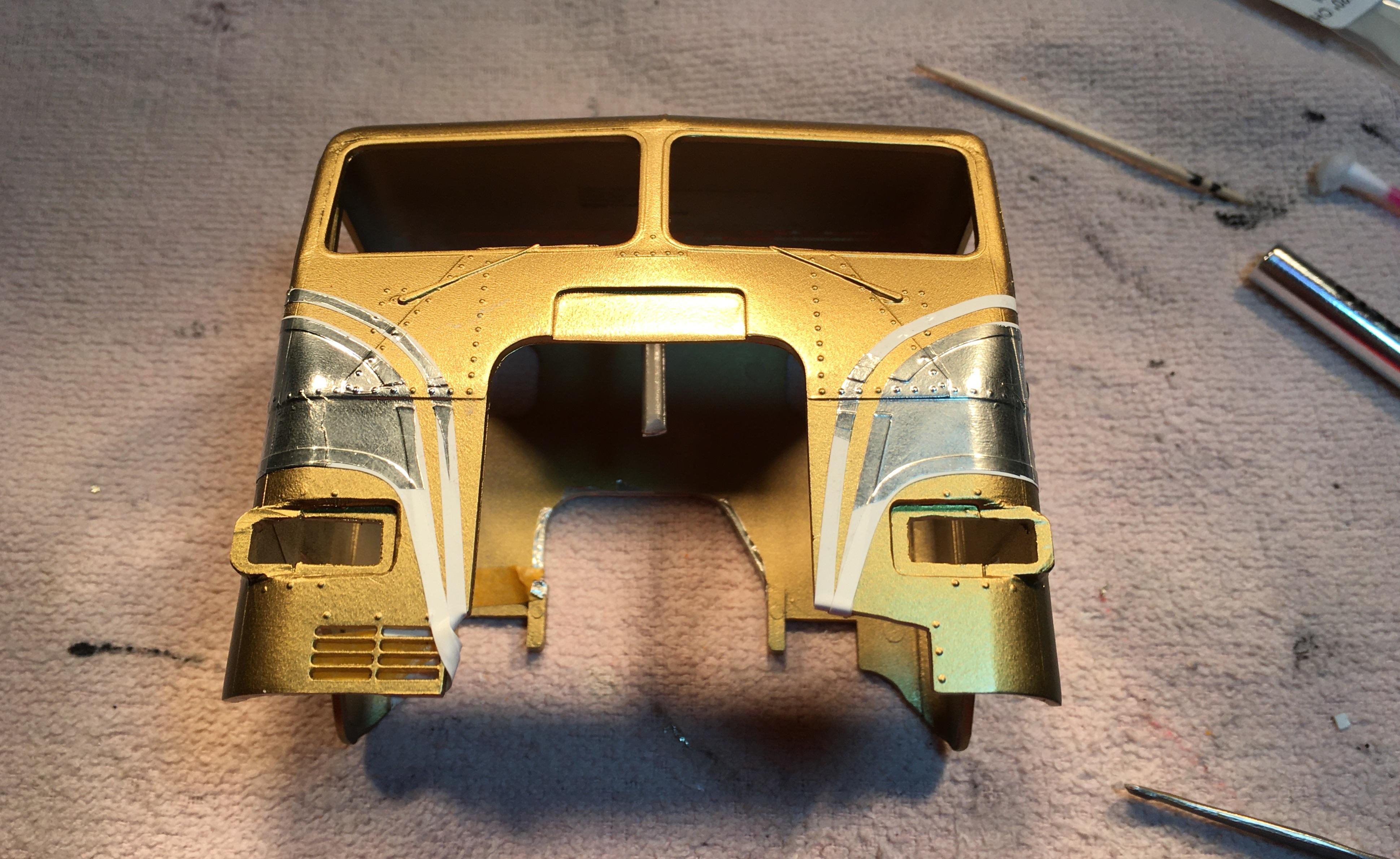

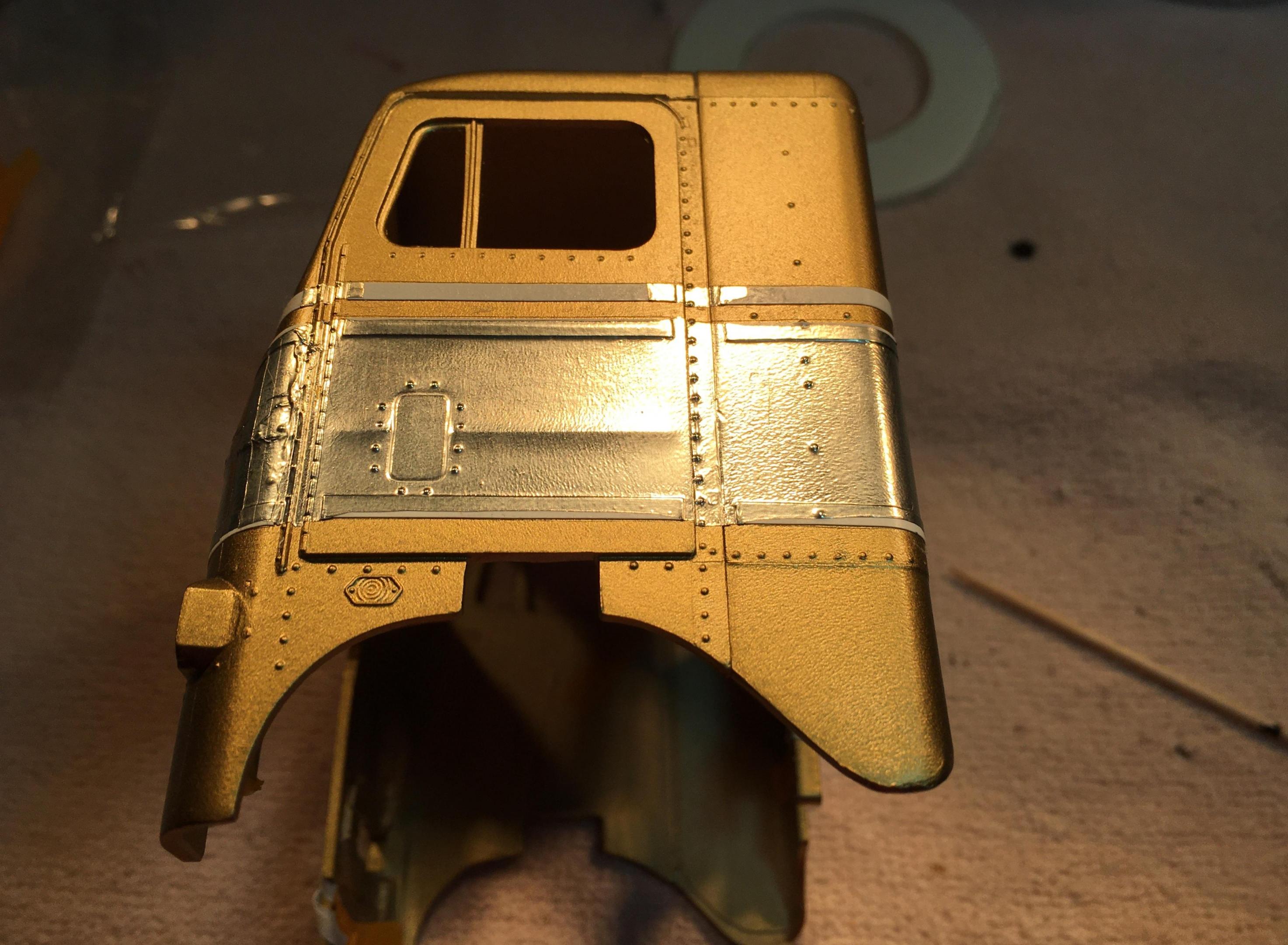

Michael jones Posted September 9, 2021 Share Posted September 9, 2021 (edited) Tamiya tape or equivalent washi tape works great, but also bare metal foil is really great the few times I have used it. Edited September 9, 2021 by Michael jones Quote Link to comment Share on other sites More sharing options...

Bills72sj Posted September 12, 2021 Share Posted September 12, 2021 BMF makes good masking material if you can bring yourself to use it for that purpose. I have heard of a trick of stuffing TWO #11 blades in an Exacto knife to make a precise width line that can be curved. Preventing bleed under is the biggest challenge. Ricky's suggestion of a layer of original paint after masking but before contrasting color can help with that. Quote Link to comment Share on other sites More sharing options...
