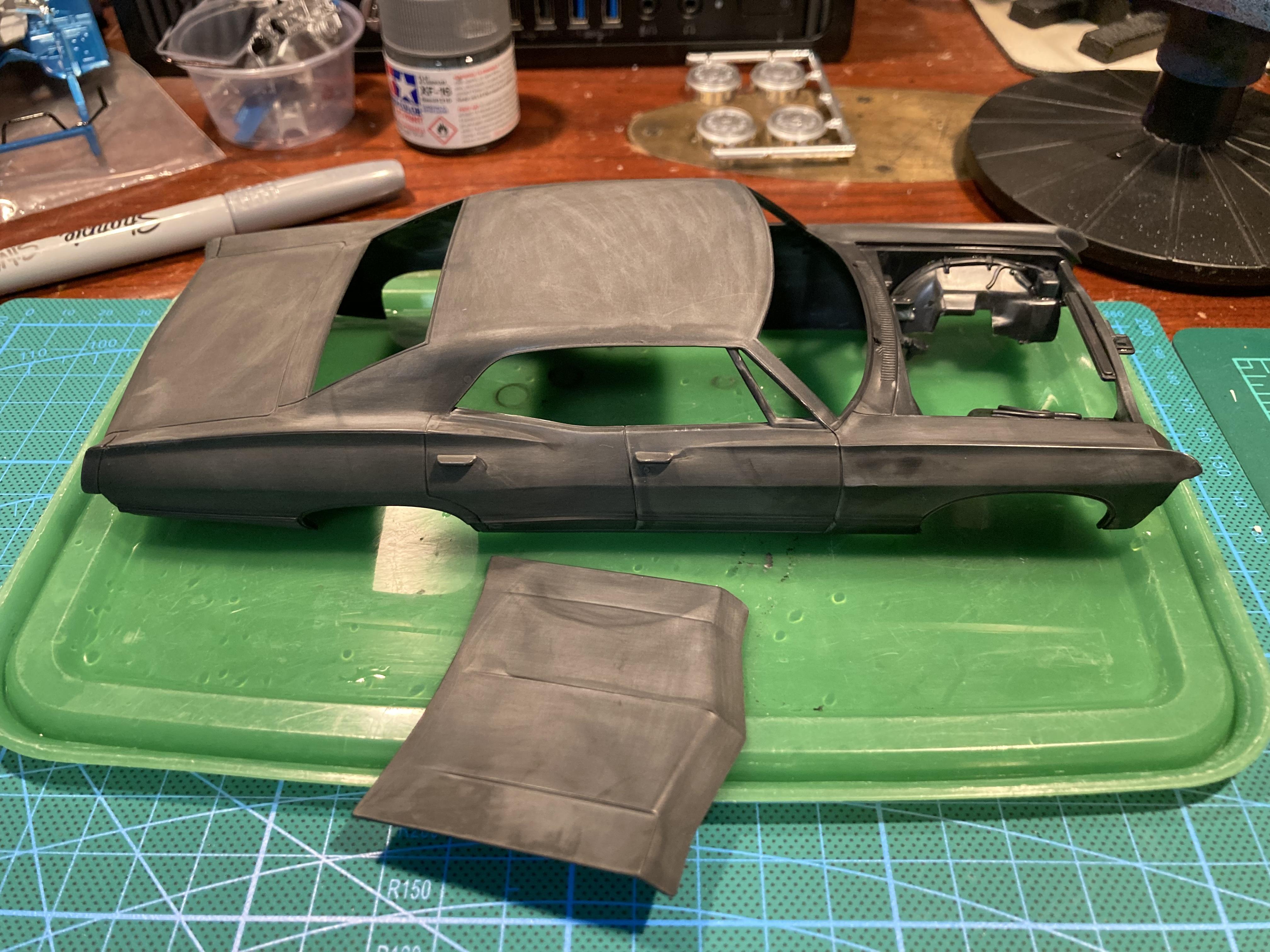

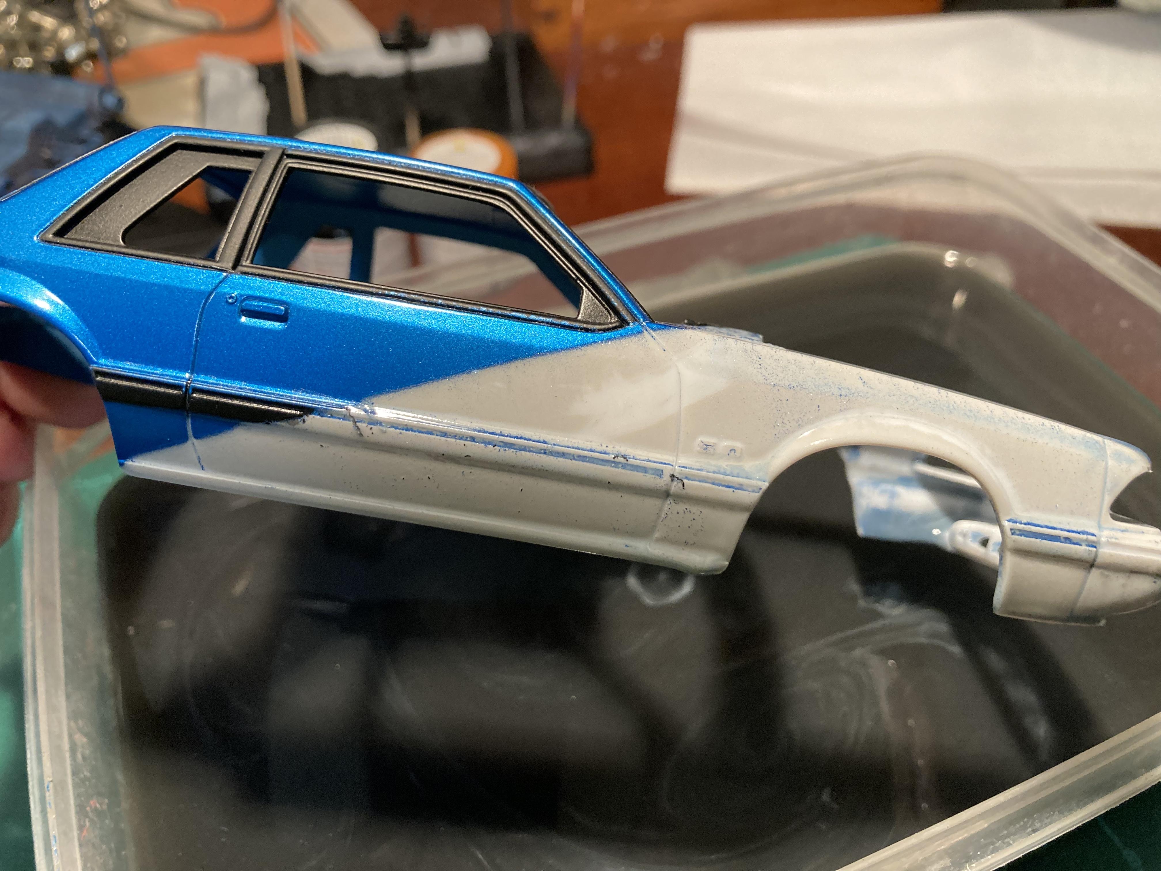

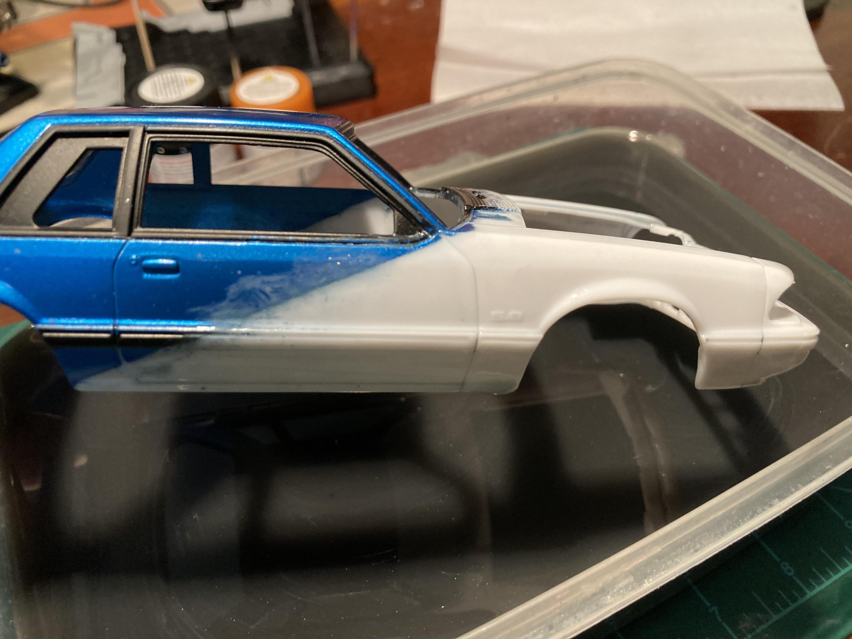

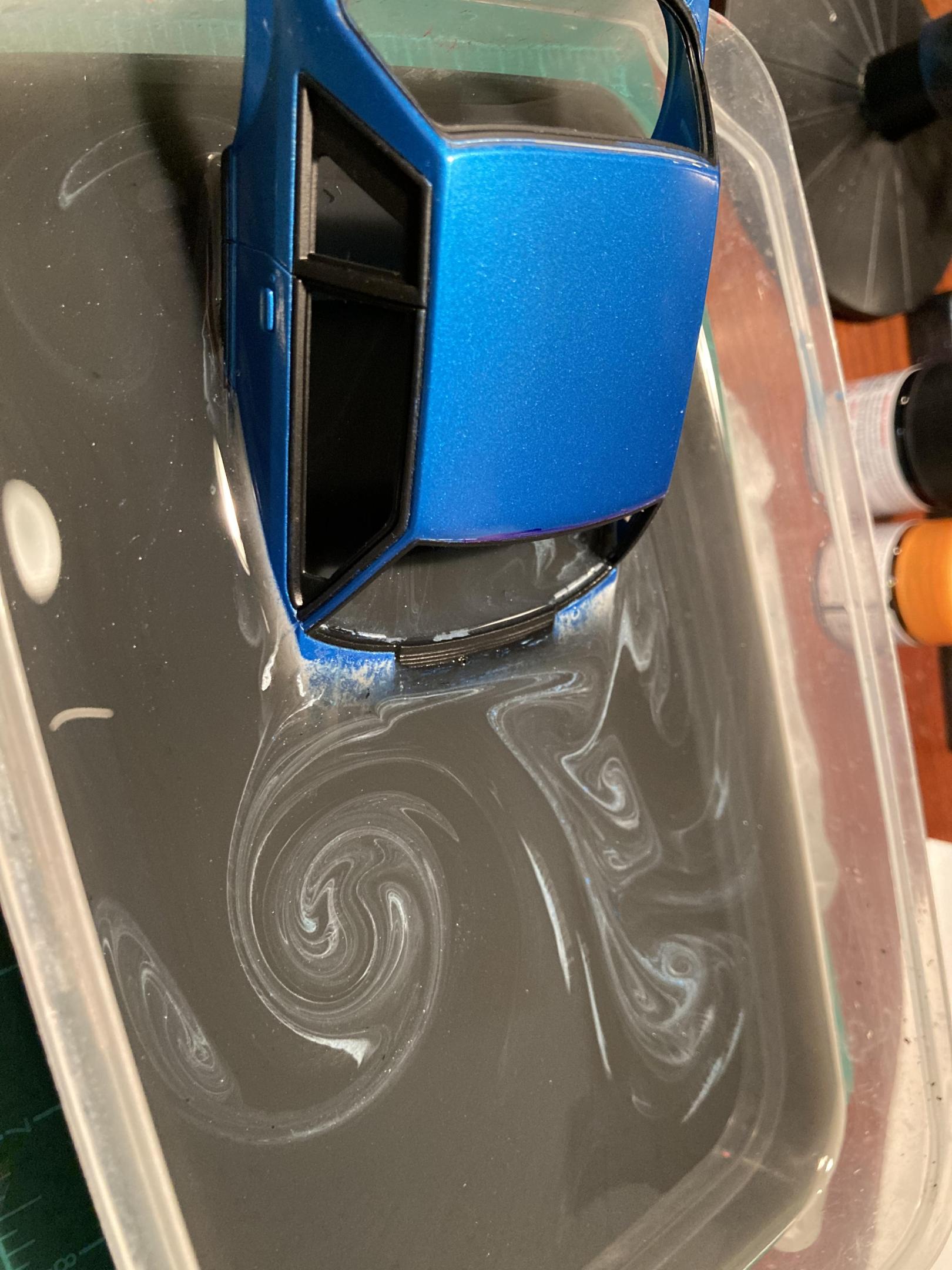

StanGlover Posted June 22 Share Posted June 22 I saw the HPIGuys review on YouTube for QCS Model Safe on June 11th and immediately placed an order for two 32oz jugs. (There’s a secret 20% off code within that HPIGuys review btw). It arrived today and I immediately tried it out. This stuff is not cheap at $35 per 32oz jug… but it works FANTASTIC. I have tried all the usual paint strippers, but nothing touches Tamiya spray primers very well and lacquers are difficult to strip even with ELO and 91% Isopropyl. This Supernatural Impala was primed Tamiya gray spray primer, followed by four coats of Tamiya TS gloss black. I left it soaking in isopropyl for three weeks and was left with the primer untouched, and black firmly attached to crevices. I didn’t think to get a before picture. I dropped it into QCS, left it for an hour while I got dinner, and pulled out a near clean body. Just some quick swishing with a toothbrush resulted in this: It has a chalky look to it after rinsing and drying, but I think that’s just from my initial sanding, maybe some of the primer has etched in. Regardless, this body is ready for prep and fresh paint. I did another test on another body and took pictures, I’ll post that separately below. I will mention, I have ZERO affiliation with Stripwell/QCS or HPIGuys. I bought this with my own money and these are my results! This stuff really works!! If you have a product you like, great, keep using it. If you want something that works QUICK and EASY, give this stuff a try! Quote Link to comment Share on other sites More sharing options...

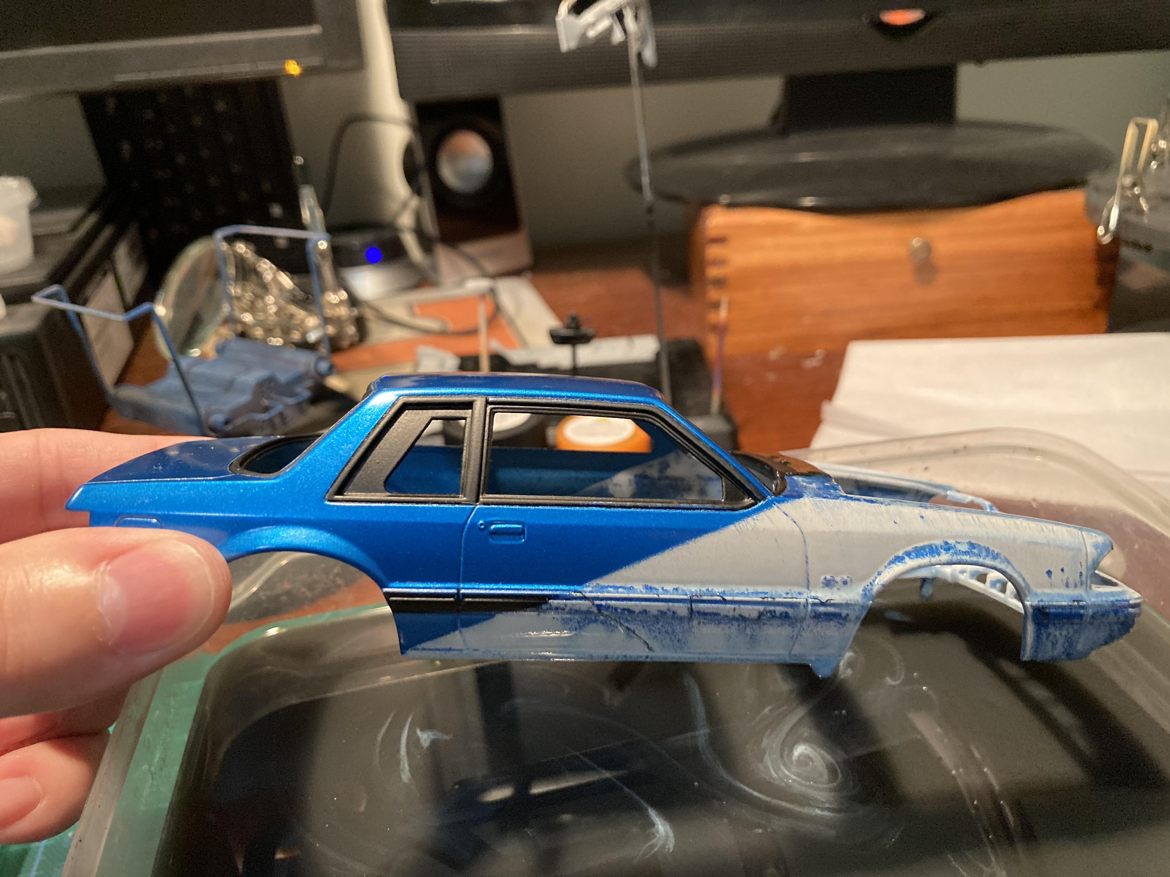

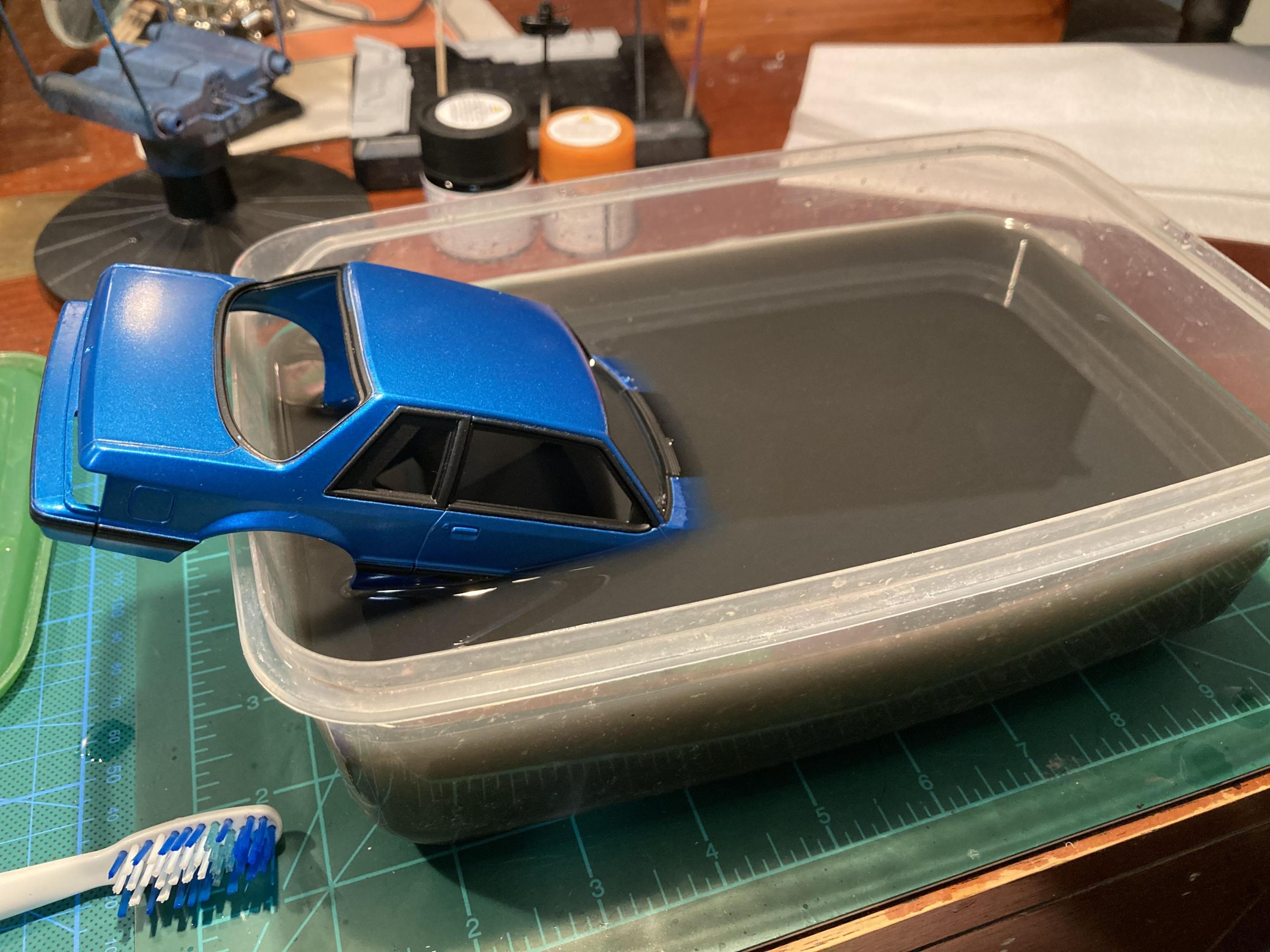

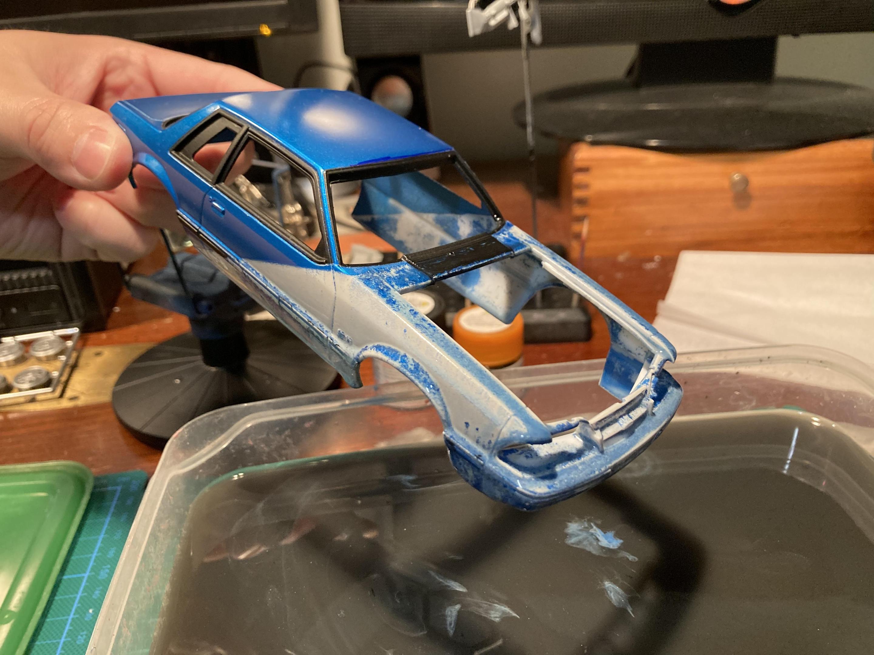

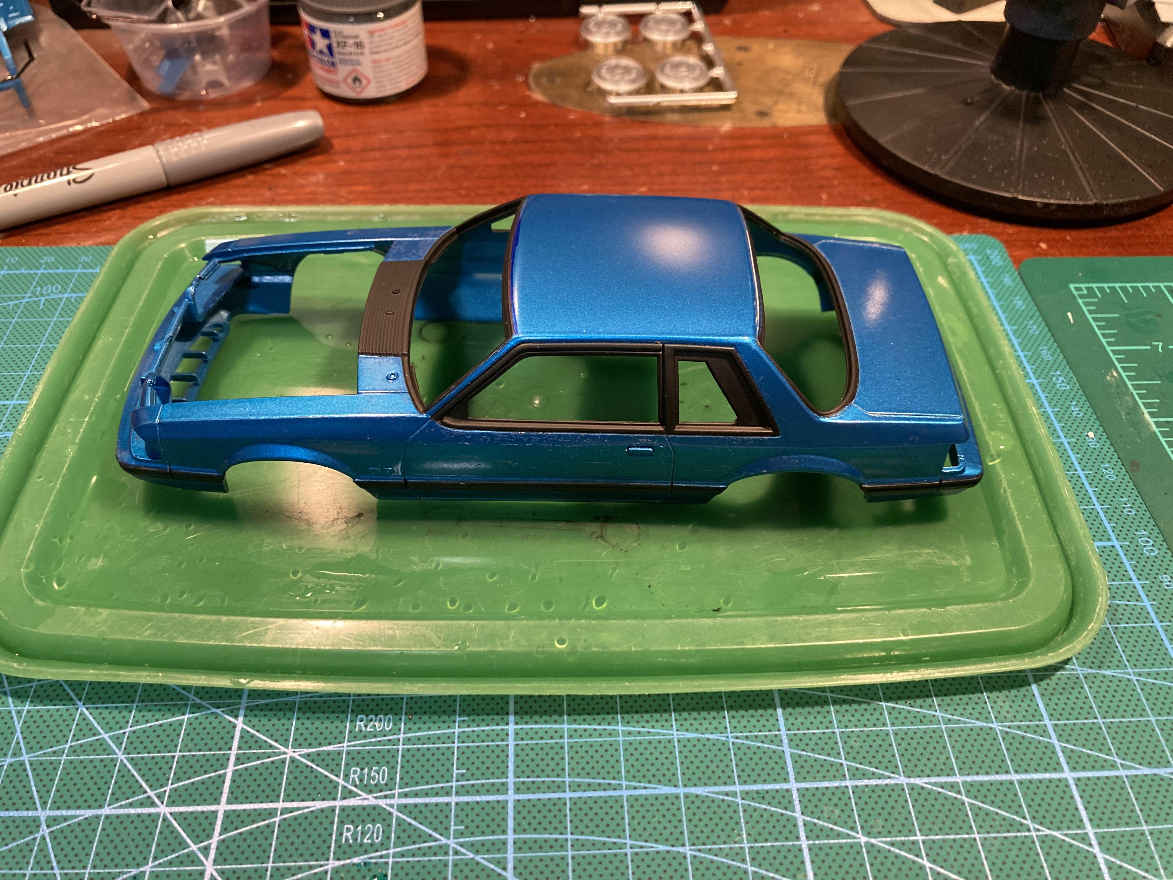

StanGlover Posted June 22 Share Posted June 22 Here’s the second project I stripped using QCS Model Safe. Tamiya Gray primer, three coats of Tamiya TS Light metallic blue, and the black trim is Krylon black primer. The Tamiya blue had room-temp cured for two weeks, and the krylon trim was about three days old. I partially submerged the body to really show the magic. This is after 10 minutes: I dunked it back in. You can see the primer starting to swirl away: 15 minutes later, a total of 25 minutes submerged: I then swished the fluid over the body with a toothbrush, lightly brushed, and we’re at bare white plastic. This stuff really works, really fast! I will not be using anything else to strip paint 😂 1 Quote Link to comment Share on other sites More sharing options...
69H.O.Firebird Posted June 23 Author Share Posted June 23 Yes it works great! But try to change minds of people that have been using oven cleaner and purple cleaner is difficult. This stuff will not melt plastic and is totally safe. Works like magic as you saw! 1 Quote Link to comment Share on other sites More sharing options...
