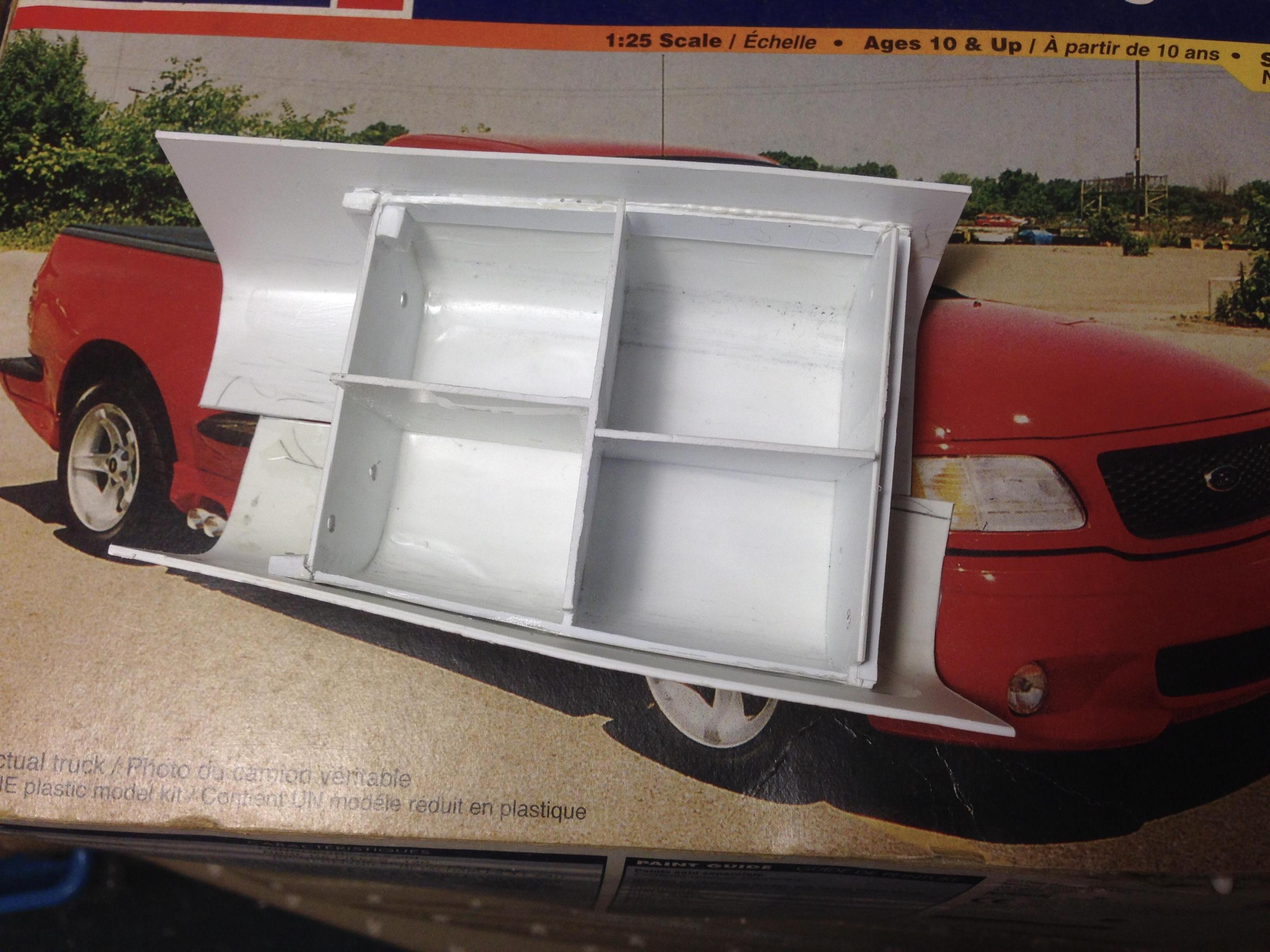

hct728(Bob) Posted September 16, 2021 Share Posted September 16, 2021 Anyone built one? My idea was to make a template shaped like the cab, and narrow it to match the tapered box in segments (like an egg crate) that I could wrap styrene sheet around. Not going well so far, 0.010" styrene sheet can be bent to match but is pretty thin for gluing and holding a smooth shape. More experimentation to come Quote Link to comment Share on other sites More sharing options...
Plowboy Posted September 16, 2021 Share Posted September 16, 2021 I made a full top for a '67 Jeepster a few years ago. I used .020 and laminated it. On your project, I would make a template of the top of the bed with .040. Think bed cover. Then glue the sides on top of it, the front and rear. Once you have the shape you want, add another layer to fine tune the shape. Then cut out the openings and lastly cut away the bottom. Quote Link to comment Share on other sites More sharing options...
Chariots of Fire Posted September 17, 2021 Share Posted September 17, 2021 Hey, Bob. Think about trying this. use long strips of thin stock, say 0.020" and glue them longitudinally across those forms. When they are all in place sand them down and fill in the gaps with putty or CA and sanding dust. That keeps the curvature and makes it really strong. Here's an example of what I mean. Those are all individual strips across the top of the body above the windshield. Then they were sanded smooth. Here's what I did inside. I mixed up some two part resin and poured it inside the top and sloshed it around until it started to set. This made the inside just as smooth as the outside. You should be able to adapt this method to what you are doing. Just glue the strips to the two end bulkheads you have and use the in between ones just to hold the line of the strips. Glue around them and then remove them when all is done. Then you can fill in the gaps. Let me know if this helps. Quote Link to comment Share on other sites More sharing options...
NOBLNG Posted September 17, 2021 Share Posted September 17, 2021 (edited) 17 hours ago, hct728(Bob) said: Anyone built one? My idea was to make a template shaped like the cab, and narrow it to match the tapered box in segments (like an egg crate) that I could wrap styrene sheet around. Not going well so far, 0.010" styrene sheet can be bent to match but is pretty thin for gluing and holding a smooth shape. More experimentation to come It could just be the angle of the photo, but it doesn’t look like your bulkheads are symmetrical? Fold a piece of paper and draw a half pattern, cut it out and unfold it. It will then be symmetrical. The method Charles suggested should work (think wooden barrel). I would go even thicker with the strips, like .060” maybe? More material to sand smooth. Good luck with it. Edited September 17, 2021 by NOBLNG Quote Link to comment Share on other sites More sharing options...

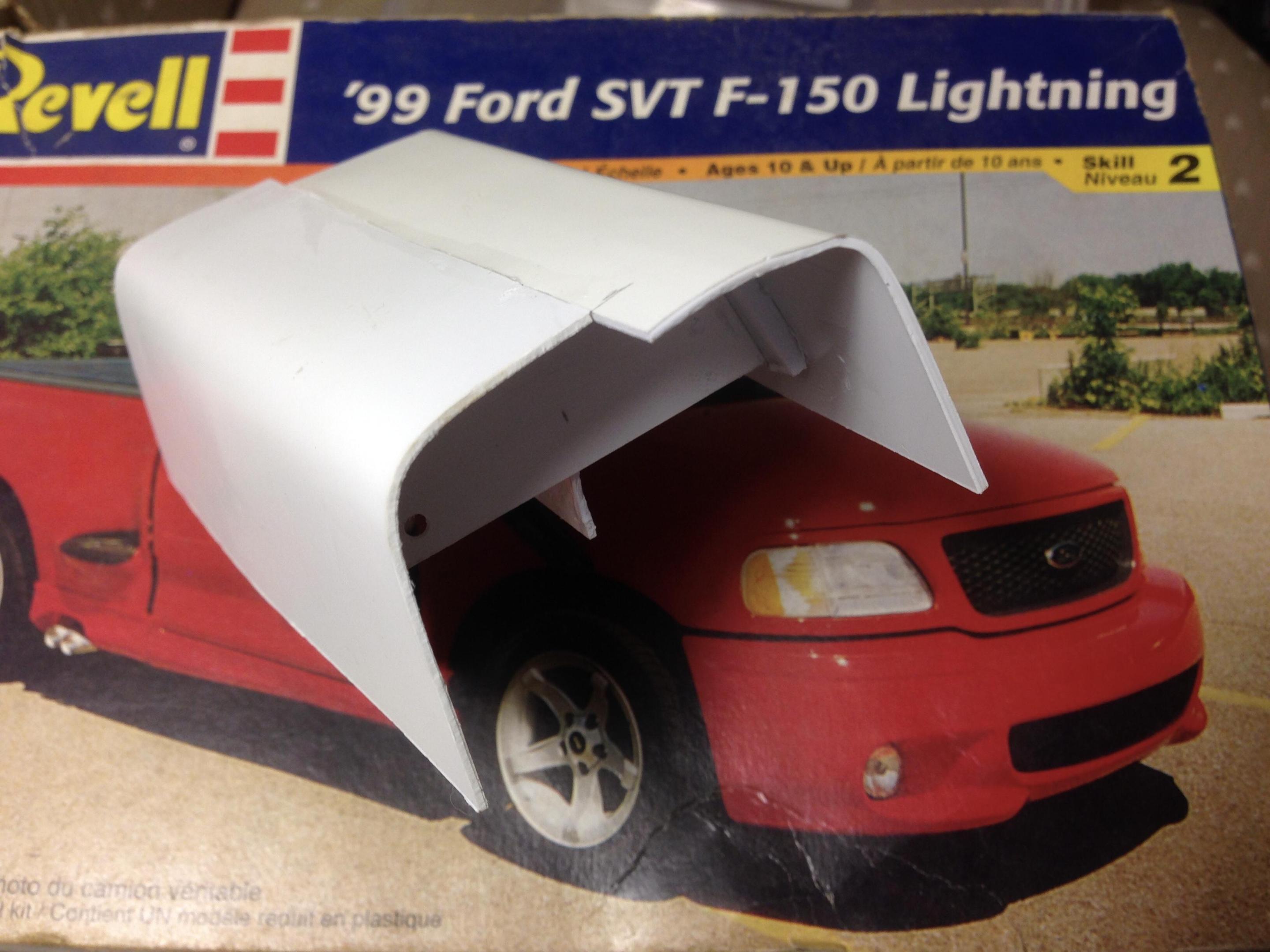

hct728(Bob) Posted September 17, 2021 Author Share Posted September 17, 2021 Thank you for the suggestions, one for box construction and the other using strips on frame construction. Thanks also for the tip on getting frame symmetry, seems obvious now. Picture of first attempt at wrapping frame with 0.010" styrene sheet, too thin and cap seems too narrow, needs another layer or use strip technique. I wanted to have a simple method, though... Quote Link to comment Share on other sites More sharing options...
hct728(Bob) Posted September 27, 2021 Author Share Posted September 27, 2021 Well my flexible styrene wrap idea didn’t pan out, so I went with some .040” styrene that I had heated and bent almost 90 degrees, cut and joined at the middle. The thickness will tolerate some final sanding to shape. I have the Lightning version of the kit to try a second attempt using this ‘bulkhead’ approach, the idea being to keep it simple. Next time… Quote Link to comment Share on other sites More sharing options...

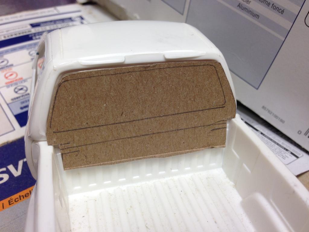

hct728(Bob) Posted October 22, 2021 Author Share Posted October 22, 2021 Progress made on front and rear windows, but still refining the shape. Always thought of body filler kinda like cheating, you know, like adding bacon to a recipe. I was hoping to avoid it with my original bulkhead idea, but the sheet styrene wrap didn’t work out so here we are…prime, putty, sand, repeat, yawn… Quote Link to comment Share on other sites More sharing options...
hct728(Bob) Posted October 26, 2021 Author Share Posted October 26, 2021 Body filler was still showing through multiple coats of Duplicolor sandable primer, so I gave it a coat of BIN sealer/primer, as recommended by truck modeller Tim Ahlborn. Seems to go on thick, but light sanding Is usually needed before colour anyway. Also tried tinting the rear window yesterday with Testors black window tint, but it came out splotchy (it never really worked out every time I tried it in the past), so I guess I’ll use Tamiya smoke. This truck will be mostly blacked out behind the doors, just assembling the painted pieces now Quote Link to comment Share on other sites More sharing options...

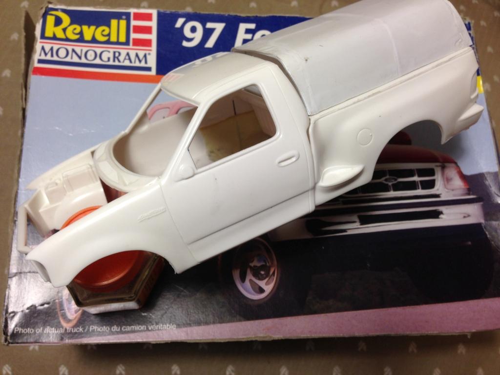

hct728(Bob) Posted October 31, 2021 Author Share Posted October 31, 2021 Well, I pretty much finished it up. Thanks for the tips and suggestions, I expect I'll be using them in the future, as I'm sure I'll be trying this again, and one of those flat bed covers too, you don't really see to many pickups without them around here 2 Quote Link to comment Share on other sites More sharing options...
Smoke Wagon Posted October 31, 2021 Share Posted October 31, 2021 Well done Bob. The canopy hugs the contours of that F-150 nicely. I like how you did the rear window, the knobs are a really nice touch. 1 Quote Link to comment Share on other sites More sharing options...

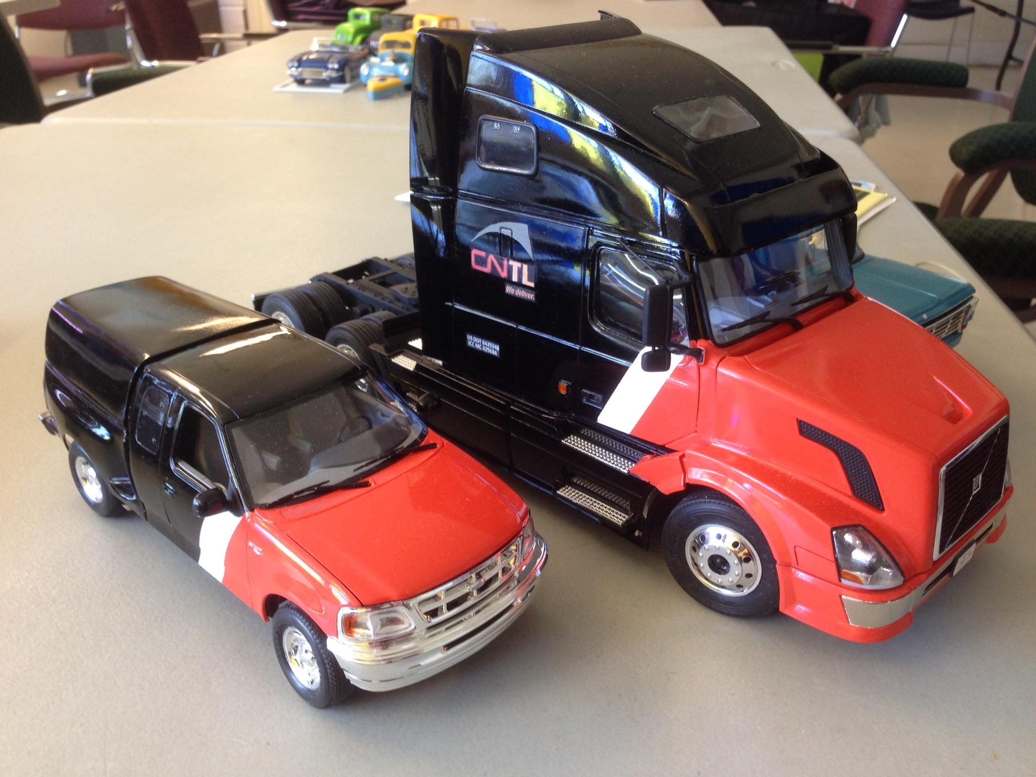

Saltie Olds Posted May 25, 2022 Share Posted May 25, 2022 That canopy looks awesome. It looks like it came with the kit and wasn’t scratch built. Great Awesome Work. Quote Link to comment Share on other sites More sharing options...
hct728(Bob) Posted May 26, 2022 Author Share Posted May 26, 2022 11 hours ago, Saltie Olds said: That canopy looks awesome. It looks like it came with the kit and wasn’t scratch built. Great Awesome Work. Thanks a lot! I took a photo of it next to its big brother at our last club meeting. I plan to try one again with the Moebius pickups, will have to have the vintage look, though, they were aluminum-skinned back then IIRC Quote Link to comment Share on other sites More sharing options...
