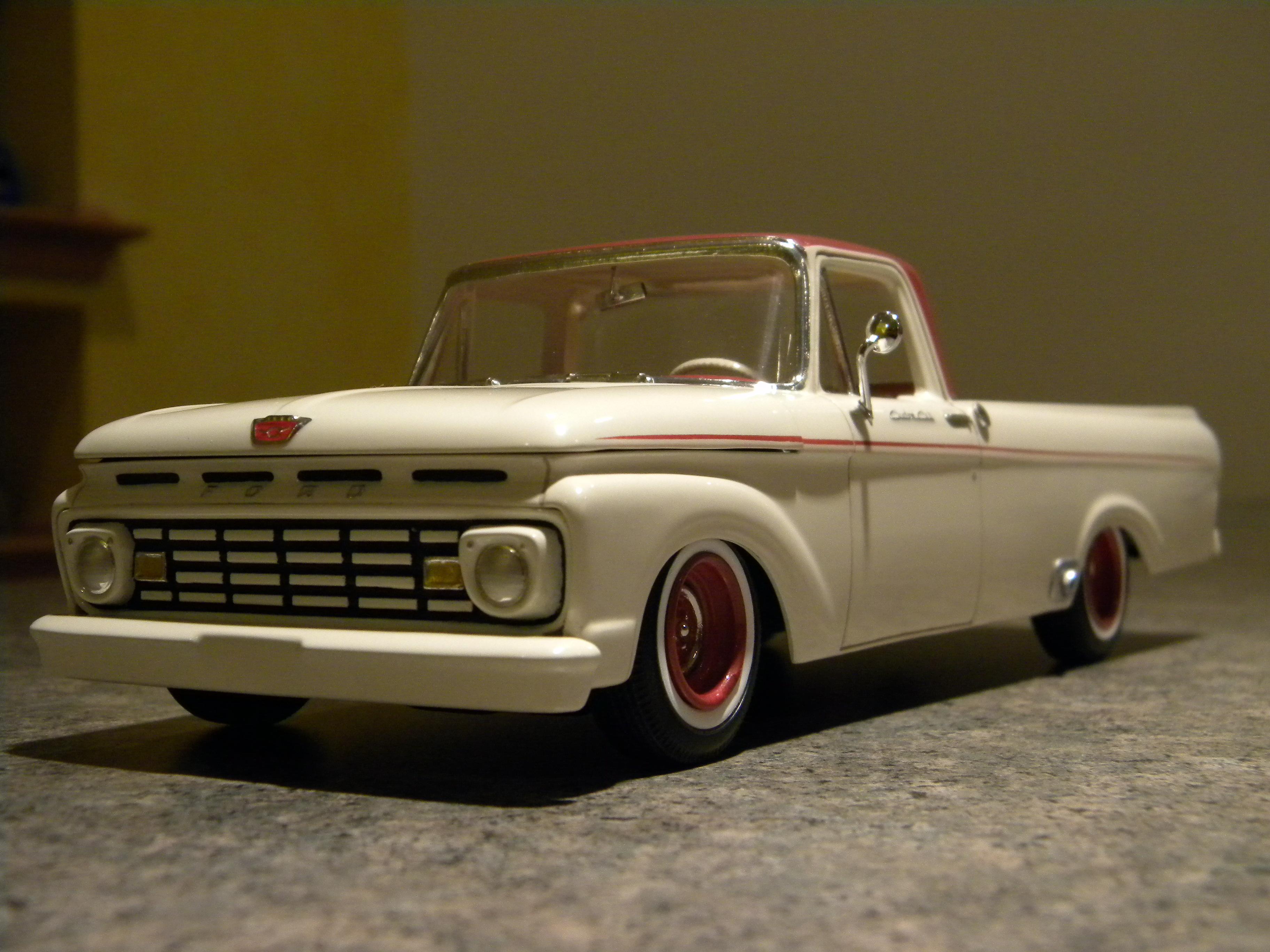

On most of my older builds, I would mix some clear with just a tiny bit of white, and possibly a little dab of silver just to "tint" the clear slightly.
On the majority of my more recent builds, I drill out the molded in lenses and replace with new buckets and clear lenses.
The lenses on this '63 Ford truck were done using the "tint" method.

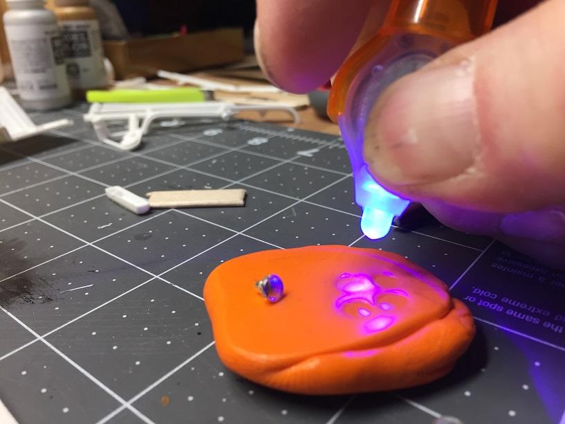

I have made an impression in silly putty and cast them using Bondic. It was just an experiment and I haven’t used them on a model yet. I have also made them out of clear plastic in this thread. Maybe someone knows of another source?
