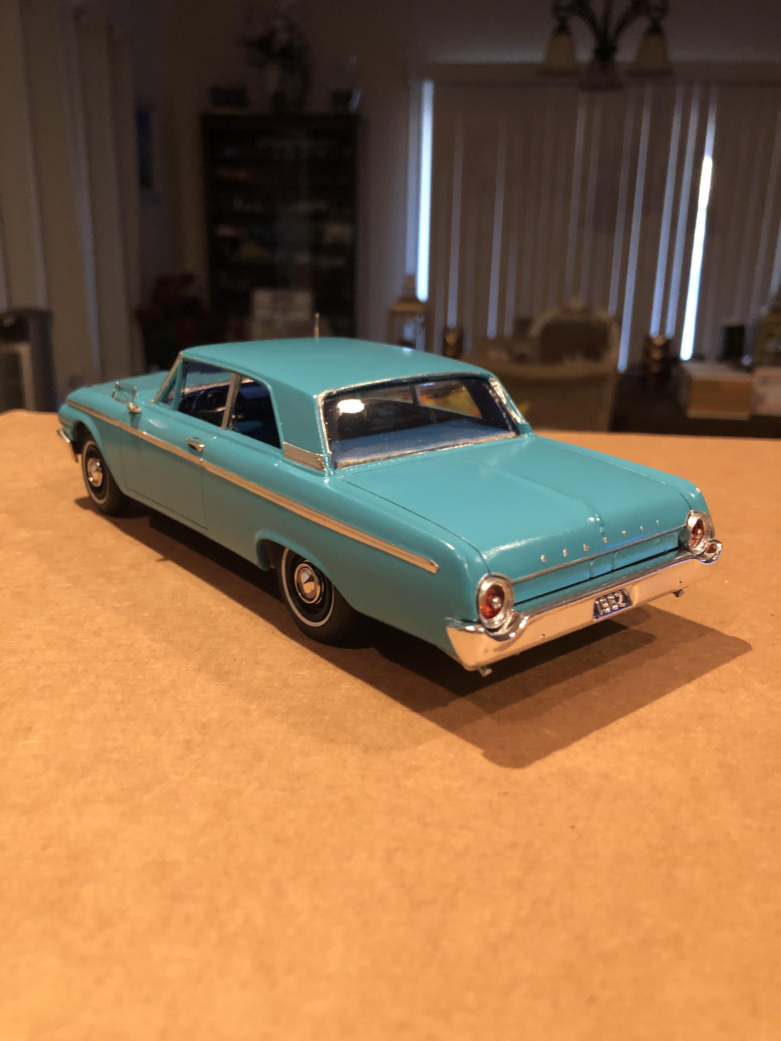

Most of my time lately has been spent on fitment. Along with a few modifications. I now have everything fitting like it should. Lots of tweaks, filing and sanding. I have a lot of work in the grille and front bumper. I separated them first. The grille got the headlights drilled. The outside headlight rings got sanded and thinned down to match the fenders. I also made a notch in it for the hood latch. And finally, I made a splash guard. It will get body color. It'll barely be visible. But, it'll make a big difference in the appearance. Plus, I'll have a nice solid mounting point.

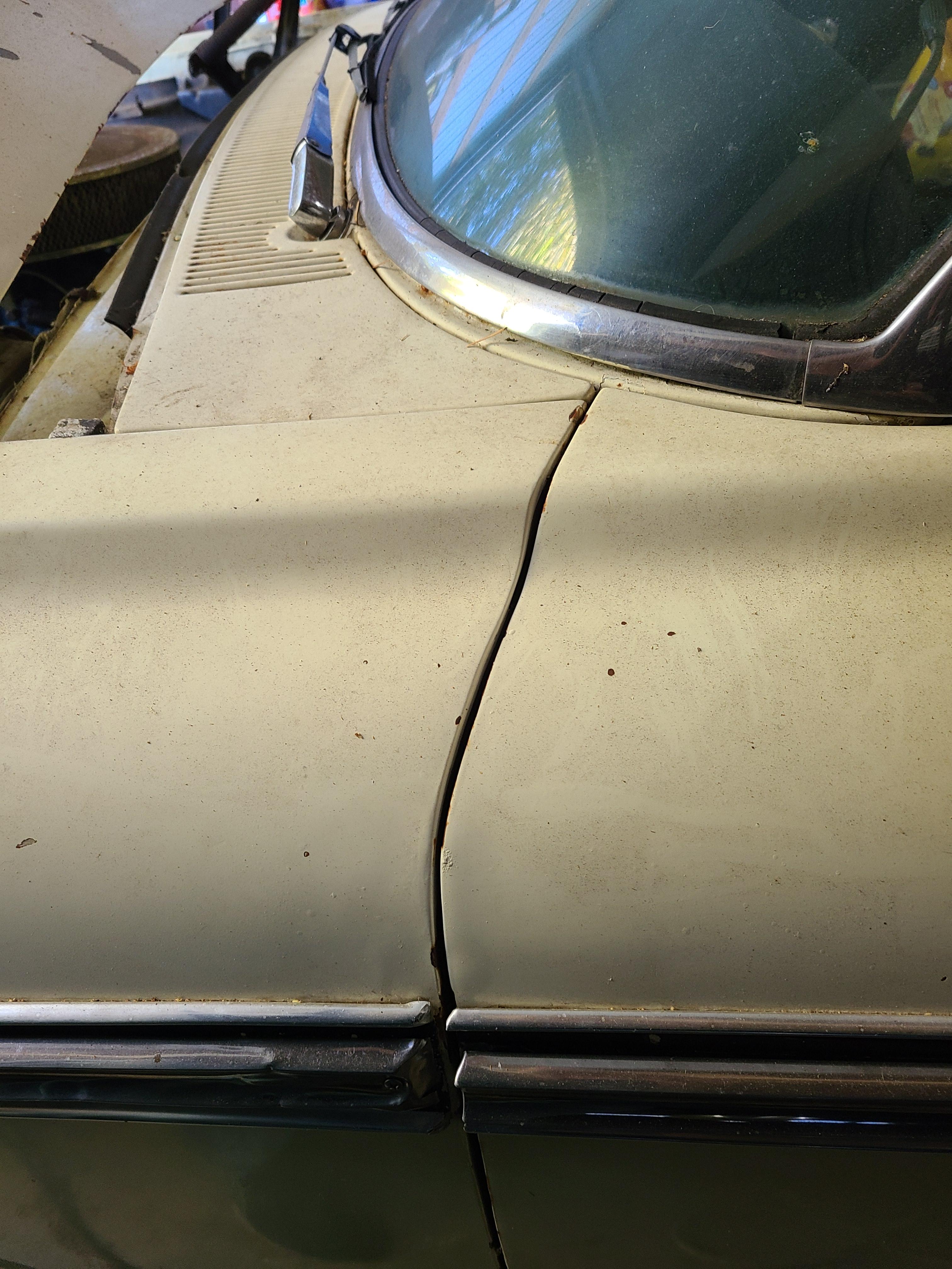

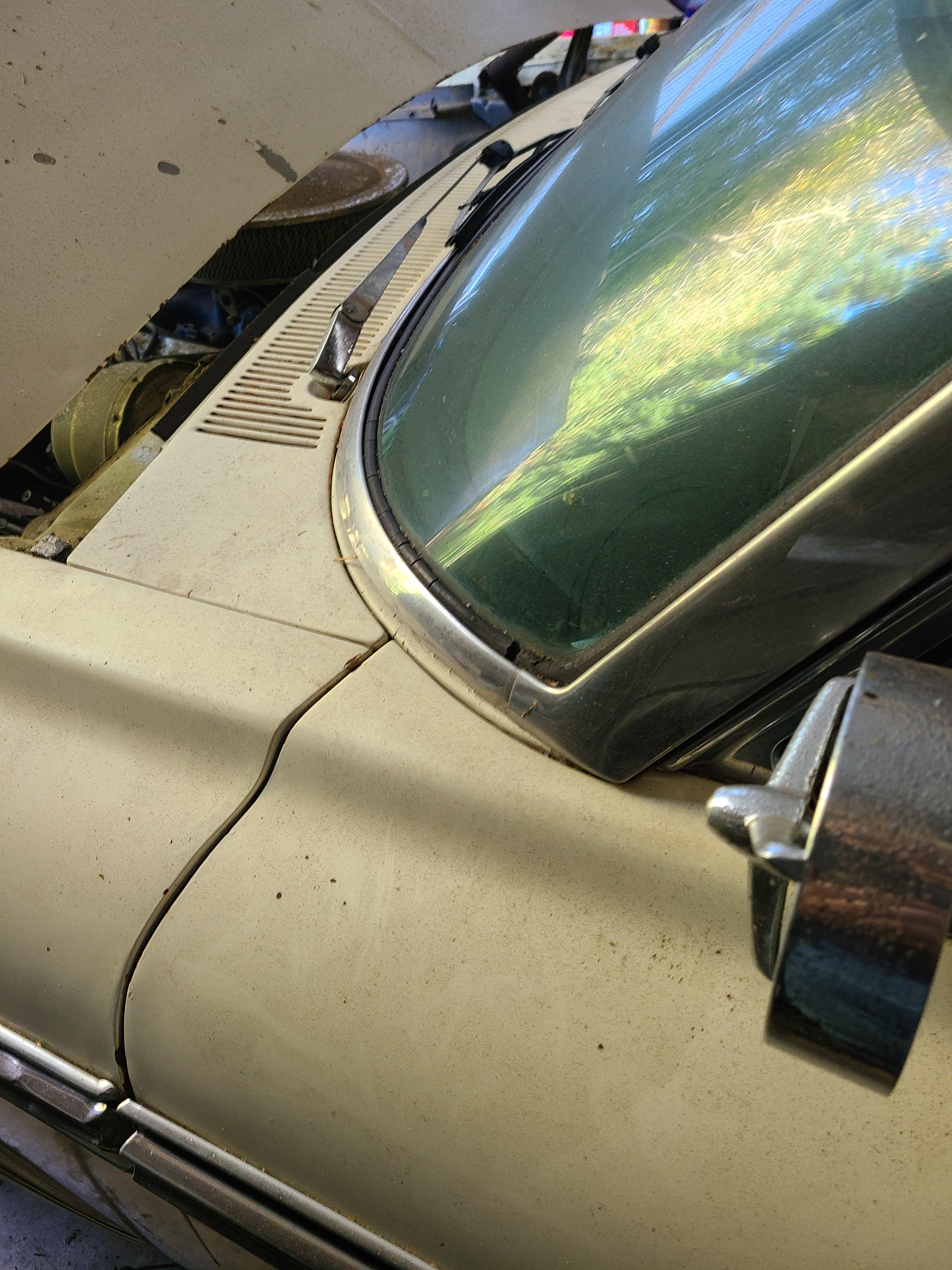

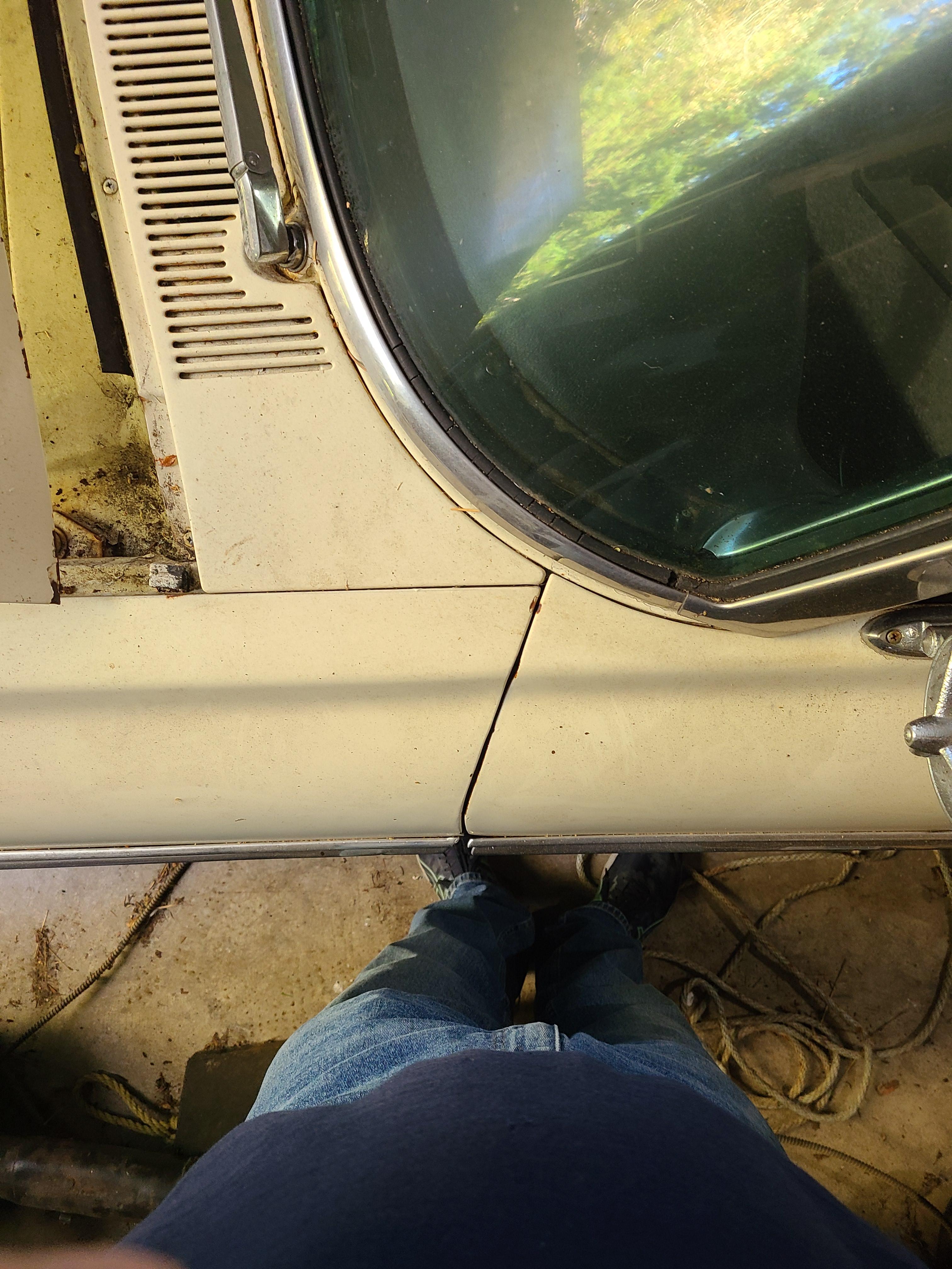

I also had to modify this area on the fenders.
That's not how it is on the full scale car. So, I filed and sanded it down to how it should be. I had to then fill the backside of the bumper to close the resulting gap. While I was at it, I made the slot in the license plate recess. Pay no mind to the bumper being crooked. It's just resting on the mount.

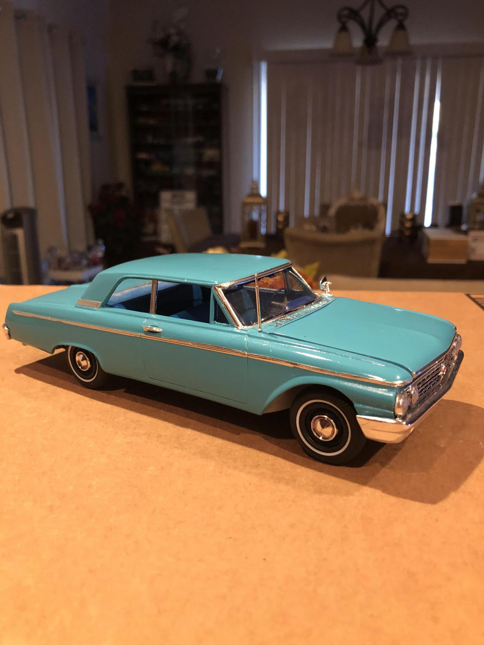

At the rear, I only had to do a bit of work to get the rear bumper and frame to cooperate with each other. I'm going to drop the rear down some more. It's way too high. Hopefully, I can get it down enough without having to do a mini tub.
As you can see in this side view, it has too much rake. I like a little bit of rake. But, this is too much for my taste. I'd like to have it almost level. But, that would require a mini tub. I may just bite the bullet and do it.

Maybe it's just me but that rake looks perfect, gives it that badass stance. That rear 3/4 view couldn't be more perfect to my eyes, WOW!!!!! Everything else looks spot on too. Exceptional work thus far.

On 10/22/2021 at 9:17 PM, afx said:
How is the stance if you raise the front slightly to reduce the rake?
I have the front down where I want it. If I raise it, it'll be too high. I lowered it by flipping the spindles.
Thanx! It would be OK for an old school street machine or drag car. But, it doesn't work for what I want it to look like.
I stuck a set of 19's with a little bigger tires on the rear thinking that would get it where I wanted. It didn't and I didn't like the way they looked. So, I decided to go ahead and modify the wheel wells and lower the rearend. I'm almost done with those modifications. I raised the inner wheel wells 3mms. The rearend will get lowered the same amount with set of lowering blocks. It will make a huge difference in the stance!
Edited by Plowboy
Link to comment
Yeah, I like this stance a lot better! Just enough to be noticeable.
