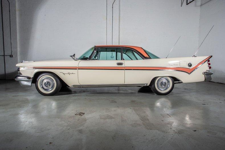

mopargreg Posted October 17, 2021 Share Posted October 17, 2021 Hi everyone, Im wanting to build a 1959 Desoto 2 Door Hardtop. I have a X-EL/Johan 1959 Desoto 4 door as my starting point & a AMT 1957 Chrysler 300 2 door hardtop kit. I'm thinking of cutting the roof off the 4 door Desoto & grafting in the roof off the 57 Chrysler. Question, Where should I make the cuts? Obviously cutting the roof off each at the bottom of where the roof pillars come off the body you will loose some material off the roof. Will it start to look like it has a slight chopped top? Any help on where to cut would be great. Second question, Ill need to rescribe the doors from 4 to 2 door & fill in the old door lines. Can this be done without ruining the side trim? Or is it easier to sand off all the trim & re-make it from thin styrene? Any help would be great. Ive built a lot in the past but never cutup bodies to much. Ive also modified side trims but I usually sand off & start from scratch. Thanks for your help! Quote Link to comment Share on other sites More sharing options...
