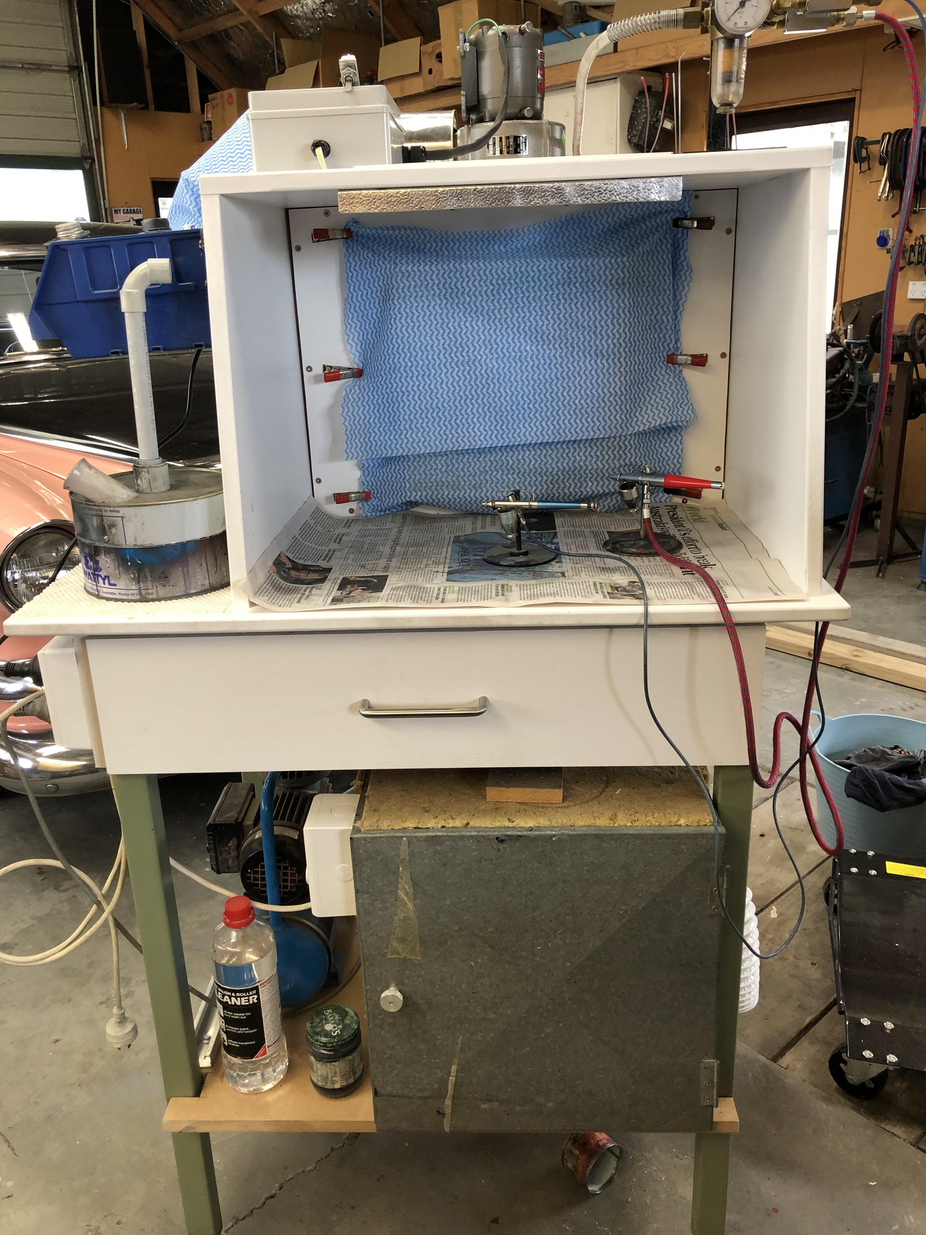

I paint in the garage and have used a light box for years. I paint any time of the year and warm the model and paint in the hot box before painting. It does not get as cold here - 6-8deg C - but I do not have any issues. In fact the light box was a game changer as it does more than warm the paint. It cures the paint quicker than leaving it in ambient air temps. The most important is it decreases the chances of BLAH_BLAH_BLAH_BLAH getting into the paint finish
I recently got around to building a spray booth and incorporated the hot box which is under the booth. I put it on wheels so that I can move it about the workshop and stash it when not needed. The filter is a unit I changed from a air exchange unit in the house. I use throw away wrags that come on a roll as a sacrificial pre filter. The main body of the spray booth is particle board (we call customwood down here) and was titivated with a coat of white paint. I also recessed an LED light into the roof for lighting. I also made up a drawer so that I can stash my airbrushes, cleaning gear, empty bottles and BLAH_BLAH_BLAH_BLAH associated with painting.
The other good thing about a booth is you do not get all the fumes in your face and lungs
The booth has worked fine but I find I still take up space on the bench with paint prep etc
I am sure with your abilities you could coble one together - I just procrastinated as I have had the parts for ages
Cheers
Bill-e-boy

2 hours ago, bill-e-boy said:
Zippi
Cheers
Bill-e-boy
Thanks for the info Bill-e-boy.  You have a nice setup.  I have a 2  1/2 car garage and keep it pretty nice do to the back that I keep my 49 Chevy pickup.  Its a driver but more of a show truck so I can't take the risk of any over spray getting on the finish.  Ill just have to deal with it but thanks for the info.

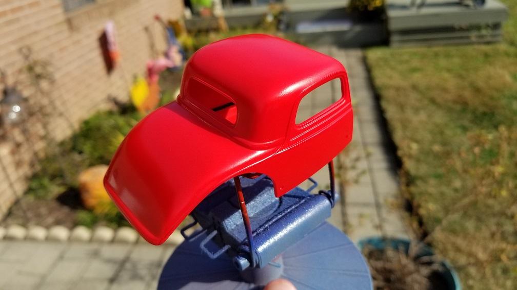

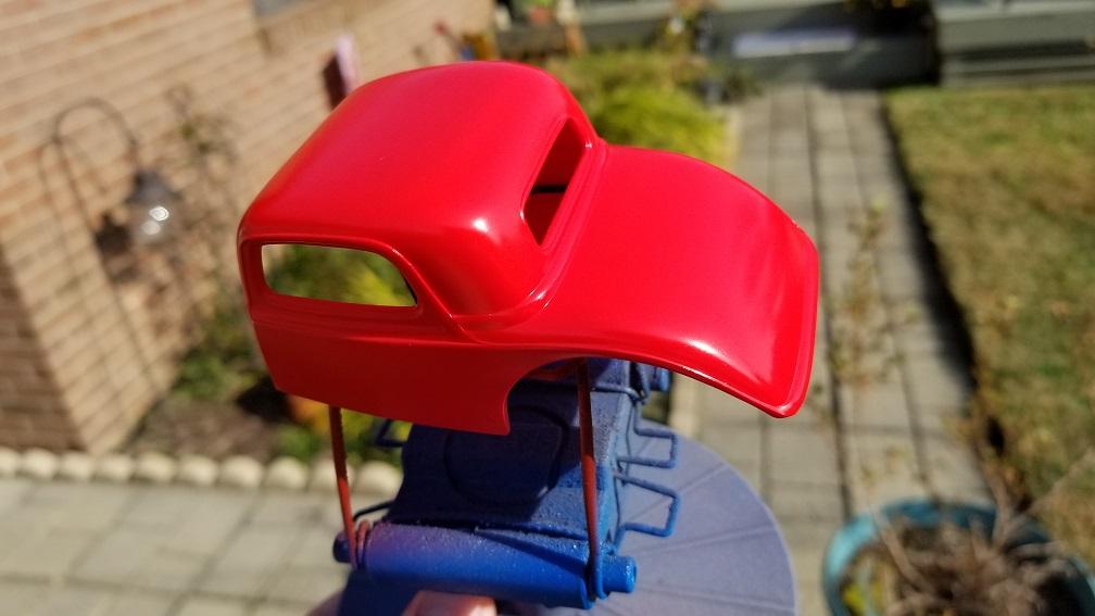

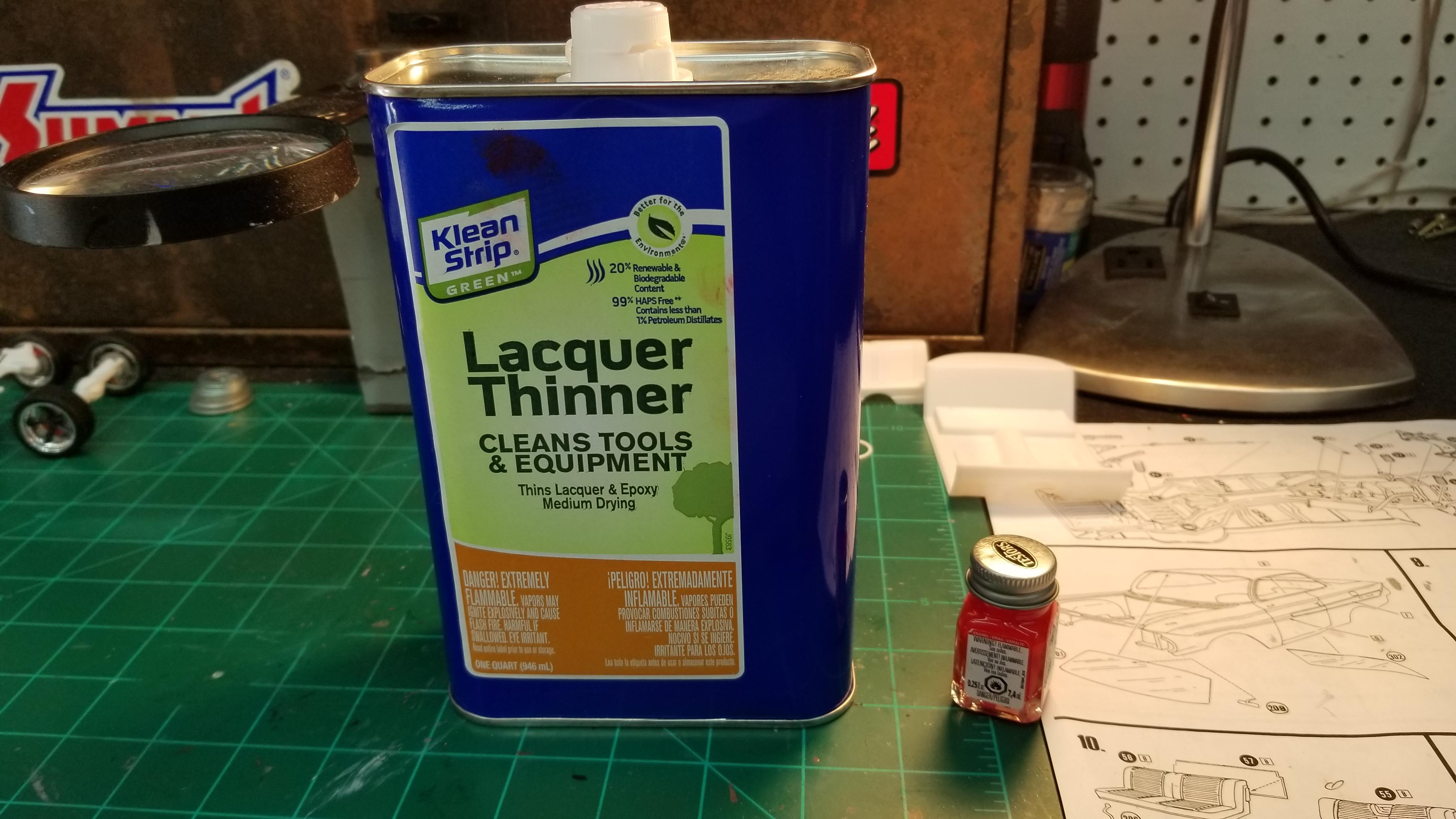

Ok fella's.  It got to 60 degrees and the humidity was at 59%.  Did a little paint testing with Testors paint.  When I tried this some months back it did not go well.  Using my Paasche H airbrush, Klean Strip Lacquer thinner, Testors red paint in the small bottle.  Air pressure was set to 28-32 psi.  I am so pleased with how this test turned out that this is my new paint process.
Edited by Zippi
Link to comment
You're catching on.

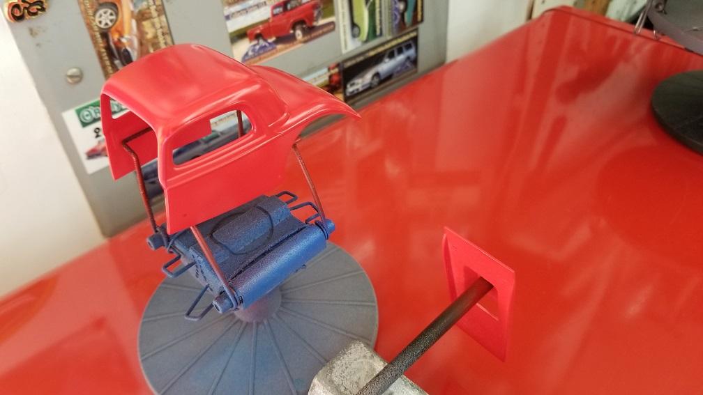

8 minutes ago, Dave G. said:
Not too bad for a dedicated food dehydrator, cut the racks to fit parts. Just make sure it has temp control. One guy over in FSM forums made one from a box, put a computer fan in it and a light bulb. All he shoots is enamels. I shoot everything, poly acryl, acrylic, lacquer, enamel, acrylic craft paint. I just use the kitchen air fryer that has a setting for dehydrate. I give enamels a 2-3 hour bump in the cure time, that way in a couple days can move on to building but you can handle without finger prints the same day.. Full cure is more like 6-10 hours but certainly by overnight, 108- 110f.
Ok....here's my "poor mans' dehydrator ☺☺☺
Link to comment
