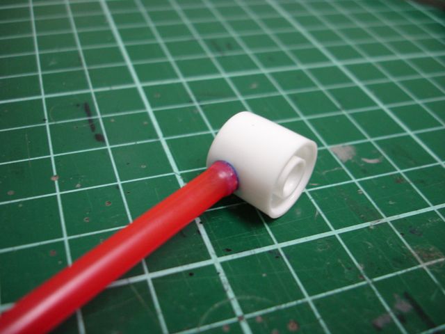

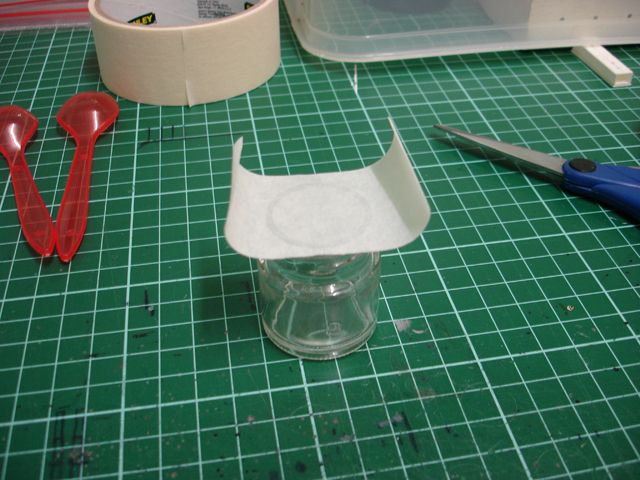

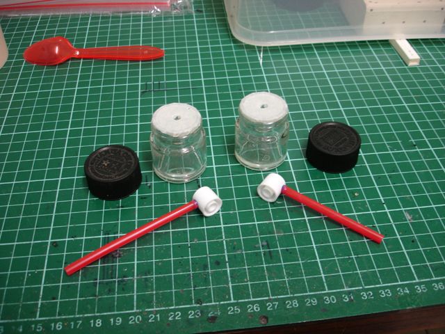

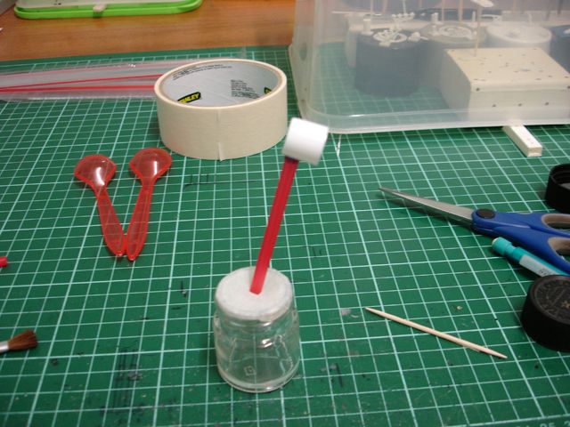

For small amounts of decanted paint I recycle Tamiya acrylic jars.
Bit of tape over the top.
I found some plastic straws that are a good press fit over the Tamiya nozzle, I super glue around the straw to seal and lock in place.
Also helps to add a few vent holes to let the excess gas escape.
After decanting into the jar, I pretty much do the same as Trevor.
Wait 30 mins, then occasionally stir gently until paint bubble's to near top of jar, stop and then let it settle back down. Repeat until its fully gassed out before pouring into airbrush paint cup.
