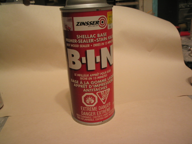

Can-Con Posted November 25, 2021 Share Posted November 25, 2021 I've been using this stuff for about 30 years. [geesh, now I feel old 🤨] works for me. prime first with whatever you usually use. BIN won't stick to bare plastic unless it's primed or completely sanded. Easier to just prime. I comes out of the can like a fire hose so better to decant it and spray with an airbrush. I just use regular rubbing alcohol to thin it and for cleanup. Also blocks hot lacquers. You can spray heavy wet coats of auto lacquer or HOK over it without damaging the plastic. Quote Link to comment Share on other sites More sharing options...
Dave G. Posted November 25, 2021 Share Posted November 25, 2021 (edited) 20 minutes ago, robdebie said: There's a recent thread on this. My contribution was that I read a paint technology book that said that the typical red dyes in plastic are easily dissolved by paint thinners. and then move to the paint surface. I would use a water-based acrylic as primer, and then be very careful with the next layer(s) that contain solvents. Rob This is basically right. I'd use Stynylrez primer which is an acrylic poly resin primer/sealer. Or the Zinsser mentioned already. If you use a platinum silver paint over that you should see if the red came through or not, to which it shouldn't in either case. Then be good to go with white. Edited November 25, 2021 by Dave G. Quote Link to comment Share on other sites More sharing options...

Michael jones Posted November 25, 2021 Share Posted November 25, 2021 (edited) If you spray the paint a bit too wet, it can reactivate the paint/primer below causing this issue. Zinsser bin works great through an airbrush but terrible from the can. It works well because it is shellac based so not so affected by lacquer thinners inside the base coat/ clear coat. Edited November 25, 2021 by Michael jones Quote Link to comment Share on other sites More sharing options...
SfanGoch Posted November 25, 2021 Share Posted November 25, 2021 If no one was aware, Rustoleum/Zinsser produces Zinsser 408 Bulls Eye Clear Shellac Spray. The surface doesn't require priming before application. Quote Link to comment Share on other sites More sharing options...

Michael jones Posted November 26, 2021 Share Posted November 26, 2021 (edited) I for one don't think plastic dye leeches out into the paint. From my observations it is simply that if you use all lacquer primer and paint over red plastic, you can reactivate the paint below causing the red to show. This can even happen when applying the clear coat (and even 2k!) I have seen this on other coloured plastic before as well - not just red! That is why bin zinsser is very effective at stopping this happening. Edited November 26, 2021 by Michael jones Quote Link to comment Share on other sites More sharing options...
