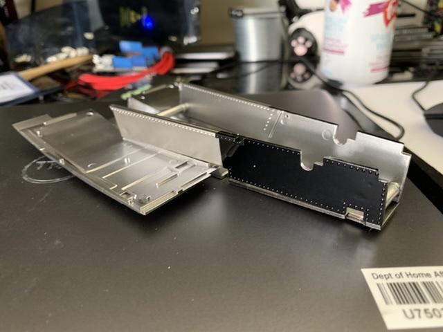

Work out if the already glued bits are “close enough”.
Dummy fit, and eventually glue the large monocoque sections.

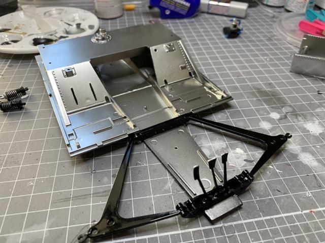

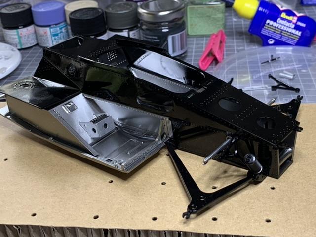

Start with the Gloss Black painting (using Zurc Gloss Lacquer)
Definitey black!
Suspension arms and quite a few other mechanicals are gloss black on these.

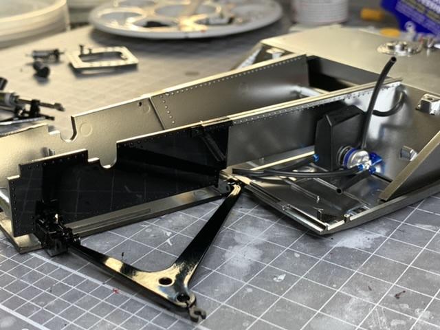

Over the gloss black base Zurc Hyper Silver gives a bright alloy finish.  Some sections are left black as they are not covered by other bodywork.
1BB15A11-F9D4-4EA8-B0EA-7F3BB892AEE4.jpeg.36cc771996377c759b32b0146a1ce2ad.jpegB2430621-BC4B-48F3-9146-16B5FCC65706.jpeg.d7dde47e8c3a5195a63fc8b3033d52d6.jpegCC3F2E12-F961-44BC-8EB4-4E84DF5A722D.jpeg.70741b84cd4ad9e3659cb1661362b535.jpegBuild up small details.

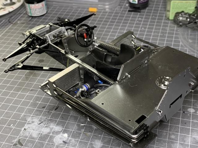

Like all Tamiya kits the out of box detail is great, but it still takes filler and sanding to bring out the best.
Trying to up the details a little without going too far.
96A61997-3340-47ED-A4E6-771417C0DEB4.jpeg.6466dd24e366ba233105ea1e6e6640d9.jpeg9D91B698-1919-439A-9777-44F79E112714.jpeg.54a9dfa71012bb9d4d988eb98d5ce46e.jpeg
Its such a contrast between the livery and the chassis.
Starting on the radiators.

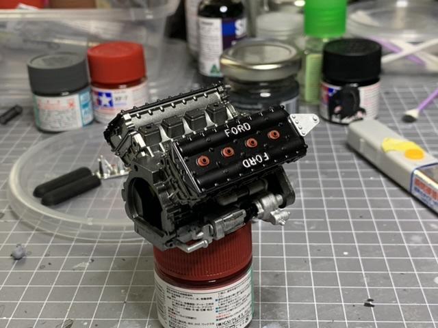

Engine and gearbox coming together.
Front of the chassis nearly done.
Awesome details in the kit.
Engine parts
ancilliaries are go!
