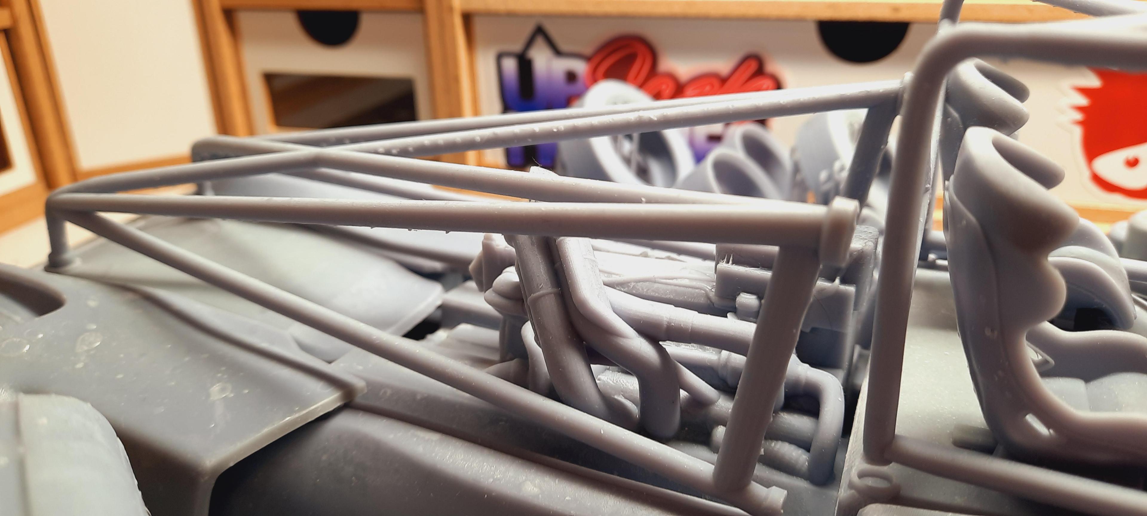

For the interior, there are three individual print files, the floor, the rollcage ( it has a full rollcage) and this preview of the dash and steering wheel. I did not like the "stock" seat the truck came with so I upgraded to a set of seats I had from another creator only cause I think they're more realistic looking than the stock seat. I also added in some Sparco racing pedals (small box looking thing to the left of the steering wheel) since the floor has two rectangles molded into the floor for the pedals and I wanted something more racey looking. I'm also printing off a first aid kit box, just for some extra interior detail.

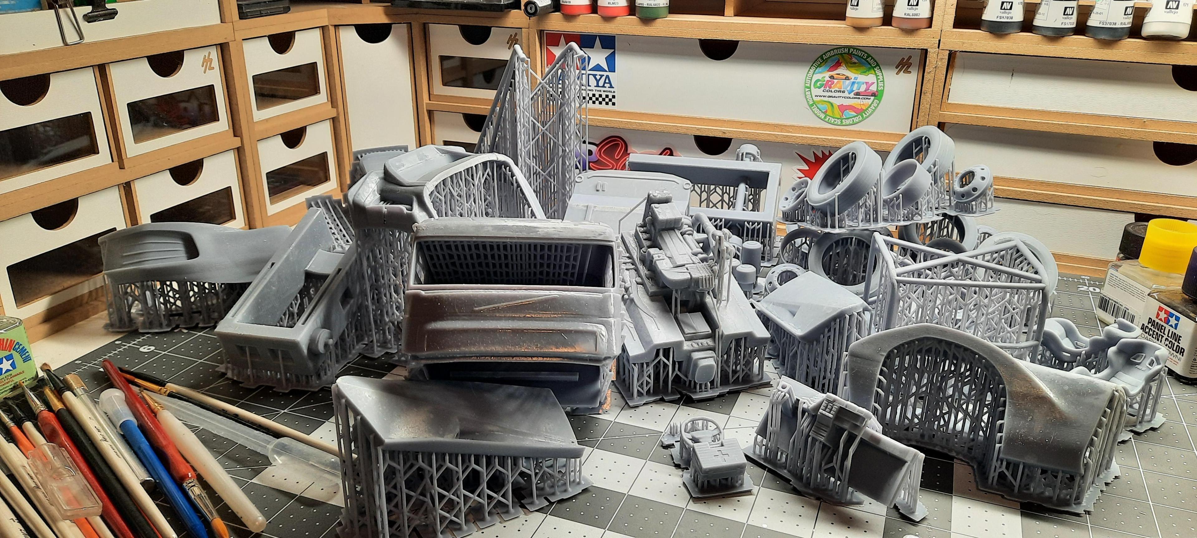

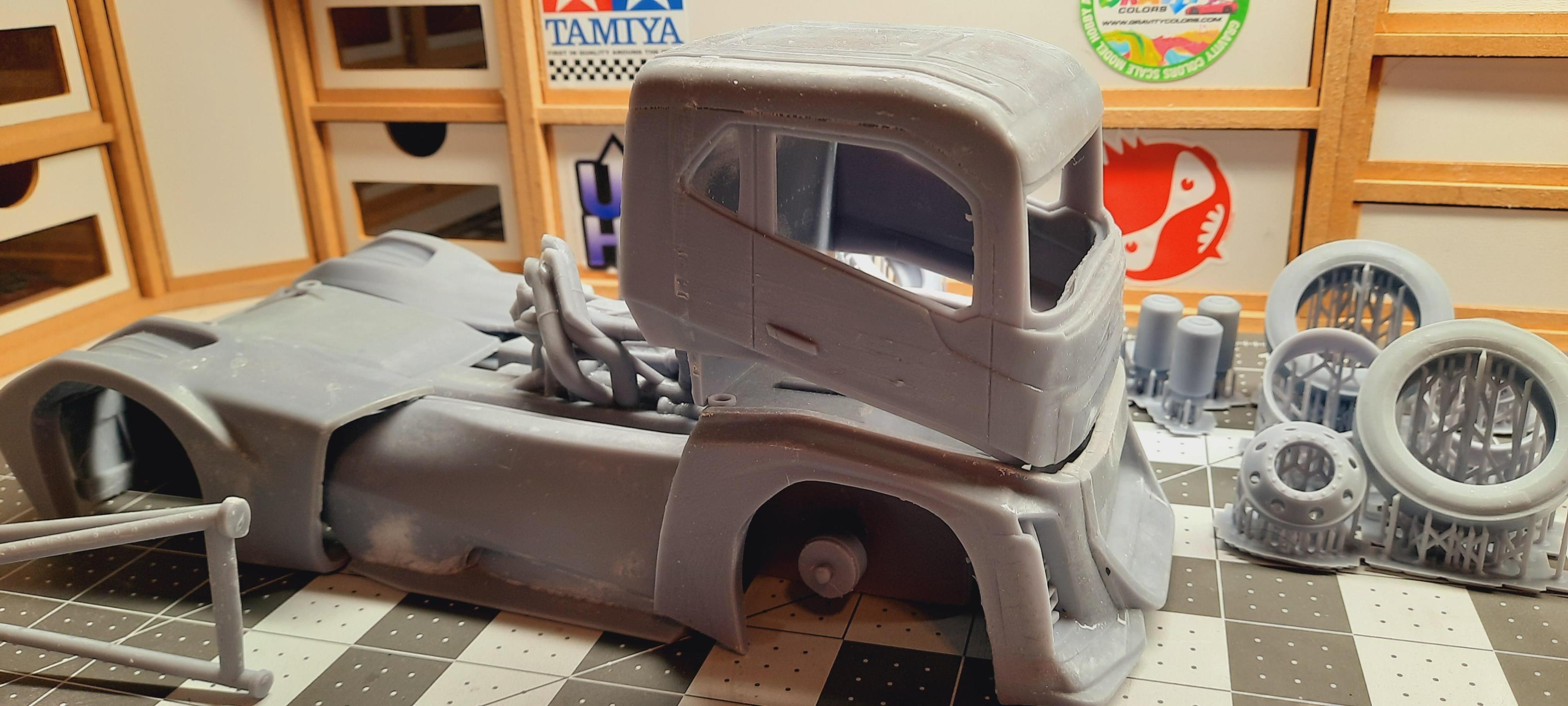

Here is a shot of all the parts out of the printer. I purposefully left all the supports in place to make sure nothing warped, but all these parts are pretty beefy so probably wouldn't have happened.
So.....

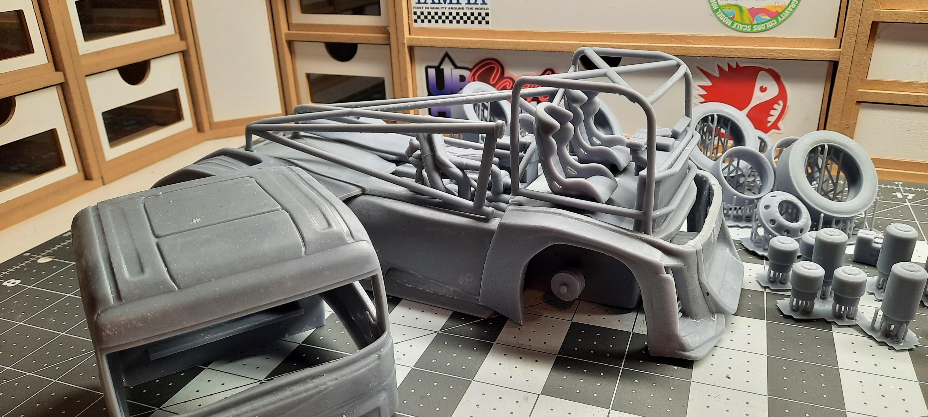

I have removed all the supports and have mocked up the truck parts. I am very pleased so far. Everything lines up pretty good. There will be some sanding and filing involved but I've seen plastic kits way worse than this..
At the moment I can not get the cab onto the interior floor pan without some sanding and scraping so that's up next. But everything else lines up decently enough.
Also you can see the support nibs left on some of the parts. I have not sanded anything as of yet so there is a lot of clean up to do. And as you can see I've not tackled the wheels/tires yet either.
The engine is one big block of resin sitting behind the cab and is decently enough detailed, but I'll add in some wires/hosing as I go to make it more interesting.

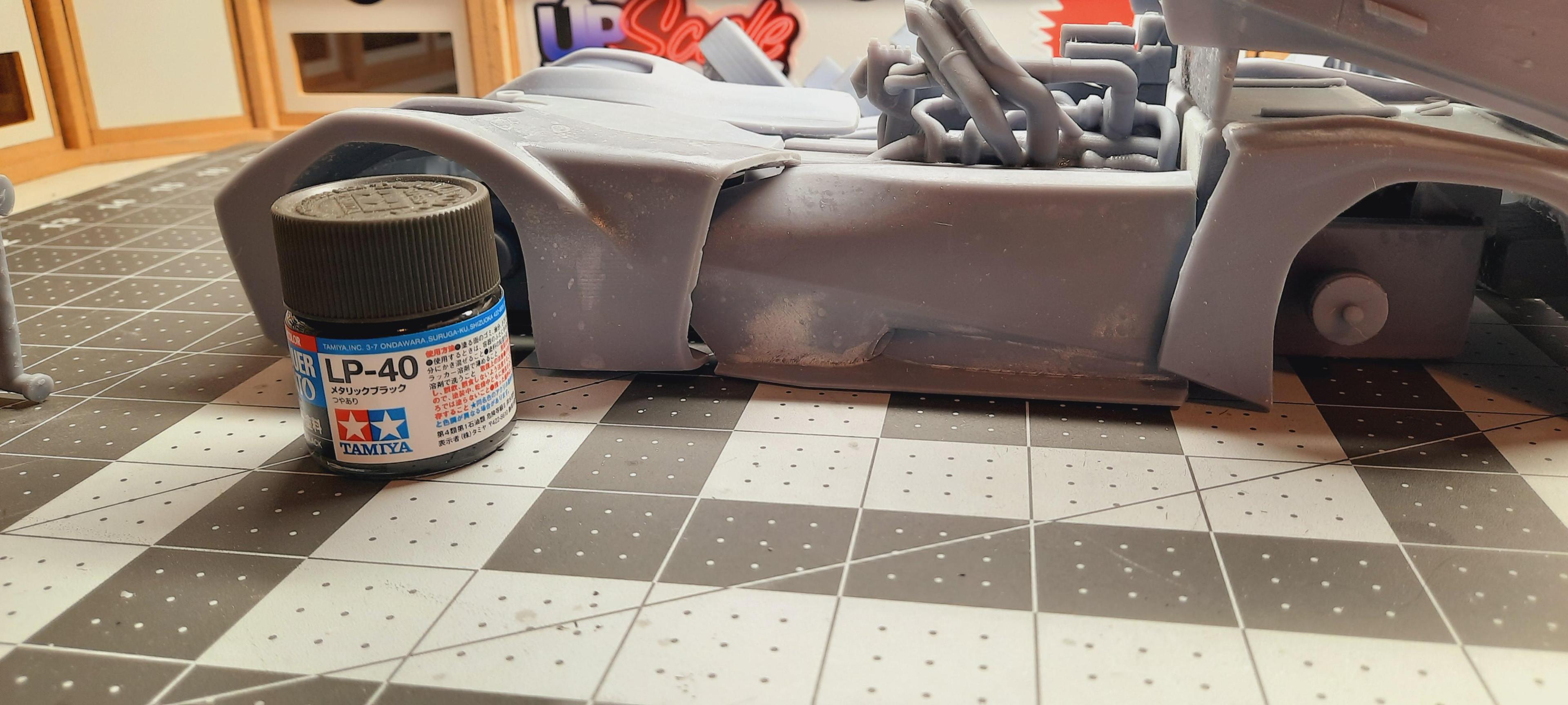

I added in a bottle of Tamiya LP paint (same size as the acrylic jars) so you can get a sense of the size of this thing, it is as big as a 1/25th scale Tractor.
The discolouration on the parts is from my vat of IPA being pretty dirty and didn't do the best job cleaning the parts. Not a big deal as I have to sand everything down and will wash all the parts again before primer and paint anyways, it just doesn't look pretty. Only the parts on this build looks that way, recent prints are much cleaner looking...it was just me being lazy and not swapping out the IPA.
Cab not quite fitting over the interior pan....

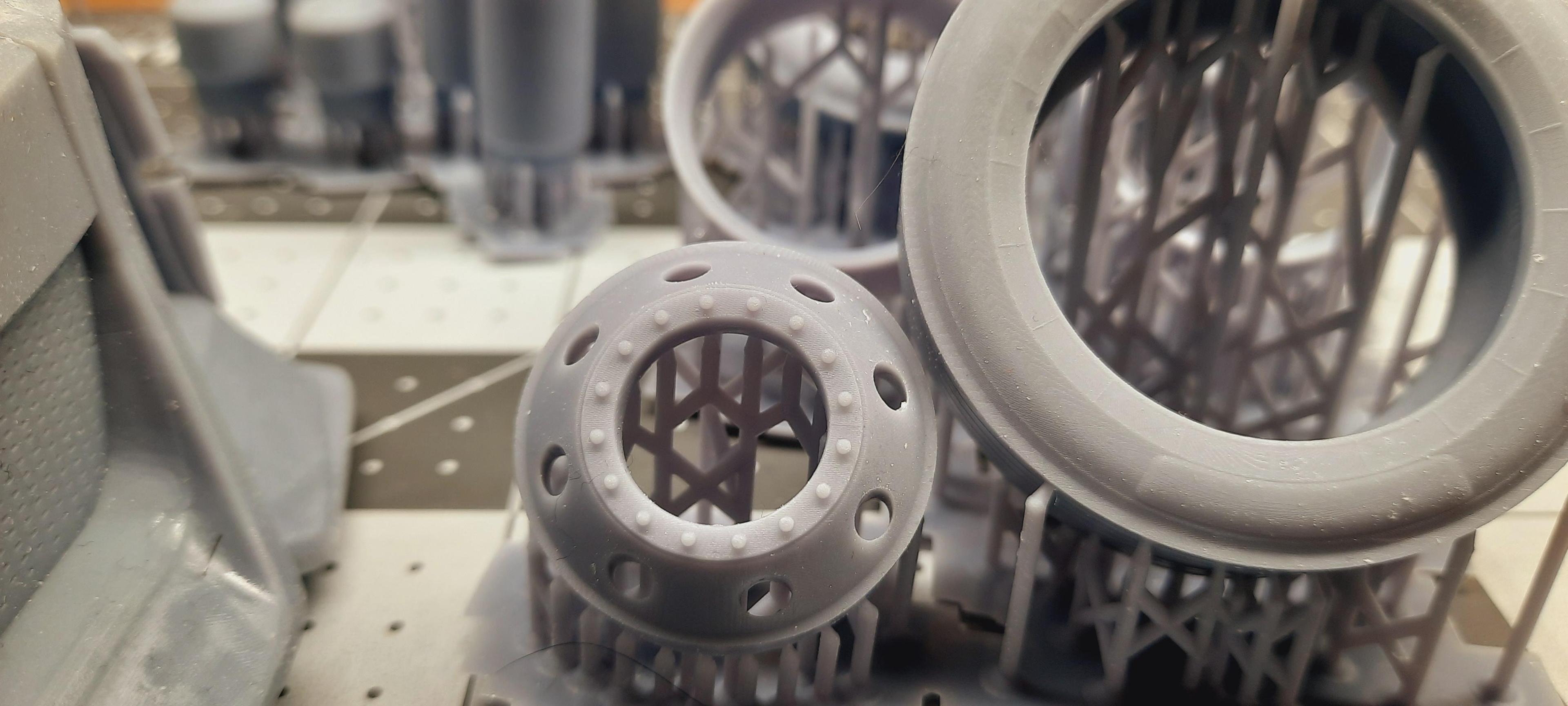

A close up of the detail on the wheels/tires..
