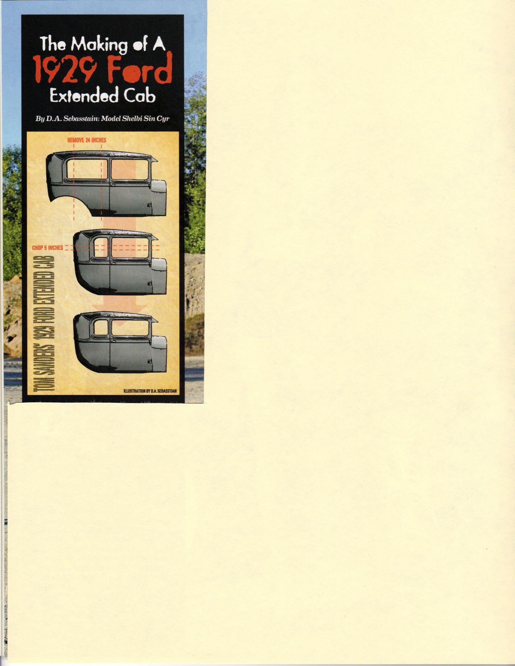

Kit Karson Posted January 7, 2022 Share Posted January 7, 2022 (edited) COMMON KIT CLASS: The Common Kit for GSL-XXVIII is the Revell 1929 Ford Model A Roadster (kit #RMX854463). The intent of this Class is for each entrant to start with the same kit, then display their widest array of individual creativity, craftsmanship, building skills, and technical innovations. The entrant may build the entry in any style or vintage. Regardless, all entered models must be based upon the parts from this kit. Entrants may also: i) swap parts from any other kit(s); ii) use any aftermarket parts (except for complete aftermarket resin bodies); and iii) use any building materials, techniques or technologies without restriction. Starting with an original AMT '28 Ford Sedan body & doors sent to me several years ago from another brother from another mother out in Portland, OR. The body has been around the block and back! But way too kool to leave in the body bin, right? After a couple of weeks in the purple pond (no kidding) Lots of scrubbing... Kouldn't get the top striped! Here's the plan: Here's the inspiration: Edited January 7, 2022 by Kit Karson Text correction... 5 Quote Link to comment Share on other sites More sharing options...

Kit Karson Posted January 18, 2022 Author Share Posted January 18, 2022 (edited) Here are the step-by-step pics of the '28 Ford Sedan De-Construction: Cut measured strips of masting tape to create uniform cutting guidelines: The same width was used all the way around: Started by cutting alternate places to retain as much of the intrinsic strength as long as possible: Making sure that the cuts through the C-Pillars are cut all the way through... Just about done decapitating the Model A's top! Thought about stopping right here and going with a Chopped Model A Sedan! ...but, NO! We will be sticking with the plan!!! Lining up the cutlines across the first section cut: ...then lining up the parallel second cut... ...made sure that the cut lines were made as close to being right angles to each other! Let's check... Looks close... Let's move on with shortening the body... Off with the backend... Now, let's build the XPU Cab! Clear tape will assist in lining up the aft cab... Set it together and apply some adhesive... Check door fit... Rubber band the forward cab to the A & B Pillars! How does it look so far? We'll leave it here for a little while to let it setup... Edited January 18, 2022 by Kit Karson Text correction... & Picture addition 5 Quote Link to comment Share on other sites More sharing options...
