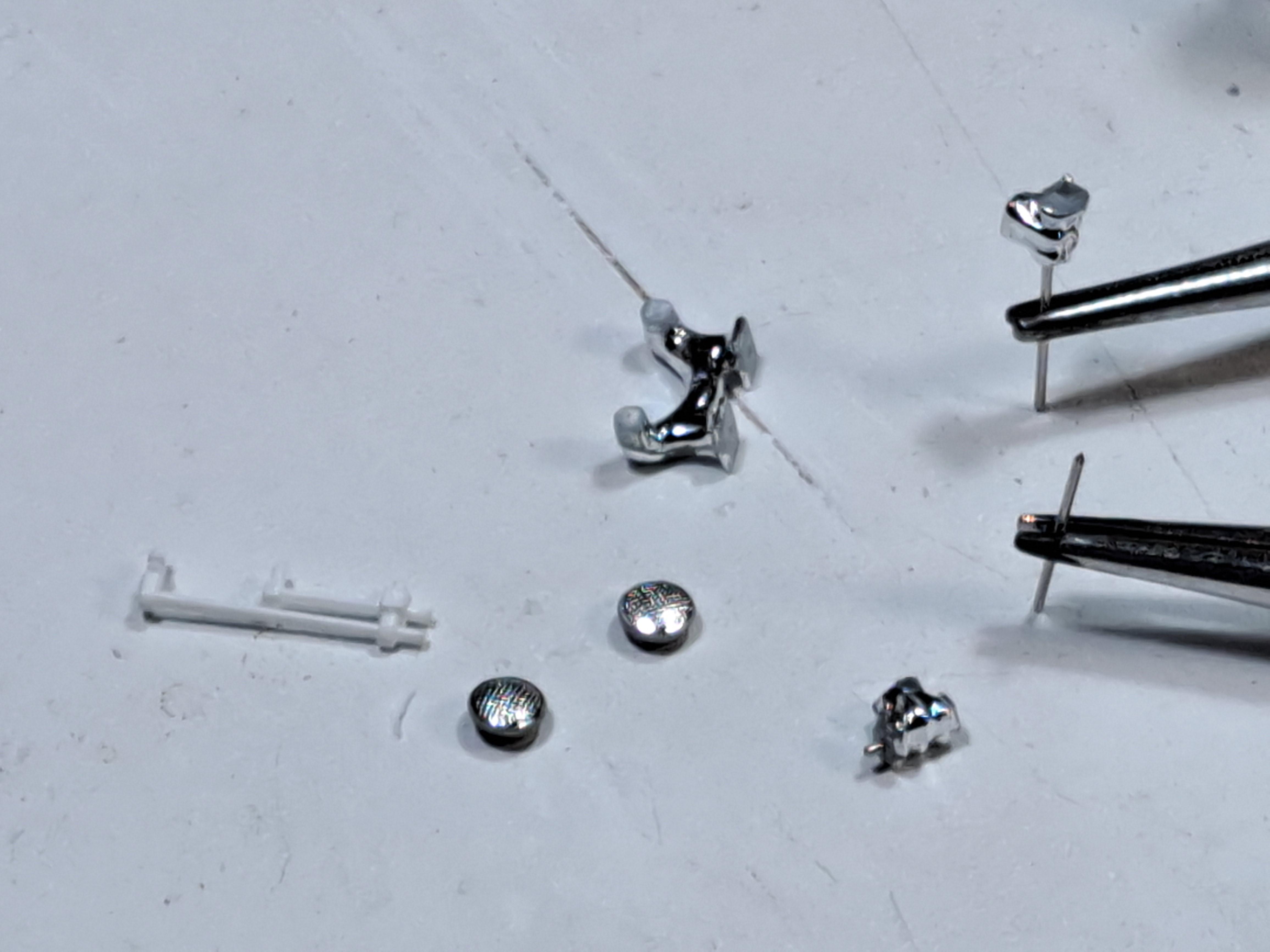

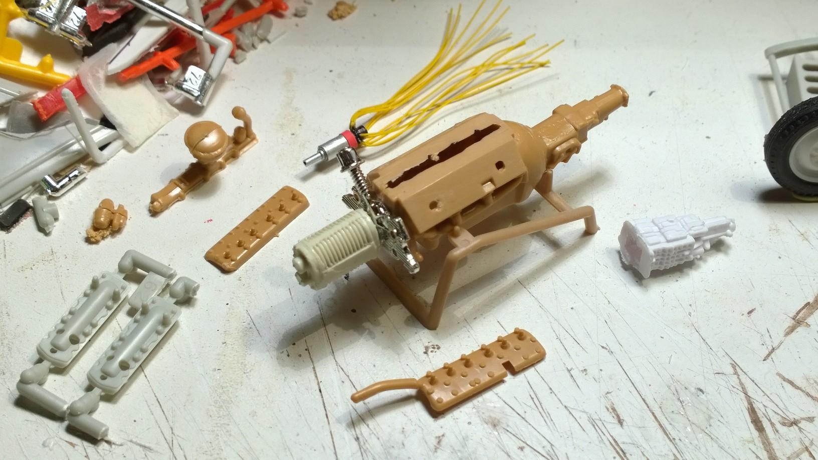

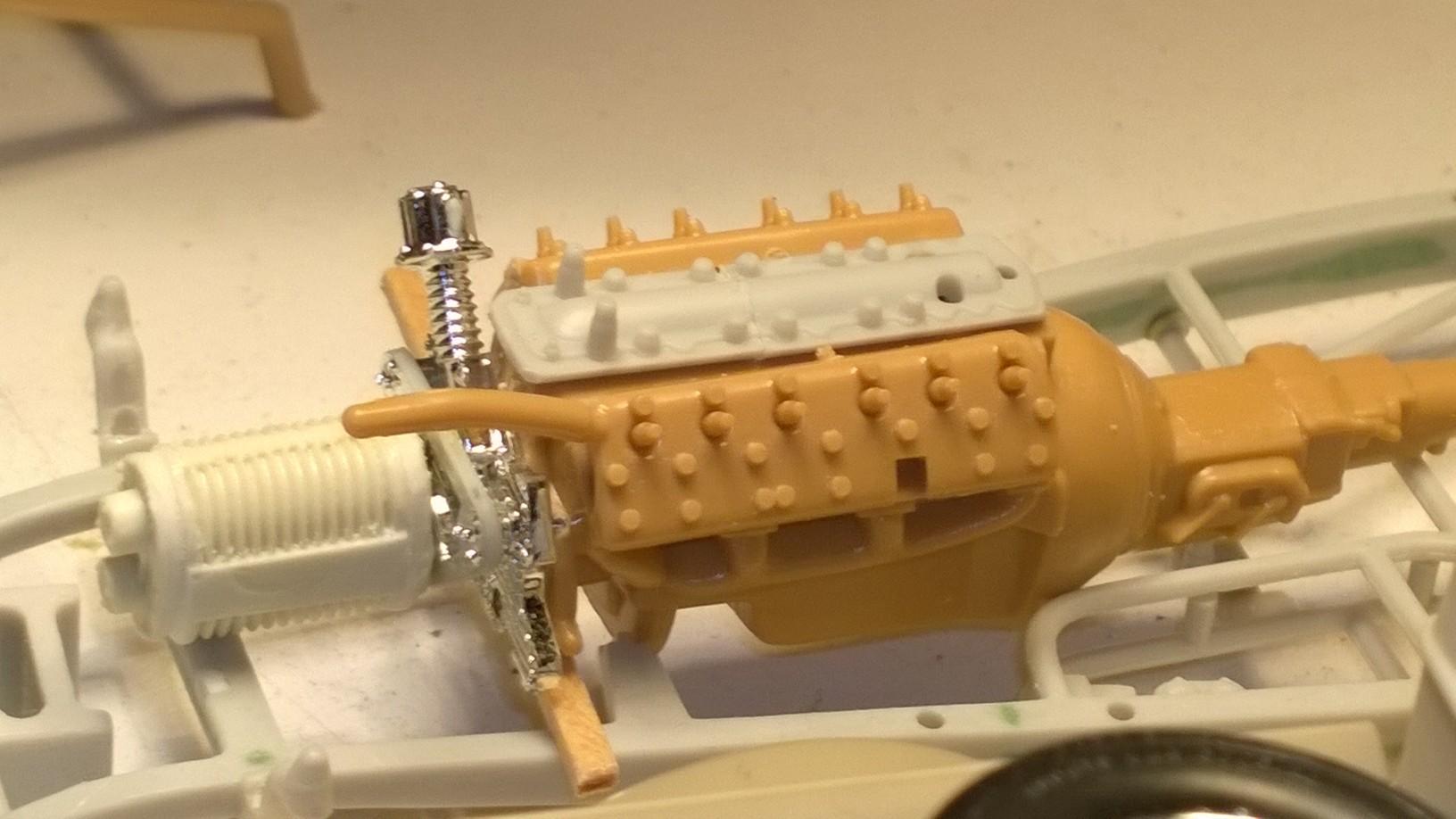

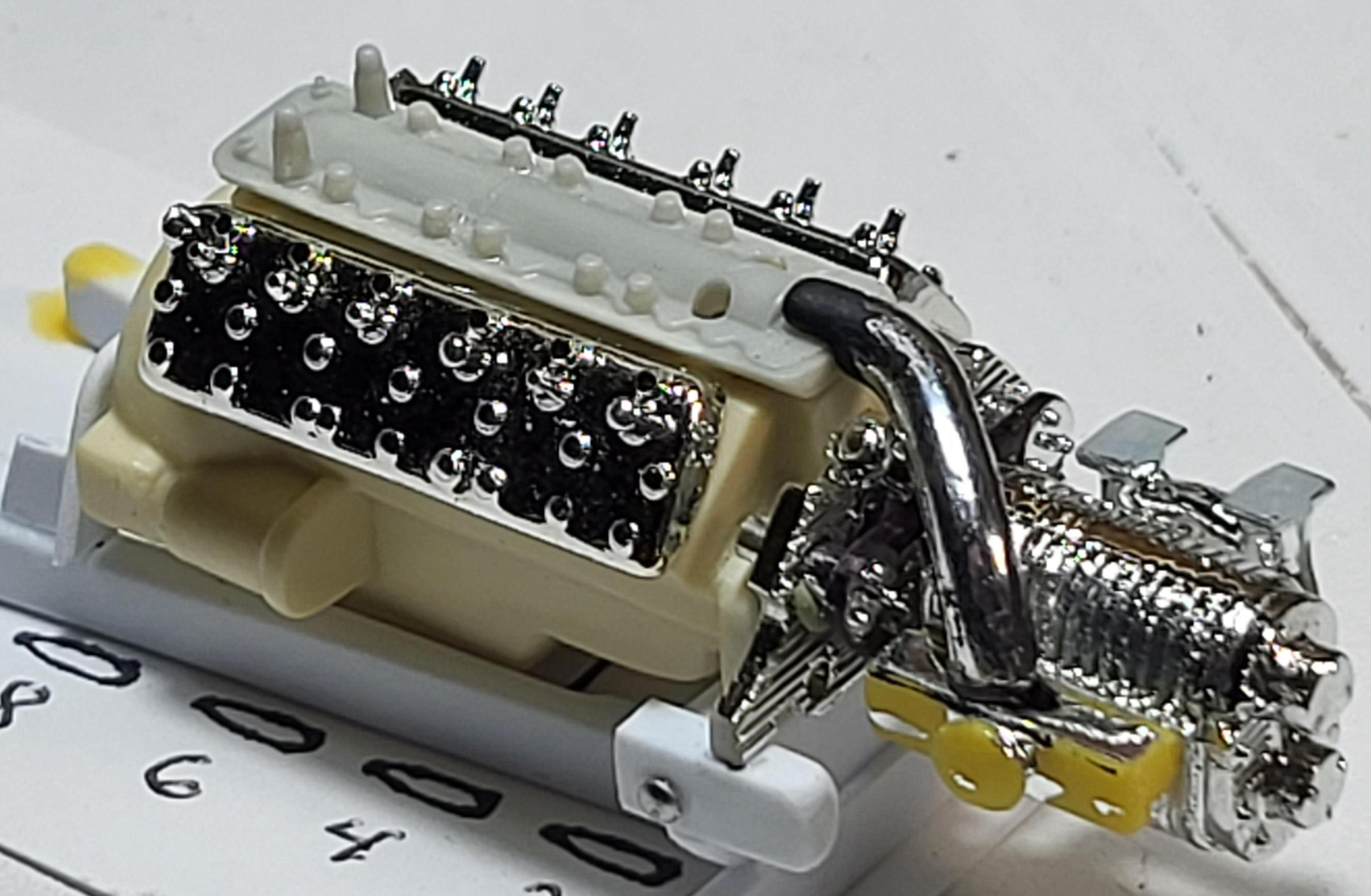

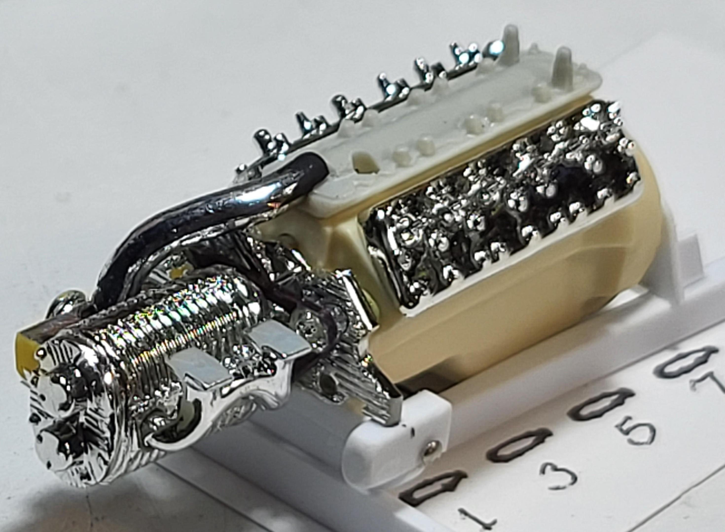

Kit Karson Posted November 29, 2022 Author Share Posted November 29, 2022 Took a header break to play with the S.Co.T. Blower... S.Co.T. - Supercharger Company of Turin (Torino), Italy Revell Model A Dual Karb Manifold... Single Barrel Karbs from the Revell Model A... Fuel Log from the parts box unknown source... Stacks from the AMT Beverly Hillbillies kit will become screened velocity air cleaners... Let's mock it up... More drilling & pinning... Cut down the stacks... It's going to look nice... A bit too shinny? -KK 3 Quote Link to comment Share on other sites More sharing options...

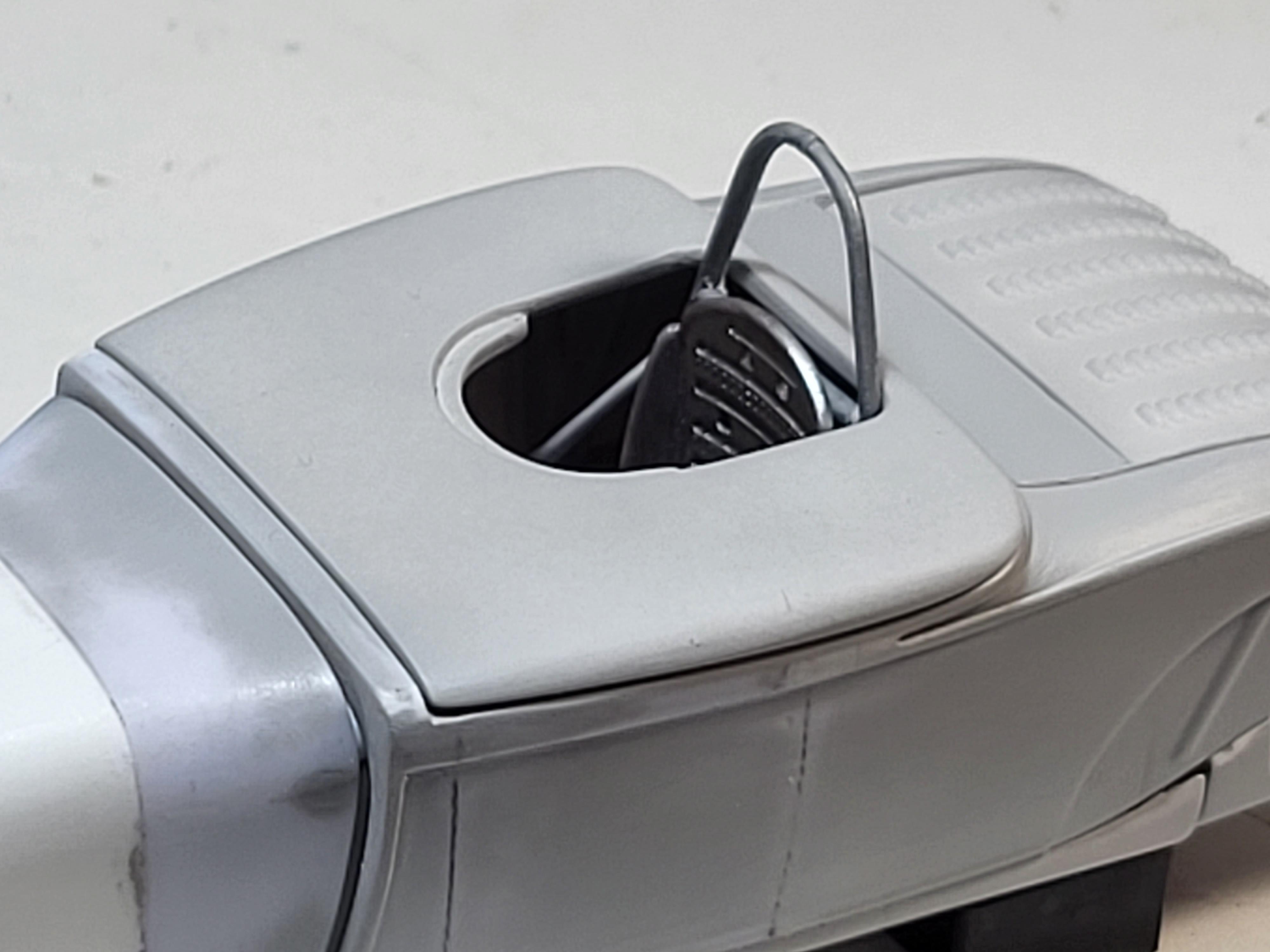

Kit Karson Posted March 8 Author Share Posted March 8 Detailed the Bomber Seat... 2 Quote Link to comment Share on other sites More sharing options...

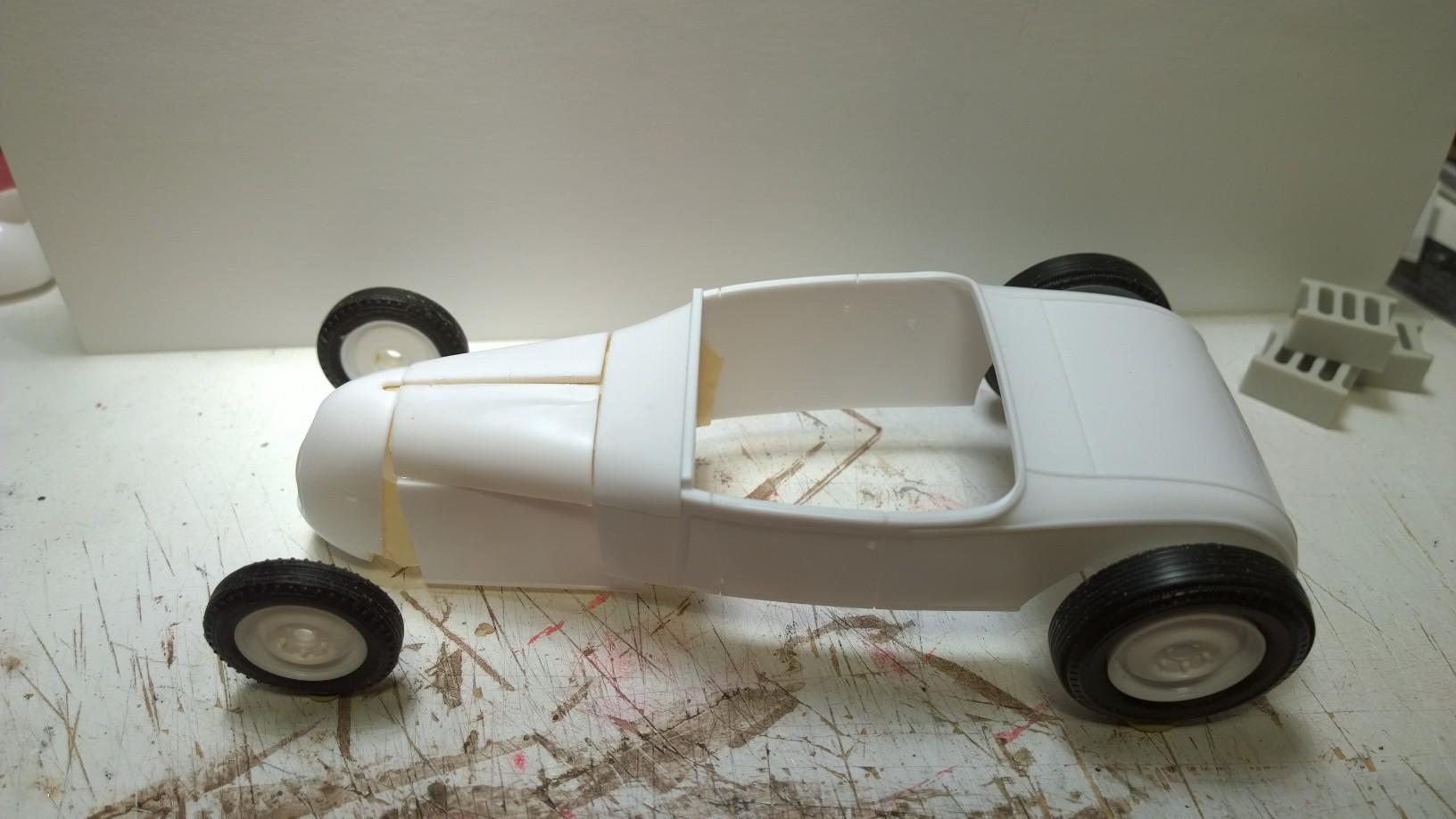

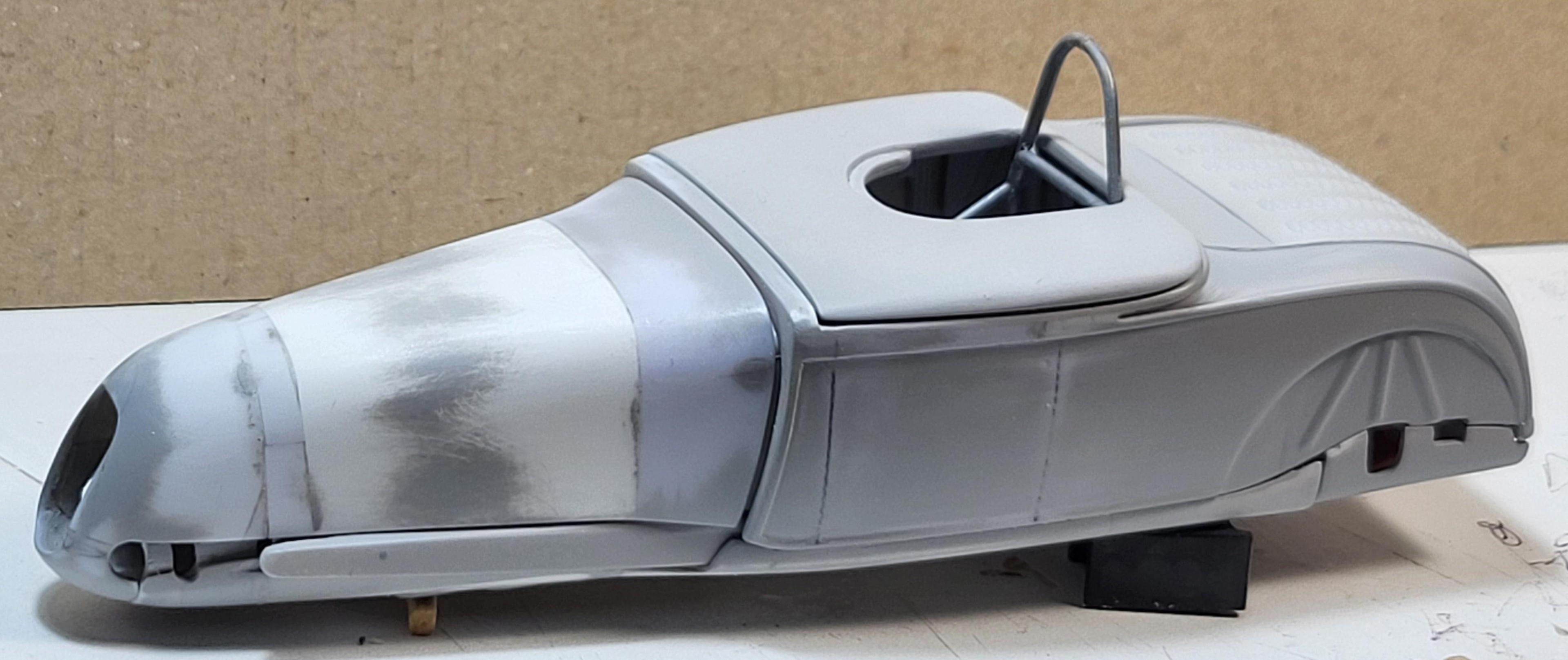

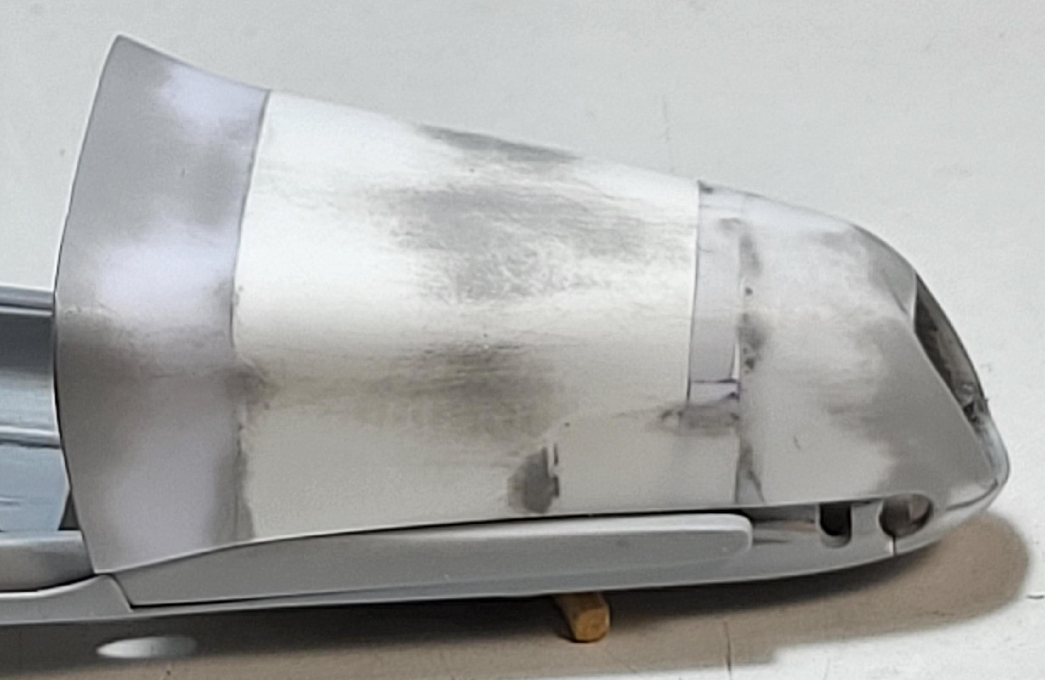

Kit Karson Posted March 24 Author Share Posted March 24 '29 TNR gets a light primer koat: 1 Quote Link to comment Share on other sites More sharing options...
absmiami Posted March 25 Share Posted March 25 Seats look really good - how do you apply the AK metal - is it brush painted or rubbed on ? Quote Link to comment Share on other sites More sharing options...
Kit Karson Posted March 25 Author Share Posted March 25 (edited) 12 hours ago, absmiami said: Seats look really good - how do you apply the AK metal - is it brush painted or rubbed on ? Brush & Rub Wax Edited March 25 by Kit Karson Text correction... Quote Link to comment Share on other sites More sharing options...
Kit Karson Posted April 1 Author Share Posted April 1 '29 TNR & '29 XPU in Primer for the 2nd time... 3 Quote Link to comment Share on other sites More sharing options...

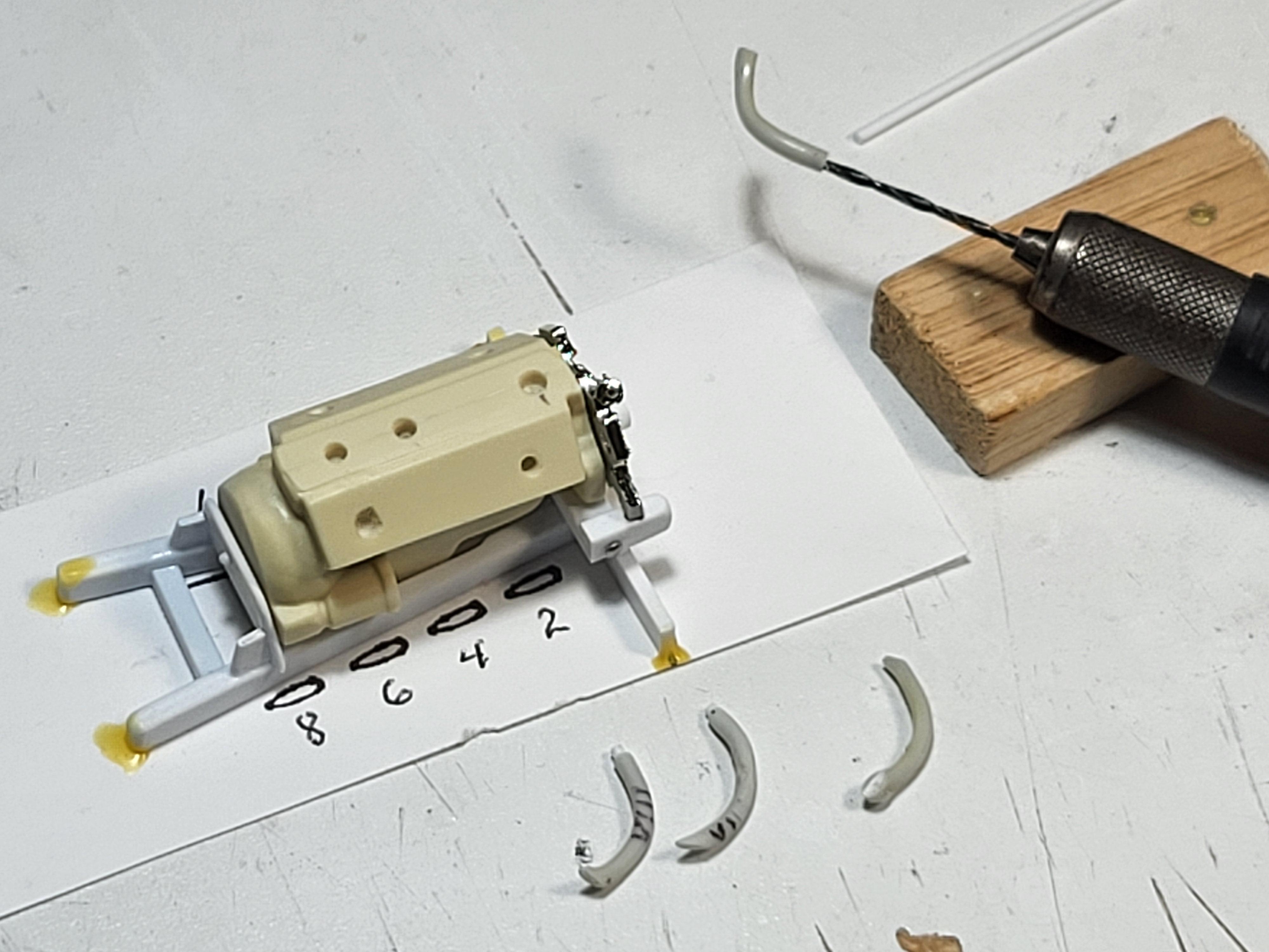

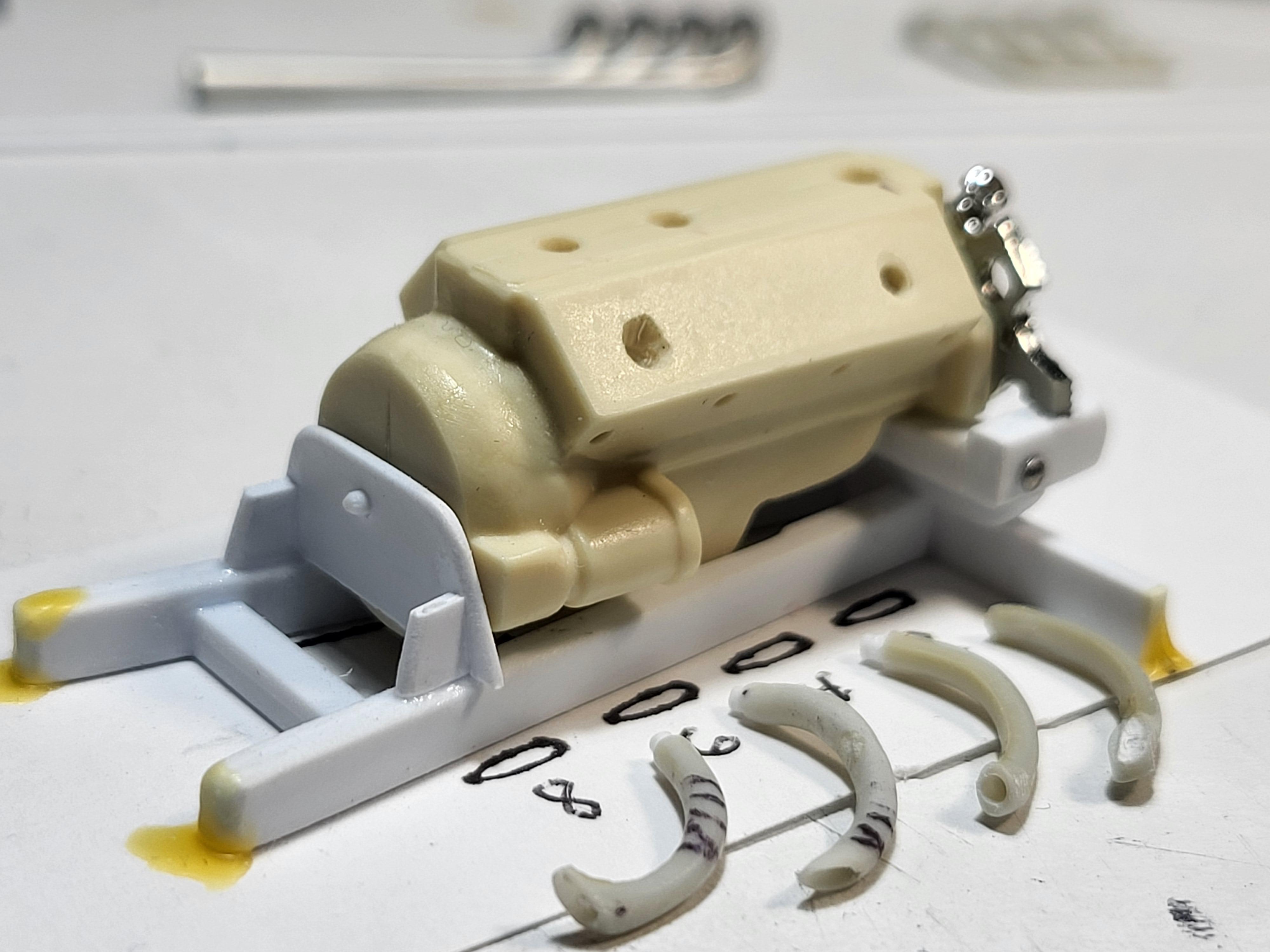

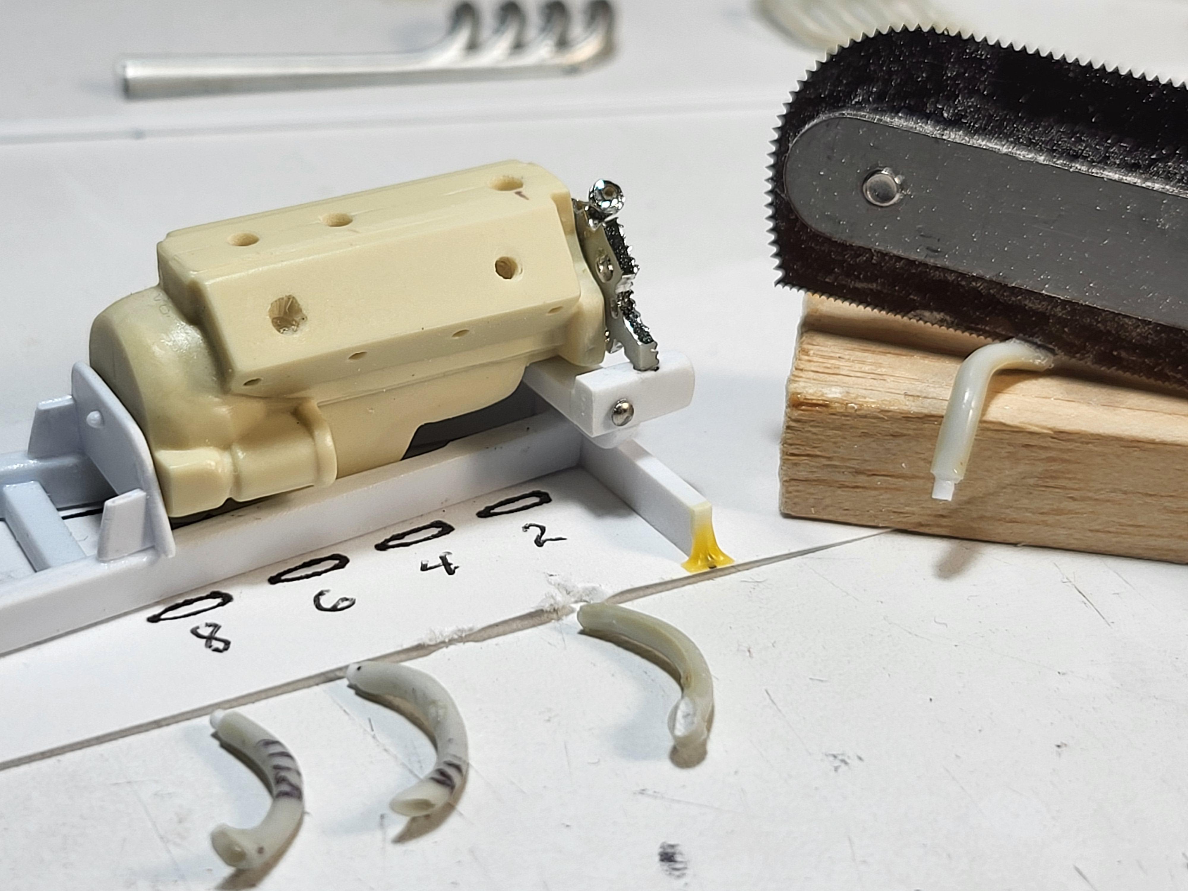

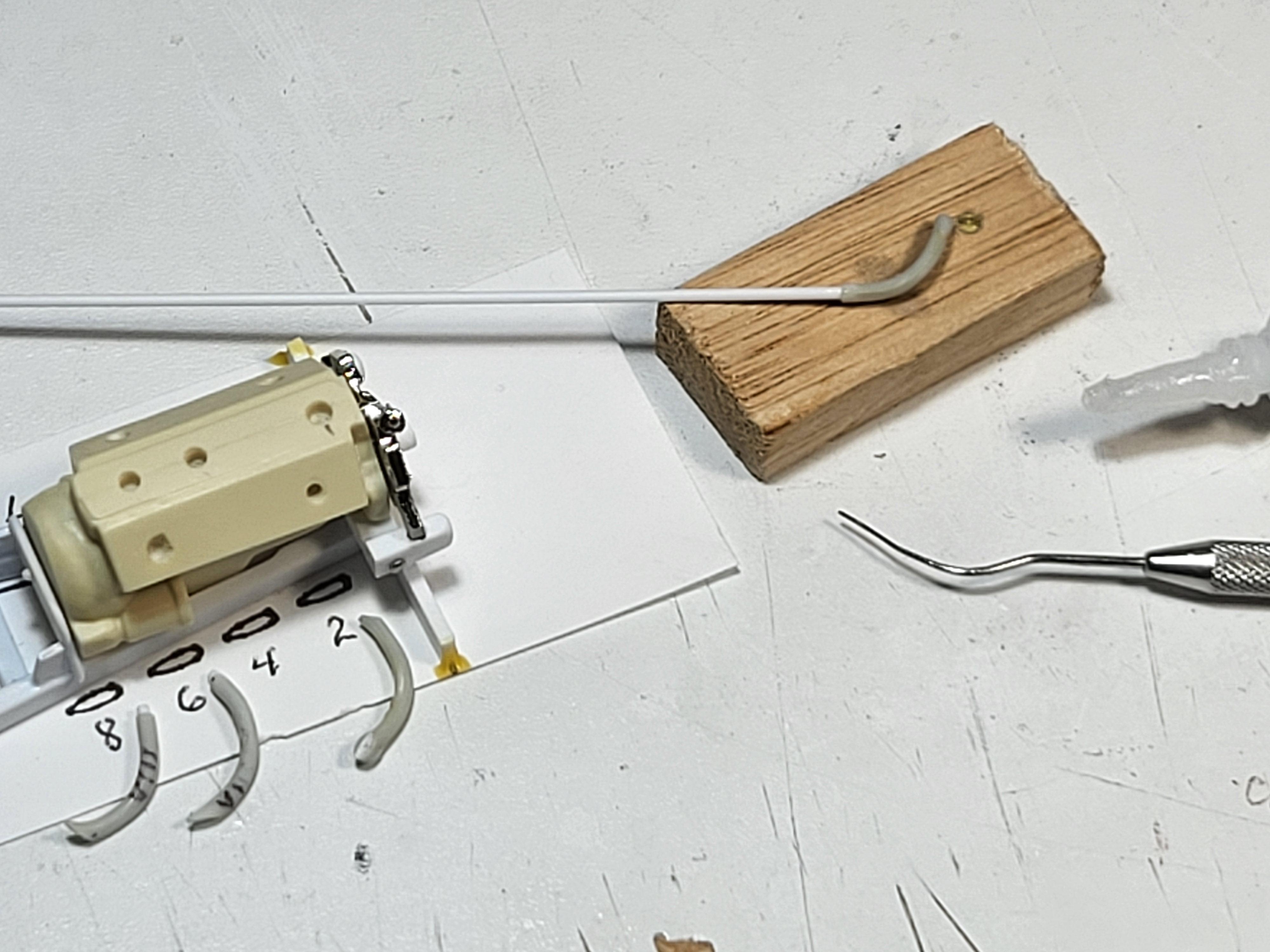

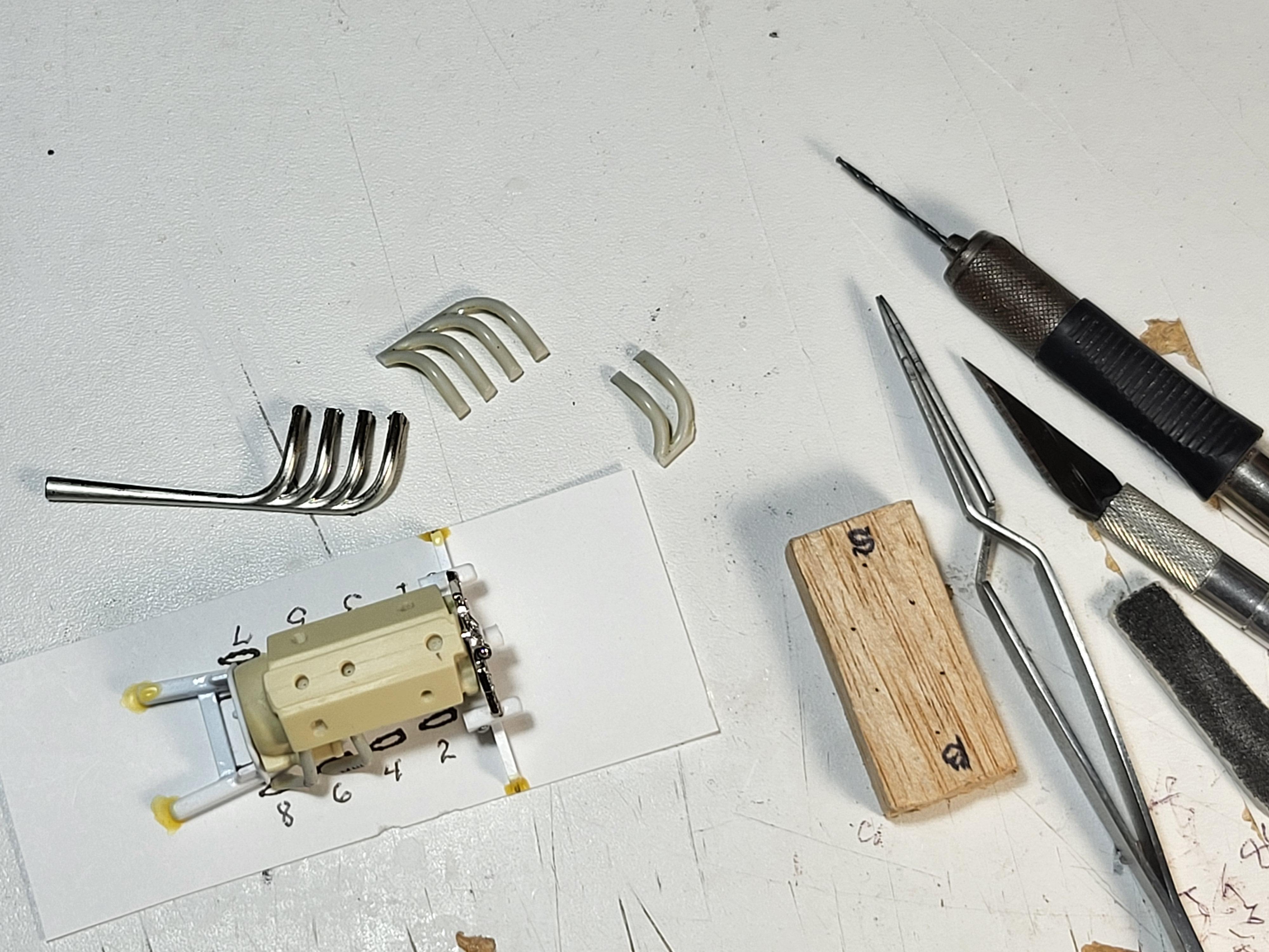

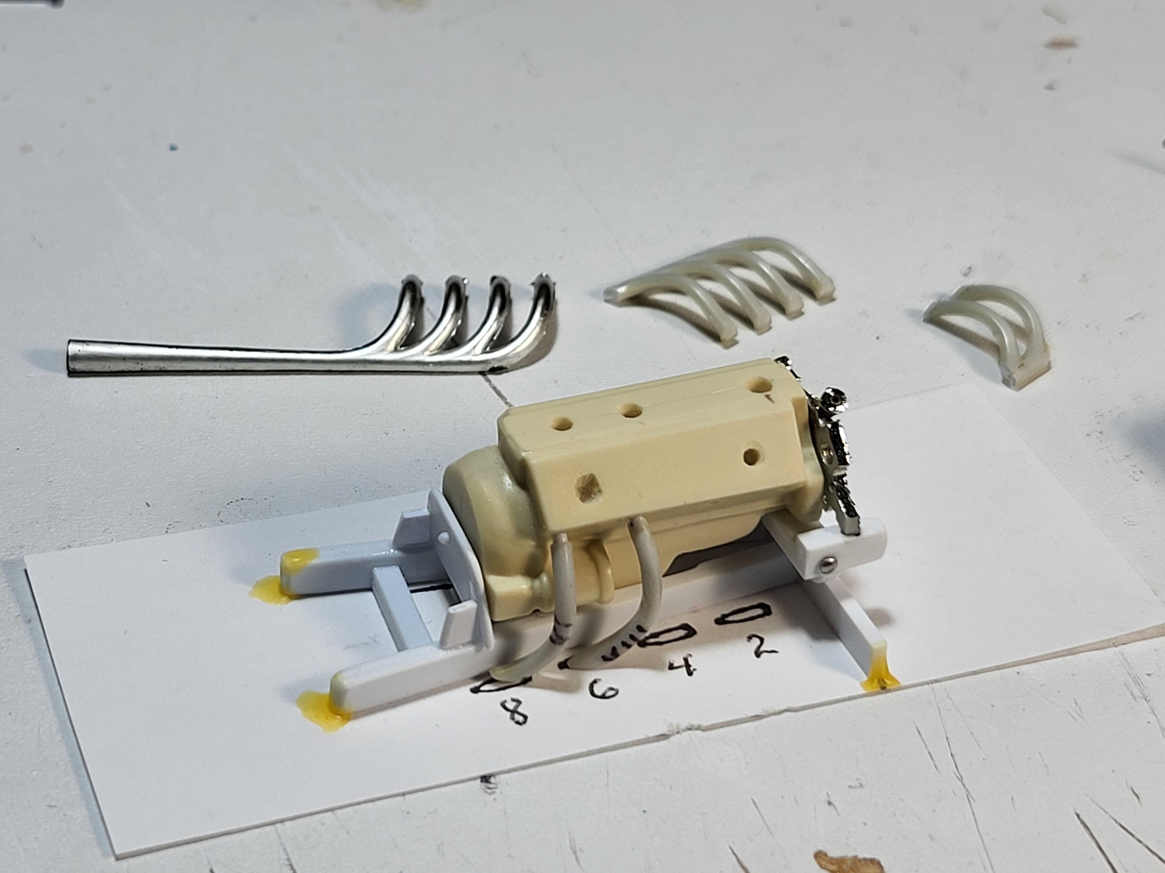

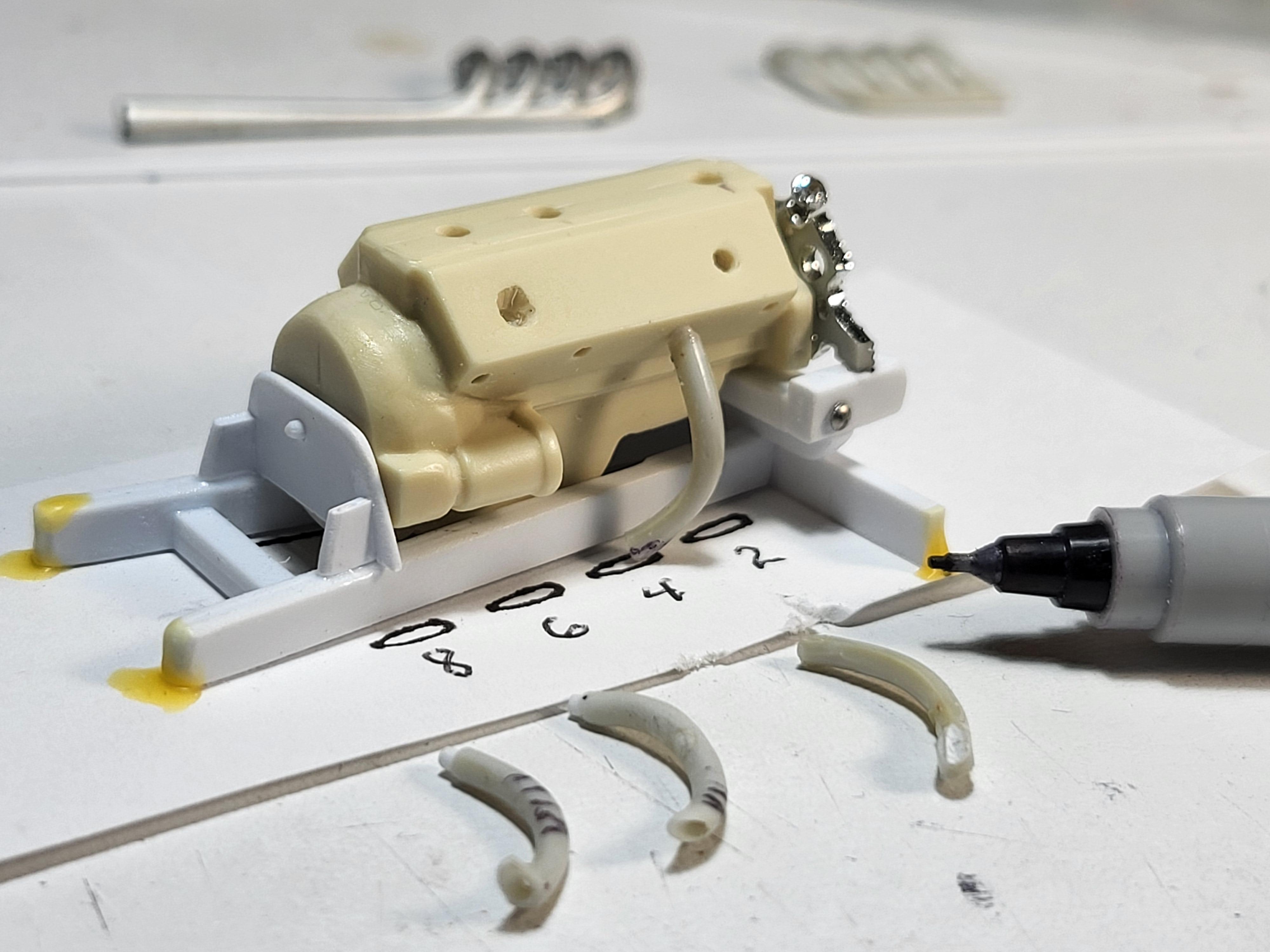

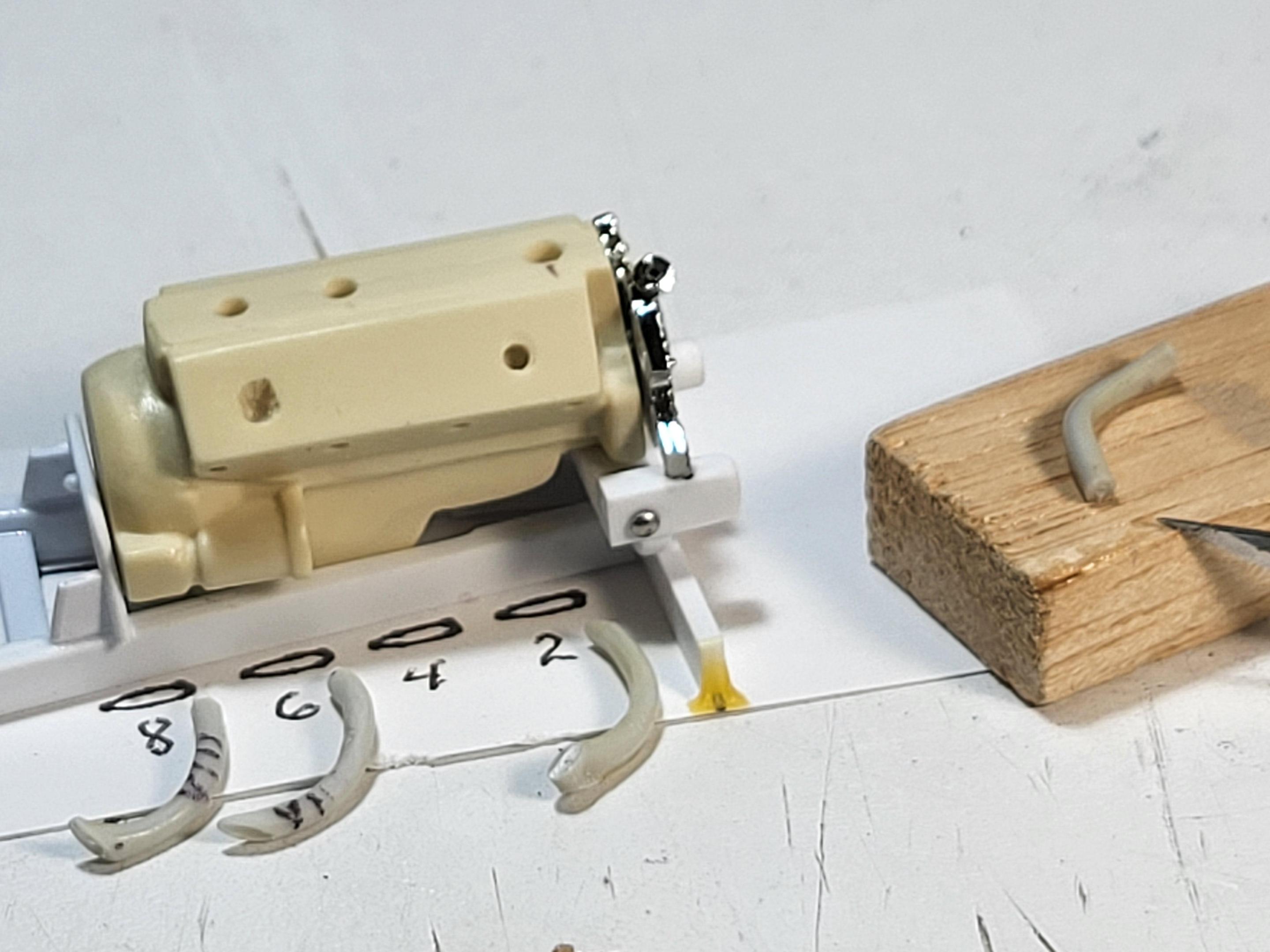

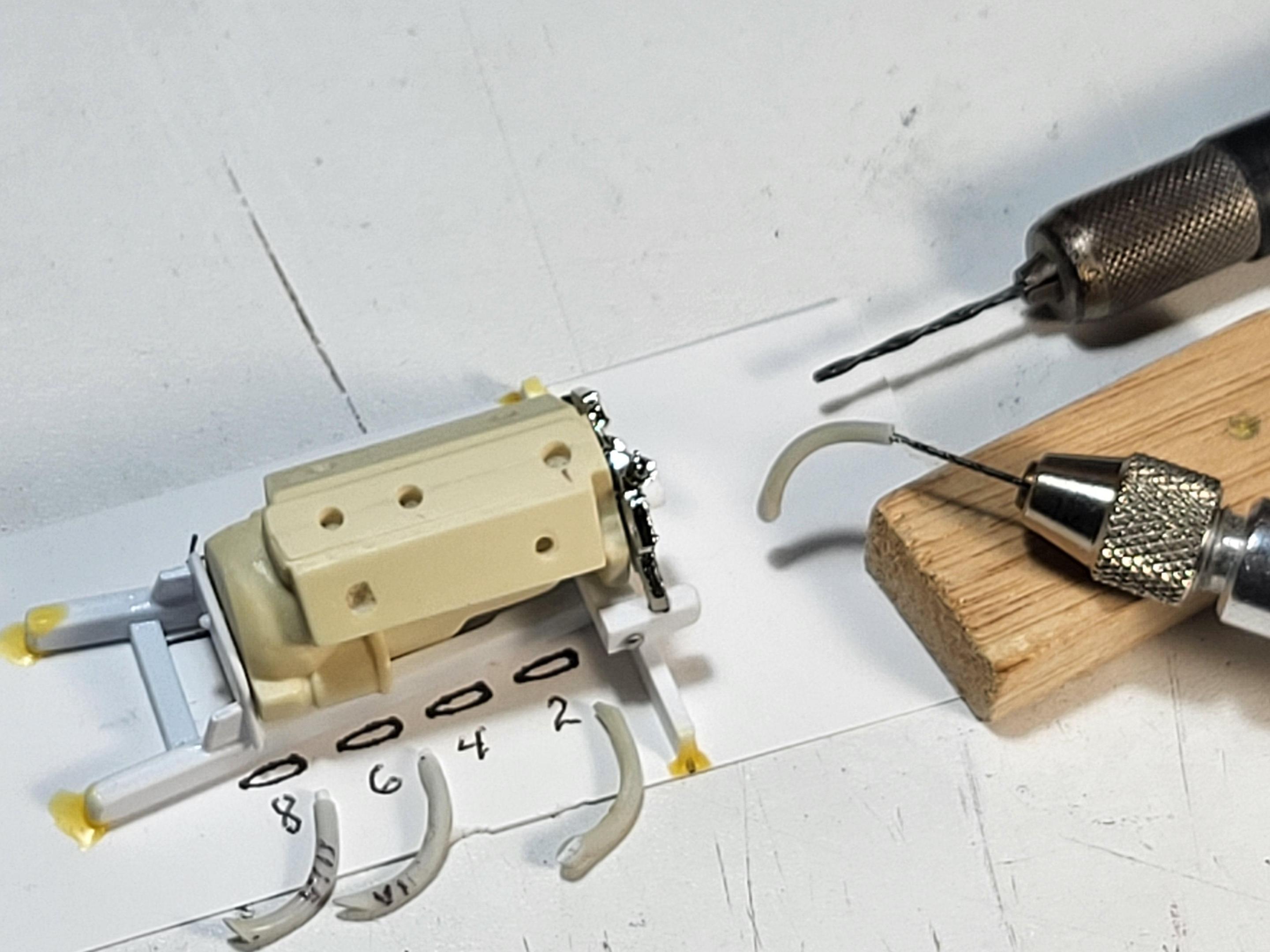

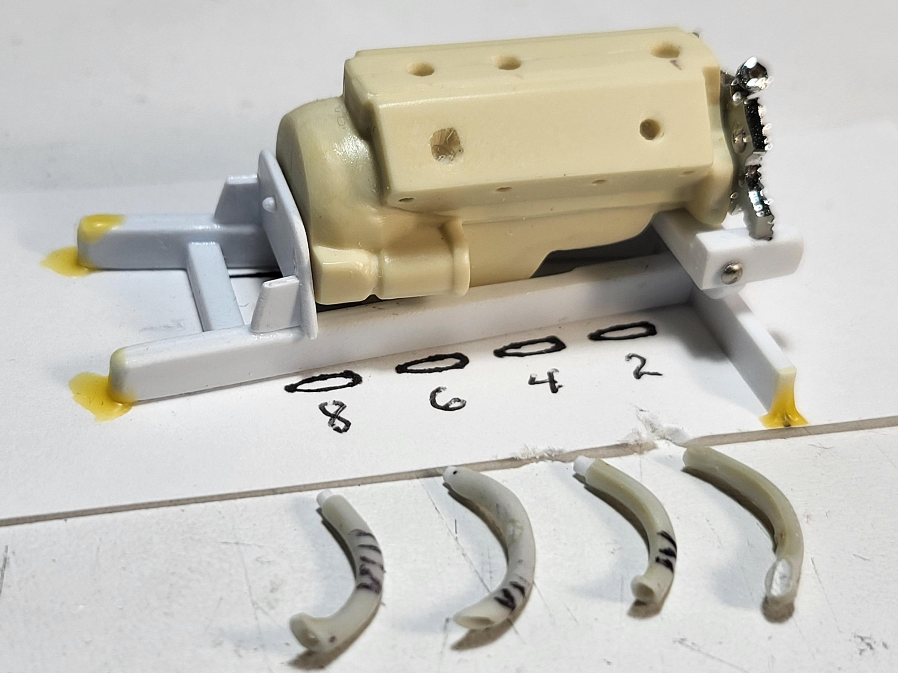

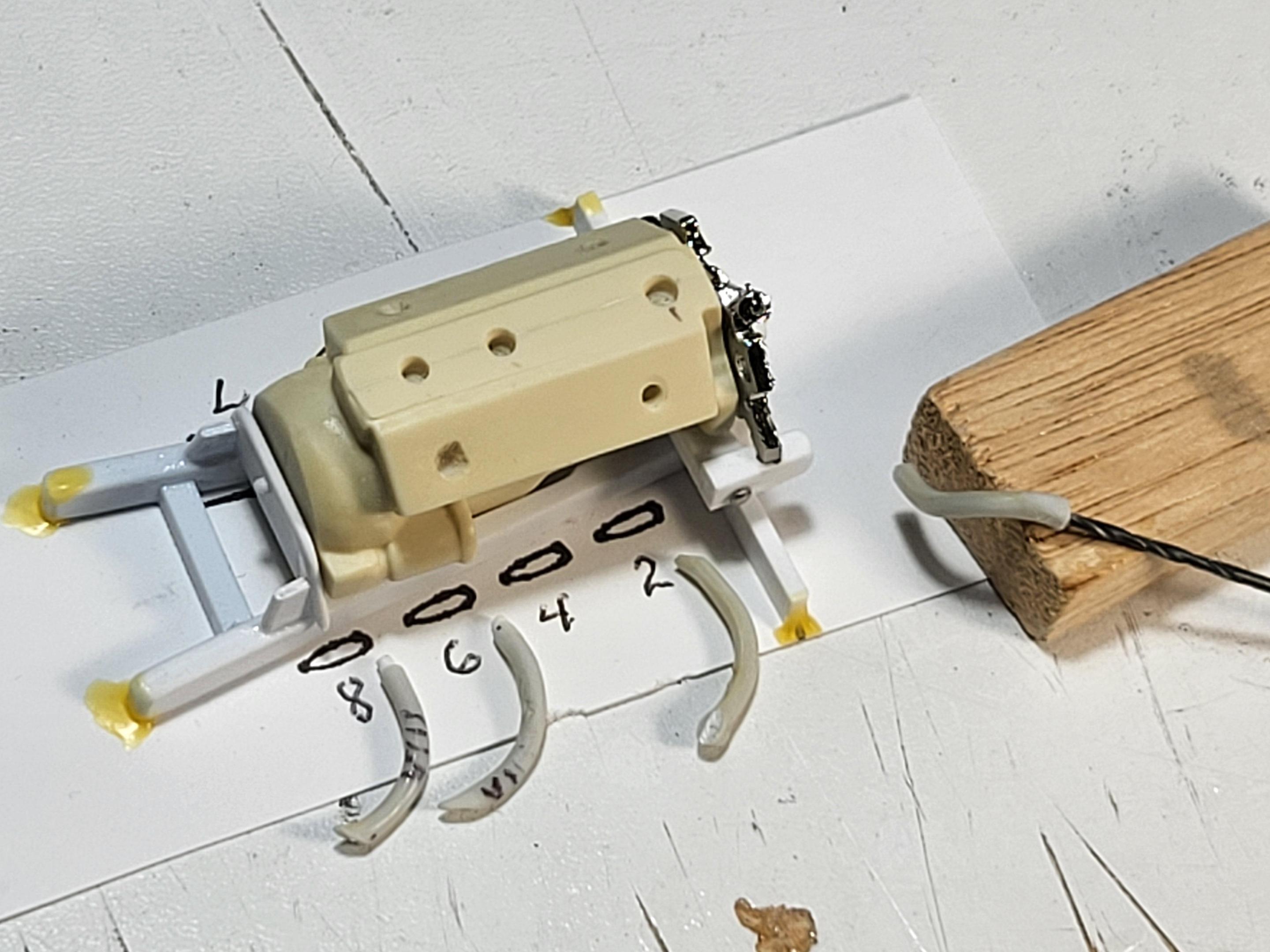

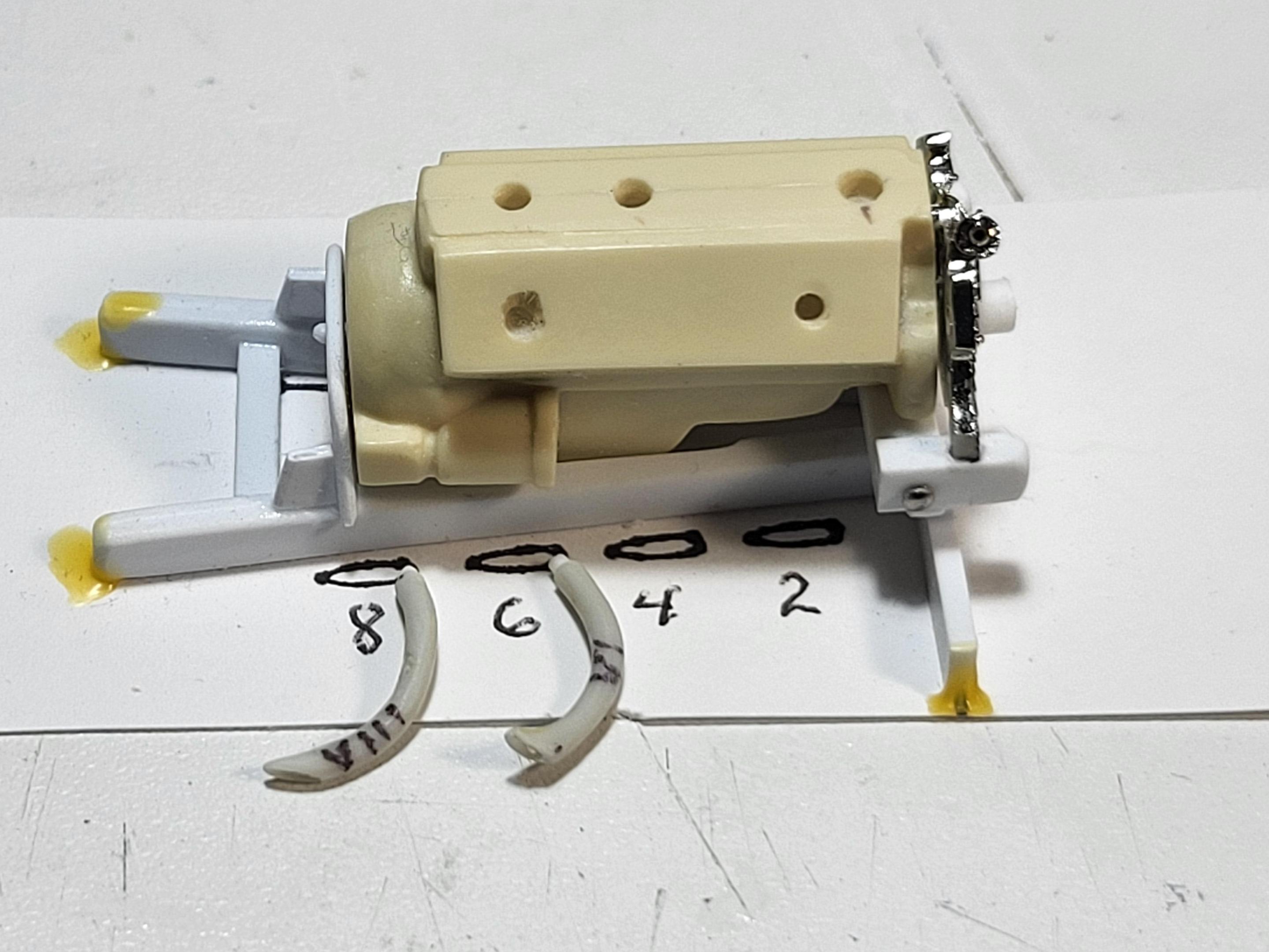

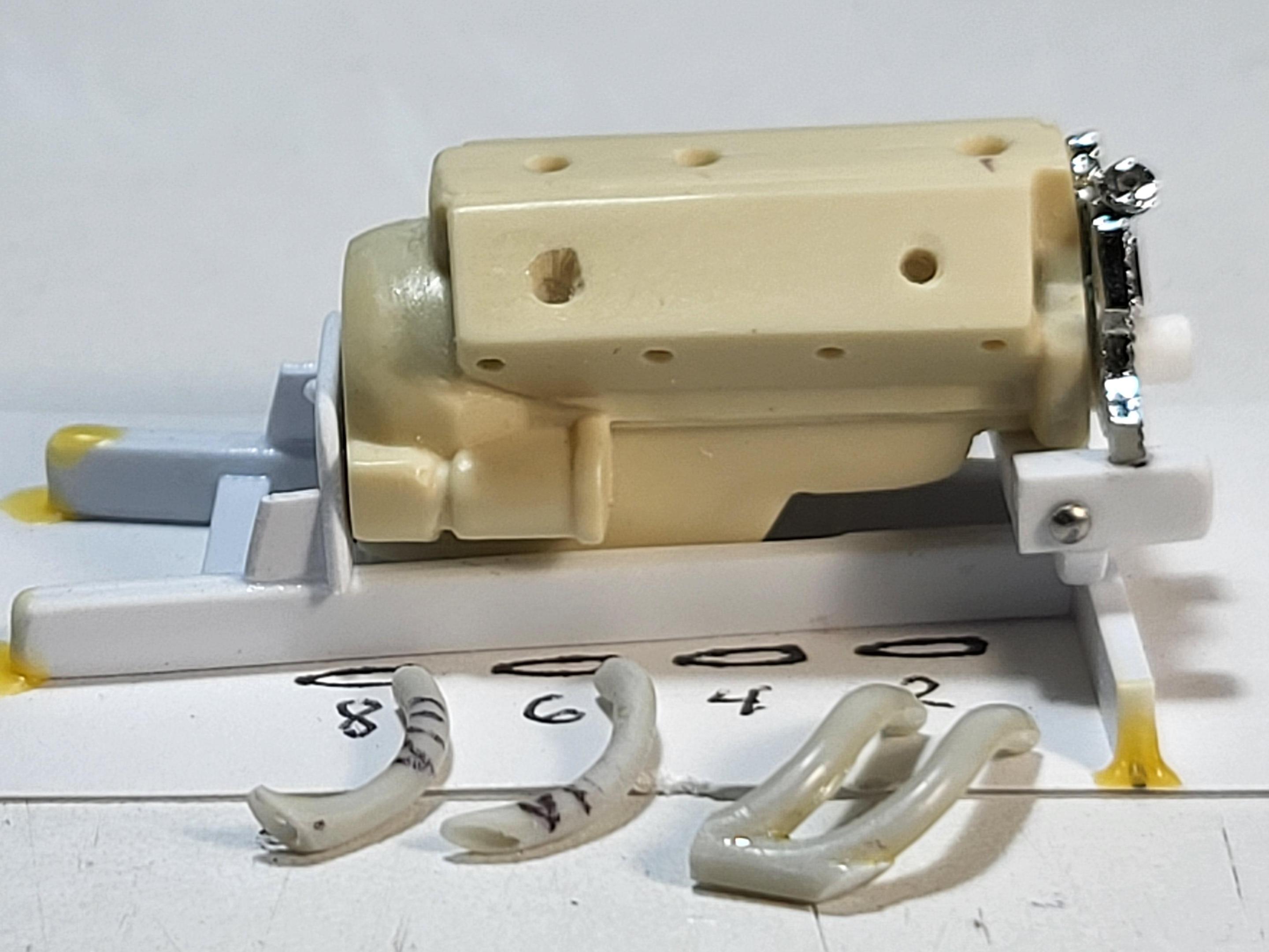

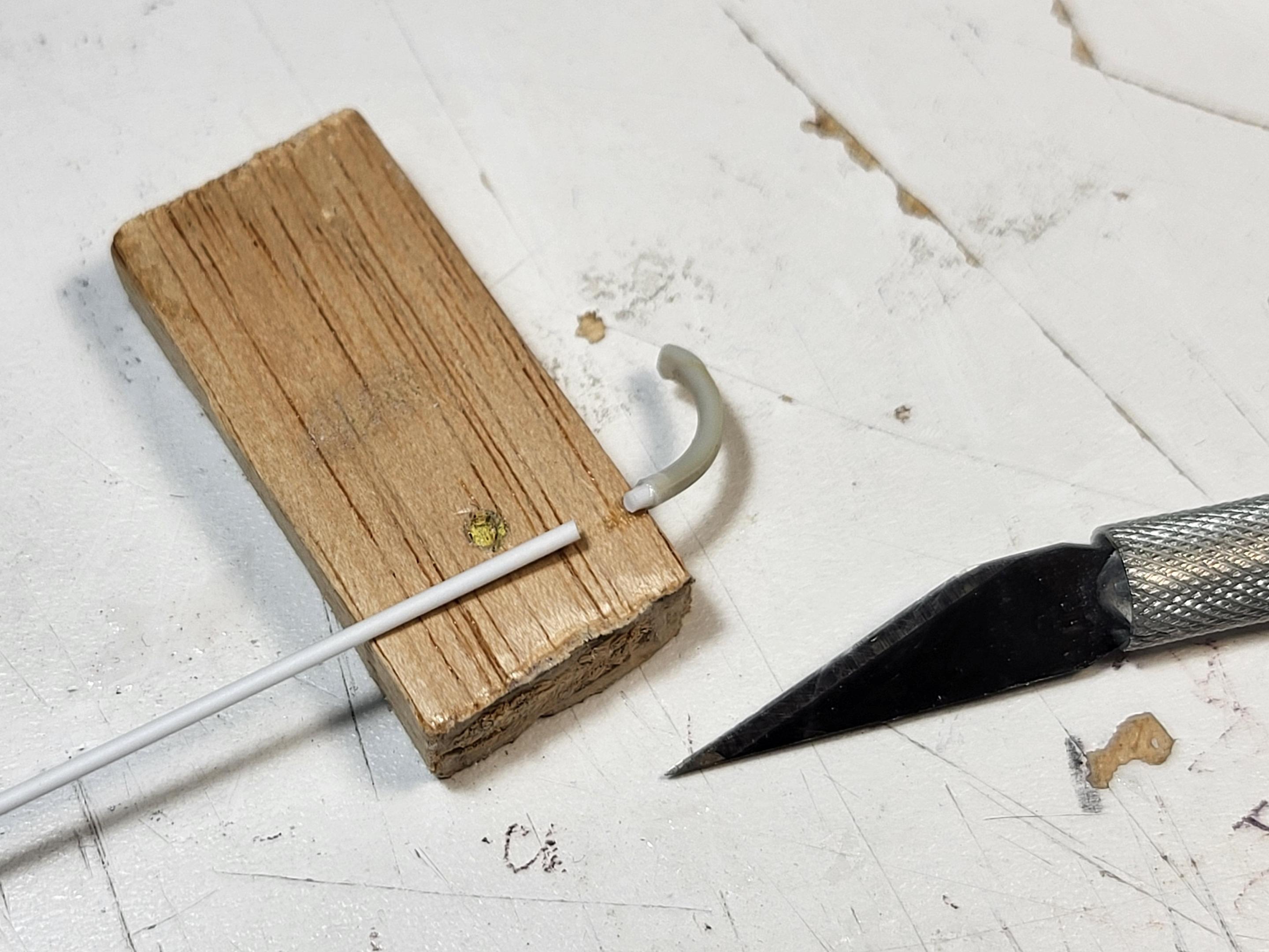

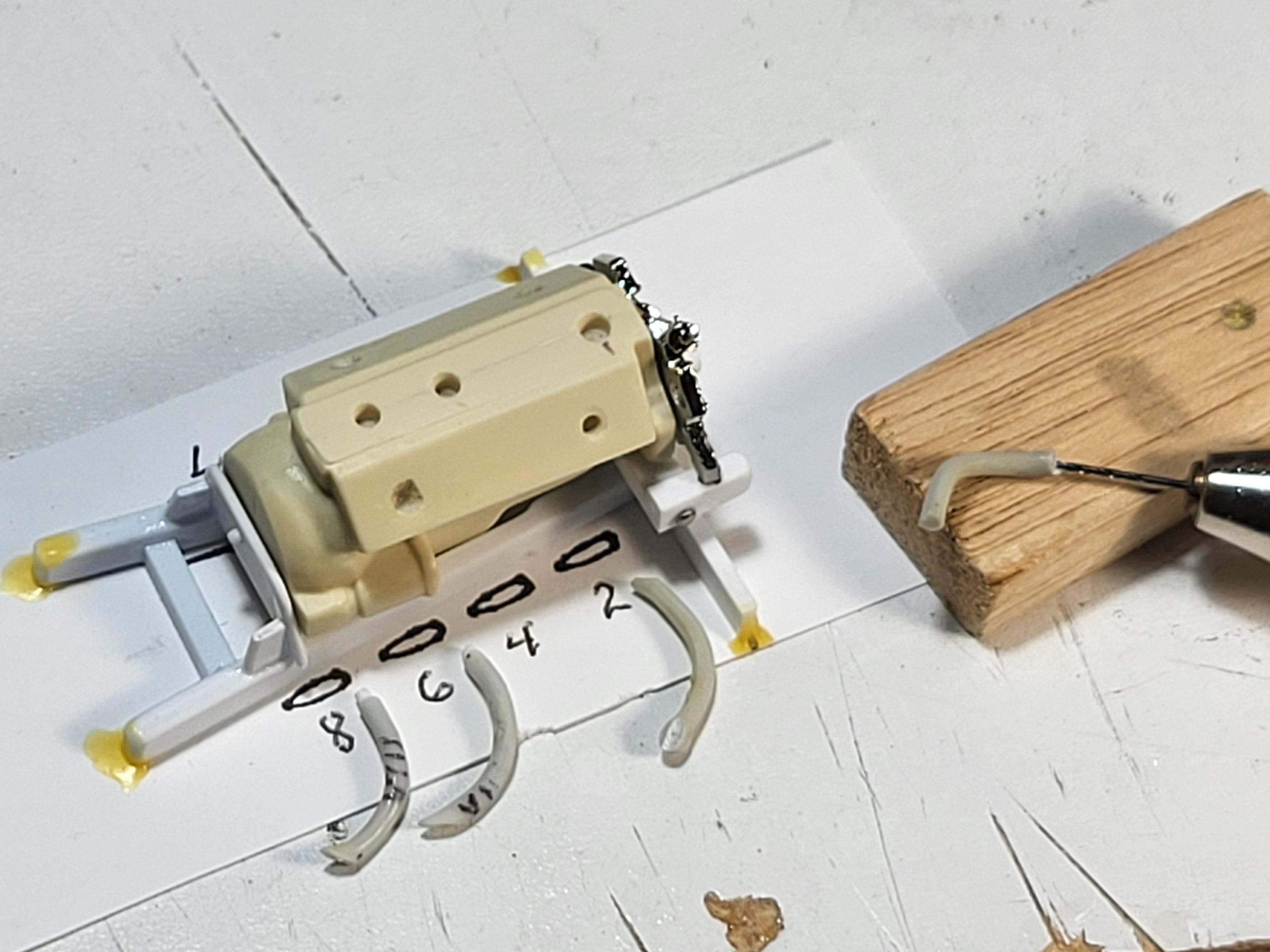

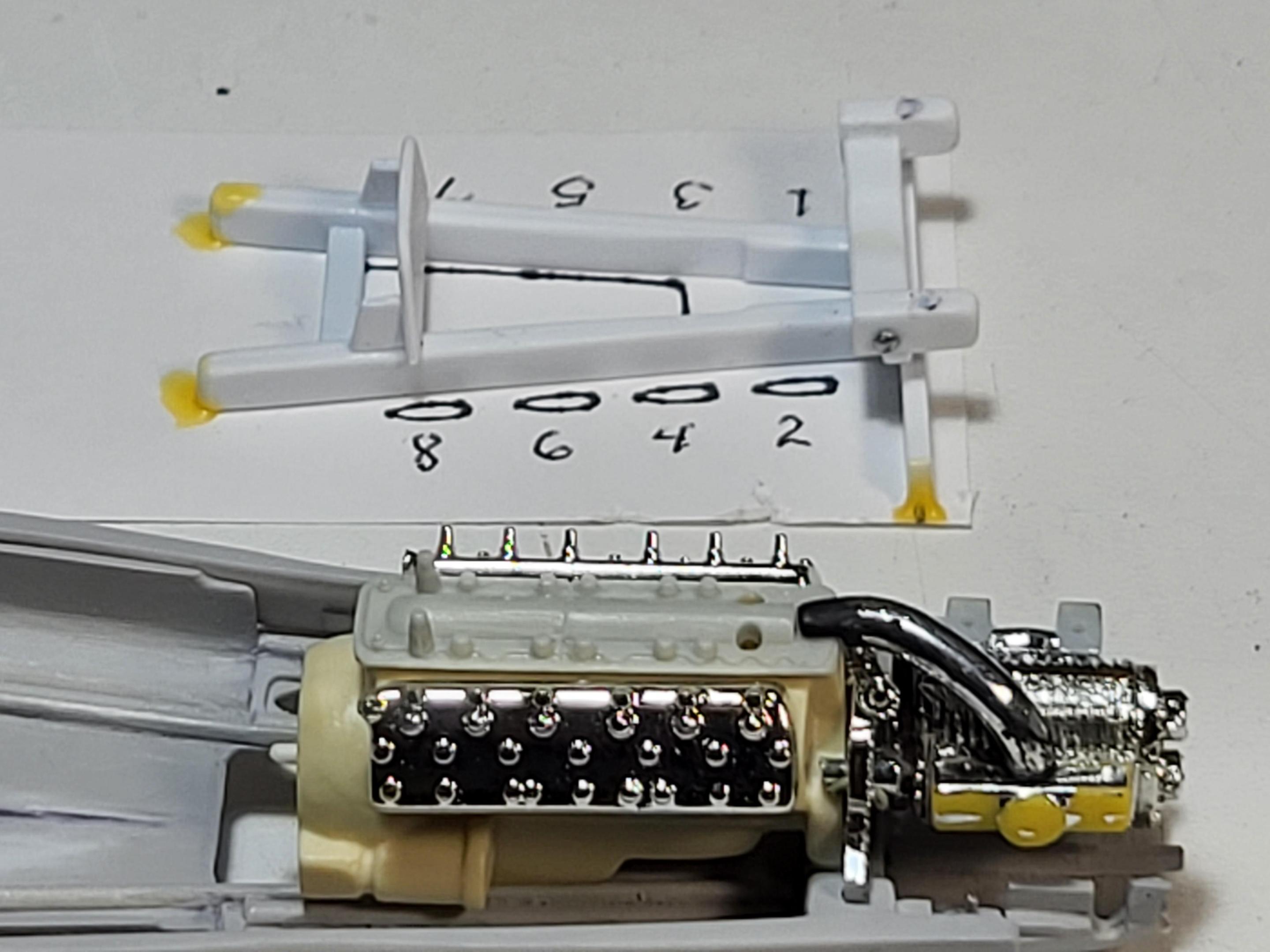

Kit Karson Posted April 12 Author Share Posted April 12 V-12 Header Pipe #4 - 3rd out of 8 slashed exhaust pipes: V-12 Header Pipe #8 & #6 roughed in... Tools of the trade... Header pipe source AMT '25 T... V-12 Header Pipe #4 & #2 in the rough... Drill the guide/pilot hole for the exhaust exit... Drill the larger exit hole... Locate & mark the center of the mounting pin hole with the tip of a #11 blade... Drill the mounting pin pilot hole... Drill for the pin... CA the pin... Trim the pin... V-12 Header Pipe #4 about to be slashed... Mark the kut... Kut the pre-drilled exhaust exit hole... V-12 Header Pipes #8, #6, #4 & #2 - 3 down 5 to go,,, -KK Quote Link to comment Share on other sites More sharing options...

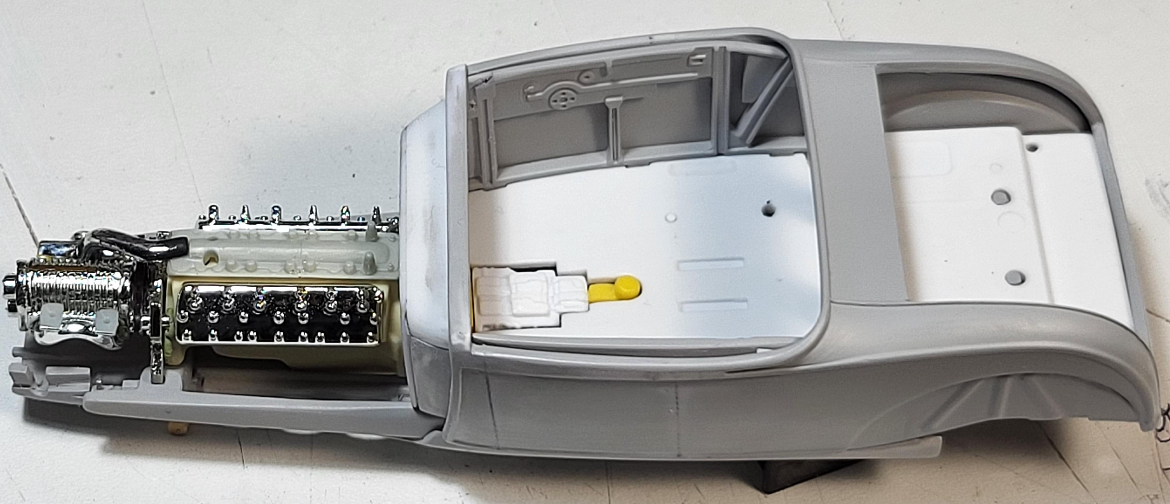

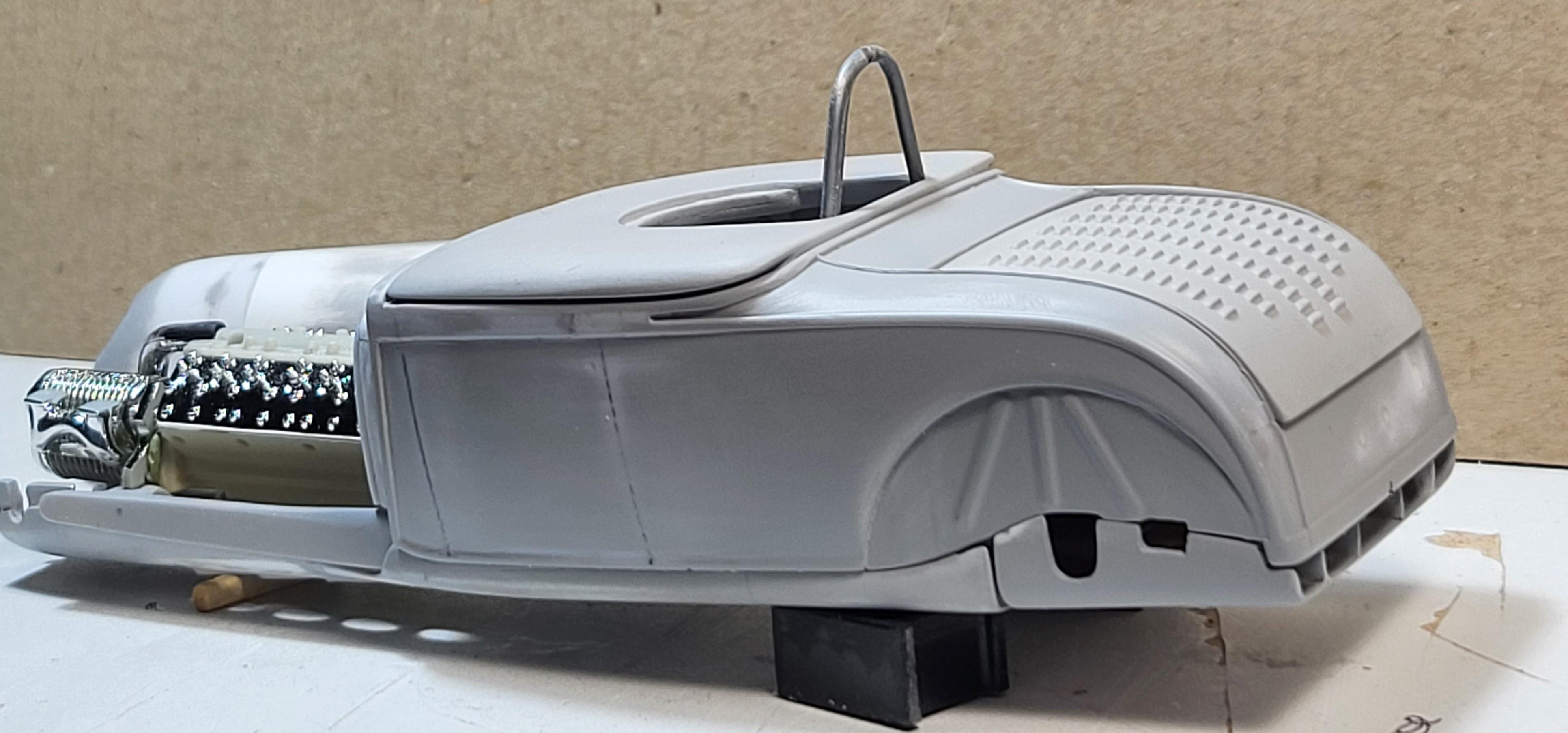

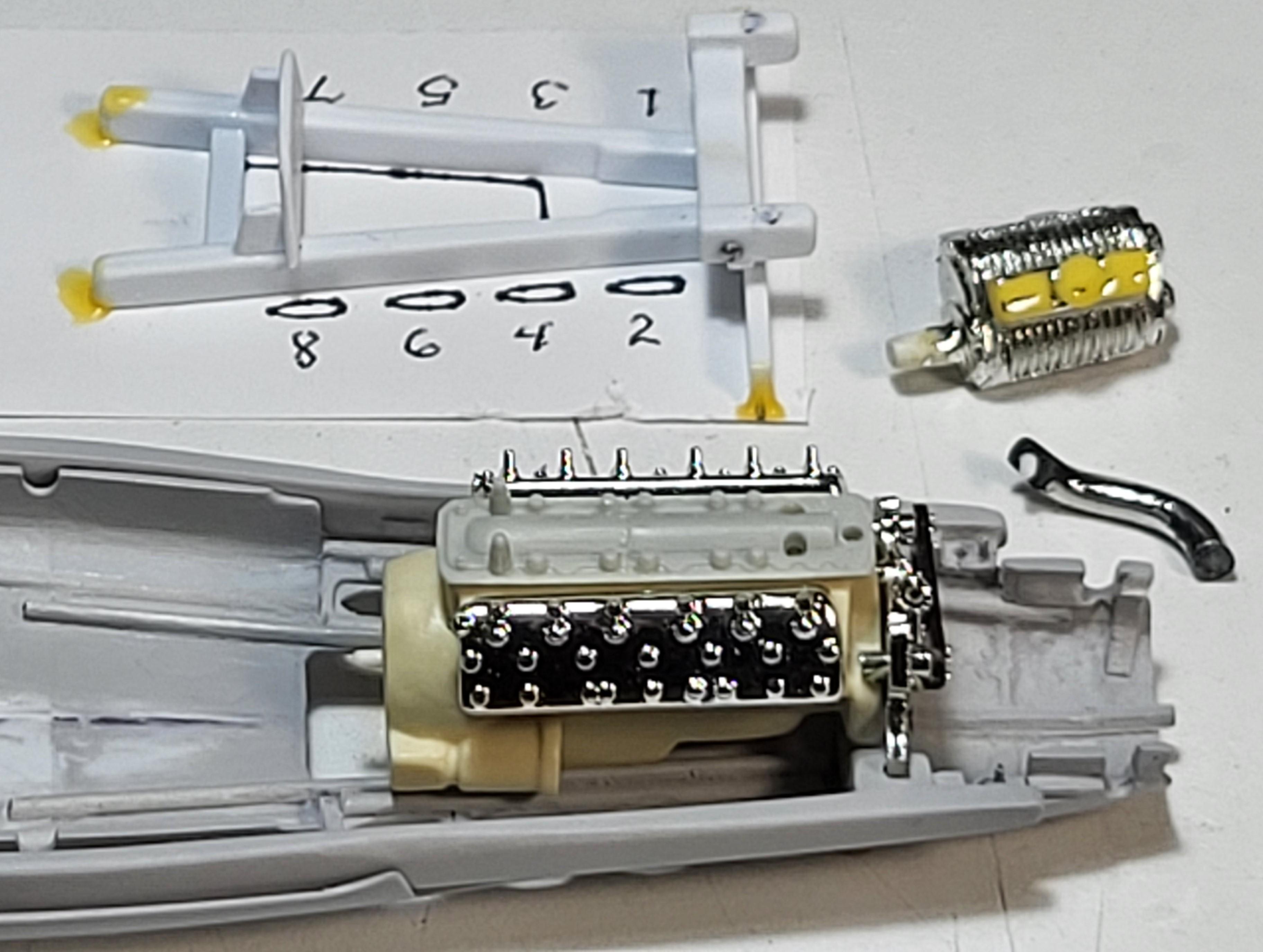

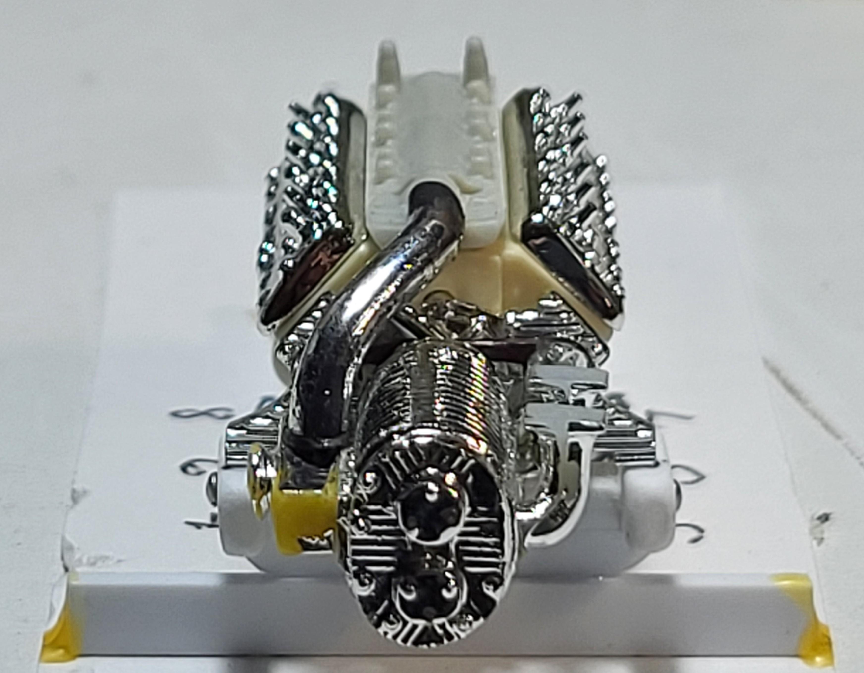

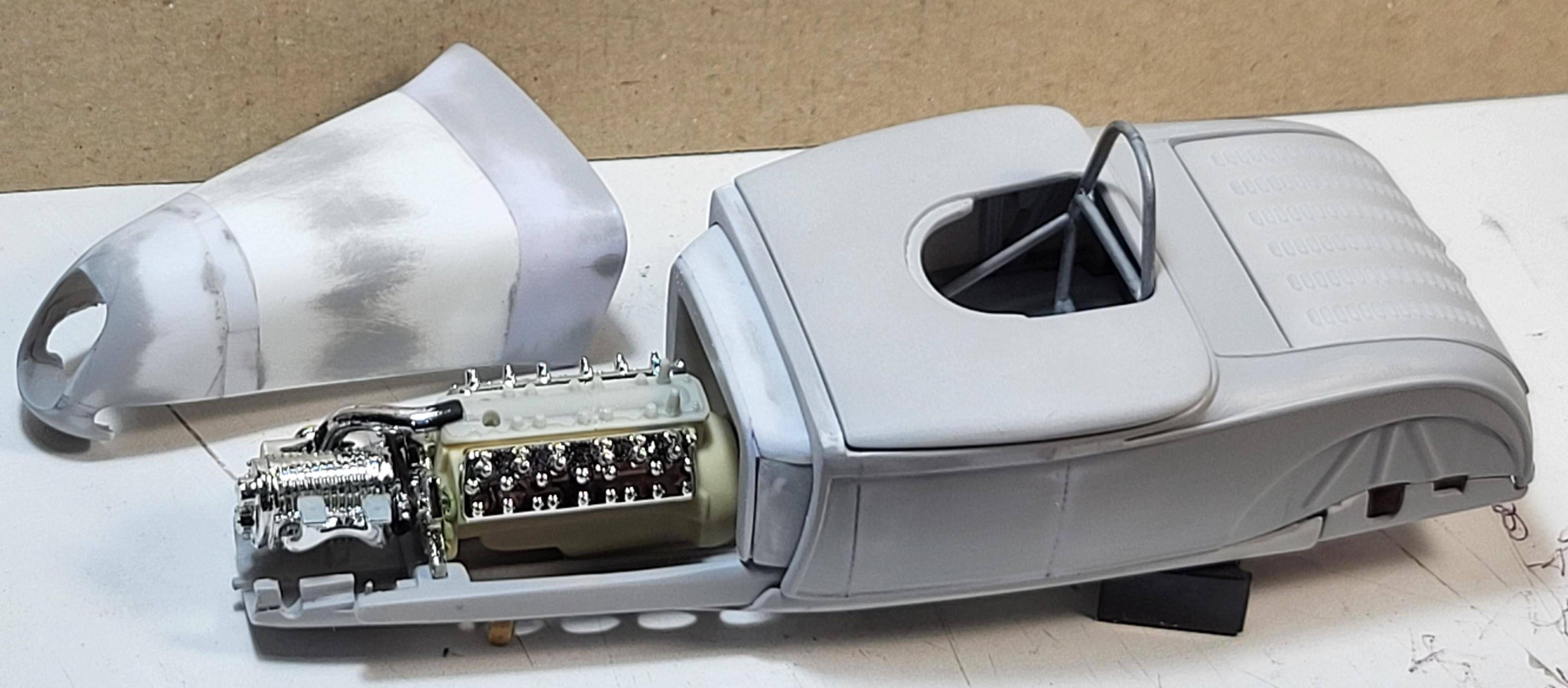

Kit Karson Posted April 15 Author Share Posted April 15 '29 Track Nose Roadster '41 Lincoln V-12 Flathead Mockup 3 Quote Link to comment Share on other sites More sharing options...

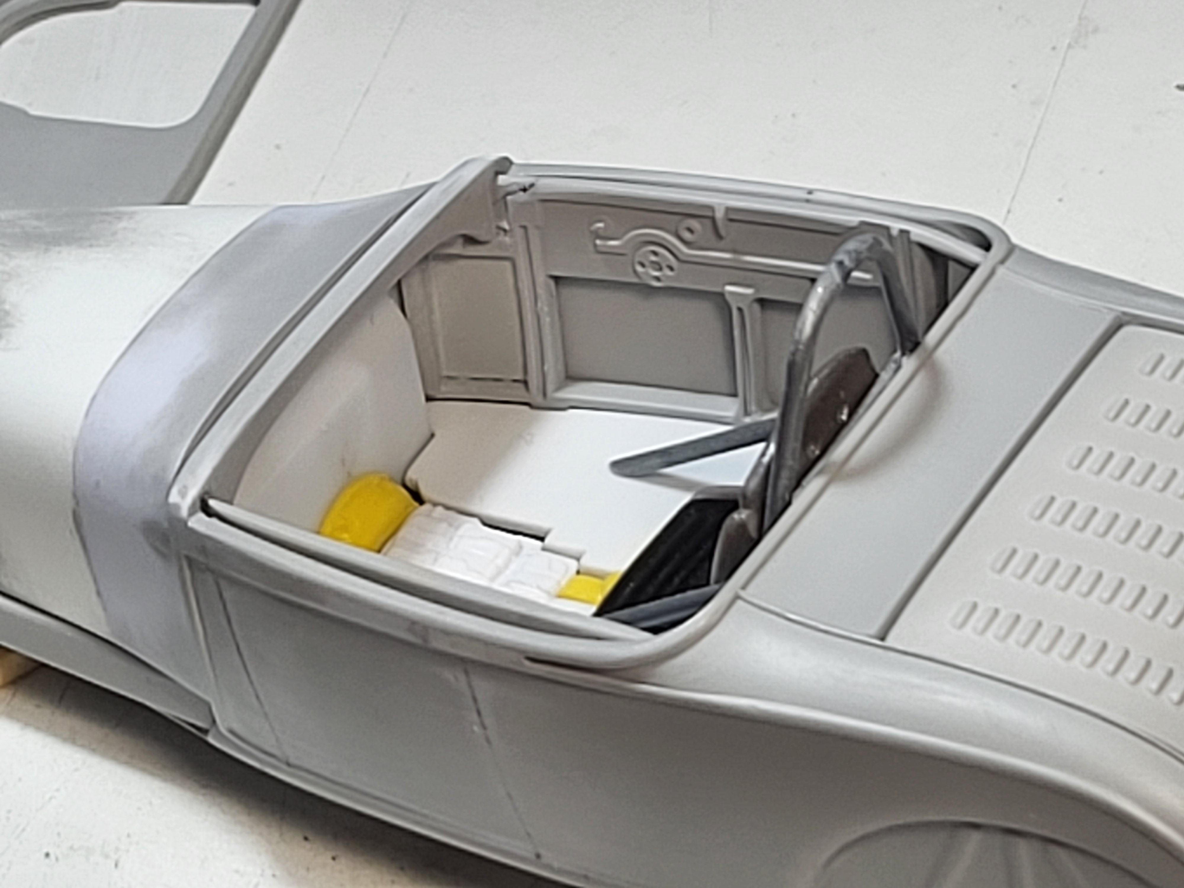

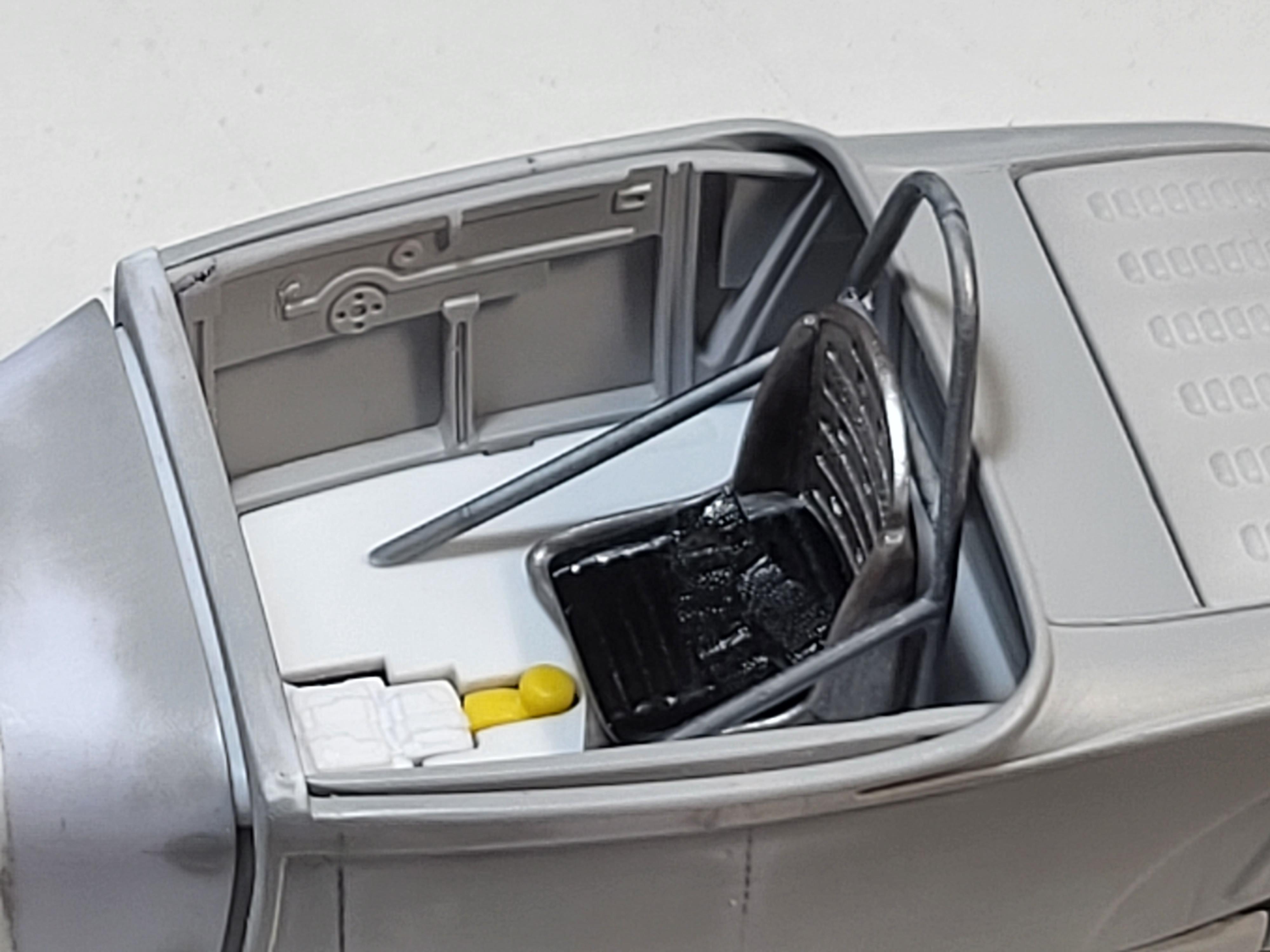

Kit Karson Posted April 16 Author Share Posted April 16 Interior Mockup Steering Next! 4 Quote Link to comment Share on other sites More sharing options...
