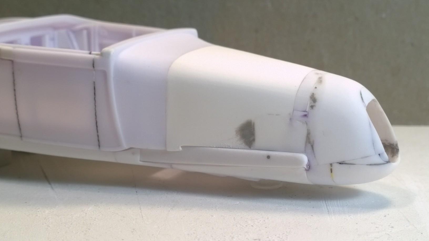

Rhinoplasty
Had to perform surgery on the '29 Track Nose Roadster's nose!
To take the height out of the nose a pie cut will come from the back edge...
Measure twice & cut once...
Total material removed from both sides match!
Nicked the corner and had to repair it...
A little scotch tape to hold the two parts together add a little CA and...
Vertical cut to the trailing edge of the nose to better set the angle of the grille opening...
Thanks out to @Rocking Rodney Ratfor the 90degree steel block!
Good example of "Take" the line when sawing through a thin plastic wall...
Belly pan meets the new nose...
'29 Track Nose Roadster with a bit of an attitude! -KK
