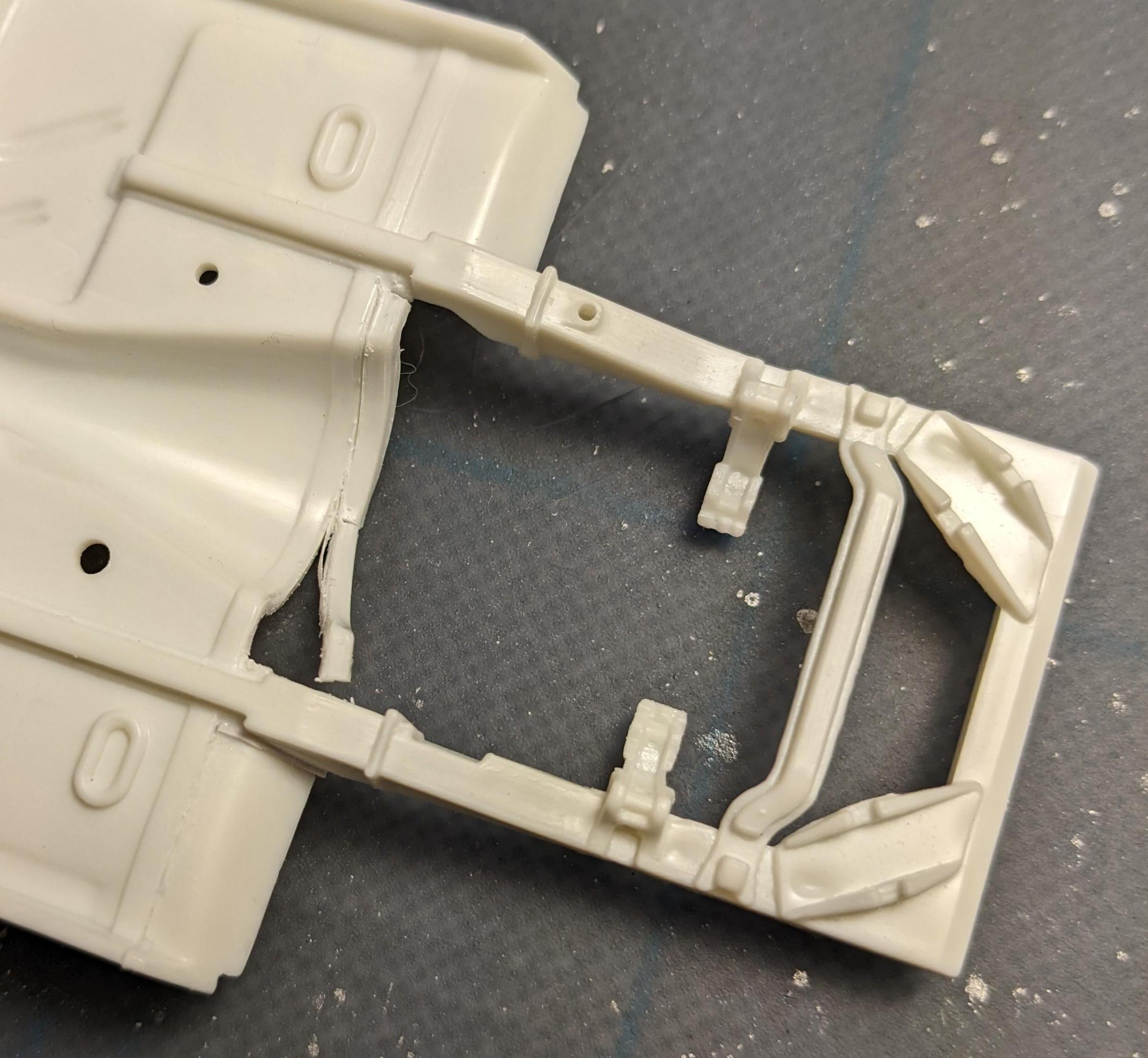

'70 Grande Posted January 8 Author Share Posted January 8 (edited) I thoroughly researched where the factory-stock rear wheel openings needed to be located on my converted '65 body. For the chassis-swap, I wanted the factory-stock chassis from the AMT 1/25 1966 Chevy Nova kit as both 1:1 car's are the same 110"-inch wheelbase. Here's where the work begins, and the "morphing" begins as well! Turns out, probably due to these kit's being originally-molded decades apart, the kit wheelbase's did not match-up. The '66 Nova factory-stock chassis was probably a scale 1-1/2-to-2"-inches longer that the wheelbase for the '65 kit. At the top of Pic #2 below, it shows the amount I cut-out of the '66 chassis to gets things lined-up properly. Edited January 8 by '70 Grande 1 Quote Link to comment Share on other sites More sharing options...

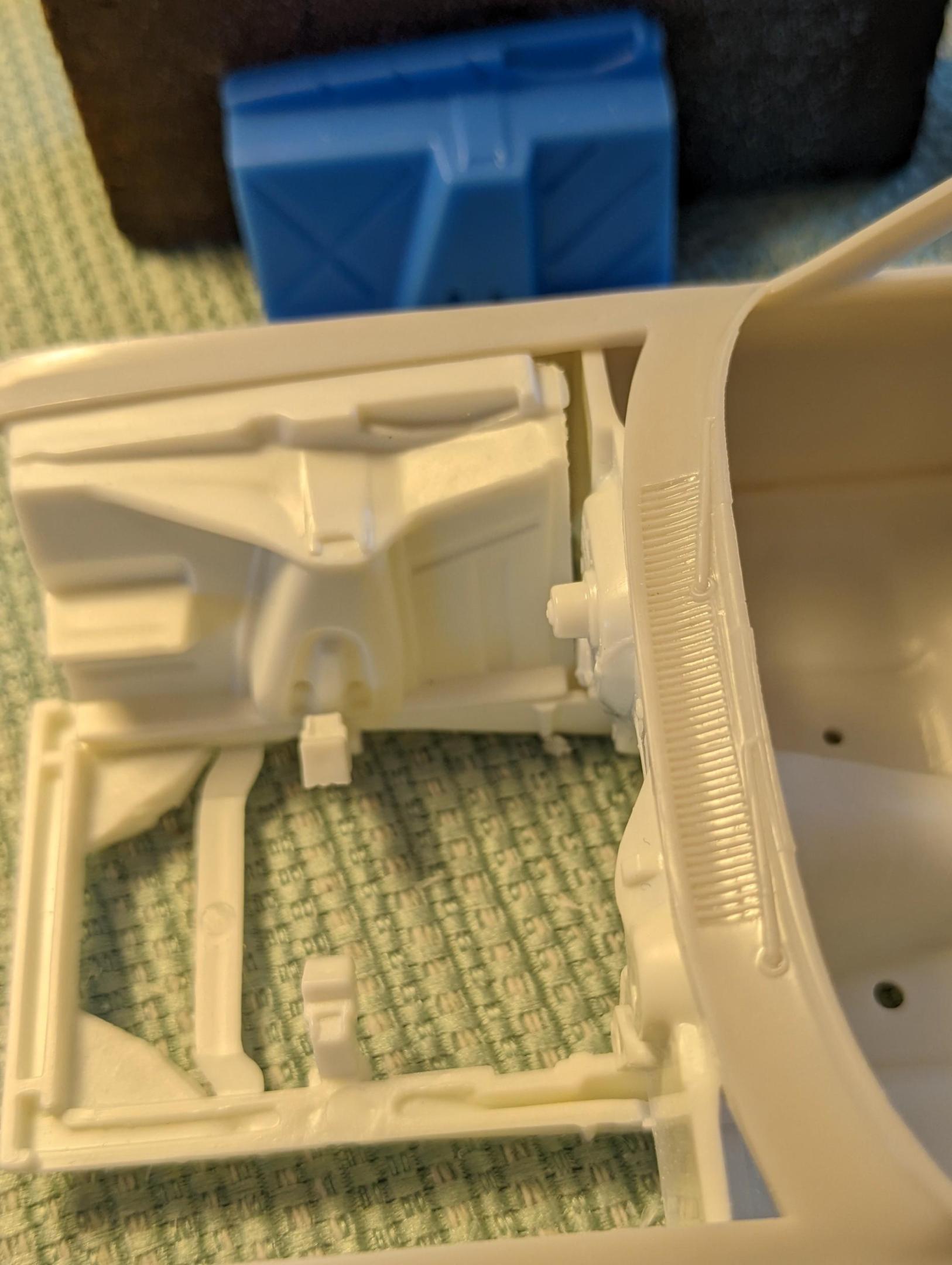

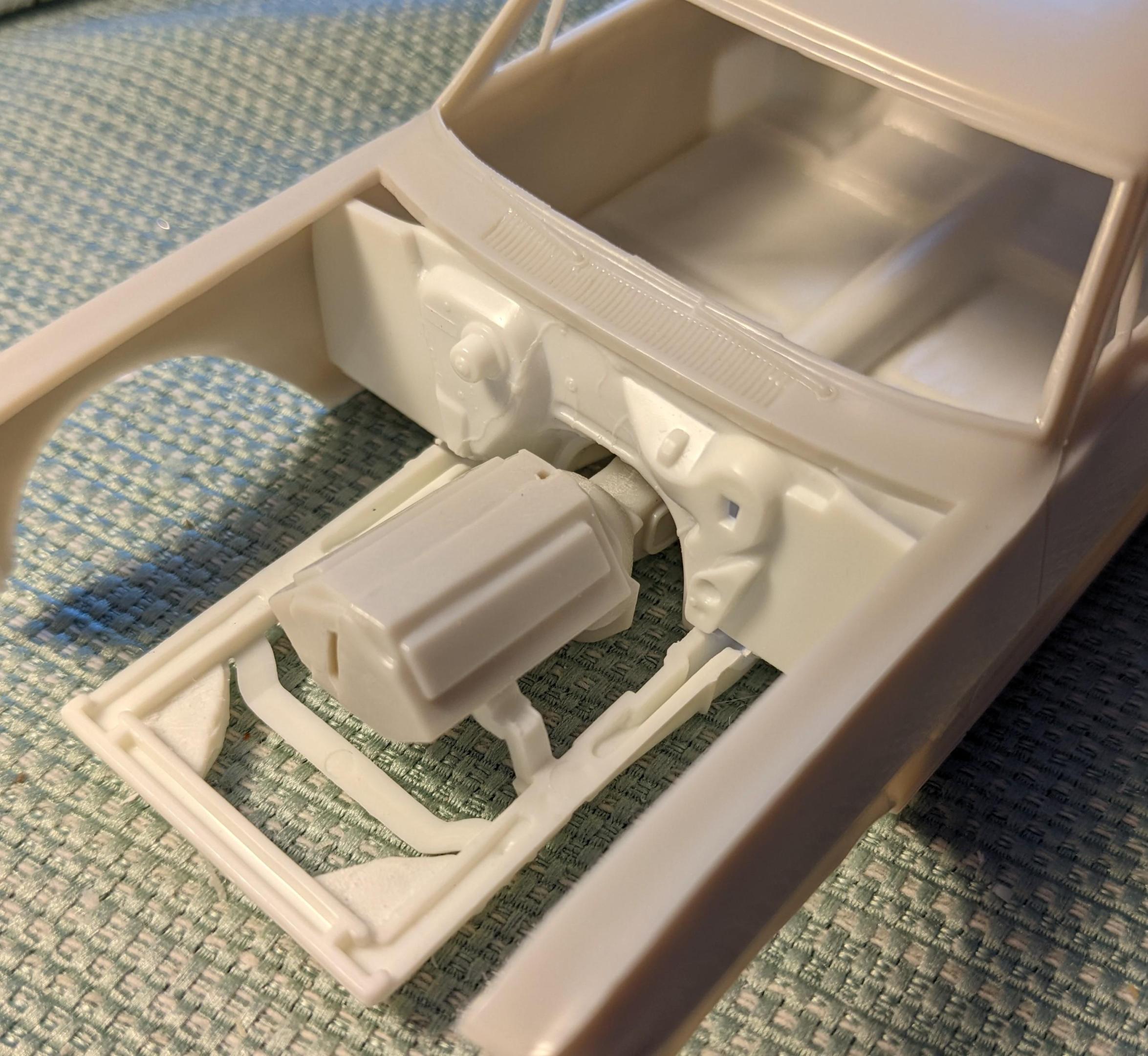

'70 Grande Posted January 8 Author Share Posted January 8 The challenges are growing... the engine compartment of the '65 Chevy-II is shorter in length from the radiator wall back to the firewall than the '66 Nova. I really like how the '66 Nova's engine compartment walls look inside the '65 Chevy-II body, but now there's a bit more adjustment work to be done here. I expected this, but was hoping for a overall simpler-chassis-swap. Also, I have learned that the "Street-Freak" kit's 427 engine is going to be too big/long to fit... time to dig a high-performance 327 Corvette engine outta my parts box and do an engine-swap... the morphing continues. Also, because the drag slicks that I originally intended on using on my Gasser build are going to be a tight-fit in the rear chassis, I'm probably going to a more, high-performance street car project and scrapping the Gasser theme for this build. Any thoughts, suggestions, questions or criticisms welcomed. Quote Link to comment Share on other sites More sharing options...

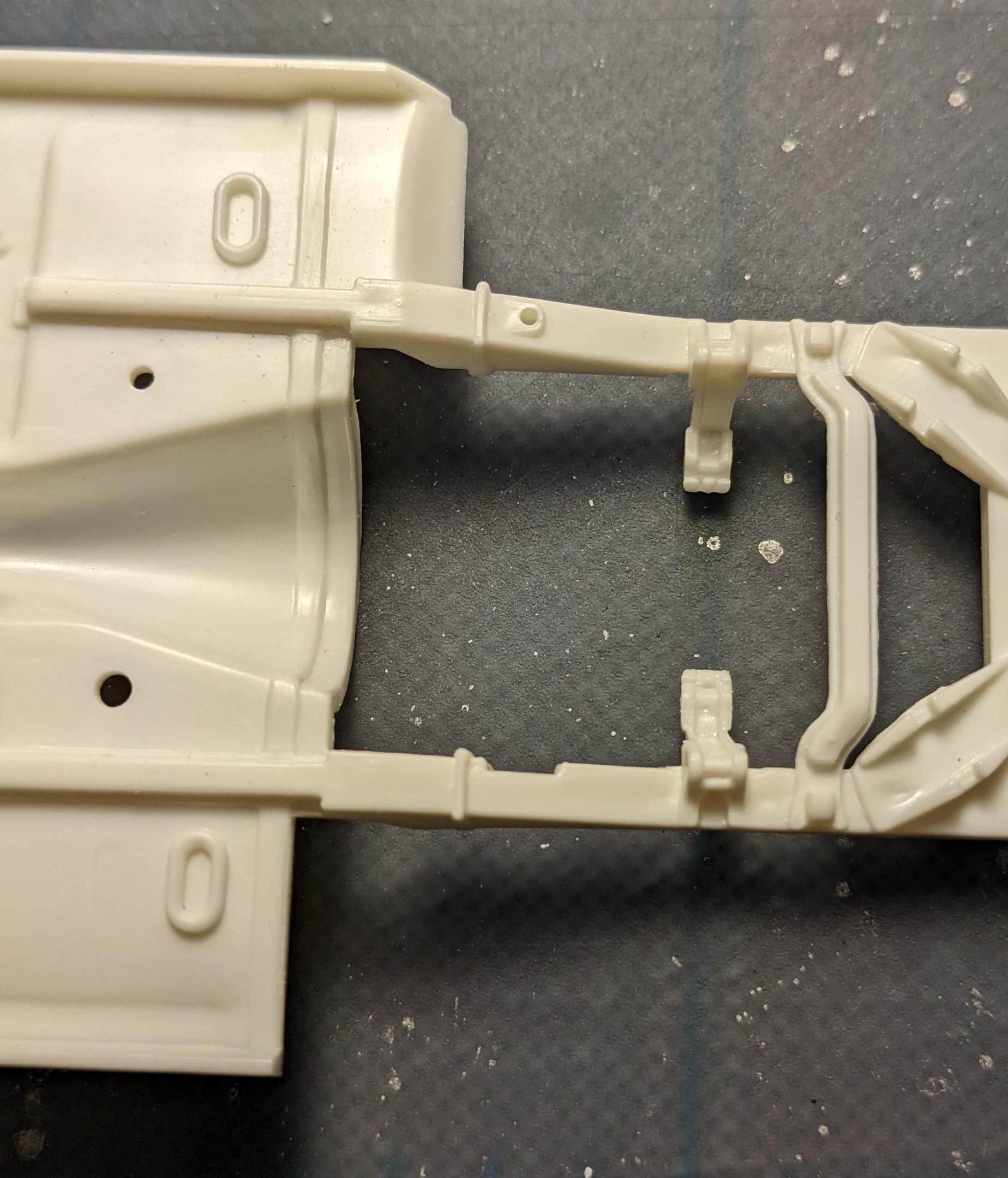

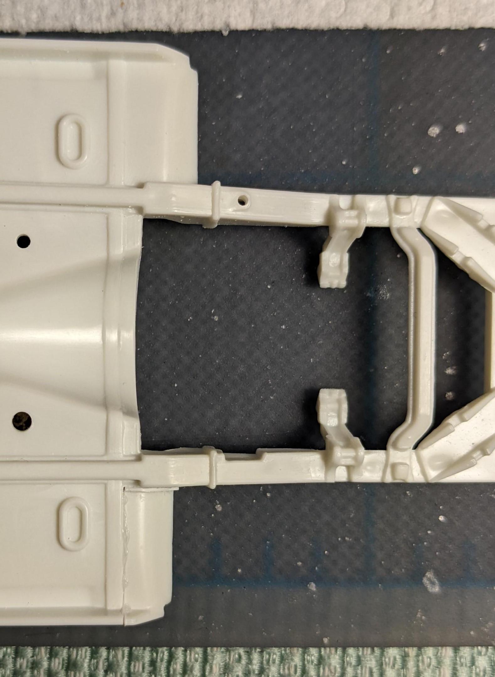

'70 Grande Posted January 14 Author Share Posted January 14 (edited) A WIP update: As seen in one of my previously posted engine bay pics, the '66 Nova's engine bay sidewalls and firewall were going to need some adjustments to fit this '65 Chevy-II body better. The major issue is getting the firewall moved towards the rear by about 3"-to-4"-scale-inches. Fortunately, I think I came up with a good solution. As seen in the following pics, I was able to cutback the outer-floorboard edges as shown in the first pic below, (cutback started at the bottom of the pic/uncut seen at the top of the pic). Second pic with cutout piece moved back and reinstalled. Edited January 14 by '70 Grande 1 Quote Link to comment Share on other sites More sharing options...
'70 Grande Posted January 14 Author Share Posted January 14 (edited) Trimming back of transmission hump seen in the first pic and firewall gap for moving firewall back seen in second pic. Edited January 14 by '70 Grande 1 Quote Link to comment Share on other sites More sharing options...

'70 Grande Posted January 15 Author Share Posted January 15 (edited) Fortunately it was not too complicated to get the firewall moved rearward and more accurately positioned as seen in the first pic below. One end result of that adjustment is now the engine bay sidewalls will need to be lengthened to reach all the way back to be connected again to the repositioned firewall, (gap seen in 2nd pic). Fortunately I have an extra set of sidewalls from the '66 Nova Pro-street kit that I can use to make this alteration. Edited January 15 by '70 Grande Quote Link to comment Share on other sites More sharing options...
