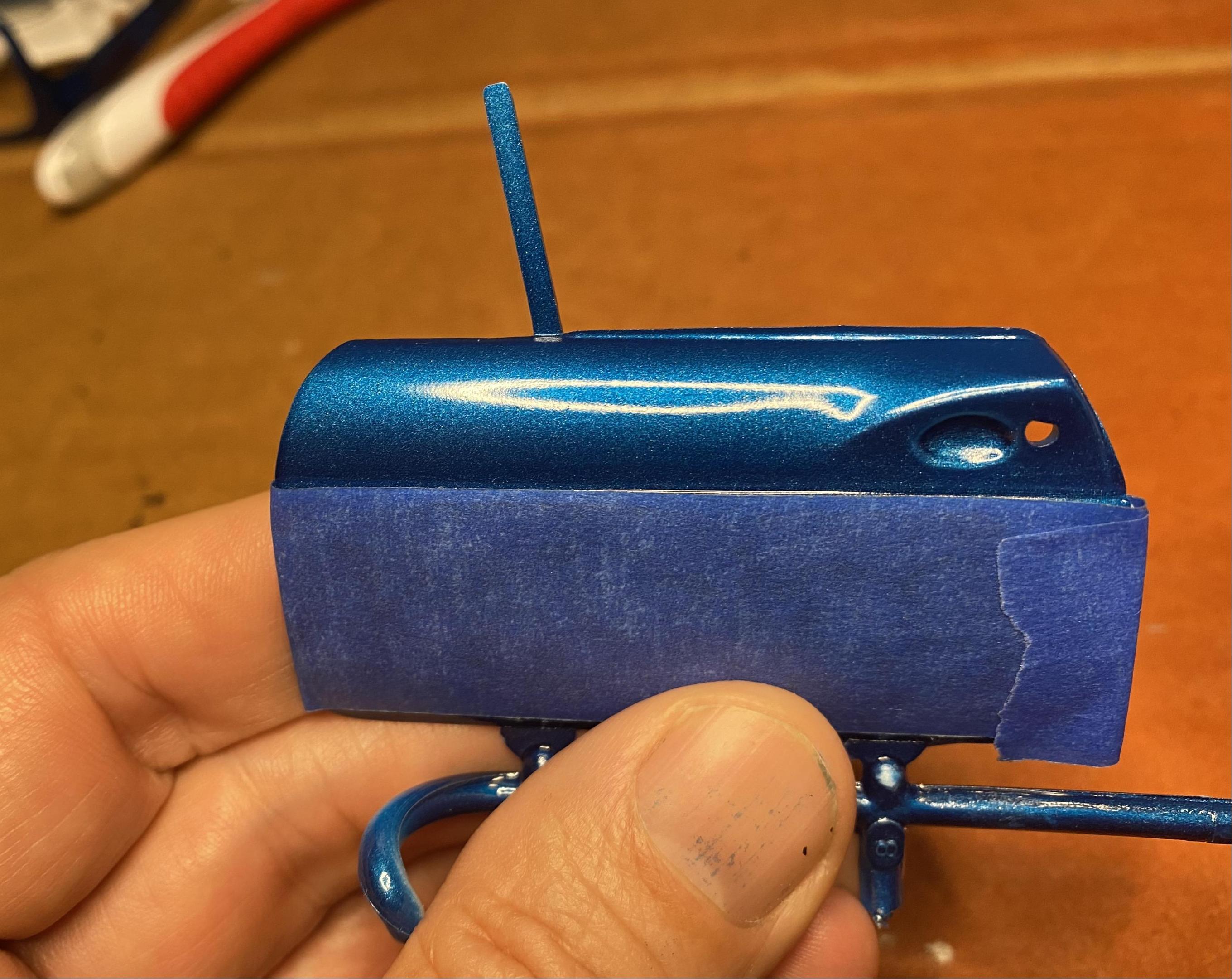

rightrudder Posted January 15 Author Share Posted January 15 (edited) So here's a test panel with the Mr. Leveler. Bare plastic, no prep, three coats You're right, good stuff! I think at this point I'd gently wet sand, add one more coat, then clear. Also experimenting with interior colors. The door panel is done in Tamiya Medium Blue (XF-18), kind of a neat blue/gray. Brush painted here, but I'll spray it on the new project. Got some of that good Tamiya masking tape at the hobby shop too. I might mix a little dark blue with the XF-18. Edited January 15 by rightrudder 1 Quote Link to comment Share on other sites More sharing options...
Dpate Posted January 15 Share Posted January 15 2 hours ago, rightrudder said: So here's a test panel with the Mr. Leveler. Bare plastic, no prep, three coats You're right, good stuff! I think at this point I'd gently wet sand, add one more coat, then clear. Also experimenting with interior colors. The door panel is done in Tamiya Medium Blue (XF-18), kind of a neat blue/gray. Brush painted here, but I'll spray it on the new project. Got some of that good Tamiya masking tape at the hobby shop too. I might mix a little dark blue with the XF-18. Yeah that looks great man. I can tell a big difference from your last picture. Quote Link to comment Share on other sites More sharing options...
rightrudder Posted January 15 Author Share Posted January 15 Thanks! Wet sanding didn't really work here--looked a little blotchy and easy to cut through the paint--so I think I'll be content to lay it on as smooth as possible. It seems the Mr. Hobby clear I'm going to use is more tolerant to sanding, and if it looks glossy enough at that point I may just polish and forgo sanding altogether. I'm glad I have some time to experiment. I appreciate all the great input! Quote Link to comment Share on other sites More sharing options...
rightrudder Posted January 16 Author Share Posted January 16 Final pic of test panel with a couple wet coats of Mr. Hobby clear. Too embarrassed to show lower part of door panel...there's a giant cat hair in the middle, and a thumbprint too...ugh. Mr. Hobby clear dries fast, but not two hours fast on a humid day! I'm really pleased with the finish & gloss. My big takeaway is to NOT wet sand the acrylic as it's ultra easy to burn through it, even with 2000 grit. Maybe it's a function of laying the paint on too thin? Or maybe acrylics are just more fragile this way. Anyway, I've got the game plan for the real thing now. Thanks for all the advice, everyone...invaluable! 2 Quote Link to comment Share on other sites More sharing options...
Dpate Posted January 16 Share Posted January 16 2 hours ago, rightrudder said: Final pic of test panel with a couple wet coats of Mr. Hobby clear. Too embarrassed to show lower part of door panel...there's a giant cat hair in the middle, and a thumbprint too...ugh. Mr. Hobby clear dries fast, but not two hours fast on a humid day! I'm really pleased with the finish & gloss. My big takeaway is to NOT wet sand the acrylic as it's ultra easy to burn through it, even with 2000 grit. Maybe it's a function of laying the paint on too thin? Or maybe acrylics are just more fragile this way. Anyway, I've got the game plan for the real thing now. Thanks for all the advice, everyone...invaluable! Yeah there pretty fragile, and with thin coats yeah you'll burn through pretty fast especially if your clear coats are thin too. But if you burnt through the clear too the color coat than that tells you your clear coats where too thin. You can burn through clear coat fast too, but not that fast unless you're really giving it the grit lol. Quote Link to comment Share on other sites More sharing options...
rightrudder Posted January 16 Author Share Posted January 16 Thanks for that, Dusty. It seems if the mixing of the base metallic isn't perfect, each coat goes on a slightly different way, so even sanding through the last base coat applied can reveal paint that looks different. Fun to learn this stuff, especially on scrap parts!! Quote Link to comment Share on other sites More sharing options...

Sandboarder Posted January 19 Share Posted January 19 On 1/16/2022 at 11:42 AM, rightrudder said: Thanks for all the advice, everyone...invaluable! WOW!!! You have achieved an excellent finish!! I won’t sand any metallics ever as a rule. I can damage the metallic flakes and ruin the effect. Use Mr hobby primer as a micro filler and wet sand if needed. Spray your metallic colour (which yours look great to me before clear) apply the clear and use that to achieve the wet shiny look as you have done. again great job!! Quote Link to comment Share on other sites More sharing options...
rightrudder Posted January 20 Author Share Posted January 20 17 hours ago, Sandboarder said: WOW!!! You have achieved an excellent finish!! I won’t sand any metallics ever as a rule. I can damage the metallic flakes and ruin the effect. Use Mr hobby primer as a micro filler and wet sand if needed. Spray your metallic colour (which yours look great to me before clear) apply the clear and use that to achieve the wet shiny look as you have done. again great job!! Thank you, Chris! I'm totally pleased with it. Great advice on not sanding the metallic...these Tamiya acrylics are wonderful and easy to work with, but they scratch easily until you apply the clear coat. The Mr. Hobby clear dries hard as a rock. I'm gonna apply the base coats to bare plastic, as the primer changes the color too much, so I'll just have to live with any imperfections in the plastic. I'll sand the bodyshell thoroughly with 1000 grit, which should help. On 1/18/2022 at 4:17 PM, Dpate said: Well so far with my kit the side skirts only one fits properly, and the other fits but has a gap. So i'm not going to use them at all. I test fitted the front and rear bumper too, but there kinda iffy. Probably will fit better once i dechrome them and clean them up - than do another test fit. When i first opened the box i knew this was gonna be a iffy kit to begin with lol. I mean there is like 5 ejector pin makes under the hood lol, and the chrome is so thick it took me a few mins to find the windshield wipers lol. There so issues here and there on the chrome too along with flash - so I'm glad i know how and love dechroming and rechroming parts. Yes except i wouldn't use it for Mr.color acrylic line up. Dusty, I hear you on the thick chrome! I couldn't even identify the wipers as wipers until I studied the instructions. I'm with you on the skirts...I'm leaving them off. The car just looks right without them and it shows off the wire wheels better. My bumpers are OK; the rear one is actually pretty nice, but the outboard ends for the front one splay out a bit. I think I'll soak it in hot tap water and see if I can bend it in a little. I might try covering the ends with BMF, as they look a little scratchy. What do you use to dechrome and rechrome? Making good progress. Wow, when you zoom in it really brings out the flaws. Soft, diffused light is your friend! I'm really digging the blue/gray interior color, and I'm using the PE parts sparingly...just the HVAC grille on the conter console. Will use a few more of them in the engine compartment. The set comes with a full set of aluminum interior inserts, but it looked too hard to shave all the door handles, etc. to install them, so I went with Tamiya chrome acrylic instead. 2 Quote Link to comment Share on other sites More sharing options...
rightrudder Posted January 20 Author Share Posted January 20 I'm glad I'm experimenting a lot, because when spraying the firewall, the metallic blue with Mr. Hobby leveler turned out far more silver than desired. I thought, is the paint going bad? But then I reshot it with IPA as a thinner and I got the rich blue that I wanted. Interesting that a thinner can affect the color that much...probably just a metallics thing. Probably lays all those flakes down flat where they become more effective at reflecting light. So, Mr. Leveler reserved for non-metallics, and I can use el cheapo IPA for now. Quote Link to comment Share on other sites More sharing options...
