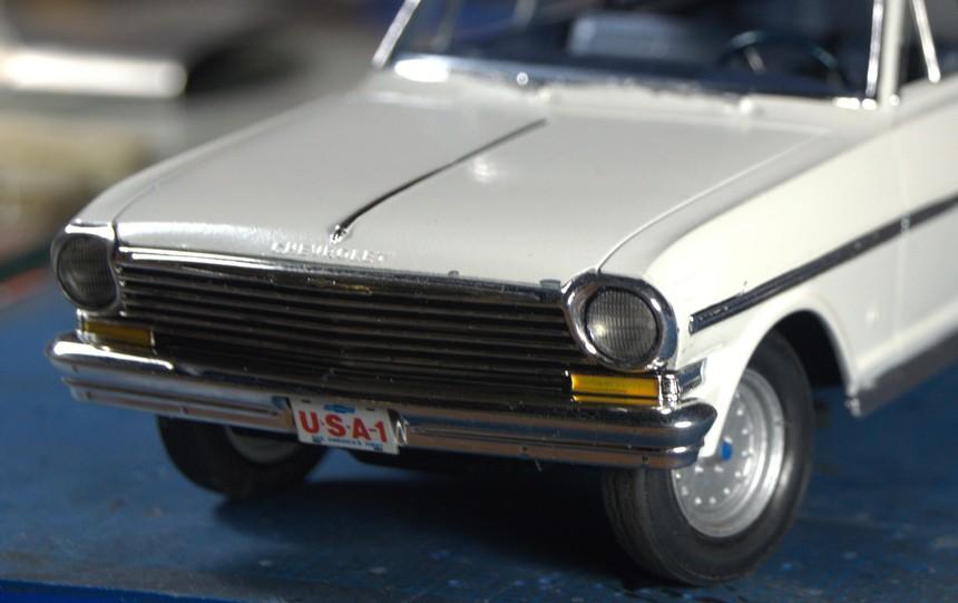

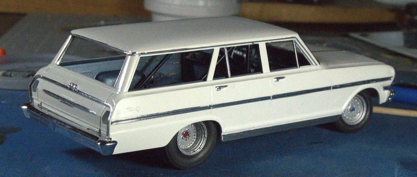

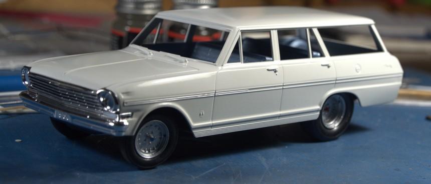

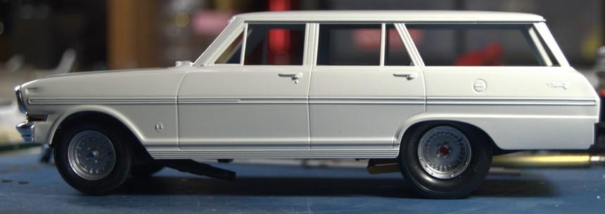

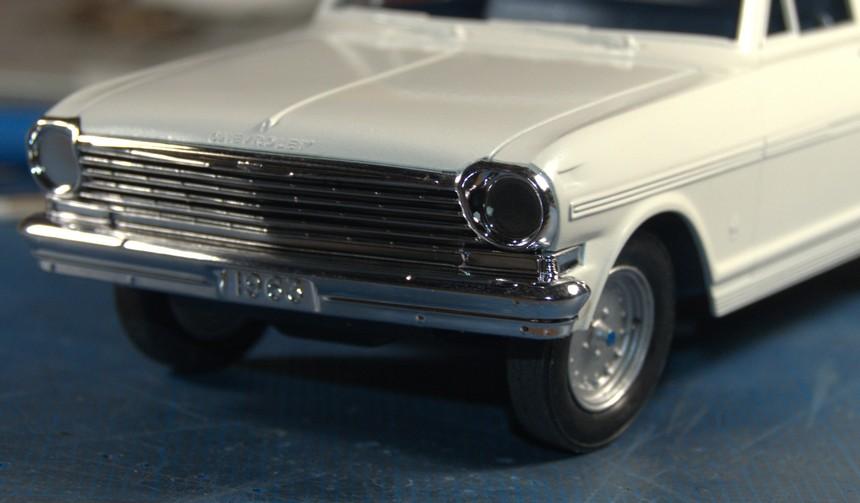

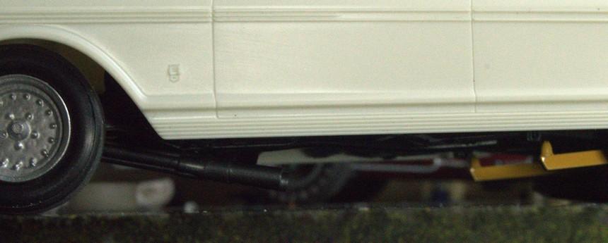

Straightliner59 Posted January 30, 2022 Share Posted January 30, 2022 (edited) This was my attempt for the 24 hour build. I didn't make my deadline (0200, 01/30/22), but got it a bit over halfway done. Anyway...the headers and slapper bars are scratchbuilt. I cast the wheels in nail resin. Front tires are Frontrunners from a Monogram Pro Stock kit (lettering to the inside, since this is a curbside). Rears are AMT Parts Pack Goodyears. I mixed the major blue using Model Master Pontiac Engine Blue, and Arctic Blue. I should get it finished up in the next few days. As always, questions, comments and critiques are welcome. Thanks for looking! Edited April 1, 2022 by Straightliner59 2 Quote Link to comment Share on other sites More sharing options...

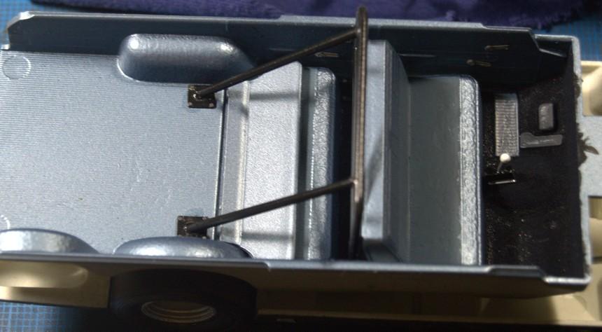

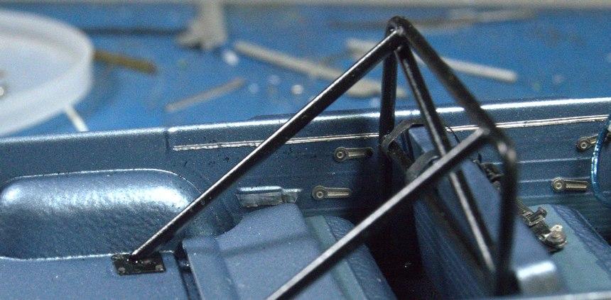

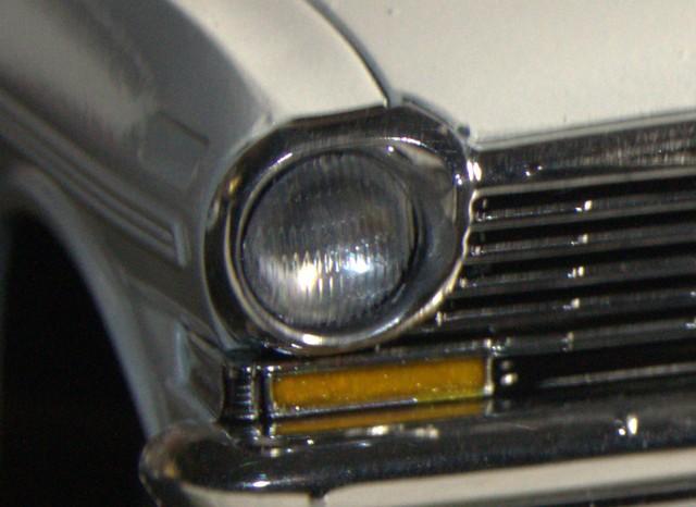

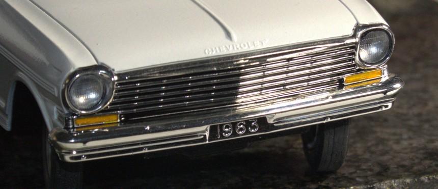

Straightliner59 Posted February 1, 2022 Author Share Posted February 1, 2022 On 1/30/2022 at 1:27 PM, Ace-Garageguy said: Nice. I've always had a soft spot for draggin' wagons. Oooh! And Modified Production! Especially M/P! I got the grille finished. Reworked the headlights. I drilled out the flat backs of the kit, and replaced them with tooling aluminum discs, domed with a doming block set--a great investment for scratchbuilders, BTW. Roll bar is assembled and painted. I'll add bolt heads to the mounting plates, and install it. I am super happy with its fit! As always, questions, comments and critiques are welcomed. Thanks for looking! 1 Quote Link to comment Share on other sites More sharing options...

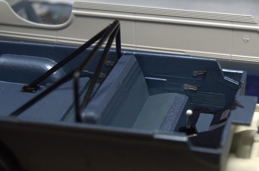

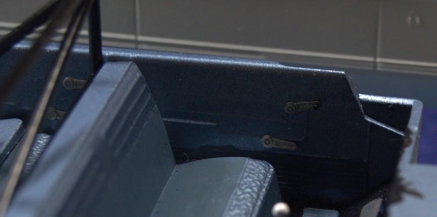

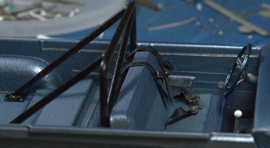

Straightliner59 Posted February 1, 2022 Author Share Posted February 1, 2022 I got the bolts added, and the rollbar installed. I painted the inside of the roof and cut a headliner from a sheet of textured paper I had lying around. The inner roof is painted Humbrol Azure Blue, and the headliner is a Humbrol sky blue. I've had many of these tins of paint for about forty years. I stirred them and added a little spec paint thinner, and they worked beautifully! I used some photoetched door handles and window cranks I had in a drawer, and made knobs for the cranks from shor lengths of Evergreen rod. I see a couple of spots that could use some paint touch up, but, I mixed the metallic blue, and I used it all. Comments, etc.--bring 'em! Thanks for lookin'! 1 Quote Link to comment Share on other sites More sharing options...

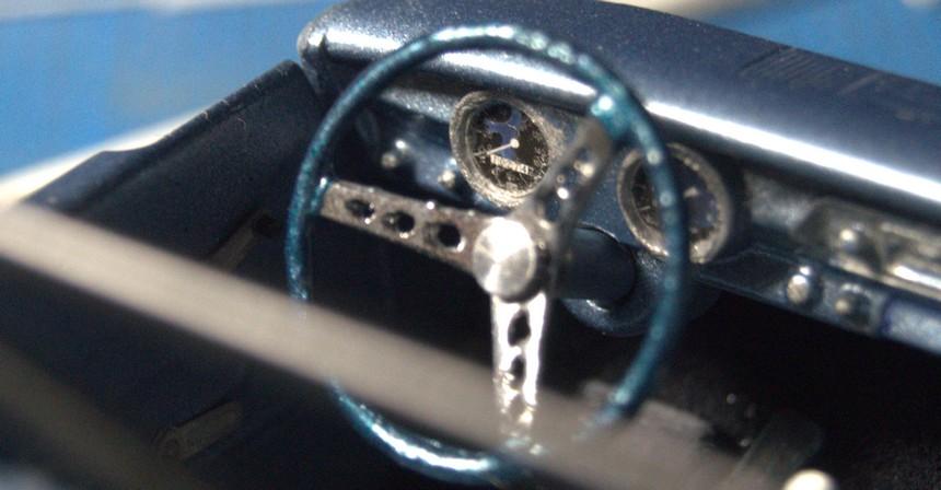

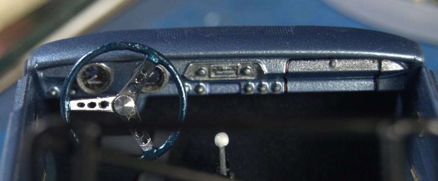

Straightliner59 Posted February 6, 2022 Author Share Posted February 6, 2022 I've done a few more things, to it, in the last couple of days. Rules recommend a rollbar. If you have a rollbar, you also must have shoulder straps. Therefore, I went with a four-way setup. I installed some photo-reduced gauges and clear lenses. I built the wheel from two cut-apart kit pieces. I thought one of those old metalflake blue Moon steering wheels would be sexy! She's coming along. As always, comments, questions and critiques are welcome. Thanks for looking! For the record, I have dulled the sidewalls of the slicks, since I last got photos of them. Quote Link to comment Share on other sites More sharing options...
BuilderX Posted February 6, 2022 Share Posted February 6, 2022 What is the horn button where/made from?? Quote Link to comment Share on other sites More sharing options...
bytownshaker Posted February 6, 2022 Share Posted February 6, 2022 Looks great I'll be following for sure. One of my favorite cars ( Charlene Wood ) to watch launch off the line attached. 1 Quote Link to comment Share on other sites More sharing options...
Straightliner59 Posted February 6, 2022 Author Share Posted February 6, 2022 4 hours ago, BuilderX said: What is the horn button where/made from?? I made it on the lathe, with an 80 tpi. straight knurl. I used a knitting needle from Dollar Tree for the stock! 1 Quote Link to comment Share on other sites More sharing options...

Straightliner59 Posted February 7, 2022 Author Share Posted February 7, 2022 (edited) I finally finished the interior. I just thermo-formed a new windshield from .010" clear sheet. I'm going to make sure the bumpers fit well, and properly, then will foil the body. Then, it'll be just a matter of putting on the final bits, then putting it all together. I'll then call it done, while I finish up the graphics and decals. I'm pretty happy with the interior! I forgot to mention, earlier, that I had to cut the rear seat apart, and make it look like it was folded, in order to clear the rollbar. I reckon you've already figured that out, but, felt I should clarify. Questions, comments and critiques are always welcome. Thanks for looking! Edited February 7, 2022 by Straightliner59 1 Quote Link to comment Share on other sites More sharing options...
