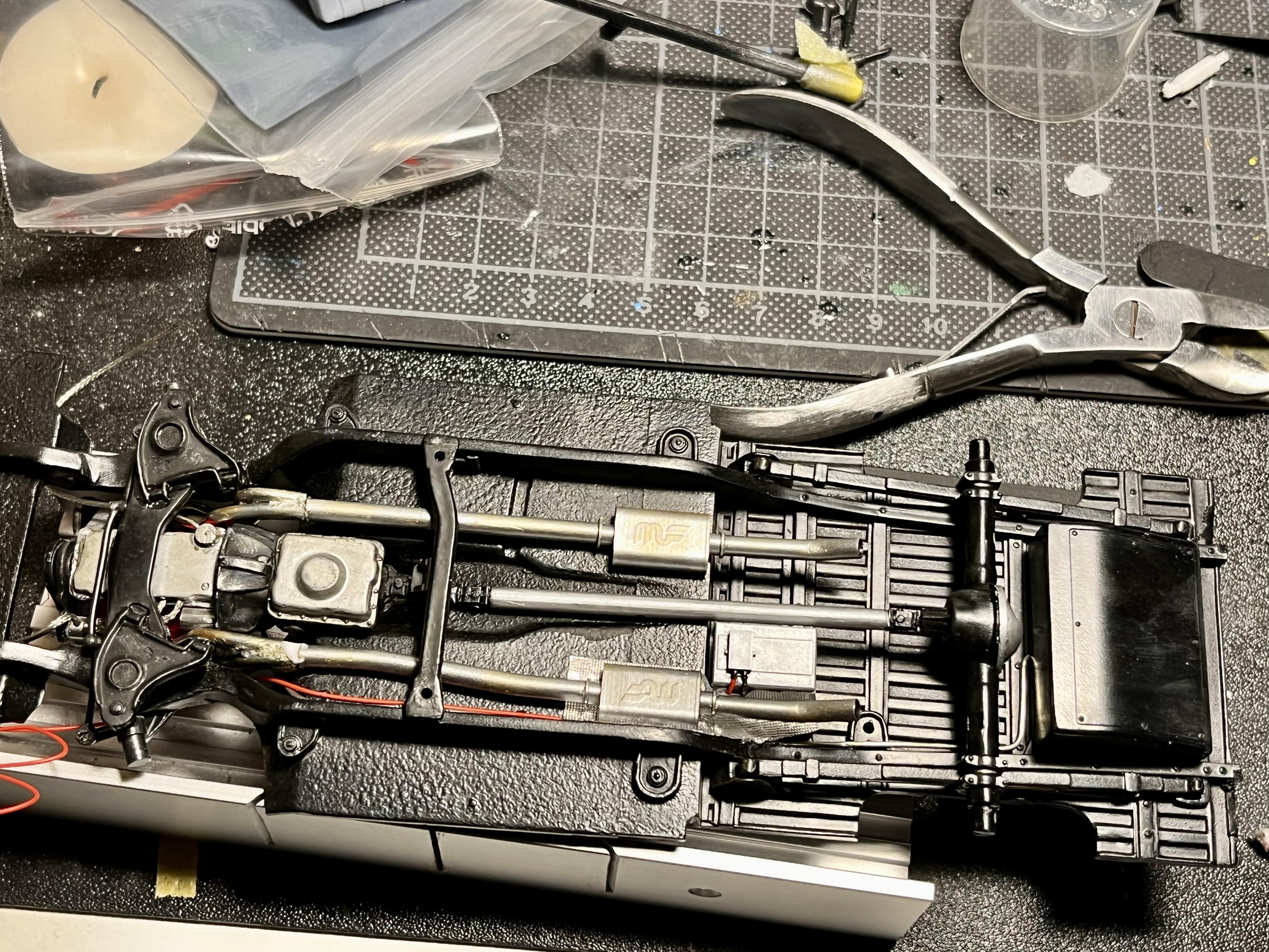

Mattilacken Posted November 21, 2022 Share Posted November 21, 2022 Got my mufflers from a fellow forum member that printed them for me. I made them for a 3,2mm tube. Quote Link to comment Share on other sites More sharing options...

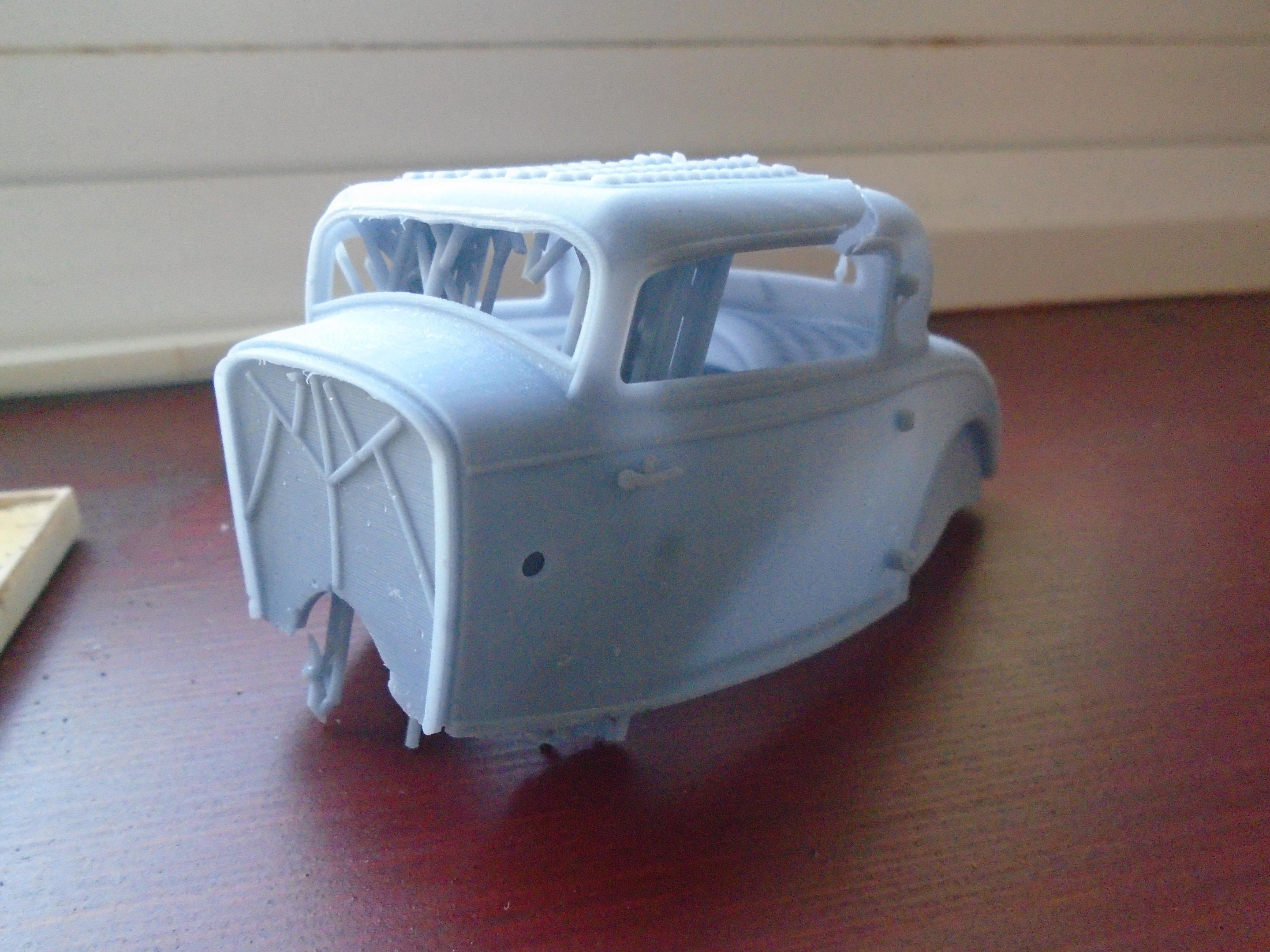

stitchdup Posted November 27, 2022 Share Posted November 27, 2022 my 32 body printed great. then i cracked it removing the supports as i thought they would get in the way of the curing. I think i can save the body if i remove the centre from the roof but it printed fantastic. Its half past 5 am here so i'm going to sleep now 2 Quote Link to comment Share on other sites More sharing options...

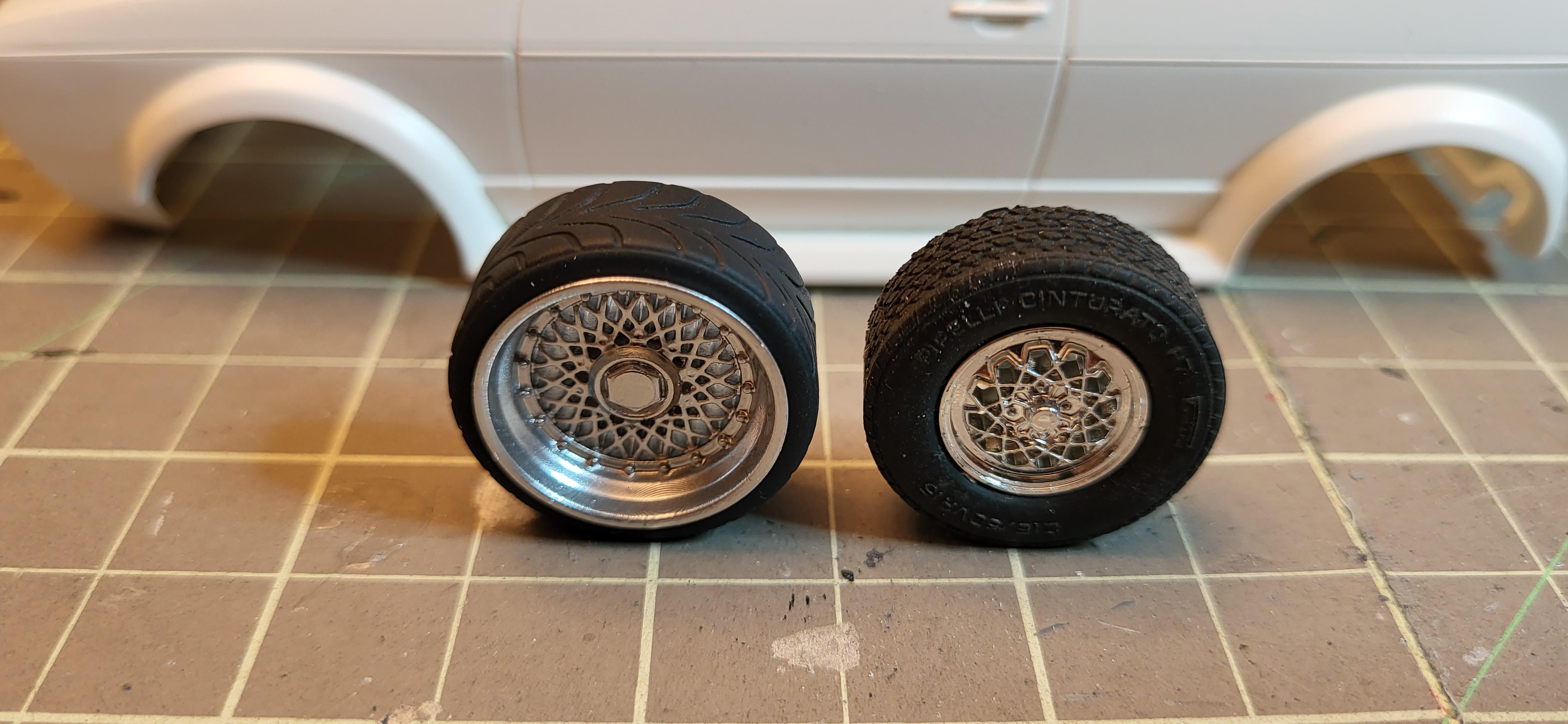

stitchdup Posted November 27, 2022 Share Posted November 27, 2022 So heres my first sucessful print, a set of raceline rims. I used up my waterwashable for these and there is noticable shrinkage compared to a set of the same i purchased before getting the printer. Its not a great pic. so after that was a sucess i printed the body for a 32 3 window with 0.05 layer and it worked. It was looking good until i damaged it removing the supports as they were very dense and i didn't think the uv would get through. It has a bit of warpage on the lower body also but that may be because i left it in the water overnight before curing and it softened. 2 Quote Link to comment Share on other sites More sharing options...

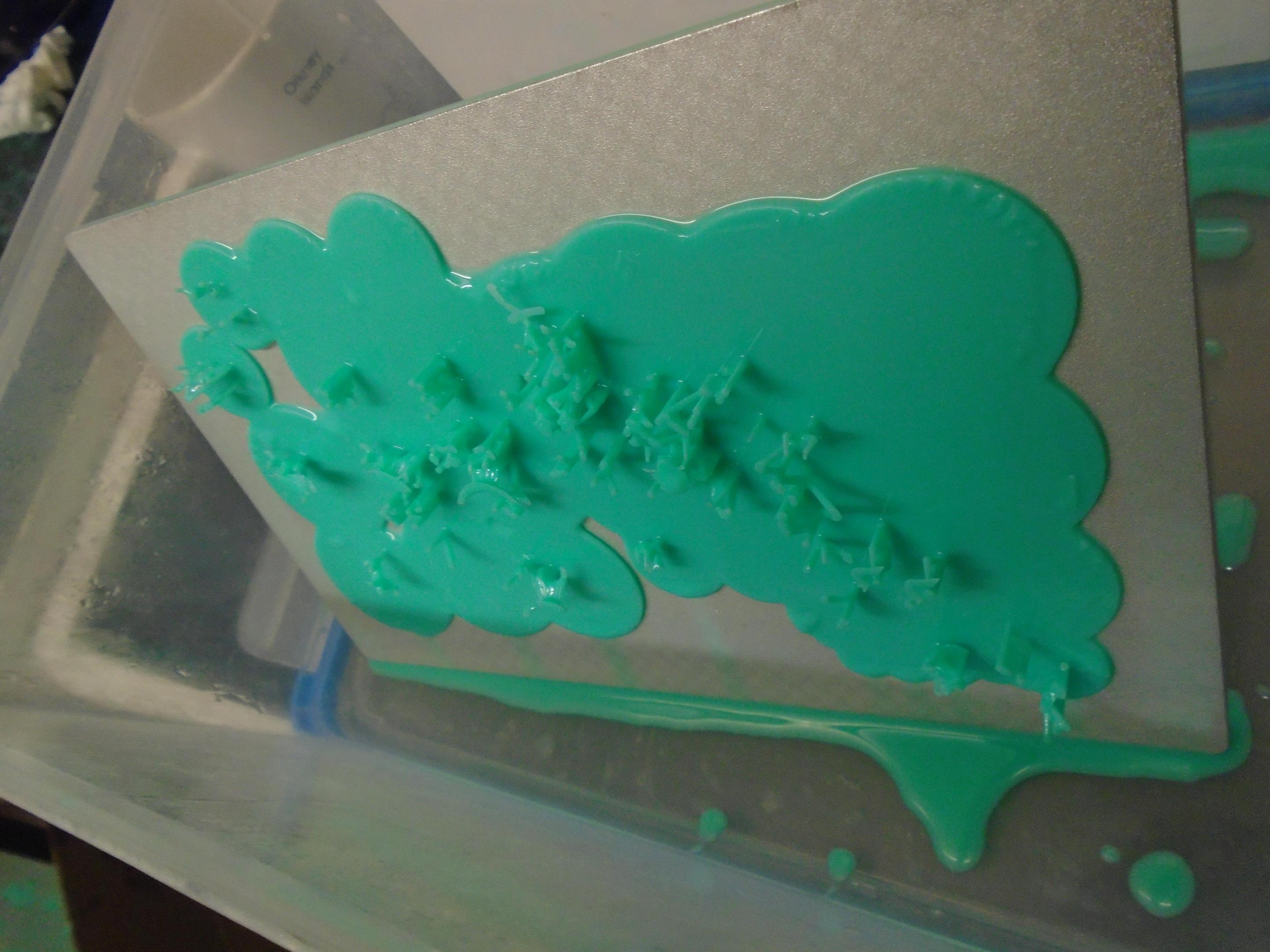

stitchdup Posted November 29, 2022 Share Posted November 29, 2022 And itsall been downhill from there. My prints are sticking to the resin tank again. I'm using phrozone aqua green resin. I have it set at the settings already in lychee for the resin and i've reset the z axis zero every time the tank or plate has been removed. I've had so many failures the bottom of the tank is now pretty dented. I just cant seem to get the prints to stop sticking. Once the supports reach the print item is when it seems to be failing and sticking to the tank. Quote Link to comment Share on other sites More sharing options...
stitchdup Posted November 30, 2022 Share Posted November 30, 2022 I tried another print with thicker joins between the supports and item. I had a full engine and a set of wheels and tyres but only a couple of parts came out useful and even they are mis-shapen. It seems like theres something strange going on as some parts only print the top half and others only print the bottom of the item while other just print on the tank, even when they are on the same print run. for example the gearbox for the engine was sitting at 45 degrees with the engine end pointed up and it started printing the gearbox from half way along the tailshaft. I've spent a lot of money trying to get this to work and i'm onto my 5th bottle of resin now with only one set of wheels from over 100 quids worth of resin that have turned out well. I've been trying to find somebody local that could give me advice but so far i've only found people that have the plastic filament printers and they cant help. It seems no matter what i try with this machine that it just wants to cost me cash. I follow the settings anycubic recommend and still its a disaster. I'm tempted to just sell the piece of garbage cos its not saved me any cash and i could have bought all the parts i've tried to print for less, even with the ridiculous postage we have now. I'm just sick of the sight of the thing now, 2 months of failures and 4 months rent down the toilet. I've tried everything people have suggested and it just wont do the job its supposed to do. anycubics suggested resin settings on their site are the same for every resin and i tried them with no sucess except 1 set of wheels, i've tried settings from 3d print help pages, forums so i just dont know what to do now. 1200 pounds wasted Quote Link to comment Share on other sites More sharing options...
MeatMan Posted November 30, 2022 Share Posted November 30, 2022 13 hours ago, stitchdup said: I tried another print with thicker joins between the supports and item. I had a full engine and a set of wheels and tyres but only a couple of parts came out useful and even they are mis-shapen. It seems like theres something strange going on as some parts only print the top half and others only print the bottom of the item while other just print on the tank, even when they are on the same print run. for example the gearbox for the engine was sitting at 45 degrees with the engine end pointed up and it started printing the gearbox from half way along the tailshaft. I've spent a lot of money trying to get this to work and i'm onto my 5th bottle of resin now with only one set of wheels from over 100 quids worth of resin that have turned out well. I've been trying to find somebody local that could give me advice but so far i've only found people that have the plastic filament printers and they cant help. It seems no matter what i try with this machine that it just wants to cost me cash. I follow the settings anycubic recommend and still its a disaster. I'm tempted to just sell the piece of garbage cos its not saved me any cash and i could have bought all the parts i've tried to print for less, even with the ridiculous postage we have now. I'm just sick of the sight of the thing now, 2 months of failures and 4 months rent down the toilet. I've tried everything people have suggested and it just wont do the job its supposed to do. anycubics suggested resin settings on their site are the same for every resin and i tried them with no sucess except 1 set of wheels, i've tried settings from 3d print help pages, forums so i just dont know what to do now. 1200 pounds wasted Yeah, something must be amiss. About the 5 bottles of resin; I filter my used resin with paint filters and reuse it and never had a problem. I know some manufacturers say you shouldn't but I think most people do. Just don't get different types mixed up. Again, did you ever print the test model that comes with the printer? I suggest resetting all of your settings to factory spec and printing the test cube, or whatever model came with yours. Also, did you run the exposure test? It might tell you if there is an issue with the screen. There is a process for troubleshooting these things and although you are frustrated I think you might want to go through the steps. Good luck. 1 Quote Link to comment Share on other sites More sharing options...
CabDriver Posted December 1, 2022 Share Posted December 1, 2022 9 hours ago, MeatMan said: Yeah, something must be amiss. About the 5 bottles of resin; I filter my used resin with paint filters and reuse it and never had a problem. I know some manufacturers say you shouldn't but I think most people do. Just don't get different types mixed up. Again, did you ever print the test model that comes with the printer? I suggest resetting all of your settings to factory spec and printing the test cube, or whatever model came with yours. Also, did you run the exposure test? It might tell you if there is an issue with the screen. There is a process for troubleshooting these things and although you are frustrated I think you might want to go through the steps. Good luck. Agreed - and I’d still be interested in seeing screenshots of the Lychee layouts that aren’t working out 2 Quote Link to comment Share on other sites More sharing options...

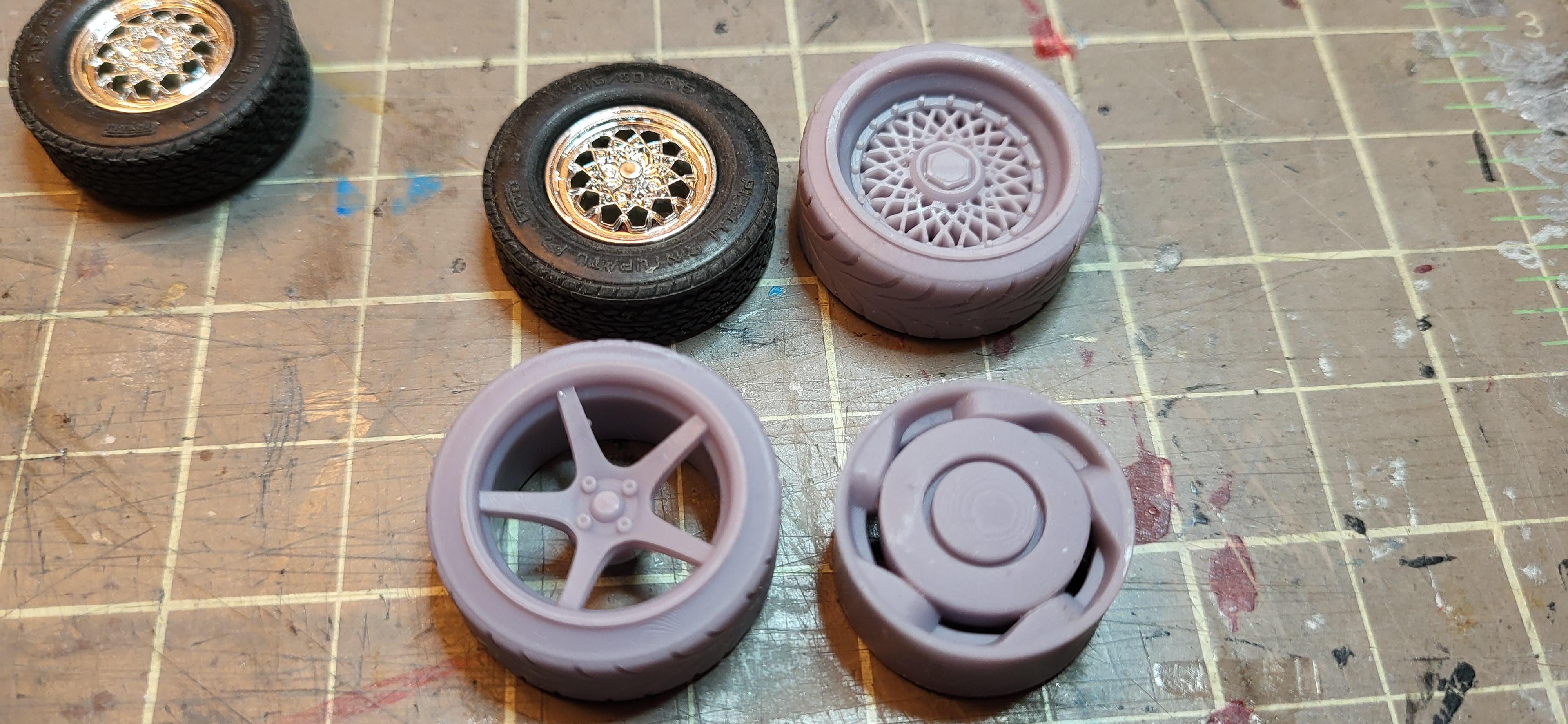

iamsuperdan Posted December 7, 2022 Author Share Posted December 7, 2022 A little something I'm working on. Kit parts on the right (obviously) and 3D printed on the left. And here are my experiments for this kit. 5 Quote Link to comment Share on other sites More sharing options...

stitchdup Posted December 12, 2022 Share Posted December 12, 2022 finally got it to work. turns out the exposure was set to 1 second which worked on the water washable resin but not on the normal resin. I also had the contact points for the print supports about half the size they needed to be. I did a print yesterday with a range of different size contact points and 0.5 seems to be working on most items but i'll probably go with 0.6 for a margin of safety. I knew it couldn't be much causing the fails so i'm happy to have it working now. I've left it and come back to it many times. 1 Quote Link to comment Share on other sites More sharing options...
