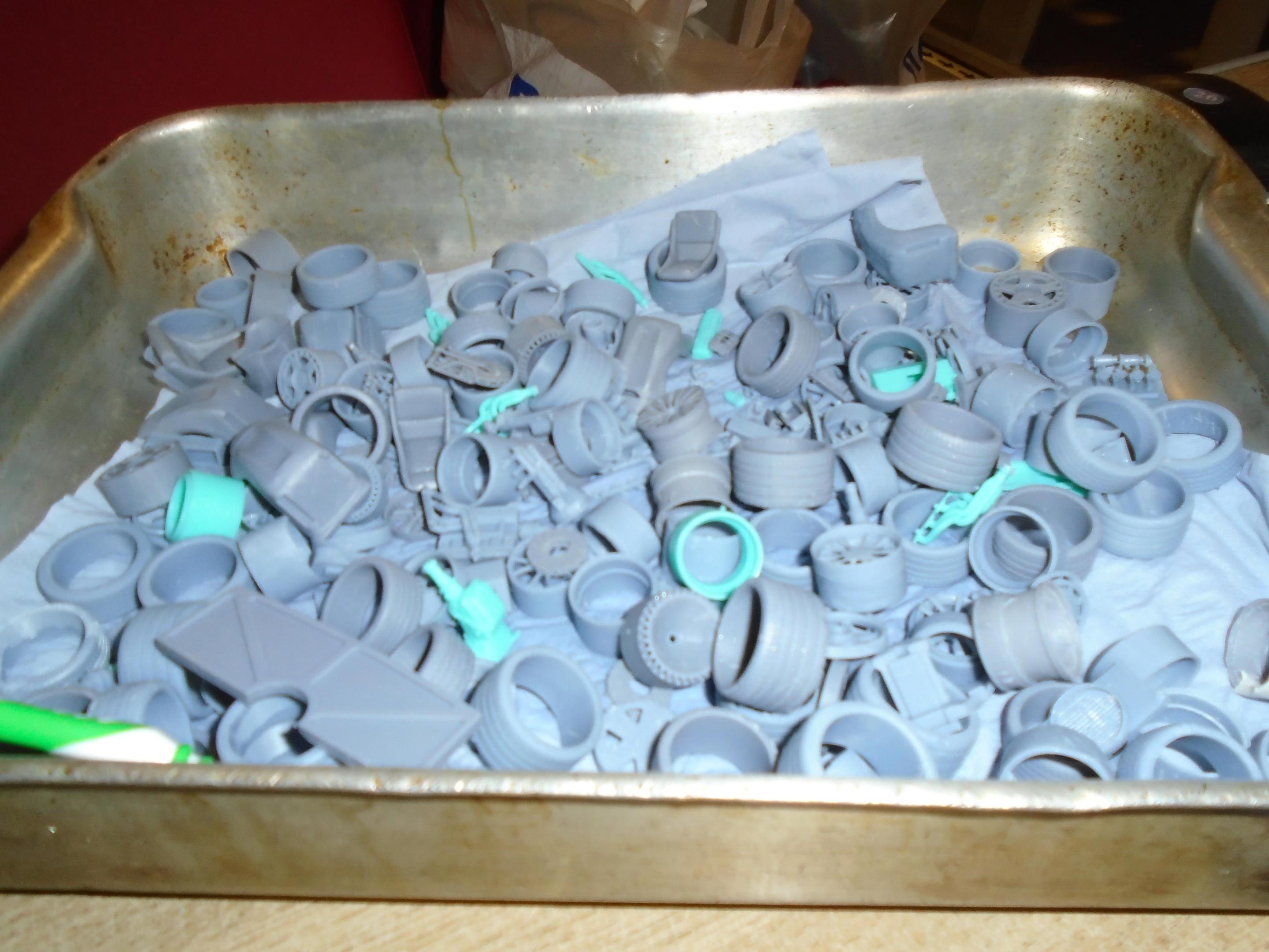

stitchdup Posted December 14, 2022 Share Posted December 14, 2022 I might have got a little carried away now i have it working. I've been printing flat out since the first print worked and i've started modifying sizes/scales to get the wheels i want. I've printed one of blackbox stl's 527 engines with various inductions, a bmw e36 m3 engine and turbo set up, right now i have a set of wheels from an rc car i've resized to fit the e tron tyres but just in case they aren't big enough I have some other options such as a set of flat face fuchs and some 911 rims. Now it working i'm having fun playing with it so maybe next week i'll get the 32 printed. Quote Link to comment Share on other sites More sharing options...

stitchdup Posted December 15, 2022 Share Posted December 15, 2022 9 minutes ago, iamsuperdan said: It's addictive isn't it? I have printed so many wheels, tires, engines, engine bay parts, seats, etc that I don't really know what I'm going to do with them all. I look at my stash, something jumps out, I get an idea, then suddenly I'm downloading files and printing parts. What am I doing? Am I mad? I have a dozen projects on the bench, I don't need to be printing parts for future projects! So now it's a stash of kits, and a stash of printed parts! Ahh well, it's still fun, and that's what it's all about. im sure i have no idea what you mean, lol 2 Quote Link to comment Share on other sites More sharing options...

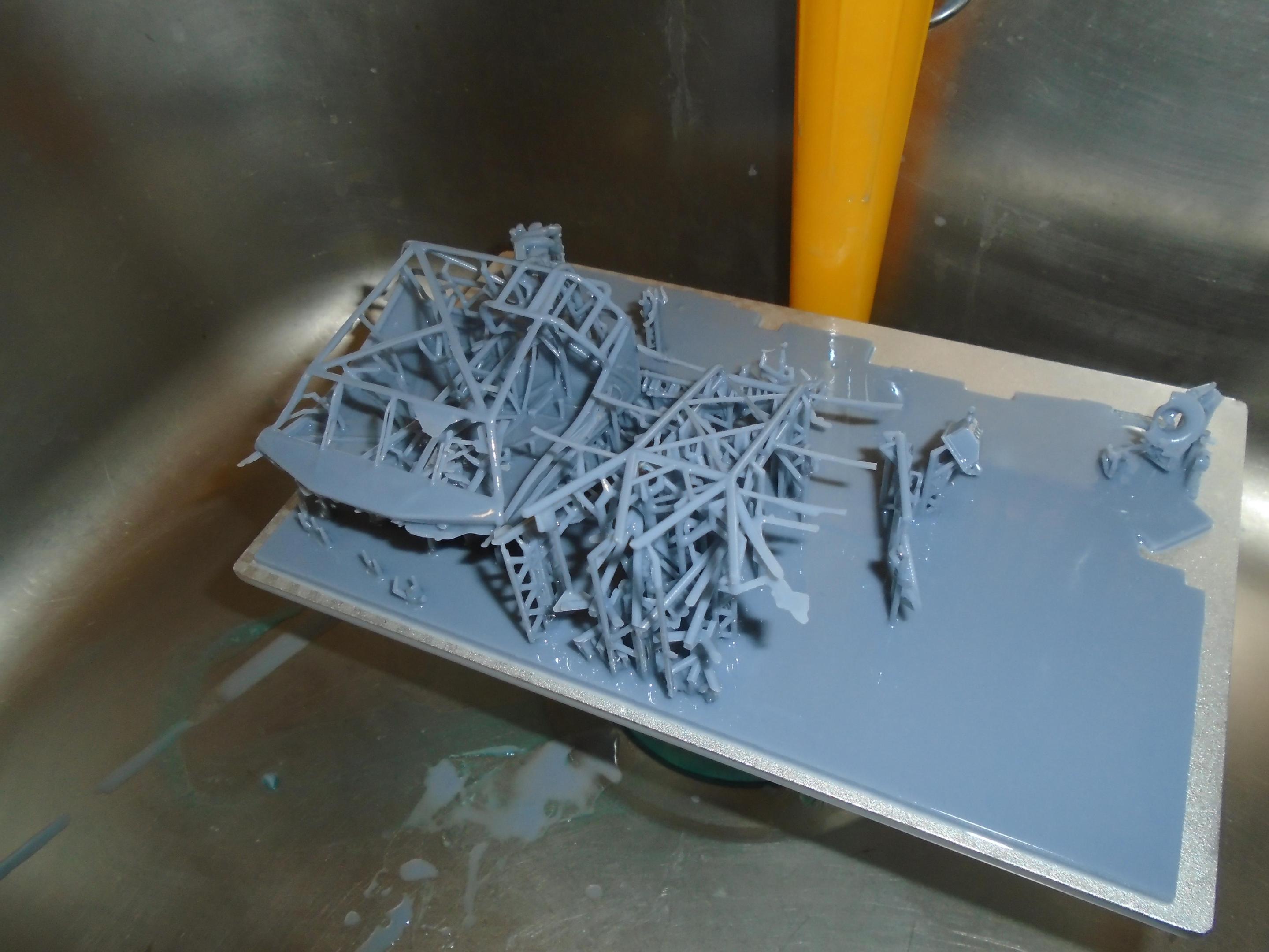

stitchdup Posted January 10 Share Posted January 10 On 1/8/2023 at 3:32 AM, Lownslow said: Slow your printer way down for thin parts also reduce you exposure times. your resin is bad i suggest you contact the manufacturer well that didn't work, used a new bottle of resin, rain x on the tank and reduced lift to 1mm per sec and exposure to 1.8 and this is the result. the first time the bottom of the chassis floor printed fine but went wrong above that, this time it did this. I've tried contacting anycubic support but i cant seem to get past the captcha they use before you submit the ticket. Quote Link to comment Share on other sites More sharing options...
