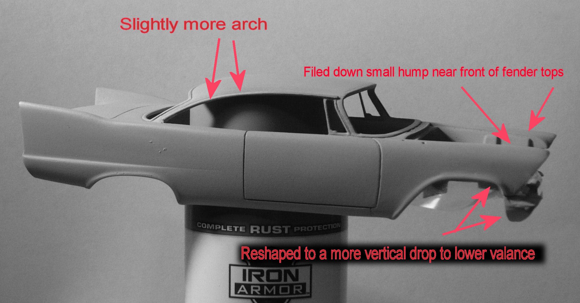

bisc63 Posted February 10, 2022 Share Posted February 10, 2022 I started this one way back, then got distracted by other matters. Recently, Smitty's excellent build of this kit inspired me to make an effort to get back on this and finish it! It will be slow progress, but progress nonetheless. Instead of box stock, I'll be doing a sort of home-built hot rod with a 70's vibe kinda thing. We all know this kit has its issues, and there are many ways to approach improvements. It'll never be perfect, but it can be much better than it comes out of the box. First and biggest improvement is to get that drooping rear quarter panel up at the tail. I sliced down the door line, then rearward just under the lower trim. I stuck a small section of square styrene bar in as a spacer, and that gave the lift I was looking for. This solves raising not only the trim, but the top of the quarter panel as well, as it should. On the real car, the quarter begins sloping upward to the back as soon as it leaves the door line. A few pics to show where I am and how I got there: Quote Link to comment Share on other sites More sharing options...
bisc63 Posted February 10, 2022 Author Share Posted February 10, 2022 ...and then I decided to lose the trim altogether, after seeing another build that did that! Quote Link to comment Share on other sites More sharing options...

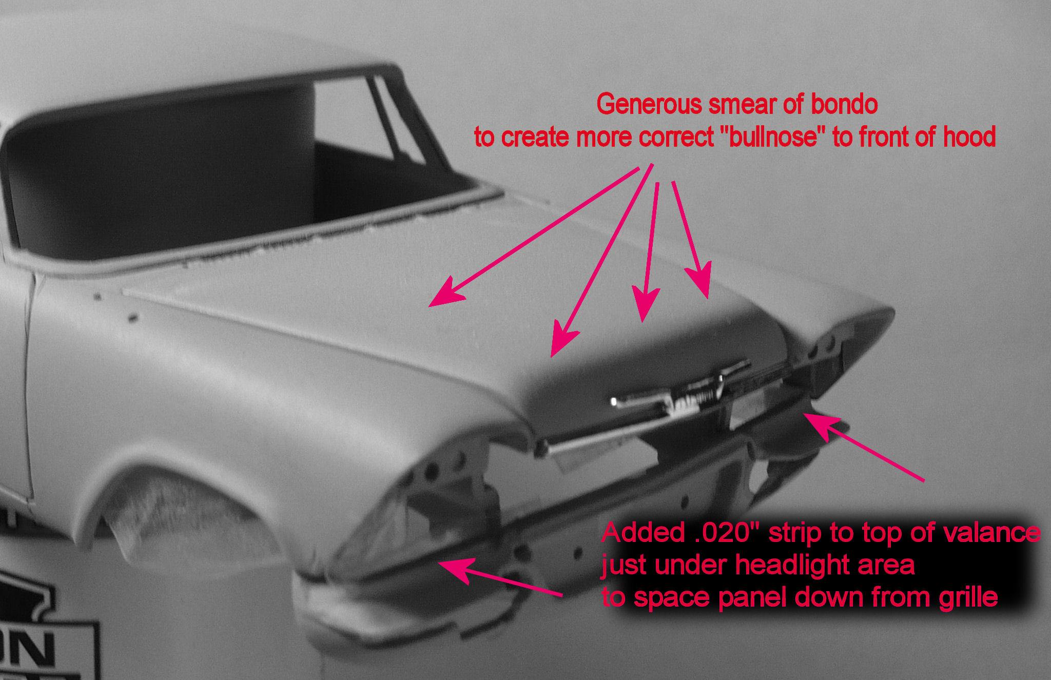

bisc63 Posted February 10, 2022 Author Share Posted February 10, 2022 Another sore spot for me is the front view of the hood. It's much too flat across the front, rolling like a later model hood might. It should have a bit of bullnose. If you have a '59 Imperial kit in your stash, look at the hood on that. That's the look. Bondo to the rescue, and a relatively simple improvement. Quote Link to comment Share on other sites More sharing options...

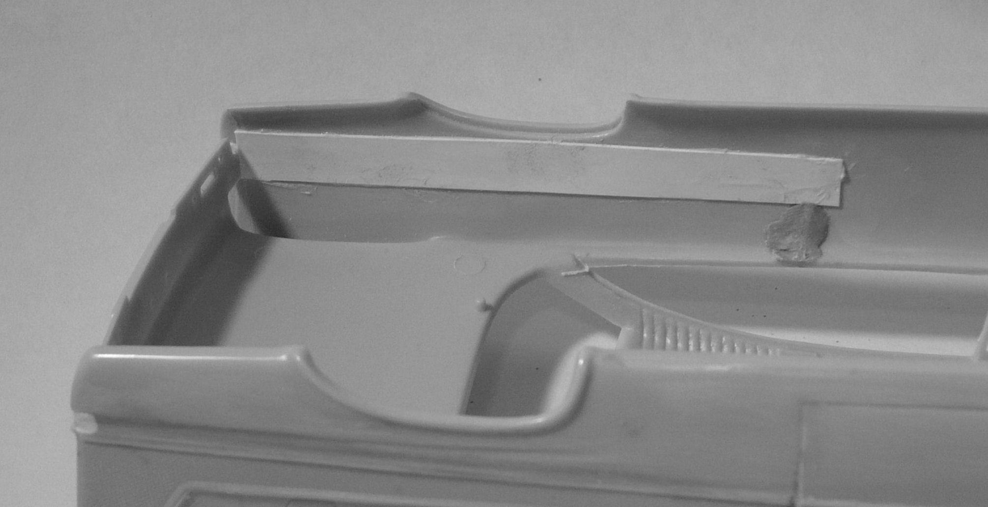

bisc63 Posted February 10, 2022 Author Share Posted February 10, 2022 Poorly pictured above also is some reshaping on the ends of the front lower valance panel. I added some styrene to the ends, then began filing to a more accurate contour. ( Still roughed in as shown) I had to think on this for a while. That seam between the fender and valance should be visible when using plain-style bumpers (which I will be), but the kit sets the bumper too high. First I added .020" shims to the top ens of the valance to drop everything a scale half inch down from the grill. Next I slotted the bumper mounting holes gently to drop it a tad more, but ran into interference from the filler panel forward extensions. Next step, superglue some .020" to the bottom of those extended areas, giving me enough "meat" to file them down from the top, thinning and sloping down at the same time so they tuck under/behind the bumper as they should. Quote Link to comment Share on other sites More sharing options...

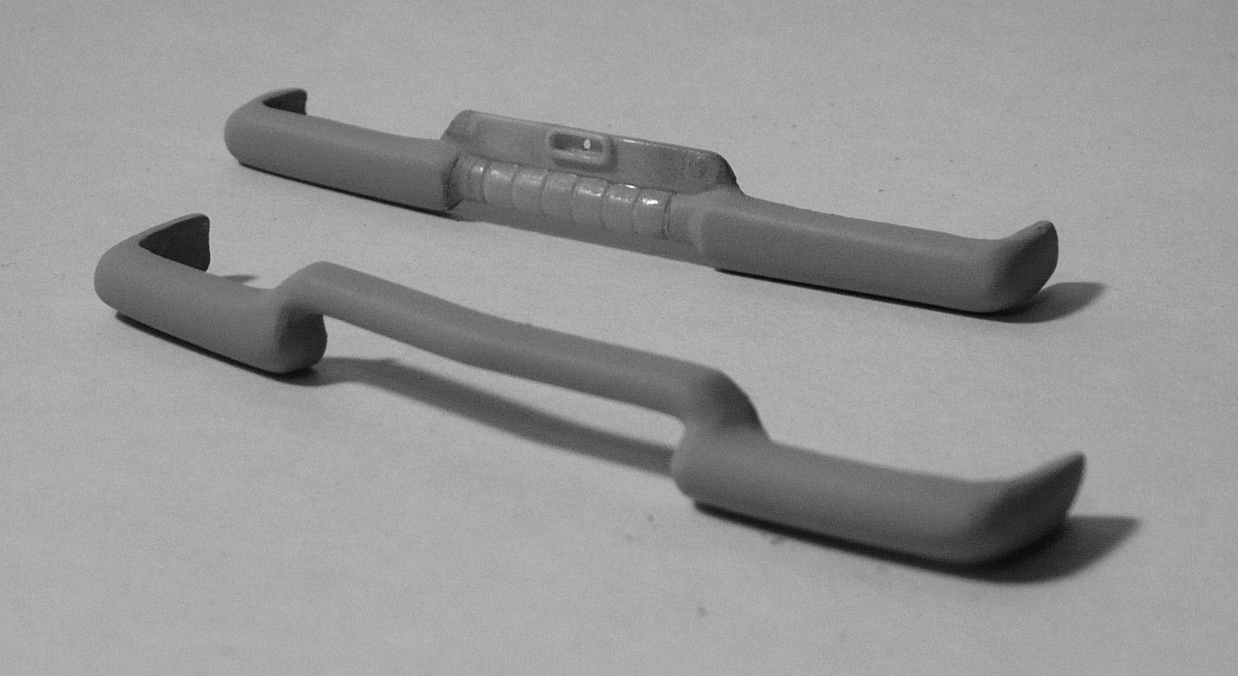

bisc63 Posted February 10, 2022 Author Share Posted February 10, 2022 My bumpers, once I did away with their "wings". I prefer this cleaner look, as was used on the cheaper body styles. Quote Link to comment Share on other sites More sharing options...

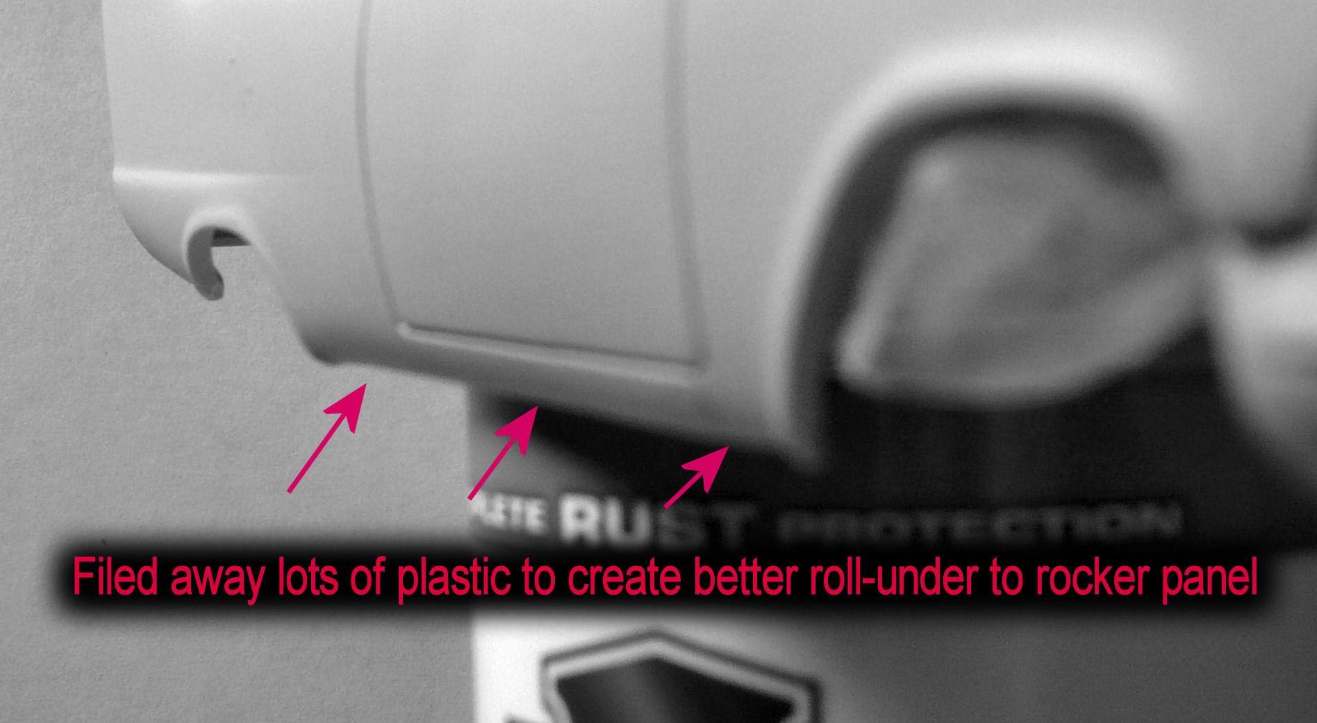

bisc63 Posted February 10, 2022 Author Share Posted February 10, 2022 There should be a serious roll under of the rocker panels, but AMT made them near vertical. No problem, though, as the kit plastic is thick enough to let you scrape, file, and sand to a much better contour. Use a small round file near the wheel opening lips to roll them under as well. Patience is key keeping those shapes right! Quote Link to comment Share on other sites More sharing options...

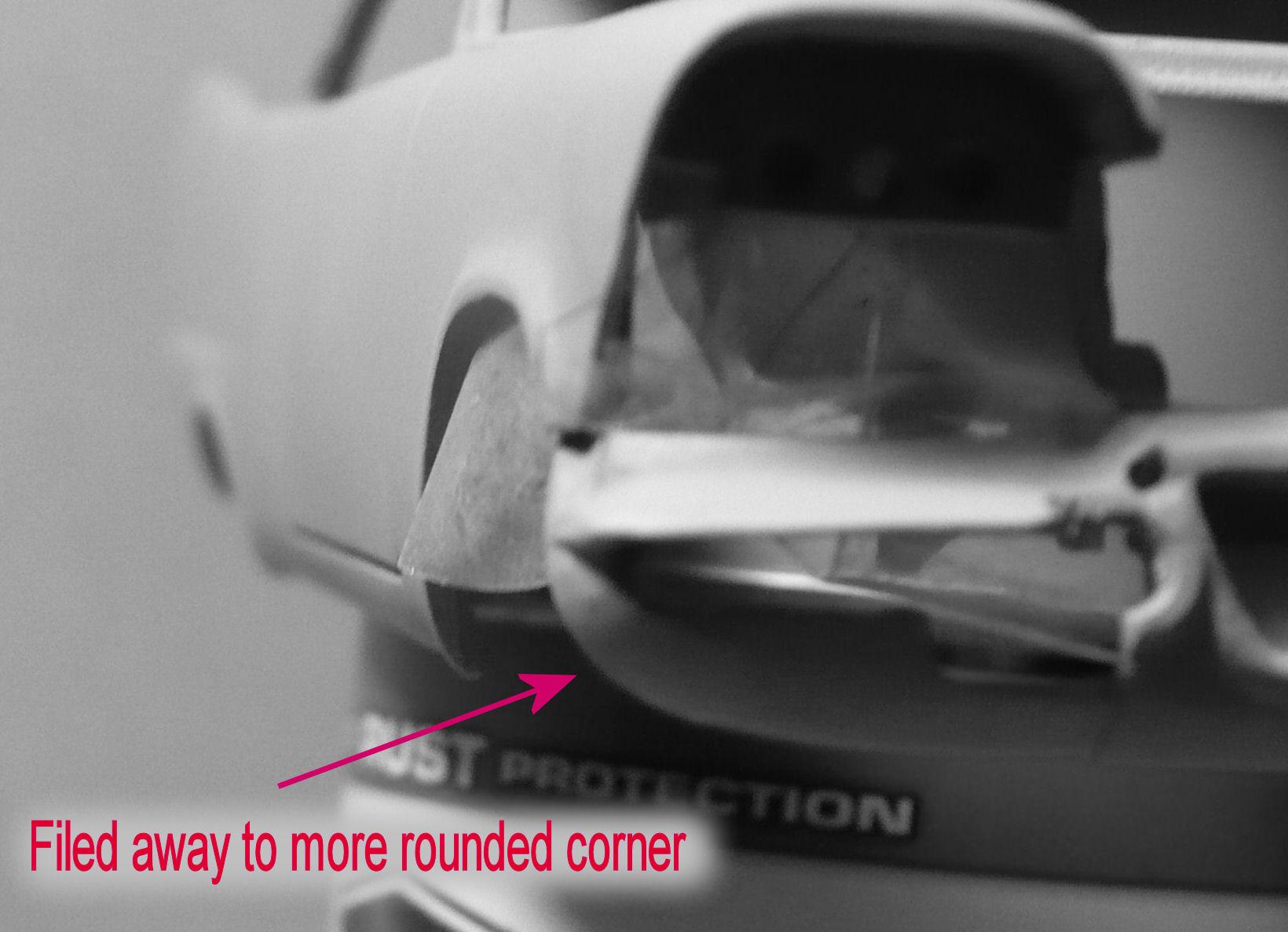

bisc63 Posted February 10, 2022 Author Share Posted February 10, 2022 Another area that needs some material removed (IMHO). The outer corners of that lower valance up front looks too squared to my eye, compared to pics of the real thing. I backed up the inside of the piece with some epoxy, and then took a big file to it. I think it's better... Quote Link to comment Share on other sites More sharing options...

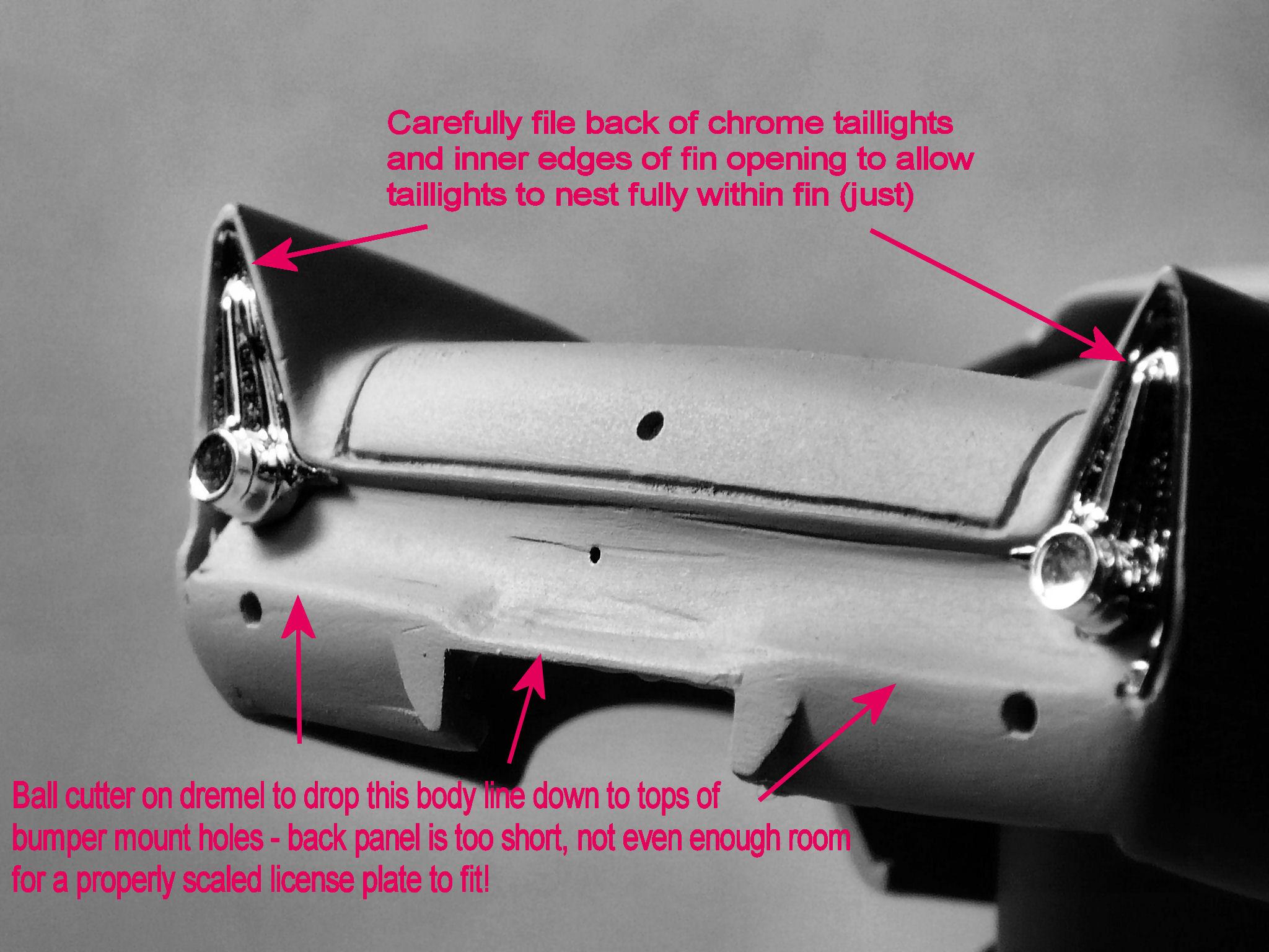

bisc63 Posted February 10, 2022 Author Share Posted February 10, 2022 The tail end needs some attention, too. The tail lights don't fit correctly out of the box, but it's not immediately noticeable if you haven't seen the real thing. Most cars have a bright housing surrounding the lens, sitting ON the outer surface of the sheet metal. These Plymouths have the bright housing tucked IN the opening on the back of the quarter panel. You can actually see body-colored narrow ends of the fin surrounding the taillight when viewed from the rear. Slow work with a fine file and sanding sticks lets you gain a very precise fit. Once again, there's plenty of plastic inside that opening, and I actually began with an Exacto knife. Another sore point is the panel below the trunk lid; it's too short. It looked off to me, so I did a little measuring, and found that a 1/25 plate wouldn't even fit as it should. The kit plate fits because it is too small! For this one, I just started filing and cutting with a Dremel tool to drop the lower lines down, adjusting the bumper down a little as needed (not much at all). I also filed the undercut just below the trunk lid a little deeper and more sharply defined. Quote Link to comment Share on other sites More sharing options...
MrObsessive Posted February 10, 2022 Share Posted February 10, 2022 I'm following along and taking notes! I LOVE what I'm seeing so far! I hadn't paid attention to the lower "tuck under" of the rocker panels.............thanks for pointing that out as that looks so much better. I also see you thinned out those way too thick C pillars. That was actually another thing that immediately got my attention right behind the awkward looking rear quarters and trim Keep up the super terrific work! Round 2............PLEASE pick up the white courtesy phone! 😘 1 1 Quote Link to comment Share on other sites More sharing options...
TooOld Posted February 10, 2022 Share Posted February 10, 2022 Excellent work with all of your mods Rusty , raising the rear quarter is the best solution to this major complaint ! I agree that removing the wings from the bumpers make a much cleaner look , and the taillight mod is a simple no-brainer that makes a HUGE difference ! 1 Quote Link to comment Share on other sites More sharing options...
David G. Posted February 10, 2022 Share Posted February 10, 2022 Holy Moley! Once you start fixing stuff you just don't stop. It would be great if there was a way to get this resin-cast so we could all benefit from your excellent work. Kudos to you Rusty! David G. 1 Quote Link to comment Share on other sites More sharing options...
rightrudder Posted February 10, 2022 Share Posted February 10, 2022 Wow, great attention to all the subtleties that make it look right and authentic. Very nice captioned pics too. Keep those photos coming! 1 Quote Link to comment Share on other sites More sharing options...
