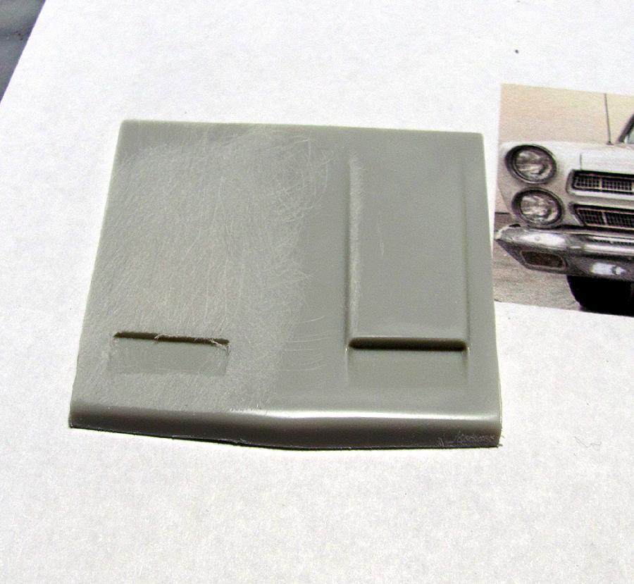

MarkJ Posted February 21, 2022 Author Posted February 21, 2022 I will have to dechrome and change the grille and also remove the scoops from the hood and make it flat with a center strip down the middle. Â

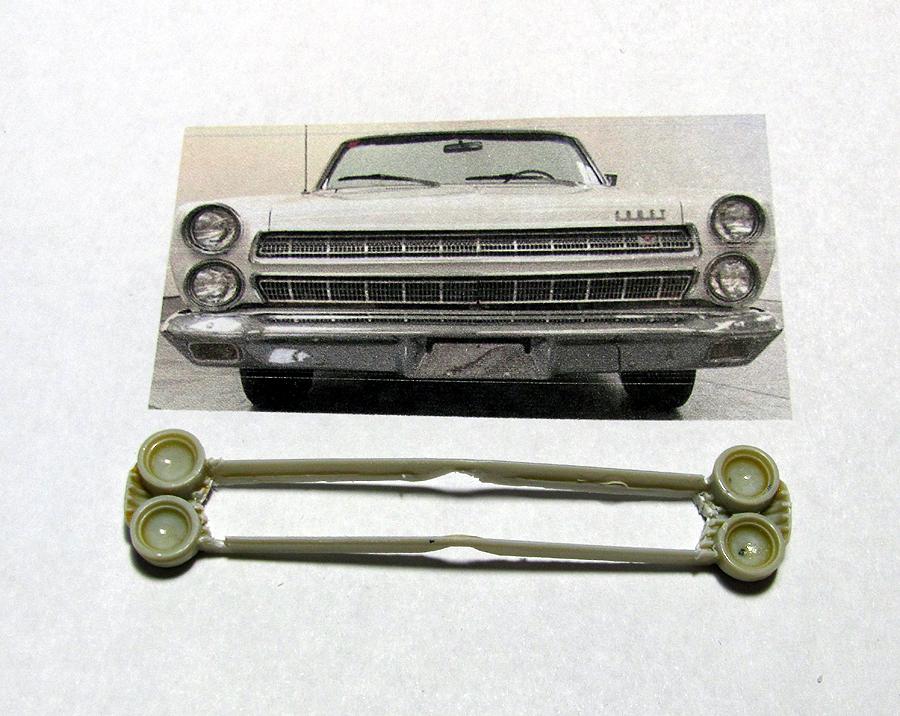

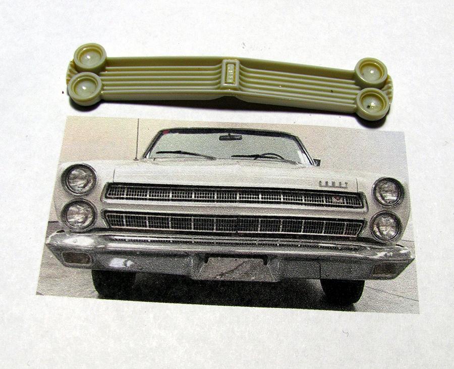

MarkJ Posted February 23, 2022 Author Posted February 23, 2022 Got some more work done changing the grille from a 1967 to a 1966.Â

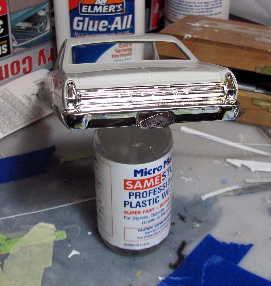

MarkJ Posted February 24, 2022 Author Posted February 24, 2022 25 minutes ago, Pierre Rivard said: Brave man. I would have chickened out and done a 67. Is there as much change needed for the back end? Thanks, Pierre. I don't think so. I will have to cut off the rear bumper from the rear panel to save the chrome bumper. I'm not as good as you when it comes to redoing chrome bumpers. The toughest part of the grille will be making the grilles that go into the upper and lower grille cavitys. One good thing is that the real car had the grille painted black.Â
MarkJ Posted February 25, 2022 Author Posted February 25, 2022 Got some more work done on the grille. I used a hole punch to make the filler plastic that goes between the headlights. Just make two holes extremely close to each other and use the plastic that is left between the two holes you punch out. I will probably just finish the voids left with putty because there is not that much area left to fill. The hole punch makes perfect sized discs to cover the headlight cavities.

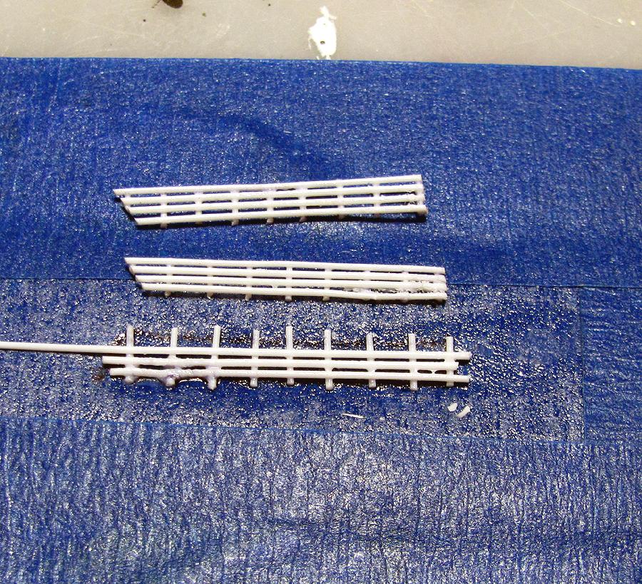

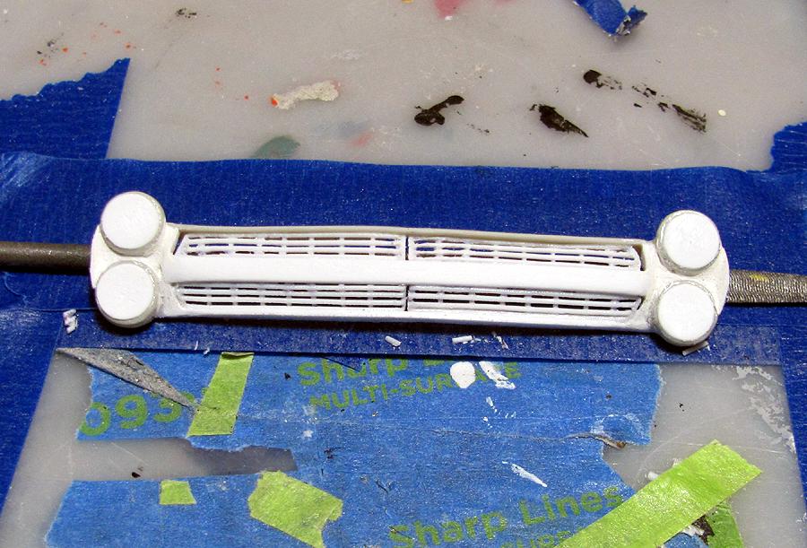

MarkJ Posted February 28, 2022 Author Posted February 28, 2022 After studying my ref pictures more, I came to the realization that this Comet was a Comet Cyclone that came with a fiberglass hood with scoops and a grille with more of a horizontal bar look that was split in the middle. So, I had to make 4 separate grilles to fill in the grille cavities. The smallest material I could find was some .020 rod, so that's why it's not as accurate as I would want it to look, I would need .010 rod to do it justice. But I don't think they make it, and my finger dexterity is not what it use to be to pull that off anyway. And the glue would melt material that small. So, this will be close enough for me. The car I'm modeling had the hood changed to a metal stock comet hood for the race I'm representing. So that's why I'm having to remove the hood scoops. A lot of the chrome trim on the grille was also removed and they painted the grille black, so just so I have the basic look of a 66 Comet grille will have to suffice.

Pierre Rivard Posted March 2, 2022 Posted March 2, 2022 Looking good. I have worked with .020 rod lately and it is small and very difficult to manipulate. Good stuff!
