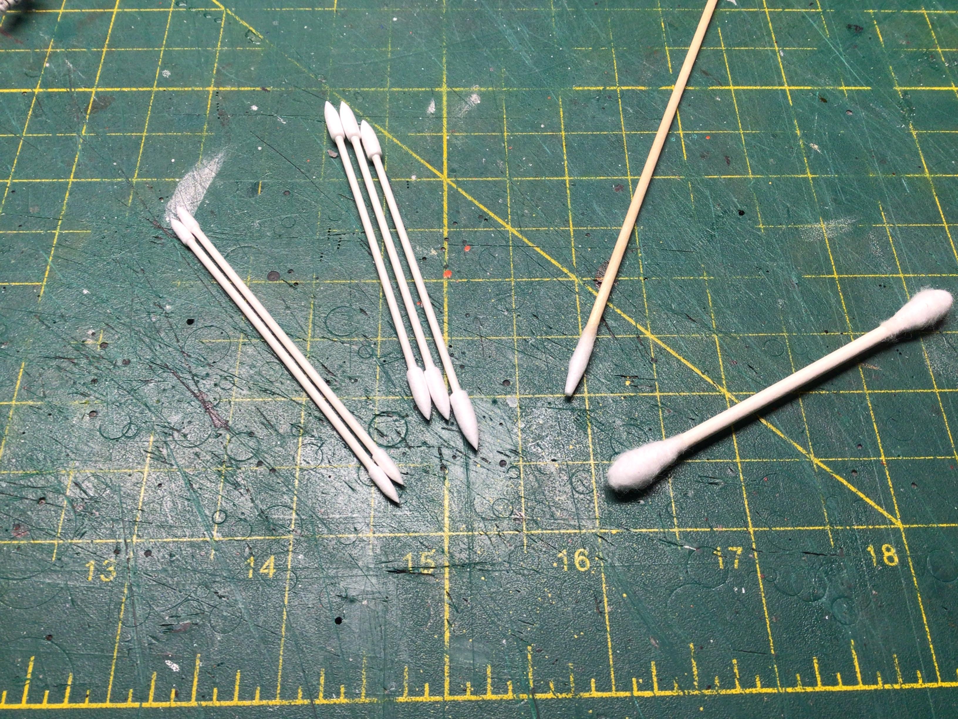

I have used both the accent and flat or semi gloss acrylic paint. The accent seems to want to cling to the corners and not cover the flat areas so it needs more coats I find. The paint usually needs some cleanup and I like the finer Tamiya swabs on the left rather than Q-tips for that task.
Edited by NOBLNG

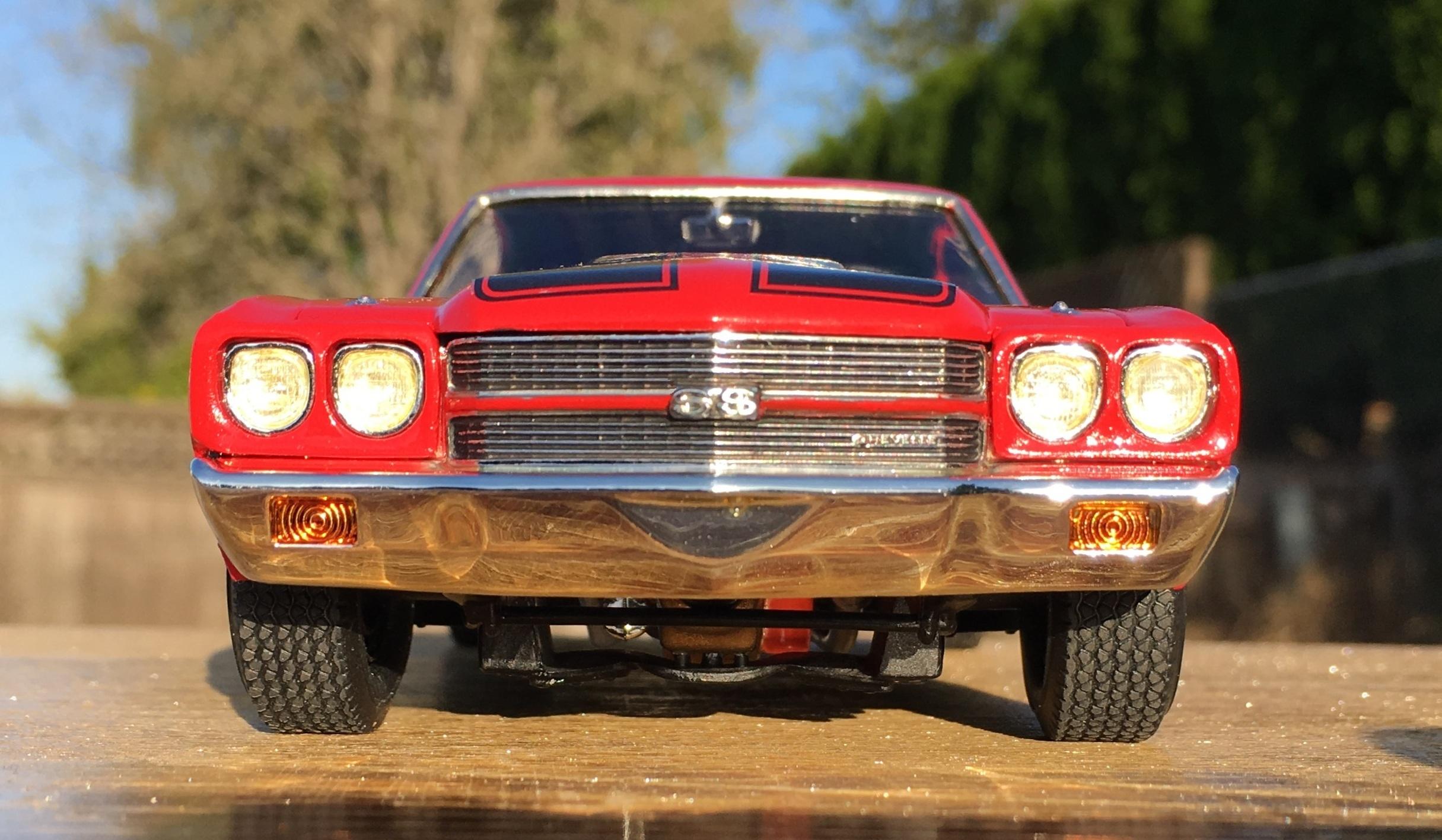

I have also had good results using Vallejo Model Wash (76.518 Black).  Like people had mentioned with the Tamiya product, sometimes additional applications may be needed in some areas.
This is a recent kit done with the Vallejo wash.
P1010090.JPG.d4c407c24d2607ee89f90783a72e5527.JPGThanks,
Bart
