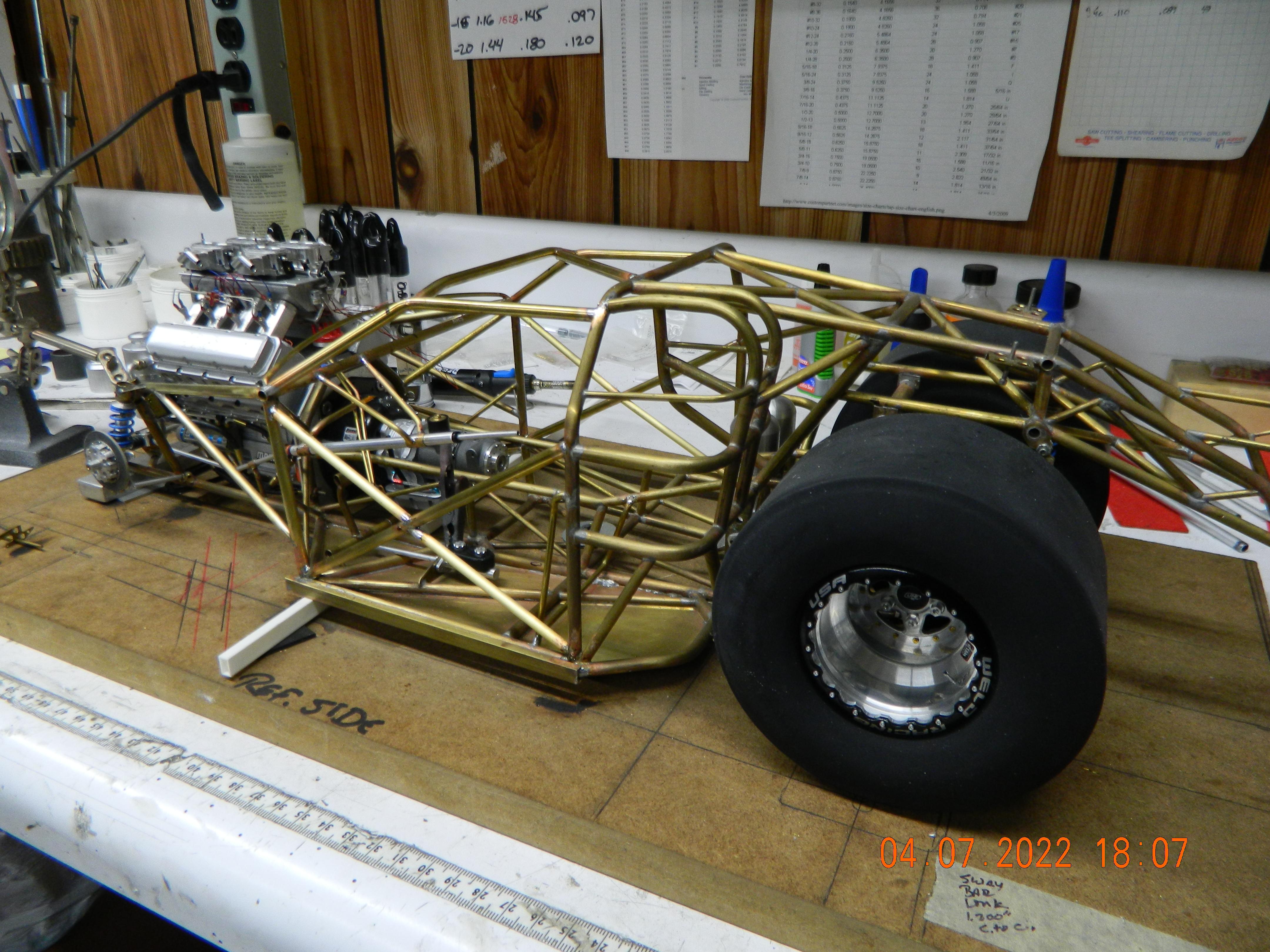

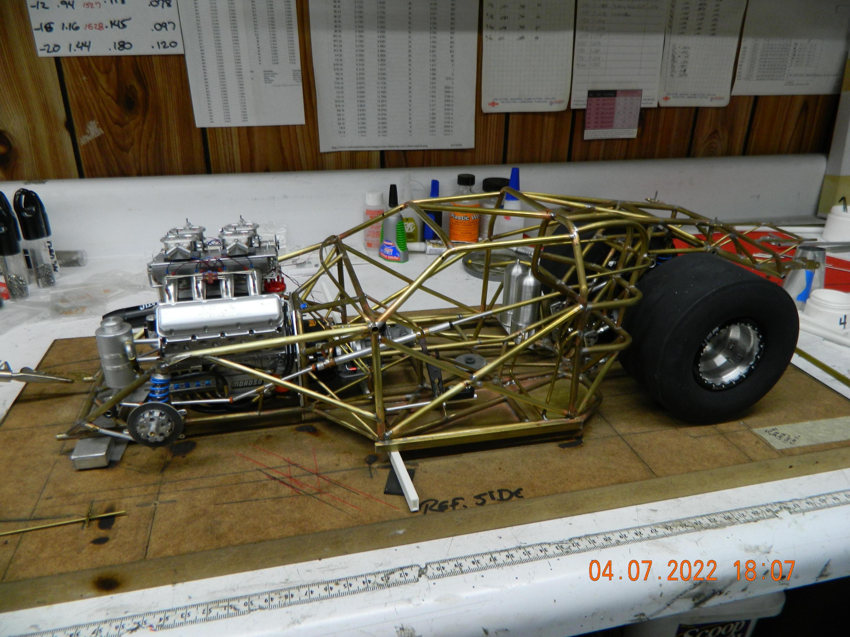

i'm finding some time and motivation to work get back to my 1/8 pro mod camaro build (although now, it would probably be a top sportsman car).  it's been over 10 yrs. since i started it so. i'm rusty and i'm old. put in a bunch of new tubing although there is still more needed.  making a bunch of the necessary parts in the back round.  we'll see how this goes.  here's where we're at now.

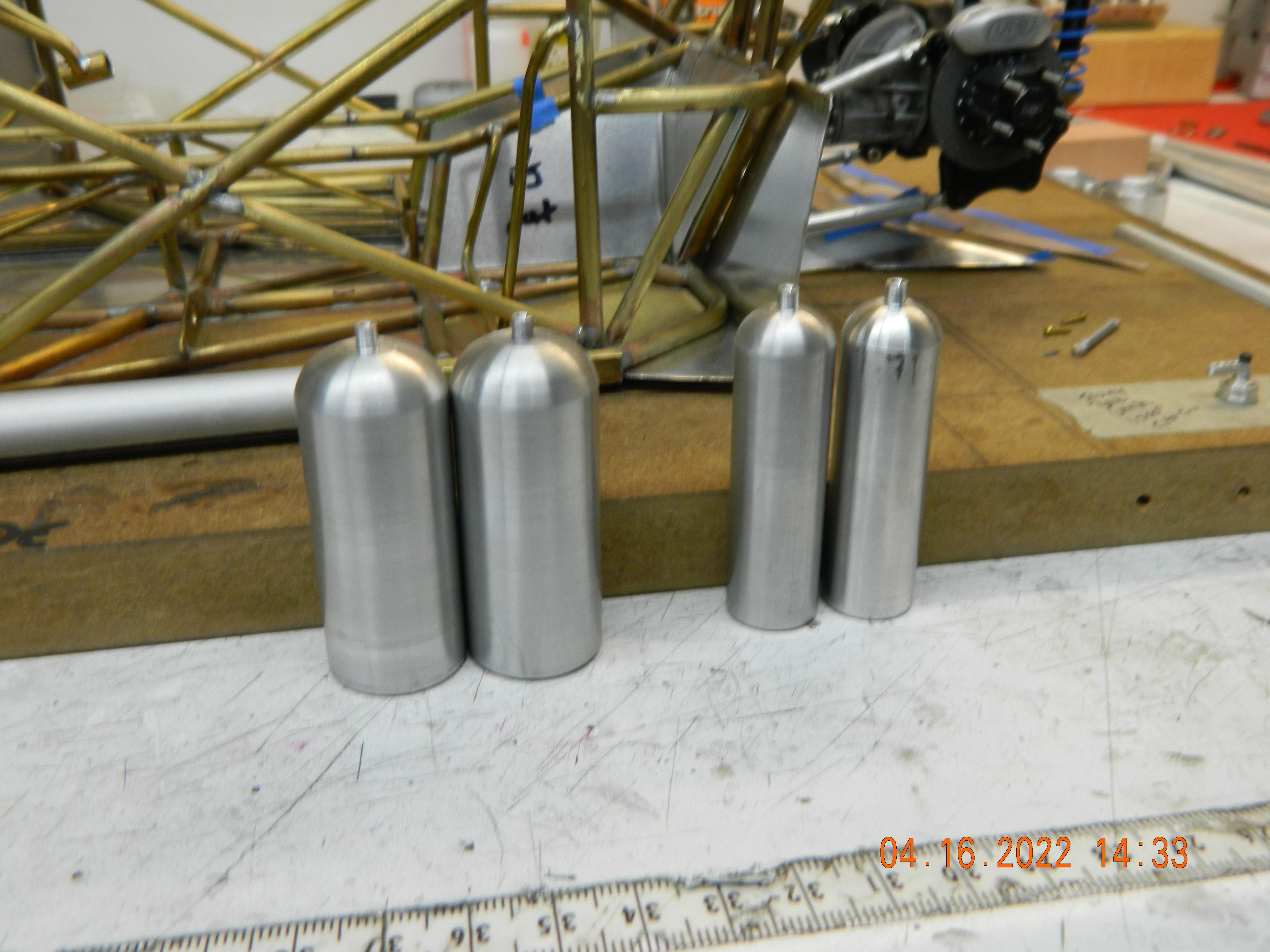

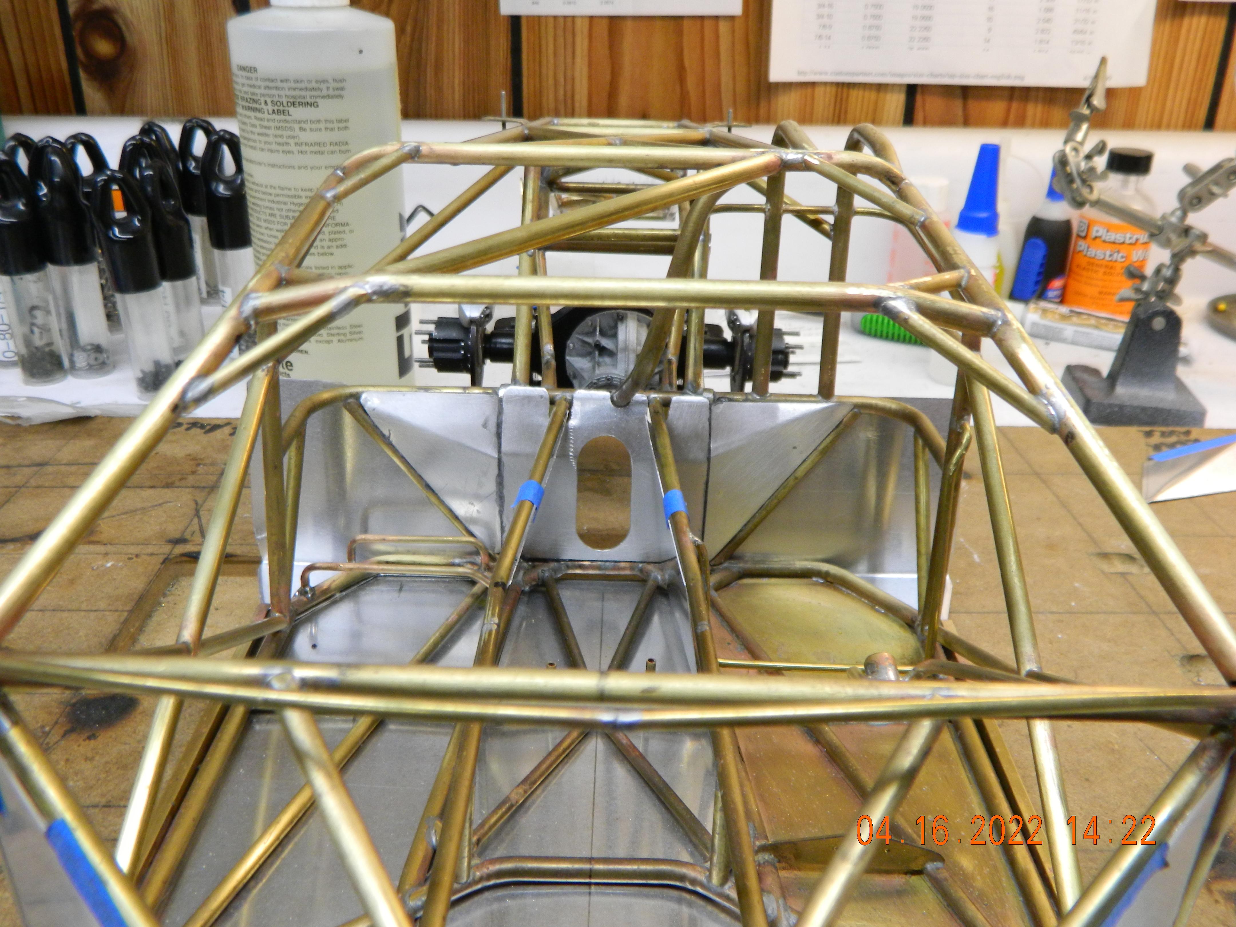

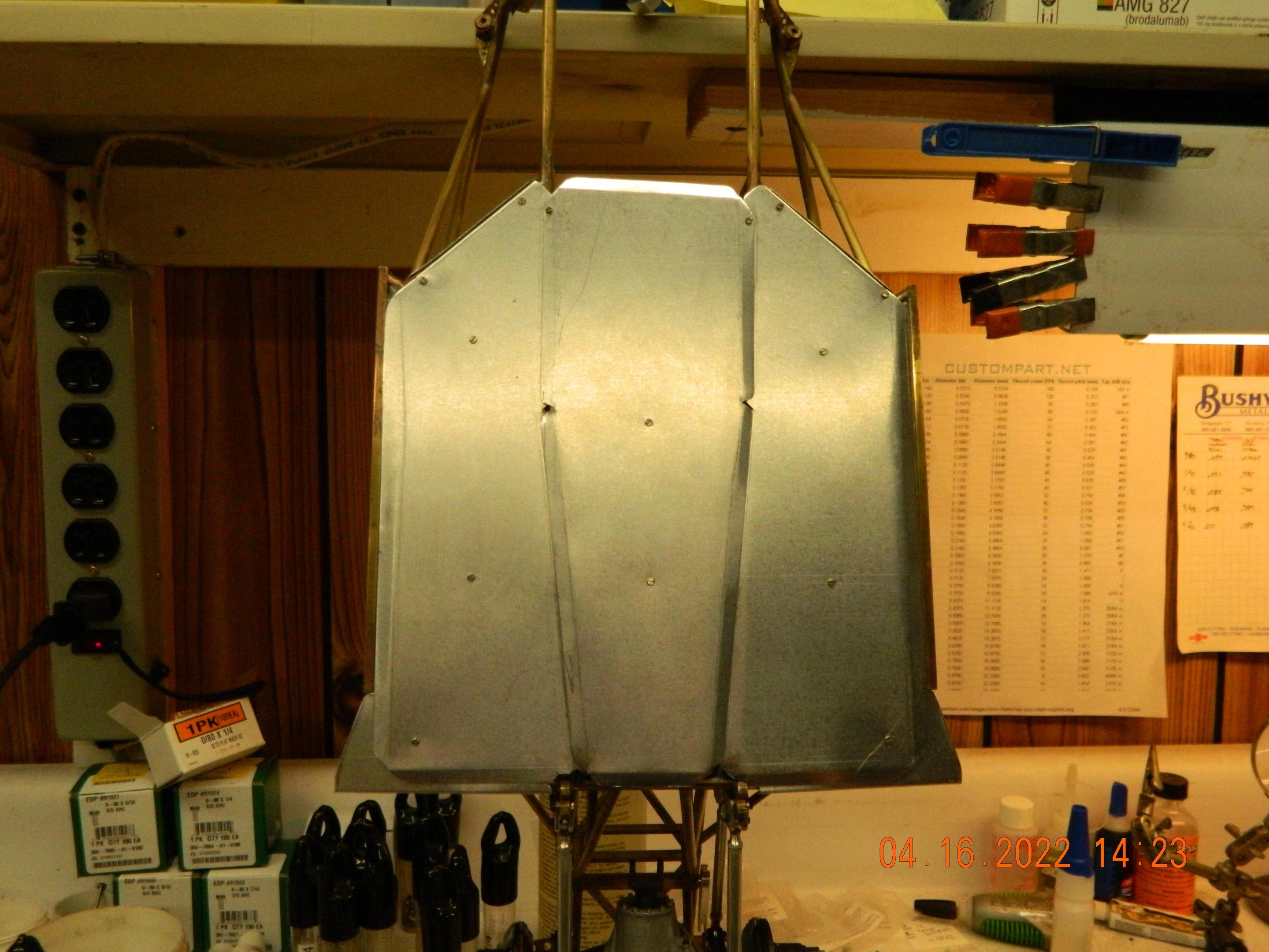

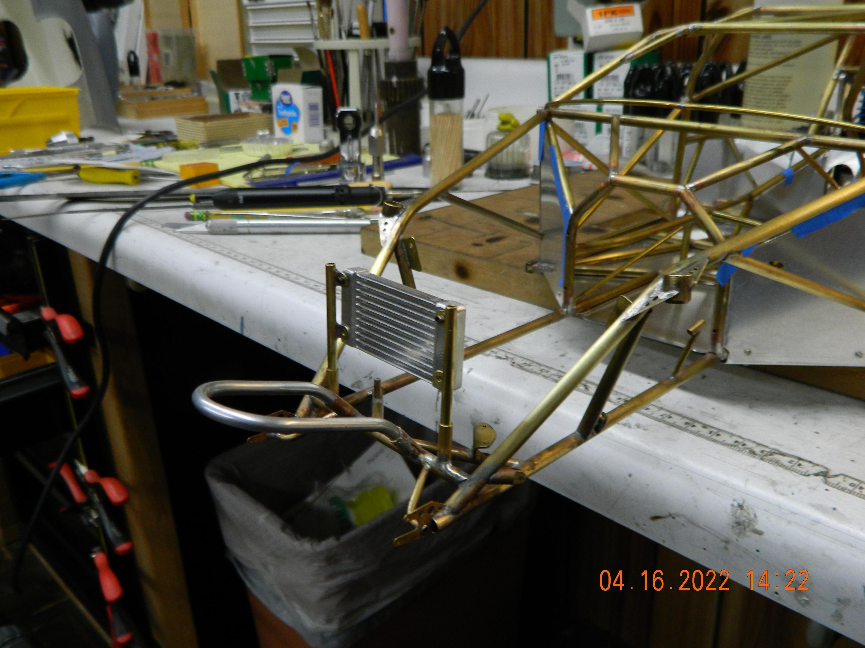

thanks guys. much appreciated.  got some more stuff done.
bunch of interior panels, radiator and mount. fuel tank mount and fuel tank. belly pans, nitrous and fire bottles.

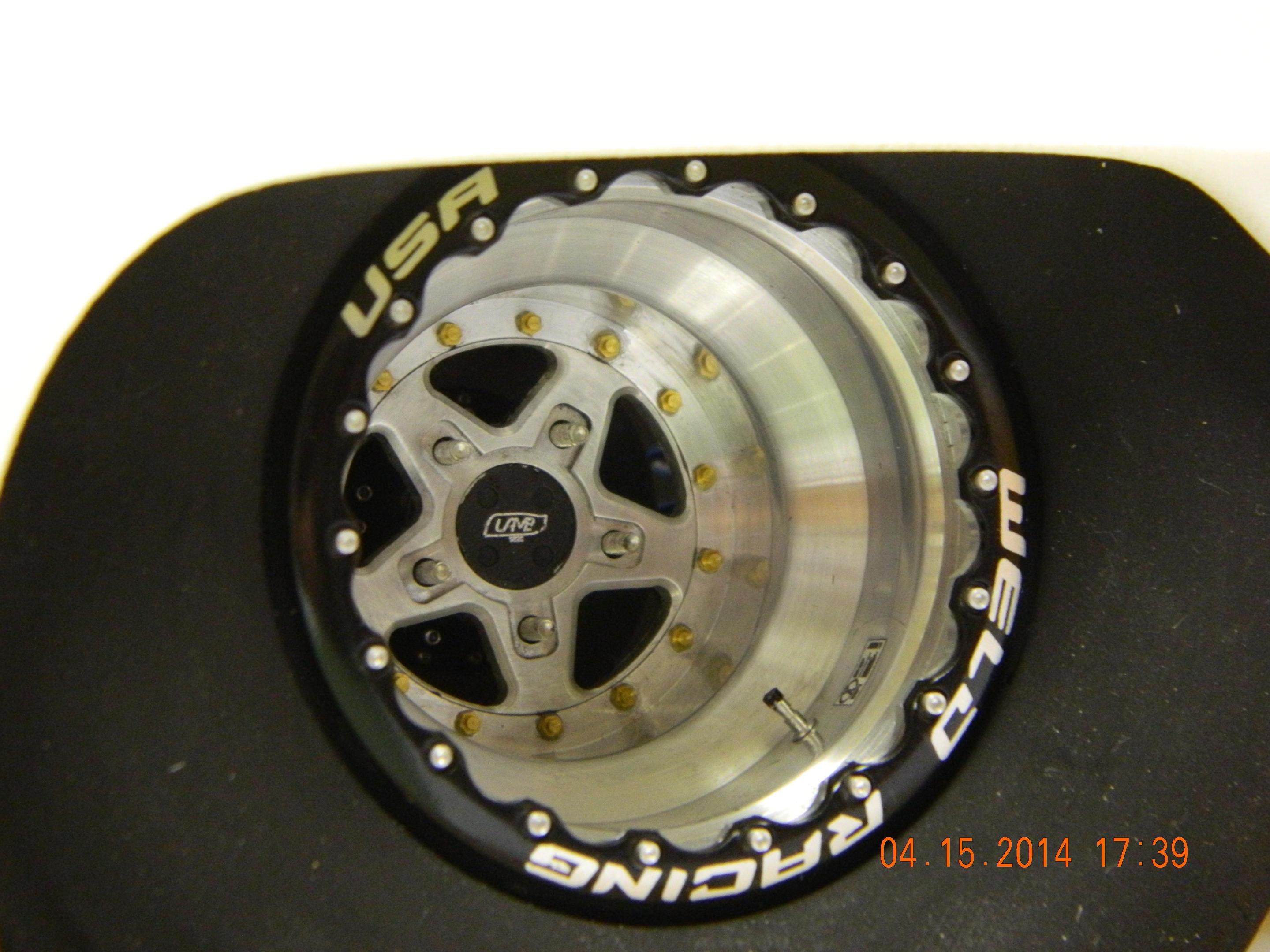

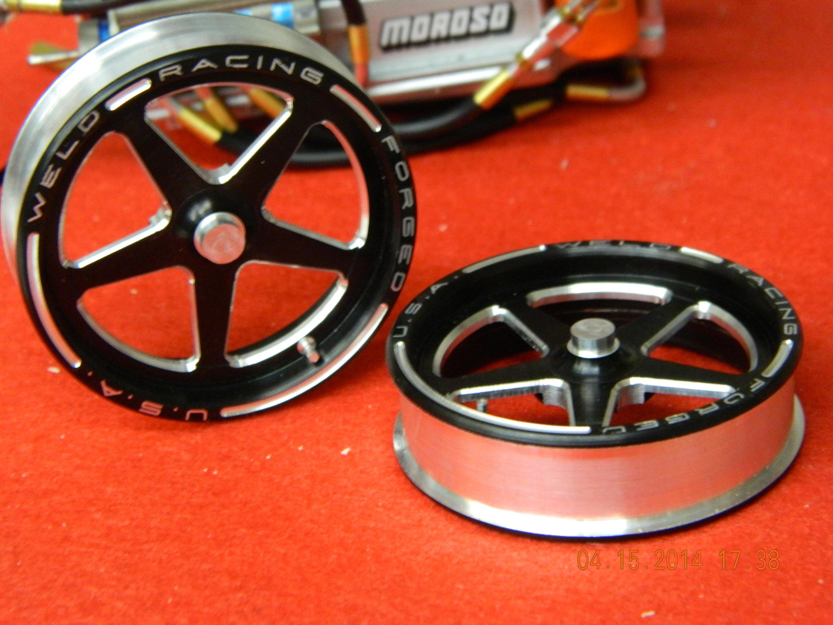

i promised to give some earlier shots of the camaro's build. if you want more details on any thing ...just ask.
one of the parts i enjoy the most is doing the wheels. fronts are 15x3.5 spindle mounts and  were black anodized and then machined. talk about pressure. zero room for error here. then the were the back wheels 16x16 double bead locks.  i'm hoping the effort shows through.
