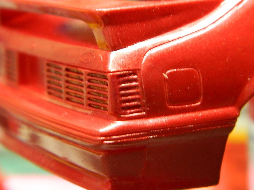

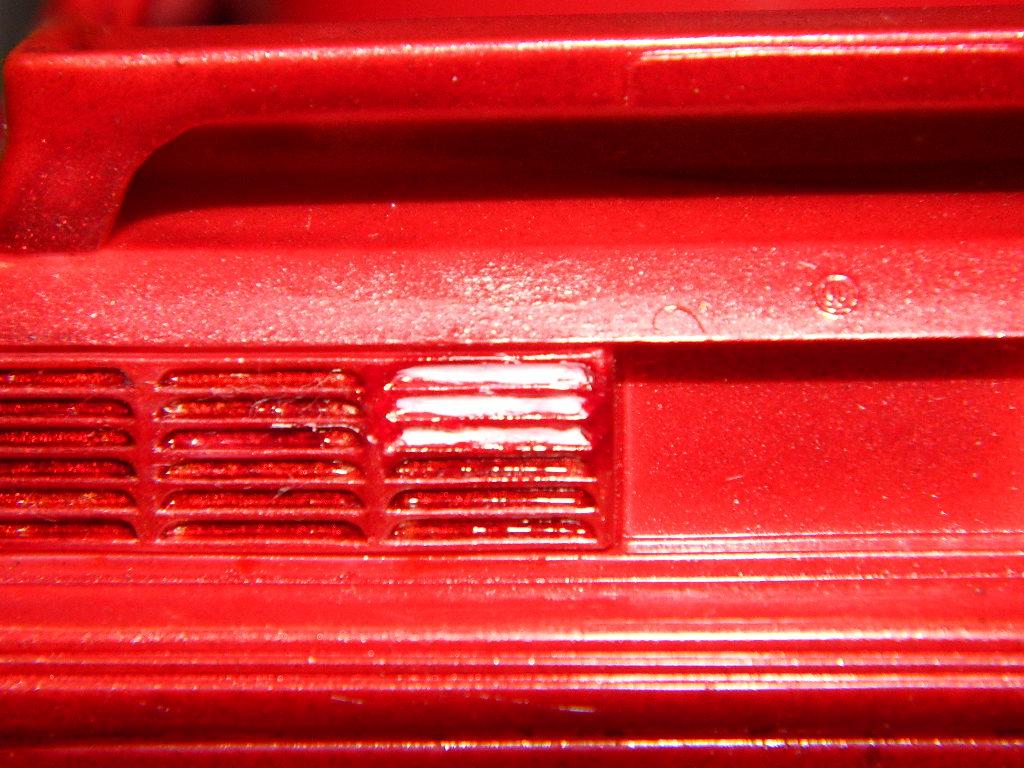

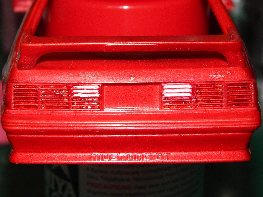

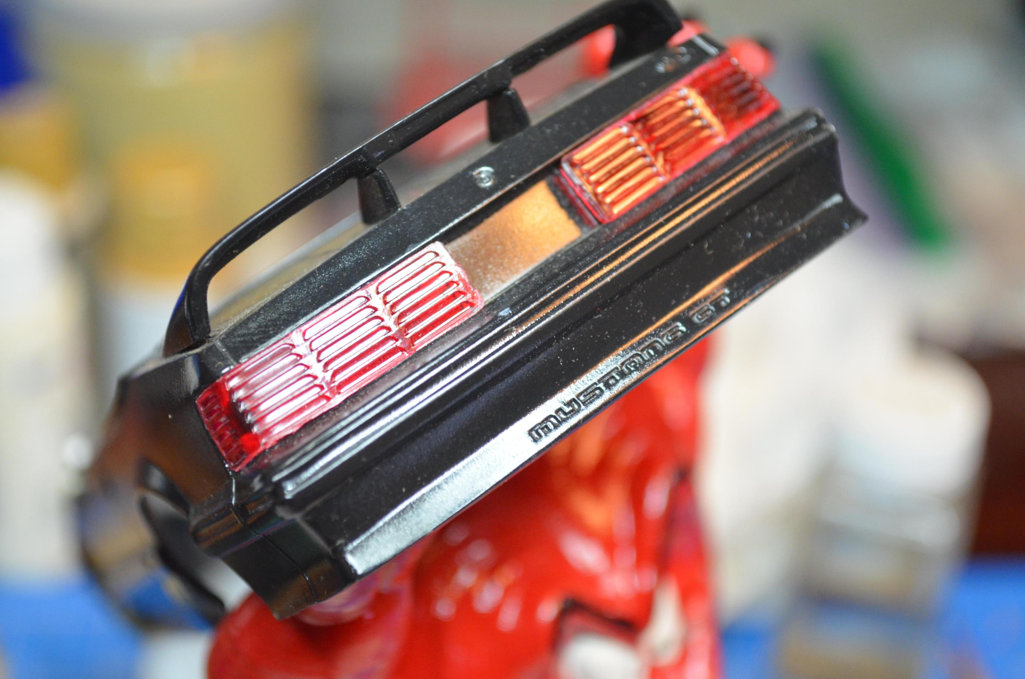

It has been over 2 1/2 weeks since I paid any attention to the Stumptown Mustang GT.  I applied the Tamiya X-27 Clear Red over the Tamiya X-11 Chrome Silver and after it had set up for a few minutes, I used an alcohol swab on the taillights and removed the extra Clear Red.  Worked pretty good!
Dex Parios will return...
This is a overwhelming process and I'm not looking forward to it on my build, but it looks like you nailed it
One step at a time.  Take a brush with chrome silver paint and brush it on the taillights and let it set up for a few minutes.  Take an alcohol wipe and remove the paint from the raised surfaces and let it dry completely.  Take some clear red and brush it over the taillights and let it set up and wipe off the raised surfaces with an alcohol wipe and you are done.  It shouldn't take you that long to do.
What sucks is, for the kit I'm doing the tail lights are seperate parts and molded in clear. Its a shame to have to cover the entire piece in paint. You would think with the part molded in clear it would save so much time
I have the Mustang Lowrider kit (same as your Monkee kit) that I got free of charge and I dug it out and found out that I don't have any taillights!  I will have to find something in my parts box to replace them with.
A clear part will only save you time if you don't have to paint it at all.  It depends on the molding process and the design of the part.  Good luck!

I kept looking at the taillights wondering what was missing and they needed backup lights!  Out came my jar of Tamiya XF-2 Flat White paint and a thin brush and now I have backup lights!

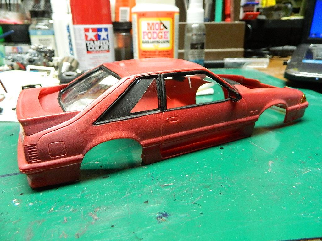

A little time spent on the Stumptown Mustang this morning.  I "weathered" the body with Model Master Camoflage Gray and my my Badger 150 airbrush.  Now to finish this!
