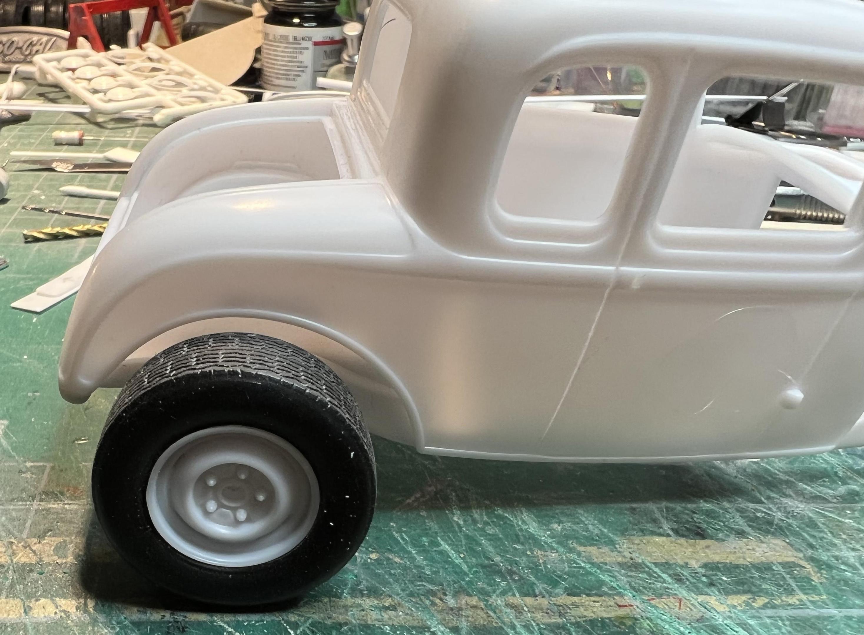

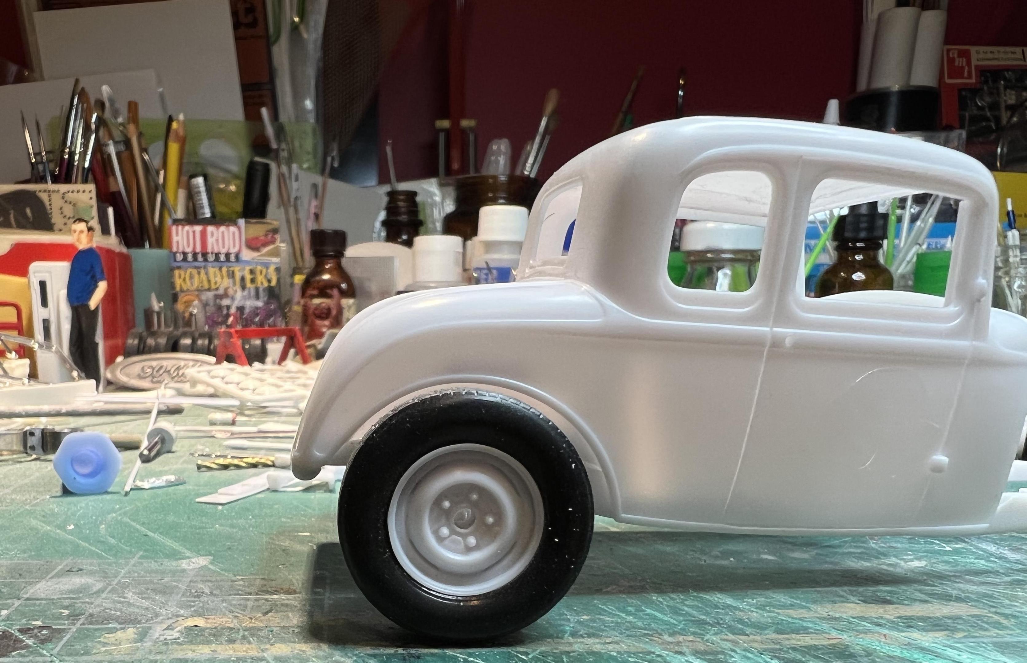

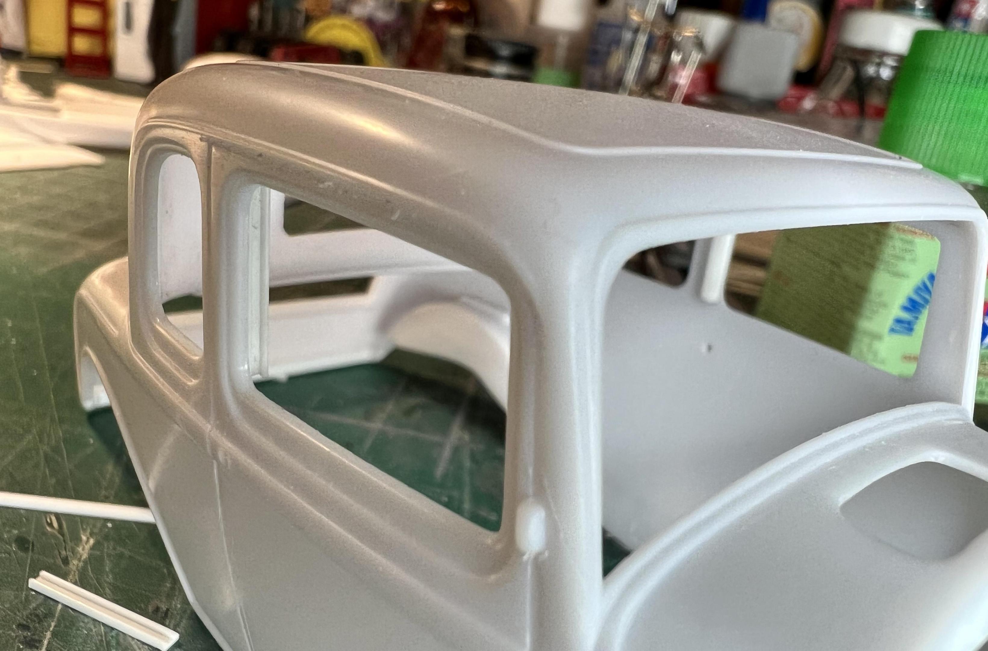

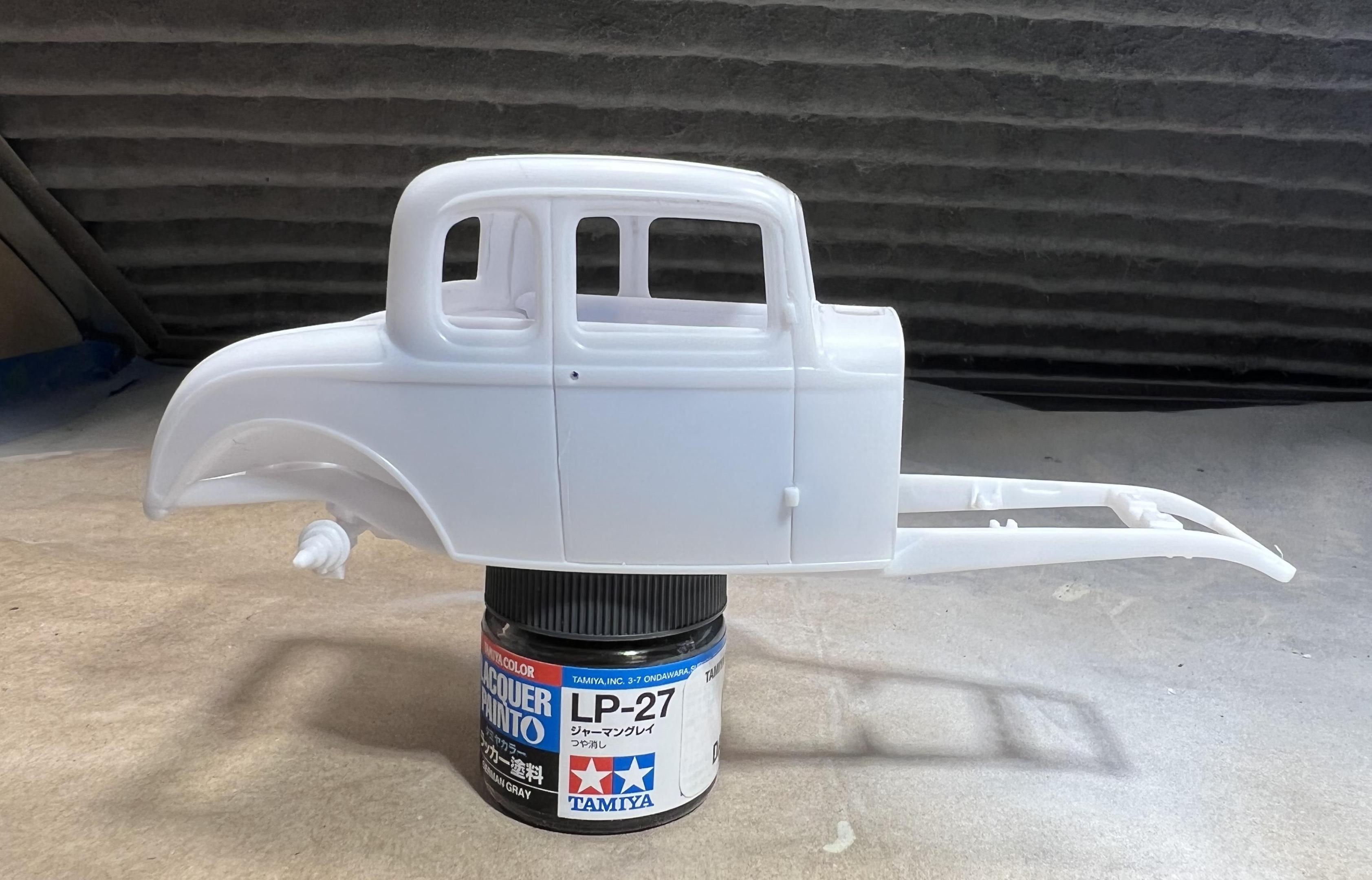

I began the build by tackling the channeling job first. The R/M kit has separate rear wheel wells that I installed first and carefully outlined the required cut by lining the frame to it and drawing the new profile. It was then a case of careful trimming out to fit. The chassis itself required a bit of tweaking to reduce its overall width near the leading edge of the wheel well. Once satisfied with the fit I moved on to the interior mods to reduce the overall height of the assembly allowing it to fit into the lower confines of the body. This was done by cutting away the lower edge of the door panels and the rear bulkhead.

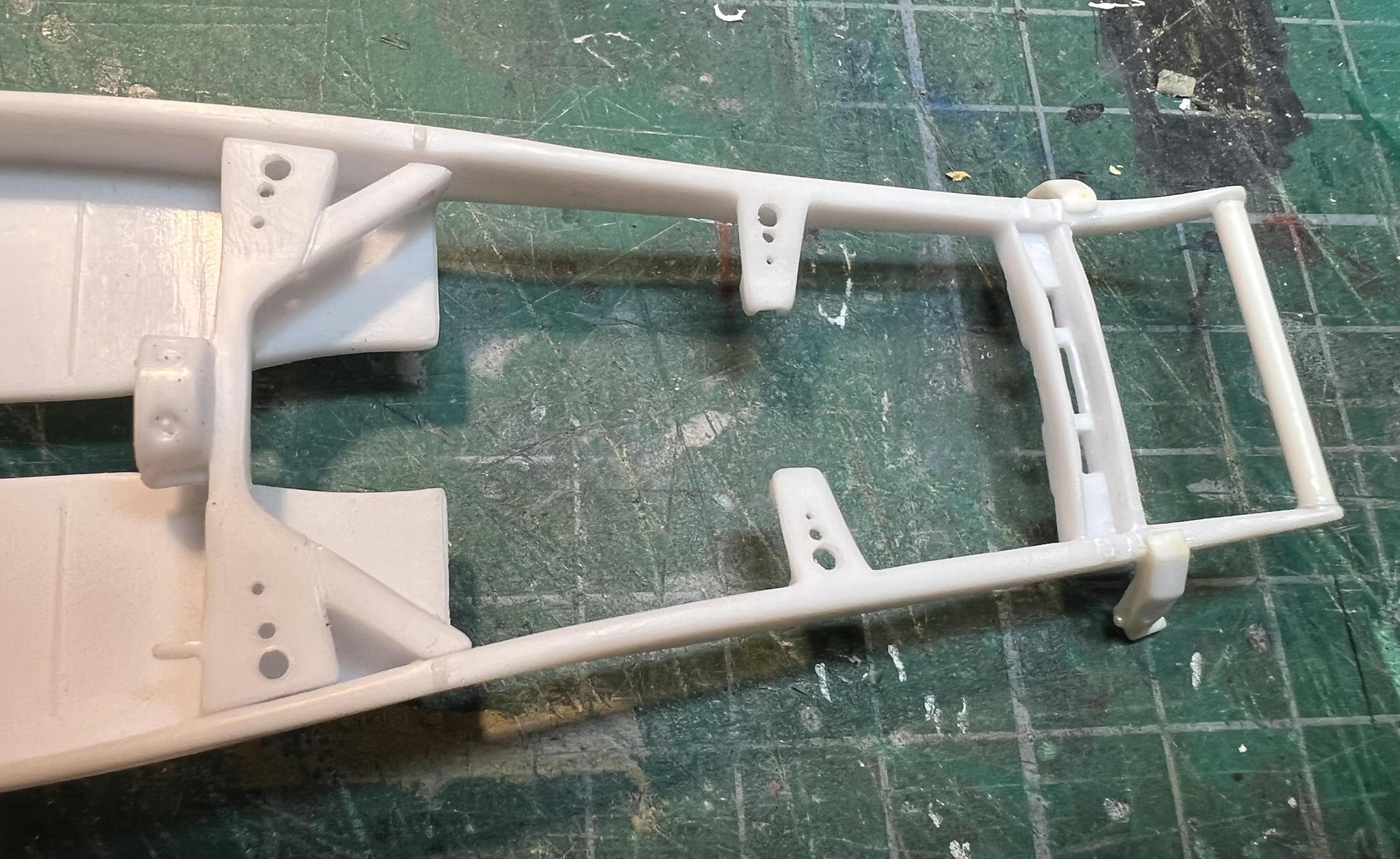

For the frame to fit the lowered stance it required the removal of the gas tank and a shortening of the rear frame rails. A new crossmember was fashioned to fit in the rear and a round spreader bas was added to the front end of the frame. In addition the front cross member where the front spring sits in was deepened and the top leaf from the spring was removed to lower the front end somewhat for that typical hot rod attitude.

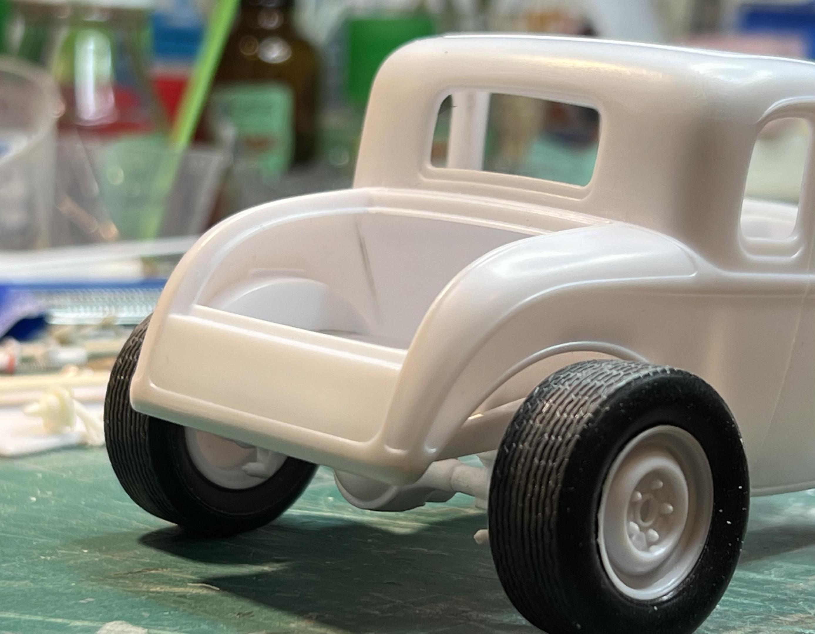

Having gotten rid of the fenders and the fuel tank in the rear left a sharp ridge to the coupe’s body below the trunk. To improve the look I fashioned a small rolled pan to complete the body lines at the rear. It was an easy modification using quarter round shapes across the rear and small sections at the ends to complete a smooth transition at the rear.

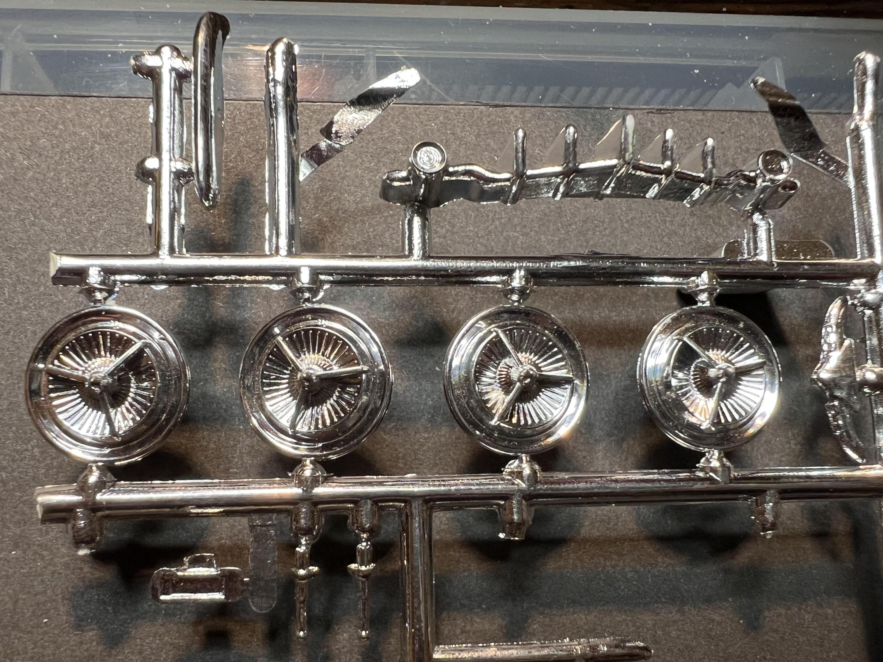

Been busy assembling various parts and dechroming many with household bleach.
Starting on the top left are the wheels and Buick brake drums from the R/M Model A kit along with its dechromed beauty rings and hubcaps. Next to them is a collection of resin parts from R&M including a chopped grill shell with rad and PE grill. The remainder of the box has mainly kit parts with suspension pieces dechromed and the kit early Hemi.

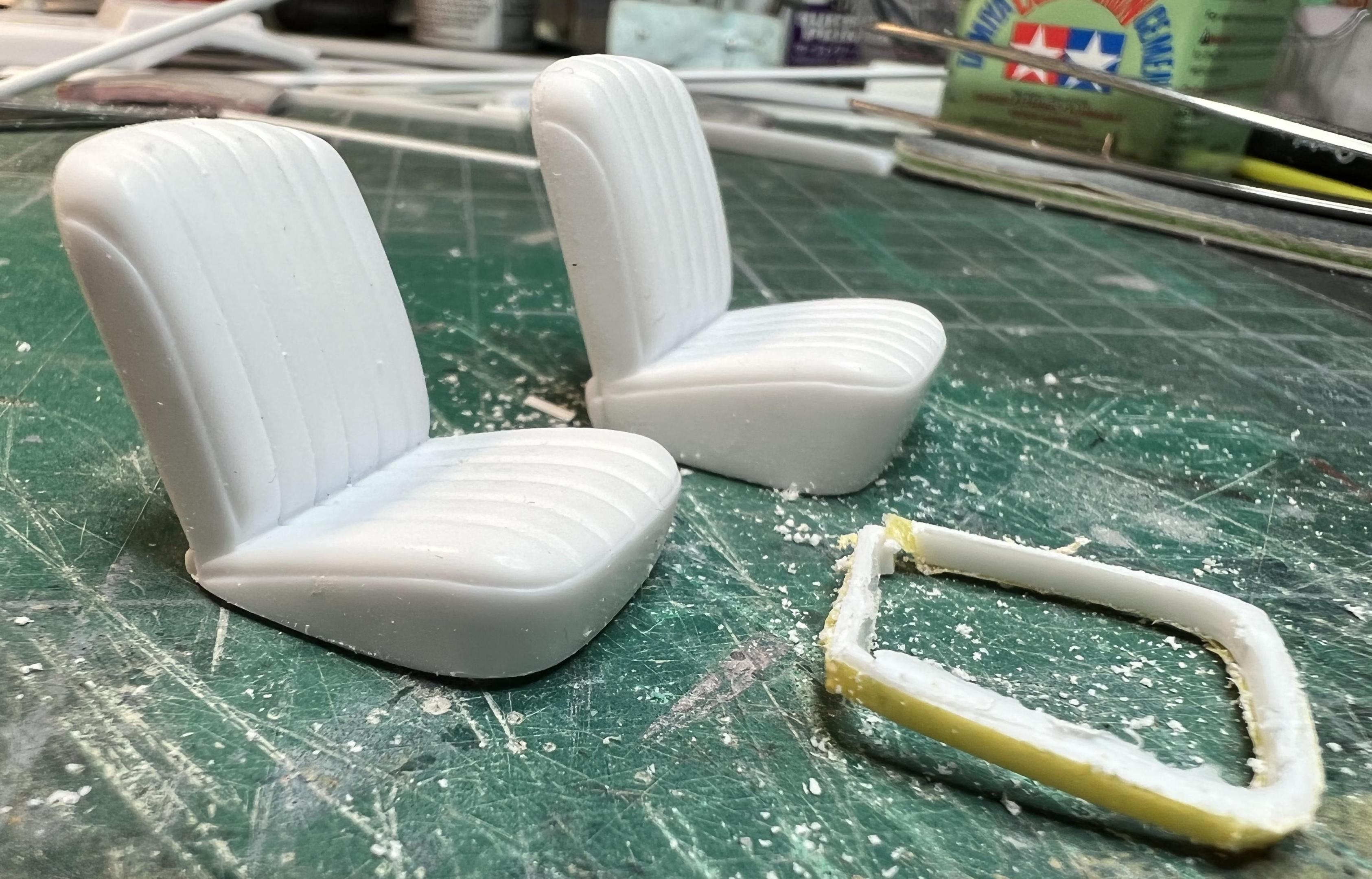

Since this Deuce is channeled over the frame the interior floor sits roughly 6 inches higher than stock and requires seats that sit lower to provide the required head room. Using parts bin bucket seats I glued the seat backs to complete them and laid masking tape to guide the razor saw for the required cut. Once done, it was obvious that the drive train tunnel would interfere with the seat fitting flat against the floorboard. Using a Dremel tool and a large round file the seat sides were re-contoured to fit around the tunnel.

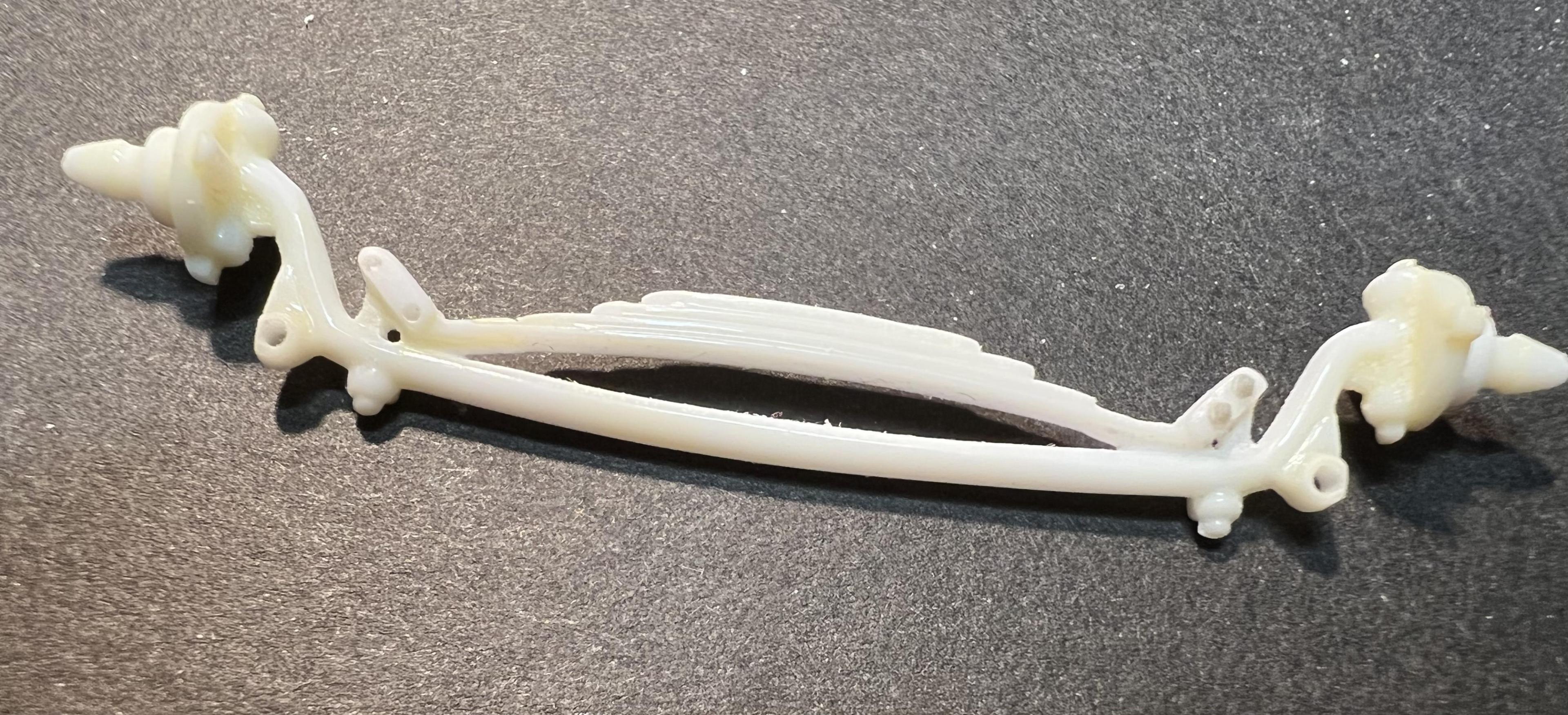

A very wet West Coast weekend offered me a chance to spend some time at the workbench rather than tending the garden! Spent most of the time prepping the parts for the kit’s Hemi 392 engine, detailing the R&M megaphone exhaust headers with bolt heads, as well as on the front axle’s spring perches. Using my collection of tiny dental files I opened up a lot of the spaces between the tubular axle and the transverse spring which has the top leaf removed to lower the front end.  In swapping in the Buick finned brake assembly for the front end I had to modify the wheel backs from the Model A kit to fit the Deuce axle by enlarging the holes.
