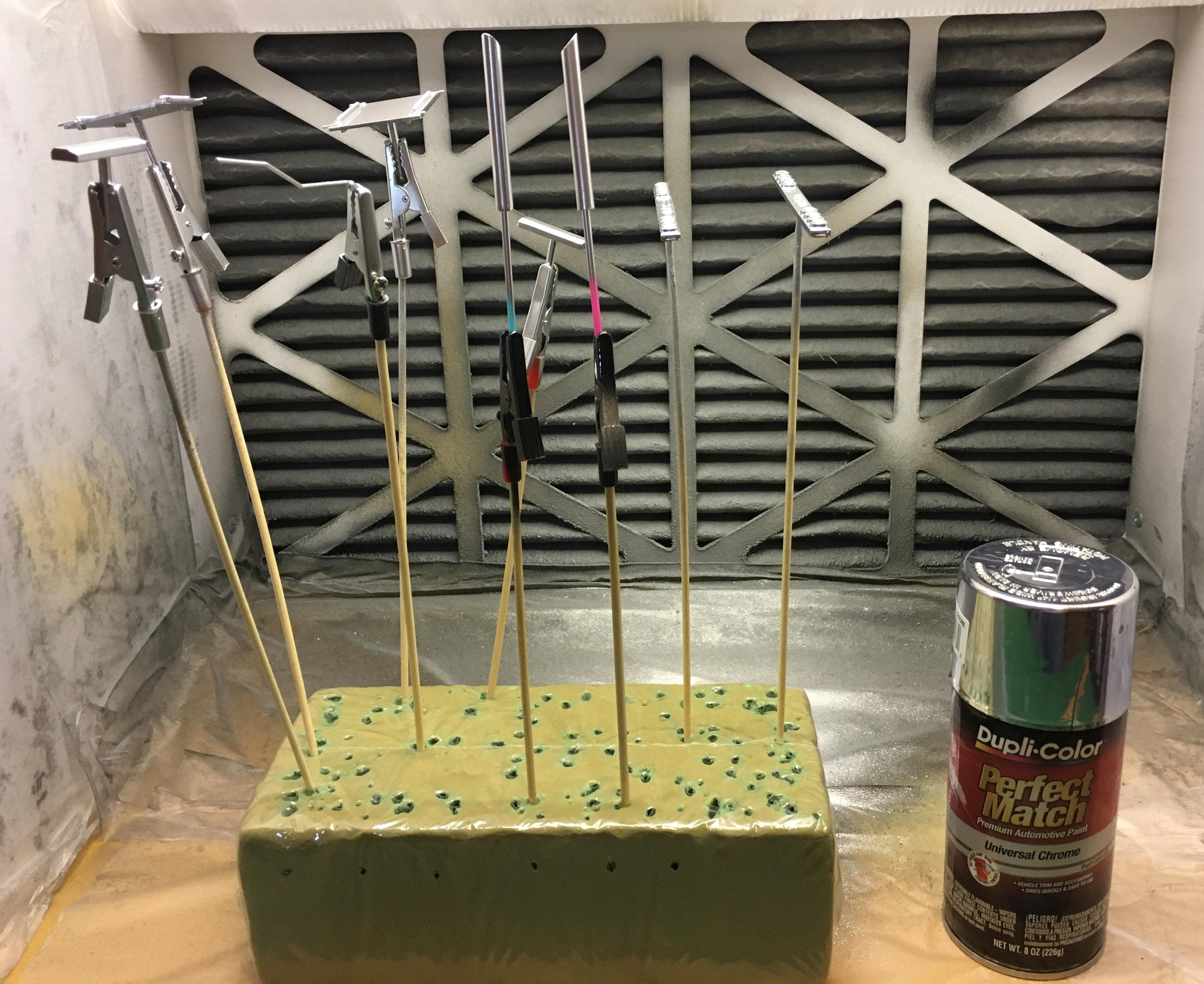

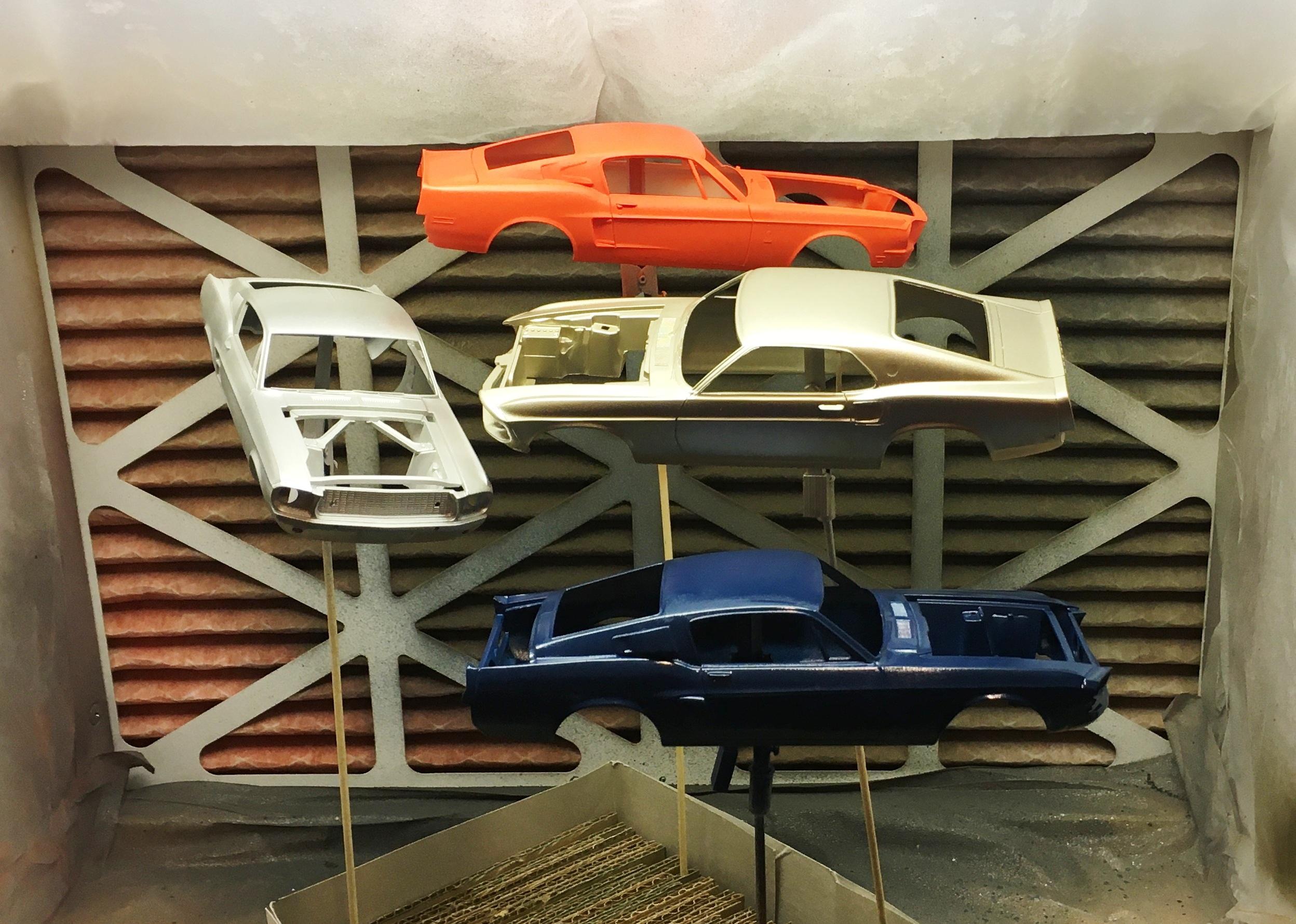

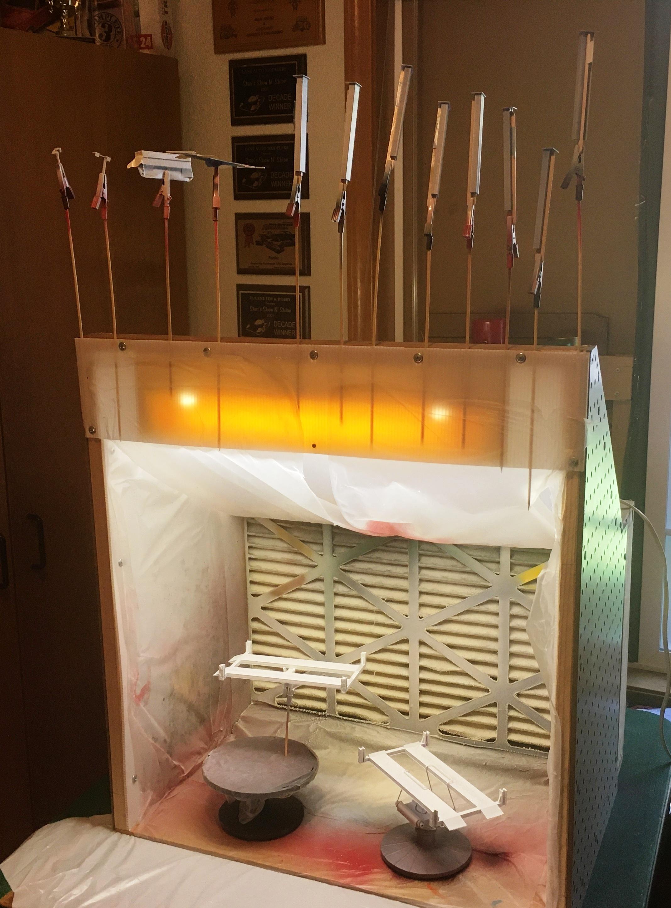

Bills72sj Posted May 17, 2022 Share Posted May 17, 2022 2 hours ago, NOBLNG said: I save all the long straight pieces of sprue. I have mounted alligator clips on some in order to hold small parts. I will also file the ends of the sprue flat and attach it to small parts in an inconspicuous place with CA. I do the same. Sprue rods CA to inconspicuous areas of the part to be painted. Alligator clips attached to bamboo skewers. I try to paint in large batches which leaves you with where to park the wet parts. The material I used to line my paint booth is corrugated plastic. It hold freshly painted item up out of the way. I also have a piece of floral foam and a model box full of cardboard strips glued together. 1 Quote Link to comment Share on other sites More sharing options...
