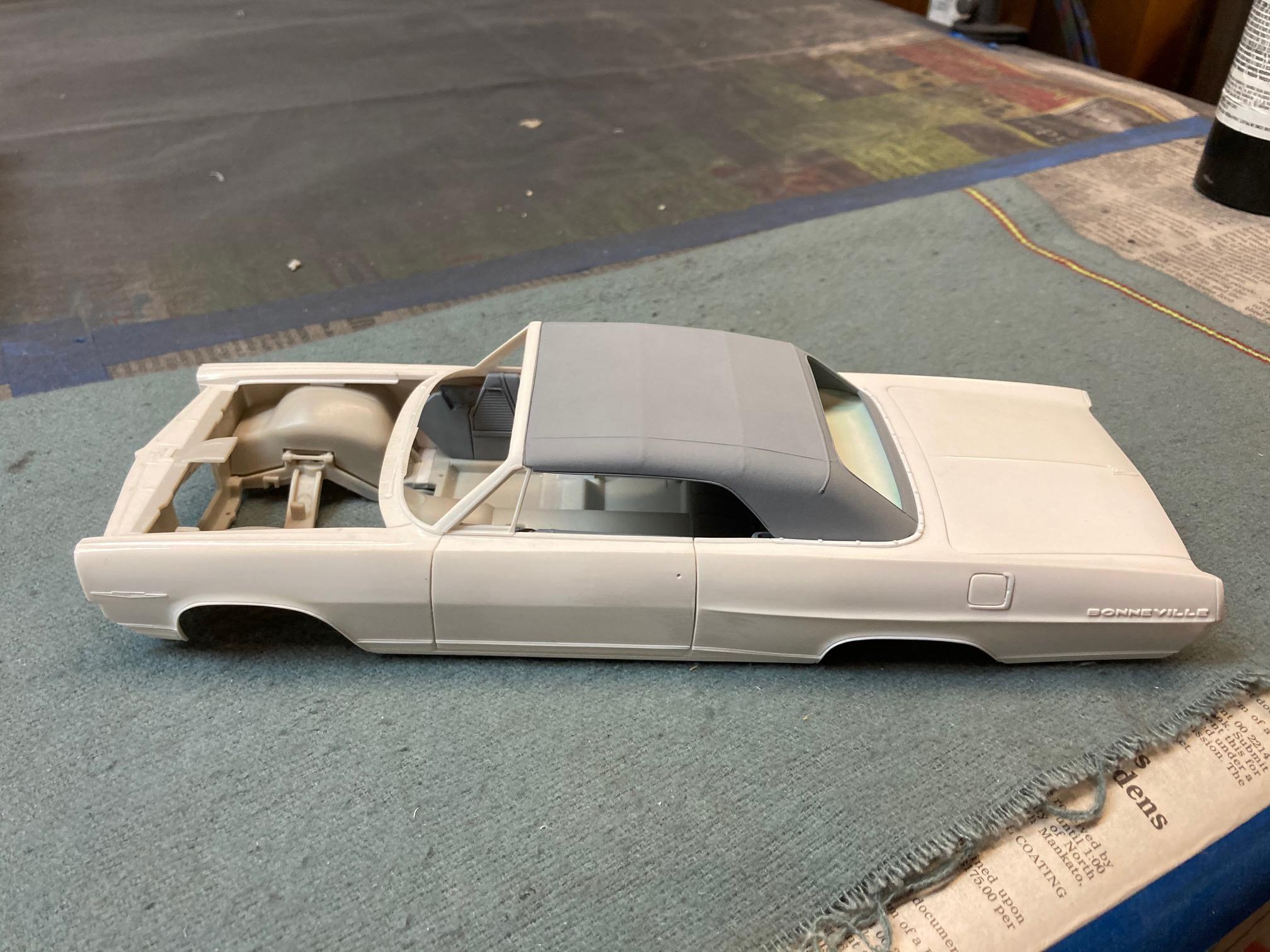

It might not be evident upon first inspection, but I did a considerable amount of work on the up top to get it to fit properly.
The up top, (originally from a '62 Buick Electra annual) first needed to be shortened overall to fit the Pontiac.
I then had to add some material to the lower back portion of the C-pillar to narrow the rear glass opening slightly.
This made it possible to be able to add the rear window by flattening the radius of the rear tulip panel area, if that makes any sense. <_<
I also added a narrow section at the base of the top at the rear between the sail panels.
This will make it possible for me to add the back window and have it fit cleanly so that I can alternate between up top and boot.
The rear glass will actually be plastic from a sandwich bag to replicate a soft plastic rear window.
I then added plastic strip around all of the window openings and the leading edge of the top, just to add a little more interest and simulate "beading" or "seams".
Now I will have the option of displaying the model with the top up, or down as  I choose.

4 hours ago, StevenGuthmiller said:
As you are such a stickler for accuracy, I've got to show you this before you get too far...
In order the prevent water leaks, a convertible top must sit on top of the windshield header, not behind it. You shouldn't be able to see so much chrome on the header when the top is up.
But as everybody says, it's your model, build it as you wish.
Link to comment
Yes, I realize that, but I made a mistake when cutting back the top many months ago.
This seemed like the best option.
Steve
