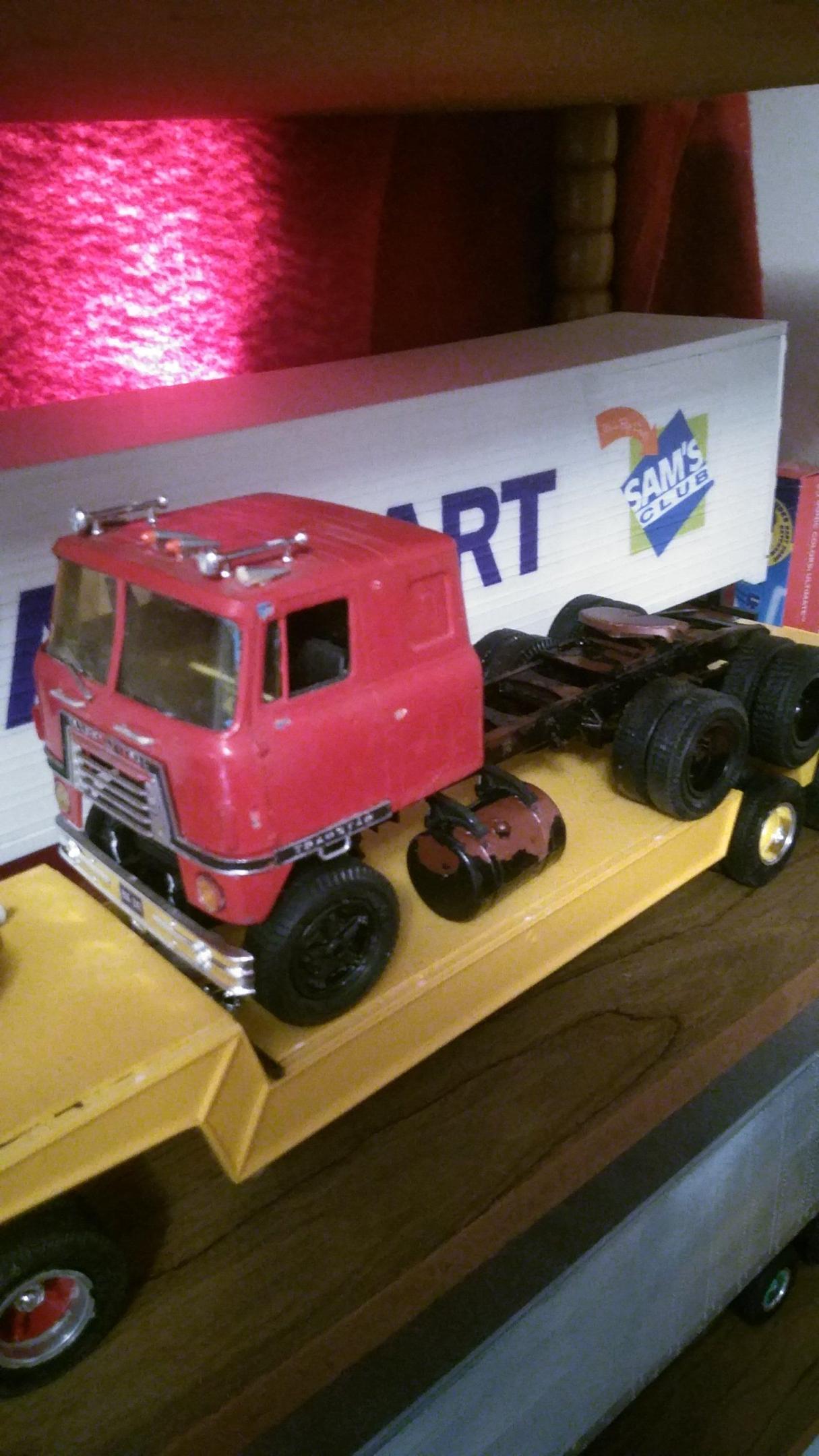

I'm working on an old IH 4070 and I'm trying to make it look old and forgotten. I've got the frame and tanks rusted up but it has tires on it that are shiny and new looking. I want to make them look like the truck in the picture. This is the truck I'm trying to replicate.

Yes this is the look I need. I've considered using real mud. This is the truck I'm working I'm not putting it in the WIP because I have about 3 projects in there already. But you see the shiny tires just do not fit the look I'm going for.

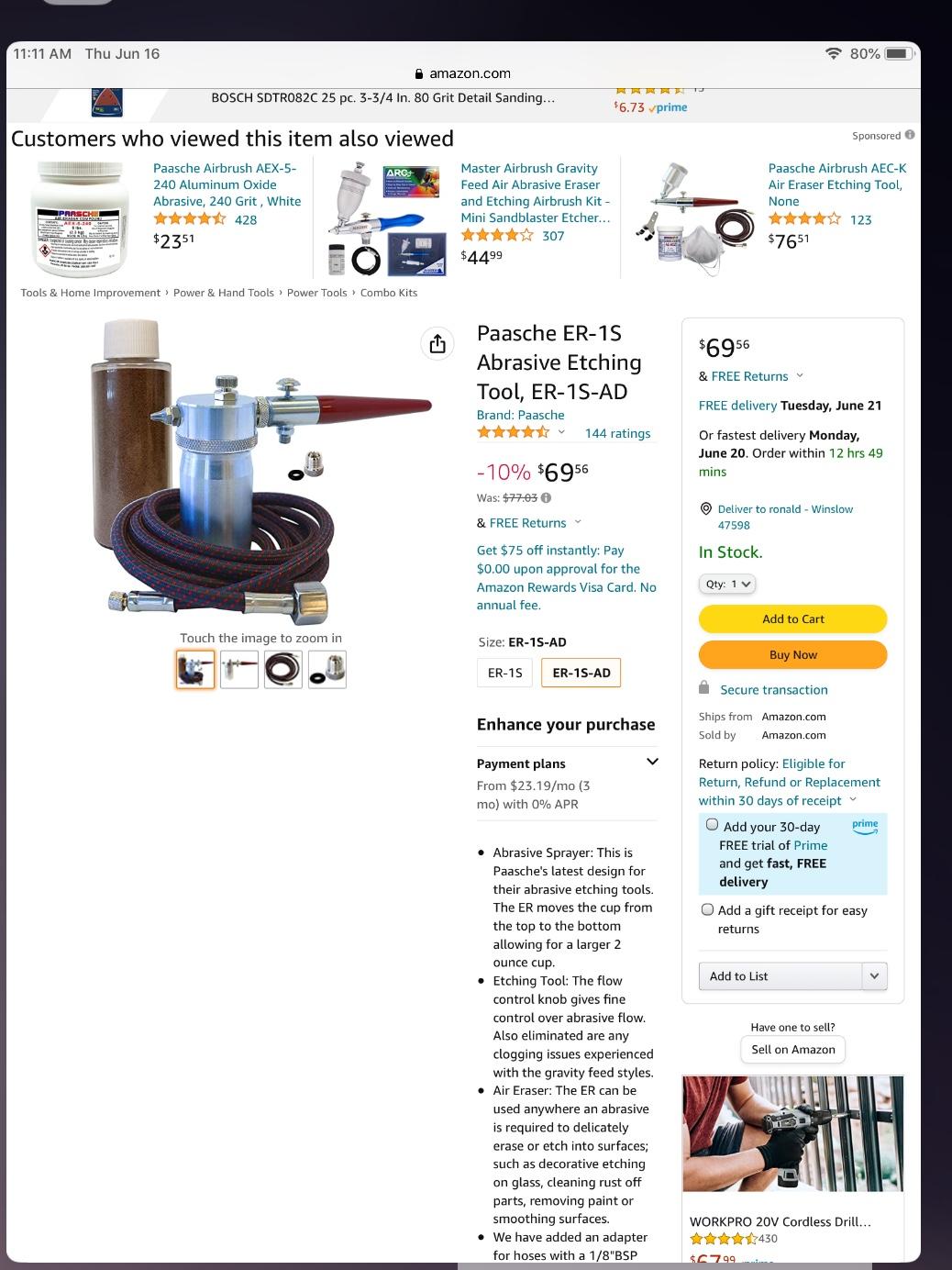

I considered purchasing one of these a few months ago (thanks, mr. Muse).  There is a generic and Paasche brand available.  These would have to be used outside or in the garage and definitely respirator use.  Different types of media are available for different surface requirements.   I don’t know for sure about compressor requirements, but doubt a large compressor is required.

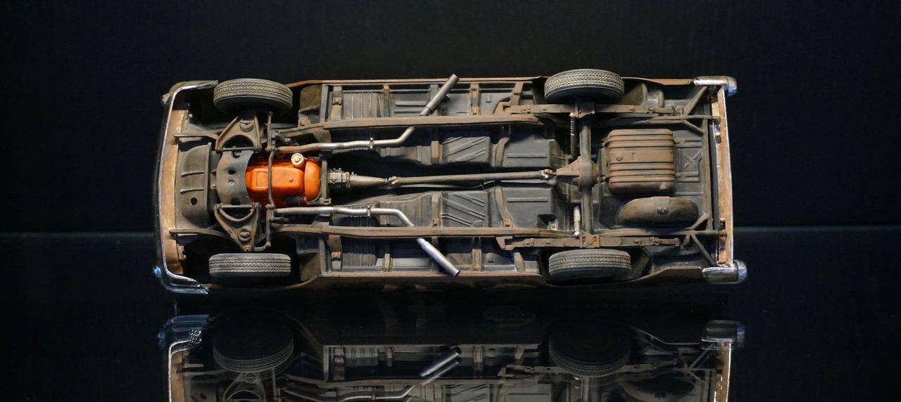

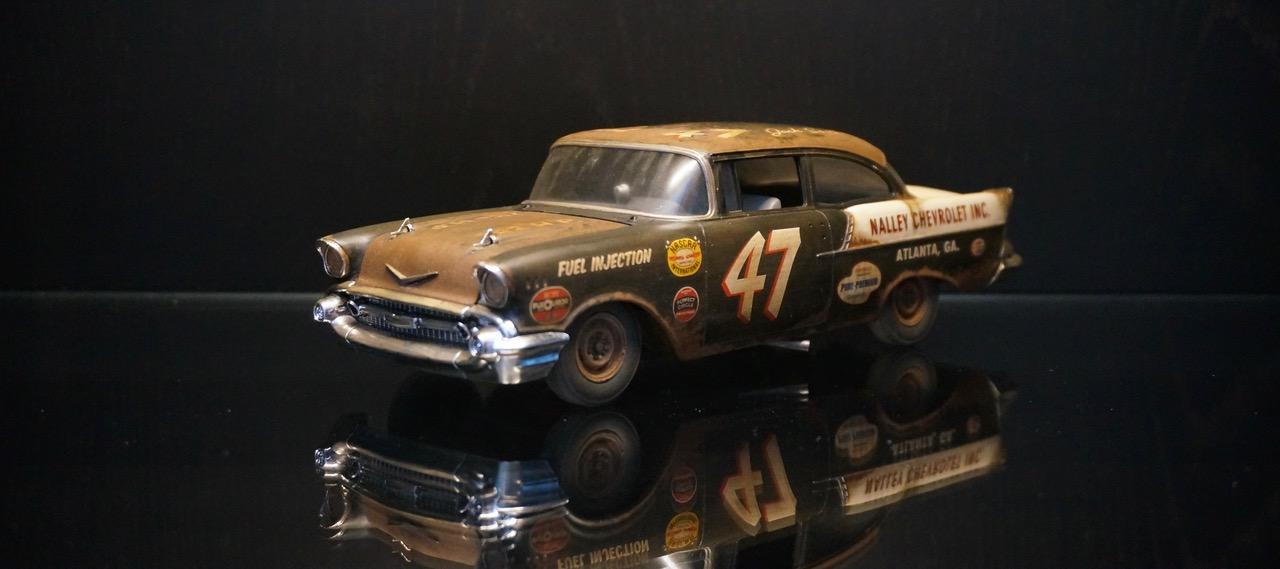

I just did it with a dullcote followed with Tamiya weathering master rust color and finally a sand colored pigment to fill the threads. Done 3 years ago and still looks good.
