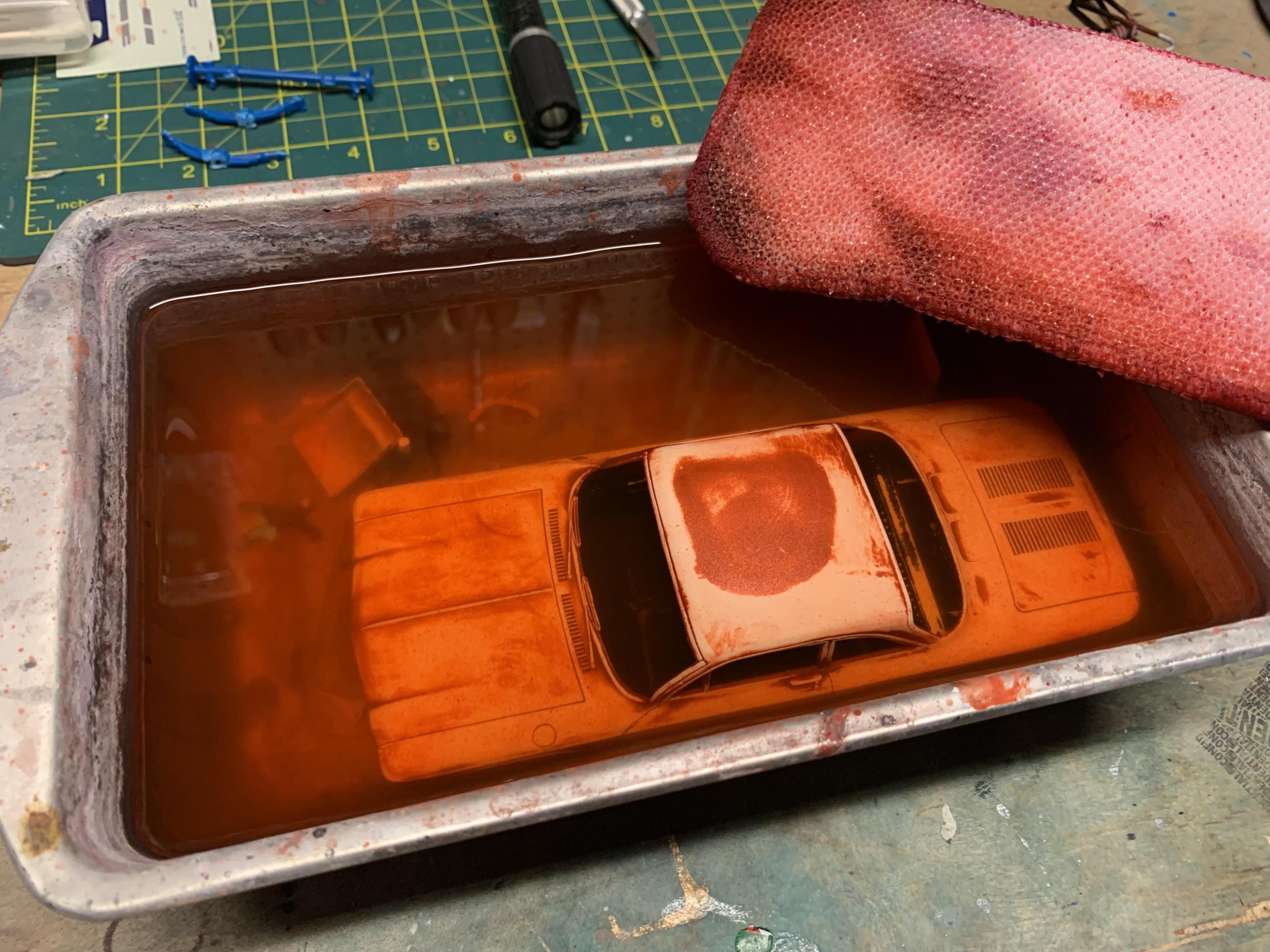

Lurch209 Posted June 26 Share Posted June 26 (edited) So I’m working on this rebuilder I scored off of eBay. I really liked the color I found it in but no luck finding anything exact. I did manage to mix one up somewhat similar that I like & am going with. however I’m having a hard time stripping the old paint off. I’ve had it sitting in purple power for two days now with no luck. I’m thinking of using brake fluid but I’m concerned about it being to harsh on the 60 year old plastic. ill post more photos as I make progress. Edited June 26 by Lurch209 1 Quote Link to comment Share on other sites More sharing options...
Slotto Posted June 27 Share Posted June 27 Nice looking piece. Might try oven cleaner before brake fluid. Just sayin 1 Quote Link to comment Share on other sites More sharing options...
StevenGuthmiller Posted June 27 Share Posted June 27 The active ingredient in oven cleaner, (lye) is the same as the purple stuff, but the concentration of that ingredient is higher in Super Clean than it is in Purple Power. That said, if it’s not having any affect, I suspect that oven cleaner won’t do it either. You could try some IPA, but I’ve always had my worries that IPA or brake fluid could make the plastic brittle. At least I’ve heard such concerns from others. You might want to try Testors ELO. I have not used it, but I know of others that swear by it. Just be aware that ELO is not for soaking. You brush it on and then rinse it off.....hopefully along with the paint. 😊 Steve 2 Quote Link to comment Share on other sites More sharing options...

Lurch209 Posted July 6 Author Share Posted July 6 Yeah I have steered clear of brake fluid with this model because of its age however I did take a risk dipping it in IPA 91%. So far so good. It’s just taking way longer than anything I’ve used so far. I seen ace hardware had 100% but at $25 a gallon I decided to try the Walgreens stuff. I’ve been able to get a lot of it off after sitting in the alcohol with lots of elbow grease. Quote Link to comment Share on other sites More sharing options...
Slotto Posted July 6 Share Posted July 6 Good news! Glad to see something is working. Hang in there 1 Quote Link to comment Share on other sites More sharing options...
boss 302 mustang Posted July 7 Share Posted July 7 Probably lacquer based on the age of the kit.......91% alcohol is probably the only thing that will touch it and not hurt the plastic. 1 Quote Link to comment Share on other sites More sharing options...

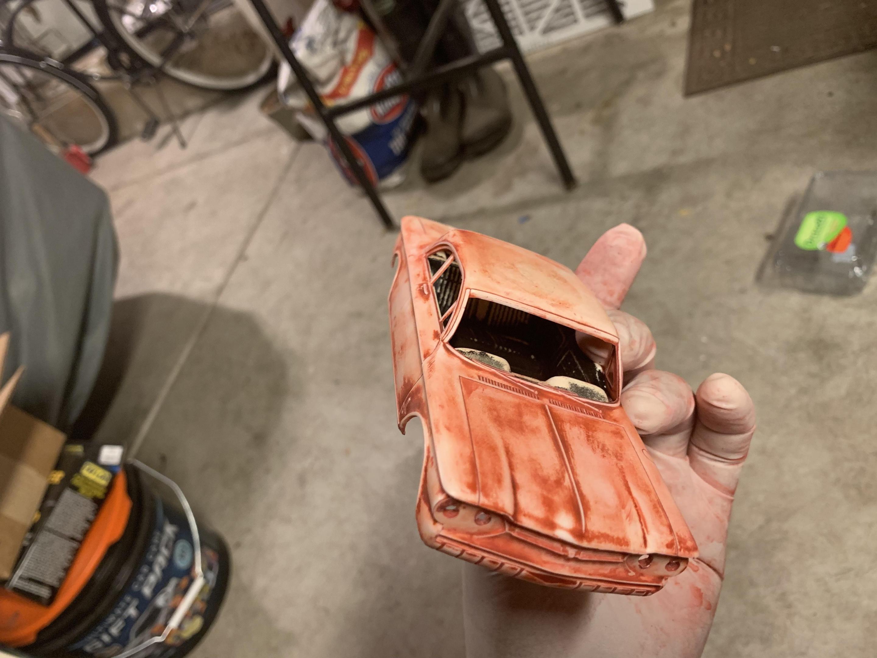

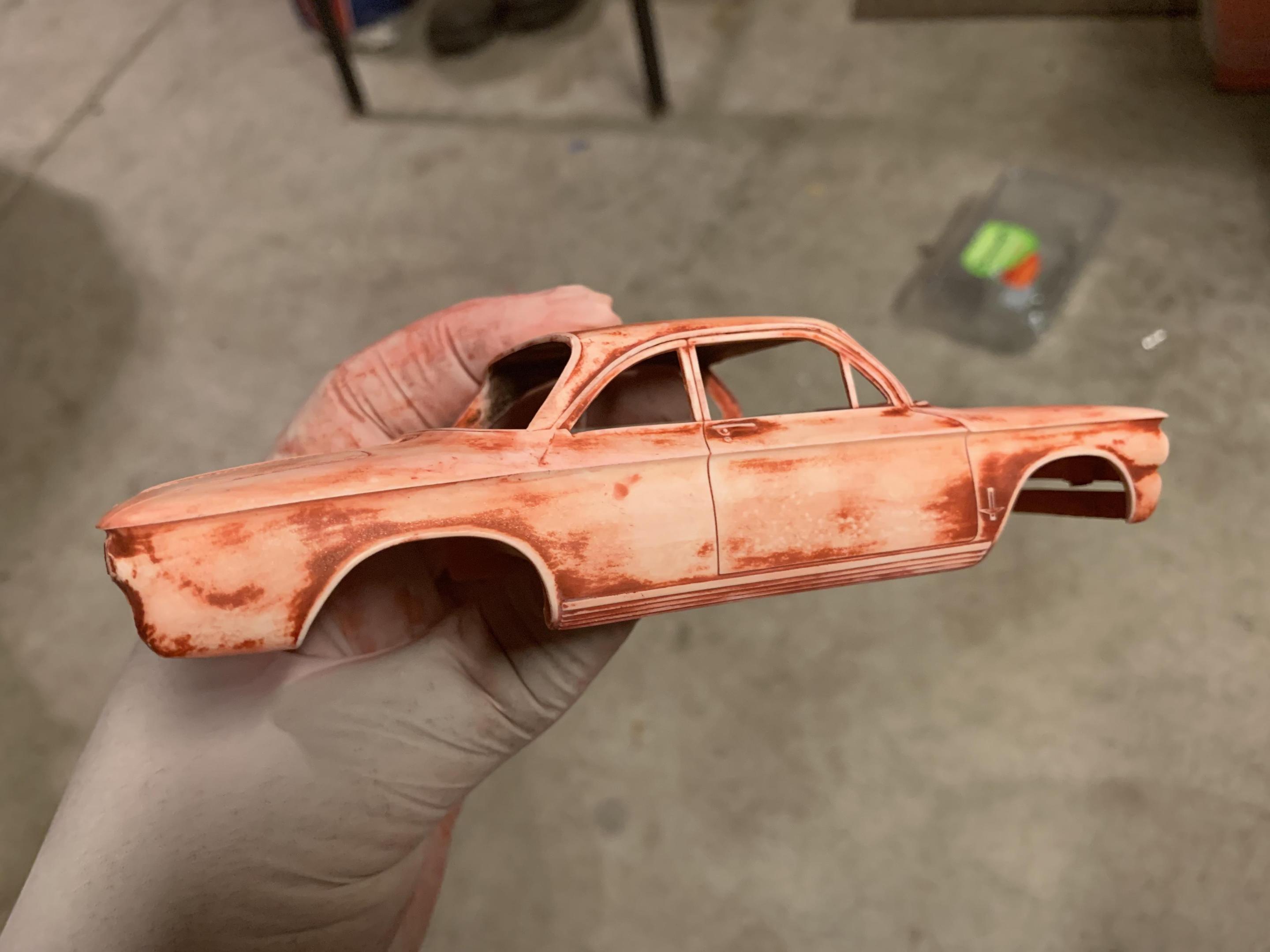

Lurch209 Posted July 8 Author Share Posted July 8 (edited) Looks like this is as good as it’s going to get. What could happen if I primered & painted over the kit like this? Edited July 8 by Lurch209 Quote Link to comment Share on other sites More sharing options...
bisc63 Posted July 8 Share Posted July 8 (edited) 13 hours ago, Lurch209 said: What could happen if I primered & painted over the kit like this? I'd be worried about losing some of the finer engraving details; there seems to be some buildup in the finer nooks and crannies. Now that the heavy paint has been removed, what remains is probably weakened. If it were me, I'd drop the body into a sealable plastic container and saturate it with Easy-Off oven cleaner ( the real stuff, NOT the low odor kind), seal the container and let it sit for a few hours, then (wearing nitrile gloves) attack it with an old toothbrush over a bath of soapy water. I'll bet it comes cleaner. Edited July 8 by bisc63 typos 1 Quote Link to comment Share on other sites More sharing options...
