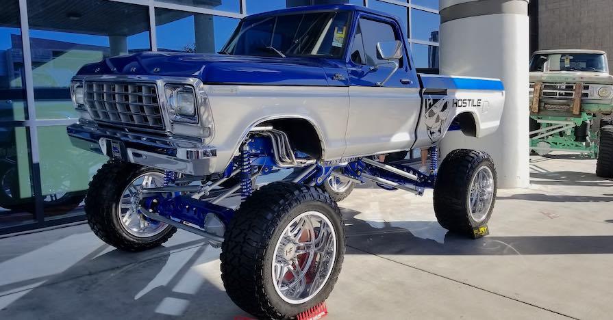

Hello everybody. I recently purchased the Deserter 1984 GMC kit and I am wanting to build a lifted show truck like something you would see at SEMA or on the Youtube Channel for Custom Offsets, a company based in Wisconsin that builds custom lifted trucks. I remember seeing a website a while back that had wheels and other parts for these types of builds, but it was so long ago I don't remember what it was. Any help would be greatly appreciated.

I'm wanting to build a truck in this type of style, but of course with the GMC Deserter pickup. This is a SEMA truck and seems to be a popular style truck build. I'm looking for wheels, suspension, bumpers, or anything else that may this type of build.
OK, you are looking at full custom, I do not know of anyone that is going to have what you want, at least not all of it.
There was a site that I can't seem to recall the name of that sold resin parts for Pull Trucks, like tractor pull etc. He may have the axles.
The wheels are going to be Etsy or Ebay unless you are looking for something truly custom or specific. Then I may be able to help.
