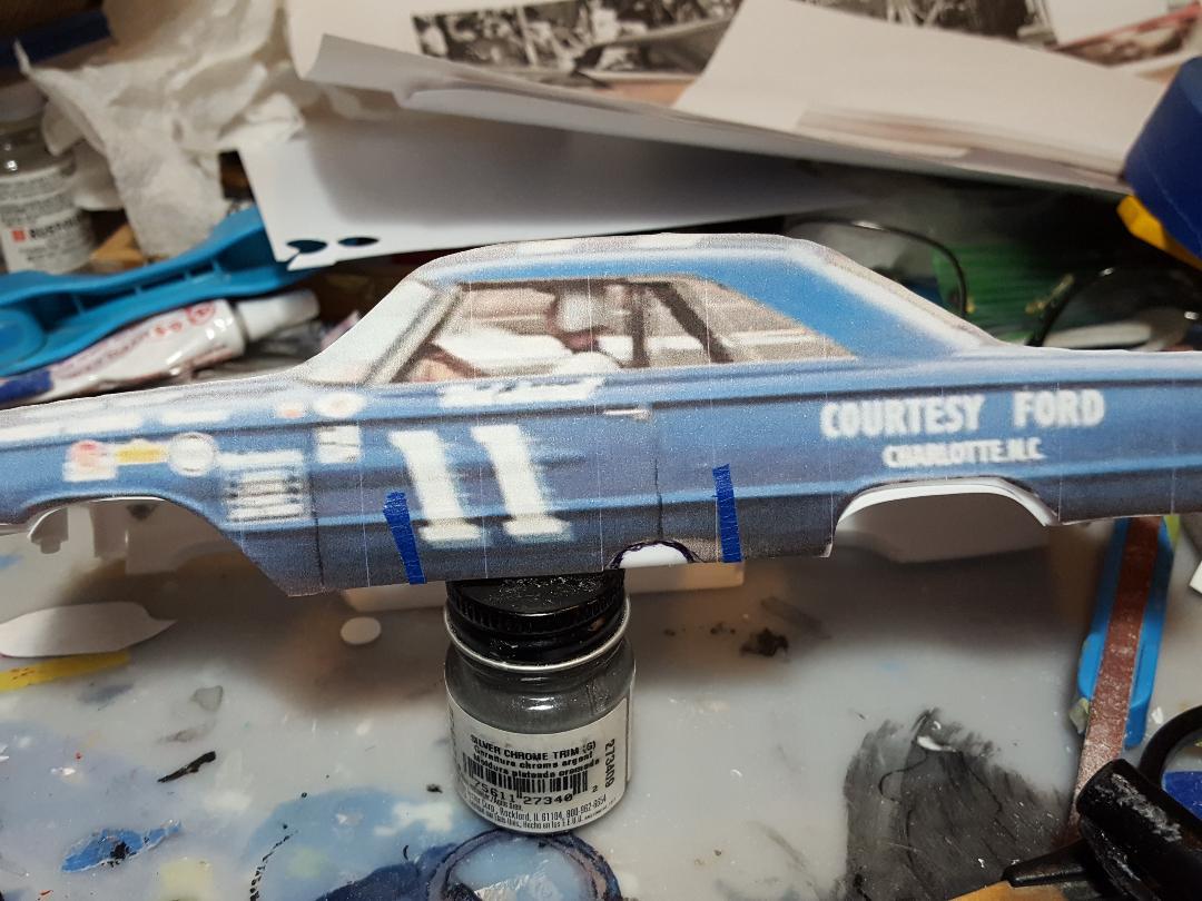

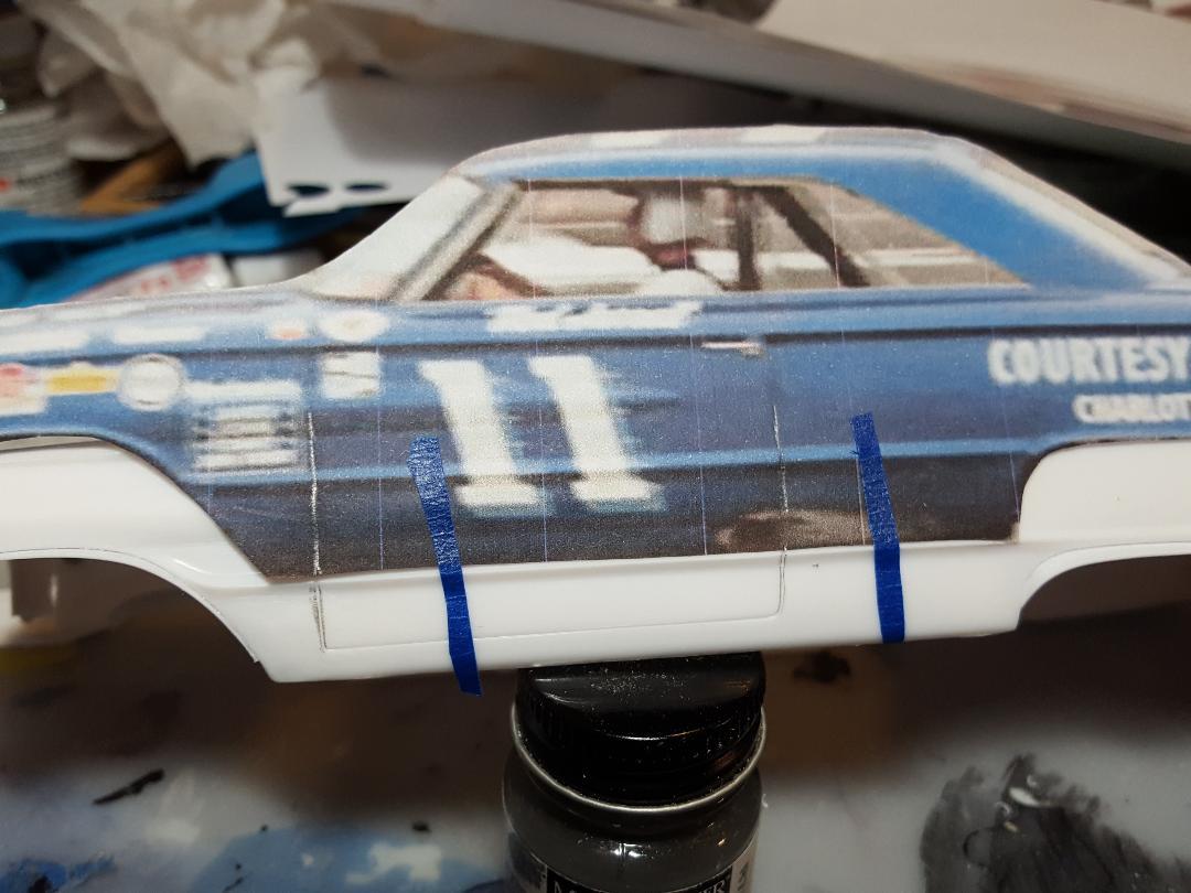

Starting on the wheel openings and where the exhaust came through the body. Used a 1/25 scale photo to locate it. you can see the door edges line up with the model. However, the model is a little too short front and rear.  nothing I can do about that. Looks like I might have to do a, do over, on the rear wheel openings. They look a little too low. Lucky to have found this profile picture of the car. Too bad I don't know how to make driver figures. I have Ned there from the shoulders up in scale.
Link to comment

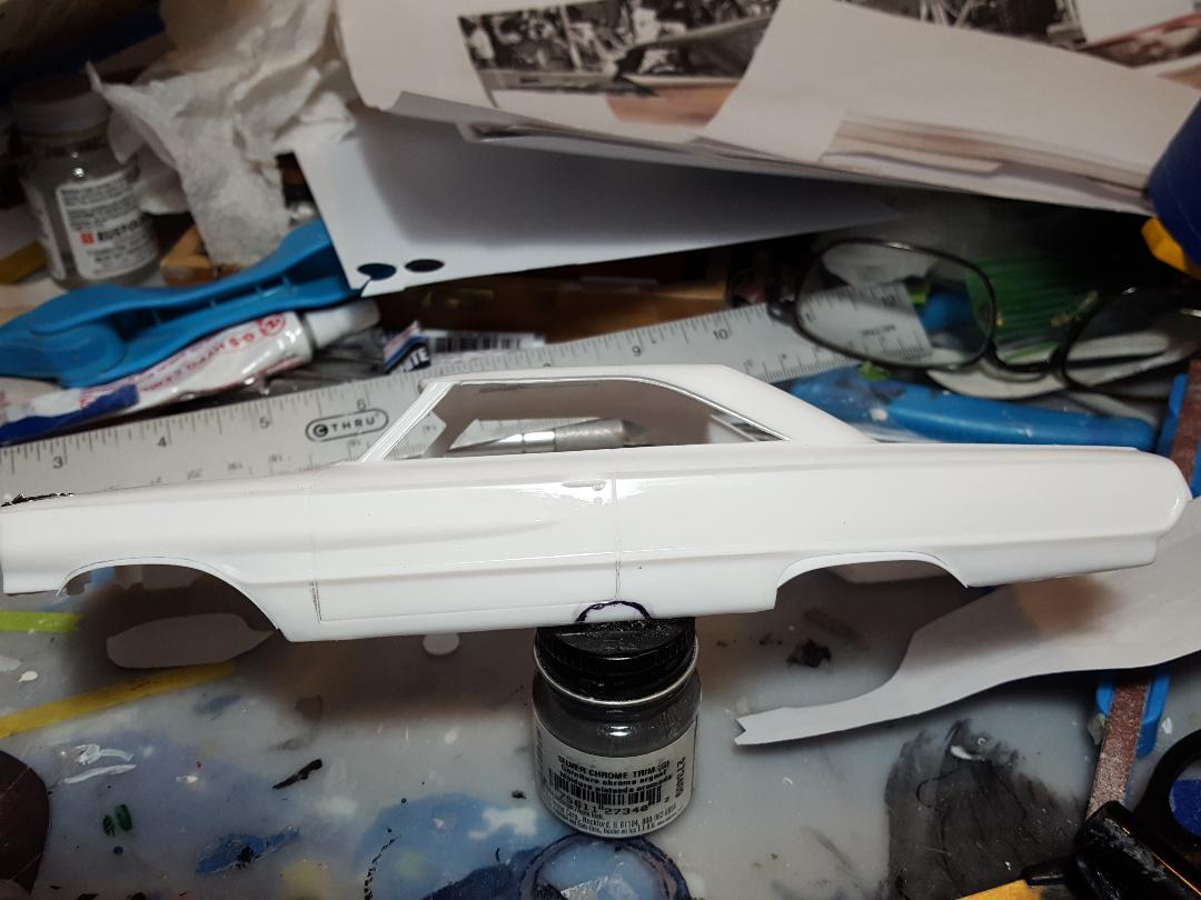

More work on the fender flares and added putty to them. Most of the putty will be sanded off. They are small lips created to get the tires in place easier. Also sanded down the front fender ornaments. I used them as filler instead of putty. Also finished where the exhaust protrudes through the body. Getting close to primer time and then making a paint recipe for the body. I'm thinking a dark blue metallic, but not a strong metallic just not an opaque dark blue.

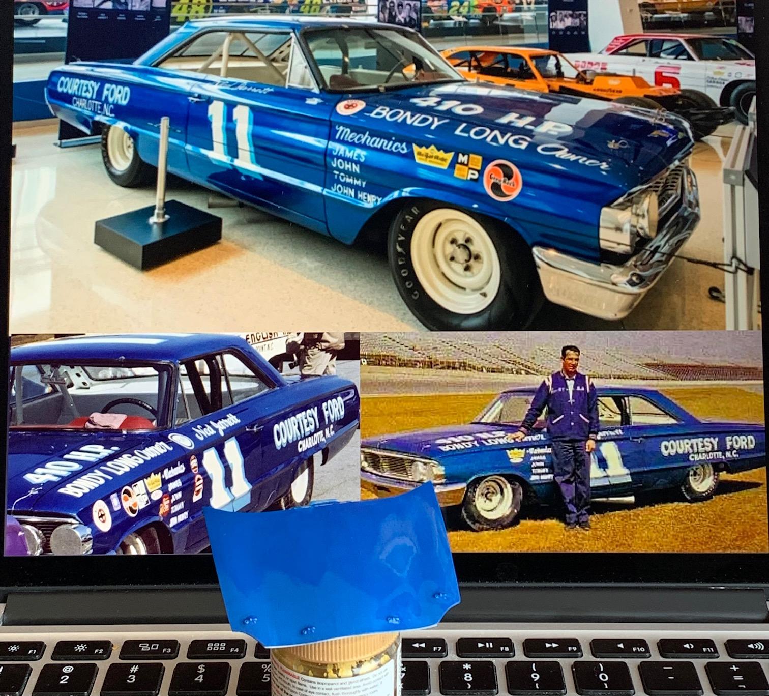

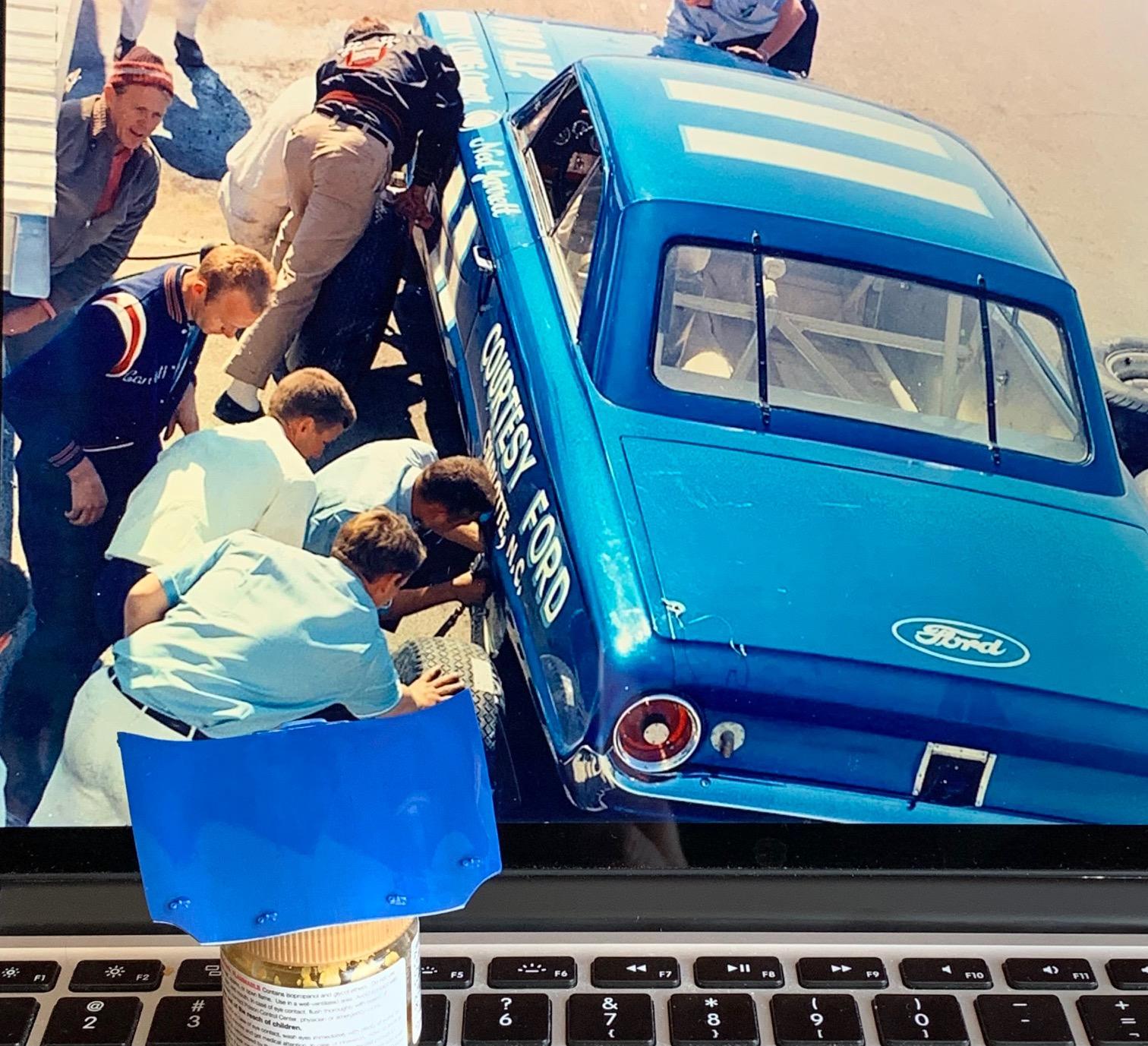

Mark, hope you are ok if I post directly here a suggestion for formulating your color. I made pics of a test hood I did today.
2 drops of 70.899 Dark Prussian Blue
1 drop of 70.930 Dark Blue
3 drops of 70.521 Metal Medium
9 drops of 70.524 Thinner Medium
3 thin coats over a gray primer.
Link to comment
I believe you nailed it, Pierre. I have all of those ingredients for the recipe. Now all I have to do is get it on the model correctly. I'm going to really concentrate on getting the primer very smooth like you did with your Corvette. It seems like any flaw in the primer will show through to the paint. Thank you for helping me out with this. I'm sure mine would not have come out near as close as this does.

The fender flares are finished so I can begin sanding the body. I believe I will do the brush painters sanding trilogy and apply 6000,8000 and 12000 grits before priming. I've already removed all the mold lines and other stuff. I might need to hit it with something rougher first. I shall see.
Link to comment
