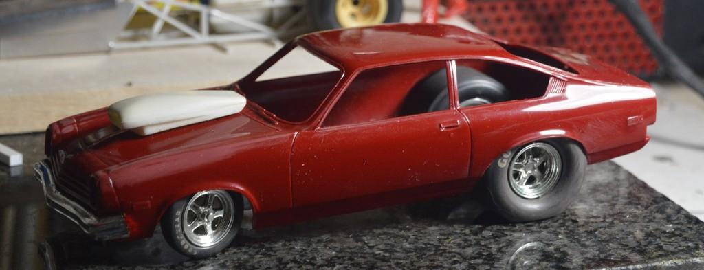

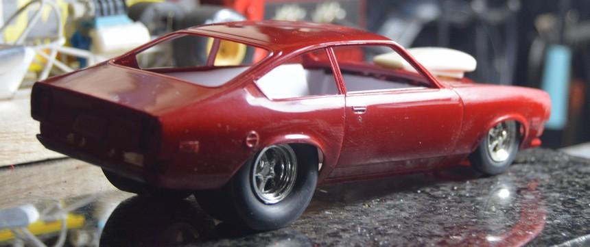

Straightliner59 Posted July 21, 2022 Share Posted July 21, 2022 (edited) While I am happy with much of the work I've done on the '53 'Vette, the crazed plastic really cooled my jets, as far as that project goes. I've been having a lot of fun doing curbside stuff, and I have all these promo Vegas, so... First, as I did with the MPC slicks on the dragster I recently started, I sanded off the lettering (A scalpel works very well, to do some preliminary slicing of the letters). I then used a 4-way polishing stick, to get them to this state. I will replace the lettering with Gofer Racing decals. When sanding the slicks, I try to ease the transition from the surface to the sidewall, as I think they're too exaggerated as they're molded. I'm not sure what the wheels are from, but I ordered a set from Forward Resin (they're beautifully cast!), then found these in one of the drawers I keep such things in. Front tires are Monogram Frontrunners, again sanded smooth and "polished". I used the Dremel to open the wheel cutouts, as it appears this is how most of them are done--just be sure to finish the edge!😃 I had picked up a Pro Stock Vega chassis and interior on Ebay, and will use them, underneath, this being a curbside, and all. I'll do my typical "aluminum siding" job, inside. It'll get all the visible accoutrement becoming a proper 1984 Super Gasser. S/G was very cool, back then--much as MP was, a decade earlier. The days before delay boxes (yuck!), when a throttle stop might just be a block of wood, beneath the throttle pedal! Really! I knew of a couple. The scoop is from AMT's '66 Nova Pro Streeter. I'm hoping not to spend too awful long, with it. Sorry for the poor photos. I was getting ready to hit the hay. As always, questions comments and critiques are welcome. Thanks for looking! Edited November 12, 2022 by Straightliner59 2 Quote Link to comment Share on other sites More sharing options...
Straightliner59 Posted July 21, 2022 Author Share Posted July 21, 2022 It's on the wheels... 4 Quote Link to comment Share on other sites More sharing options...
bytownshaker Posted July 21, 2022 Share Posted July 21, 2022 (edited) Looks great !!! Vega's and the compact cars of that era made awesome looking race cars. Edgar Edited July 21, 2022 by bytownshaker spelling Quote Link to comment Share on other sites More sharing options...
Ian McLaren Posted July 21, 2022 Share Posted July 21, 2022 Love early super gas cars, quick enough to be fun but reasonably affordable, You are capturing the look very well. 1 Quote Link to comment Share on other sites More sharing options...
geemoney Posted July 21, 2022 Share Posted July 21, 2022 love it! jealous because you have a vega with the stock wheel openings! Quote Link to comment Share on other sites More sharing options...
Straightliner59 Posted July 22, 2022 Author Share Posted July 22, 2022 19 hours ago, bytownshaker said: Looks great !!! Vega's and the compact cars of that era made awesome looking race cars. Edgar Thanks, Edgar! I have always loved these little H-Bodies! 18 hours ago, Ian McLaren said: Love early super gas cars, quick enough to be fun but reasonably affordable, You are capturing the look very well. Thanks, Ian. They were interesting to watch, back then. Now, not so much--at least for me. That "bog" just kills it! 18 hours ago, geemoney said: love it! jealous because you have a vega with the stock wheel openings! Thanks, Michele. Promos (especially '75-'77 models) can be had pretty reasonably, on Ebay. That's what almost all of mine are. Quote Link to comment Share on other sites More sharing options...

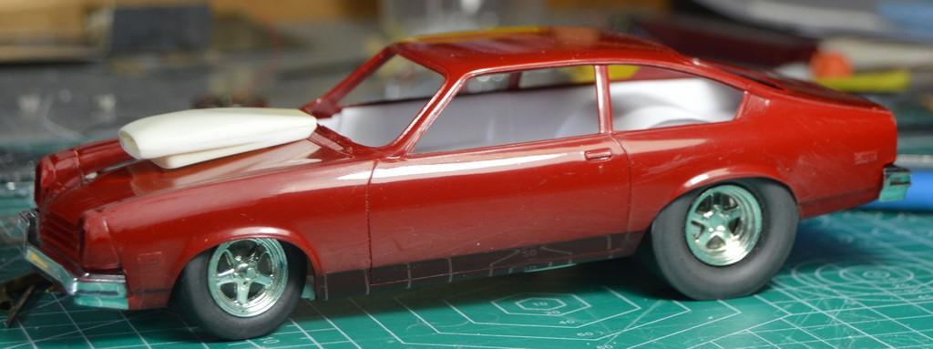

Bainford Posted July 25, 2022 Share Posted July 25, 2022 Looking good, Daniel. It sits just right. The Vega drag cars of this era had a great look. Quote Link to comment Share on other sites More sharing options...
AmericanMuscleFan Posted July 25, 2022 Share Posted July 25, 2022 Nice car Daniel, the stance is perfect and those big tires fill the wheel wells perfectly. Good choice too because these Vega (and Nova) are very popular on the racetracks, at least on this side of the border... 😁 Super Gas cars generally put on good shows and I am confident that your WIP thread, despite the fact that you will be doing a curbside, will honor the class even in its simplified form. I'm not worried about you coming back soon with another one of your super detailed project, it's hard to completely extinguish an inferno when the fire is still smoldering below the surface ! 😉🔥 Quote Link to comment Share on other sites More sharing options...

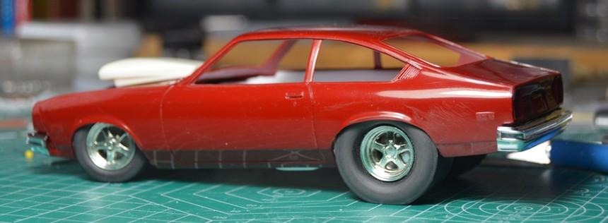

Straightliner59 Posted July 25, 2022 Author Share Posted July 25, 2022 8 hours ago, Bainford said: Looking good, Daniel. It sits just right. The Vega drag cars of this era had a great look. Thanks, Trevor. They really did look cool! To get the rear low enough, I want to clarify how I did the rear wheelwell openings. I left an inch of the highest part of the wheel arch/flare, then gently recurved the rest of the opening with a burr in a flex-shaft attachment, until it was wide enough. Essentially, it still mimics the stock lines. Once that's accomplished, it's just a matter of thinning them. It doesn't hurt to thin the front ones, at this point, too! Quote Link to comment Share on other sites More sharing options...

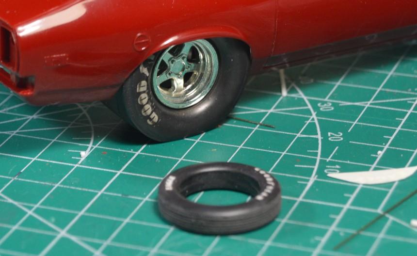

Straightliner59 Posted July 27, 2022 Author Share Posted July 27, 2022 I got the decals on the tires. I'm happy with them! I swapped the Frontrunners for a set of the Moroso fronts from (I think) the Dobbertin Olds kit. I sanded the lettering from them, as well, and added the Revell decals. It helps to use a new scalpel (or X-Acto) blade to shave some of the "height" from the lettering, before sanding the sidewalls clean. Once I have cleaned and polished the sidewalls, I coat them with Future, to prevent silvering of the decals. Once the Future's dry, I apply the decals, using Micro Set and Micro Sol. I keep watch on them, adding setting solutions, as necessary. Once those have dried, I brush on a coat of Testors Acrylic Matte Clear coat--It's Model Master, so I am unsure if it's available in another form. When the clear has dried, I liberally apply shaved/crushed/ground pastels in black, dark brown, brown, tan, and pale yellow colors, with a stiff brush. I also rub them lightly into the chalks. The pastels tone down the white of the decals, and, in some instances, make it look as if the lettering paint has worn through/been rubbed off. The white lettering becomes dirty and looks more toned down, quickly, due to the fact that sportsman racers are often pitted in muddy and/or dusty areas, at many tracks. That said, here are a few photos of the newly-lettered tires. Questions, critiques and comments are always welcomed. Thanks for looking! 1 Quote Link to comment Share on other sites More sharing options...

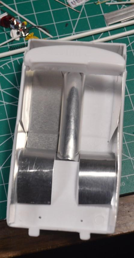

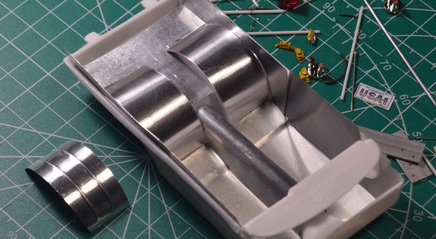

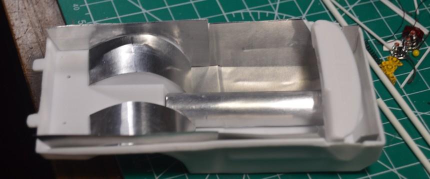

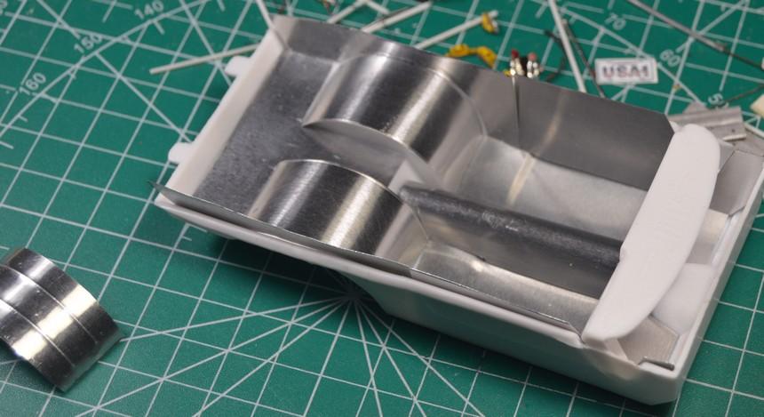

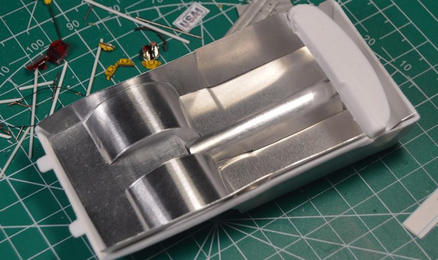

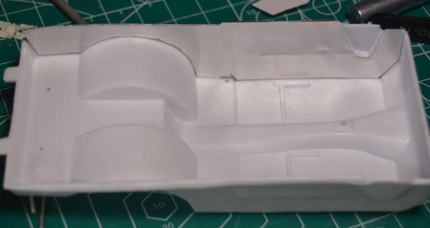

Straightliner59 Posted July 29, 2022 Author Share Posted July 29, 2022 8 hours ago, Zippi said: The Vega is looking pretty nice man. Thanks, Bob! Appreciate it. I've been cutting aluminum sheet for the interior panels. I mis-bent the passenger side floor panel. I'll cut a new one. The drivetrain hump will be cut down, a bit, and the cover for the bellhousing fabbed. The floor panels are aluminum flashing. The door panels, side panels, tubs and rear floor are/will be tooling aluminum, since they aren't structural, and have only flat bends, if that makes sense. Once I have everything cut and fitted, I'll add some bead-rolling to the tubs and door panels, using a burnishing tool and a paper pad. I plan to replace the gauge panel with flashing. I'll probably go with the Lenco, since the shifter mechanisms will add visual interest. Questions, comments and critiques are always welcome. Thanks for looking! 2 Quote Link to comment Share on other sites More sharing options...
AmericanMuscleFan Posted July 30, 2022 Share Posted July 30, 2022 Absolutely beautiful work so far on the aluminum panels Daniel ! The Lenco shifter will certainly look great on the transmission tunnel. I know it will be a curbside build, so I assume there will be no transmission visible from below, as the model is meant to be enjoyed sitting on its wheels !? Quote Link to comment Share on other sites More sharing options...
Straightliner59 Posted July 30, 2022 Author Share Posted July 30, 2022 1 hour ago, AmericanMuscleFan said: Absolutely beautiful work so far on the aluminum panels Daniel ! The Lenco shifter will certainly look great on the transmission tunnel. I know it will be a curbside build, so I assume there will be no transmission visible from below, as the model is meant to be enjoyed sitting on its wheels !? Thank you, Francis! You are correct. It will just feature details you'd see, if you were standing next to it, but nothing was opened up. I enjoy doing these because it challenges me to improve my finish work. It also helps me to look at possibilities for detailing, differently. I didn't give them a lot of consideration, until John MacGowan (Two-time GSL winner, and all-around great guy!) showed up at some show with a yellow Ferrari. His work was so beautiful, it inspired me to see them as more "serious" efforts. Timely that you mentioned the sheet work. I have an update, on just that! None of these panels are cemented into place, yet. I am quite happy, with them. The wheel tub that is sitting alone is a test mule for the bead-rolling on those that are in the car. I will do some further work to that end, to the door and interior panels as well. The rollcage will be scratchbuilt, perhaps from brass--I haven't decided, just yet. As always, comments are welcomed. Thanks for looking! Quote Link to comment Share on other sites More sharing options...
bisc63 Posted July 30, 2022 Share Posted July 30, 2022 Very nice scratch-building! Interior is impressive already. Will you add any sort of rivet detailing? Quote Link to comment Share on other sites More sharing options...

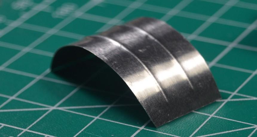

Ian McLaren Posted July 30, 2022 Share Posted July 30, 2022 The interior is really starting to look like the real deal, well done on the bead rolling I always have the challenge of either not enough bead and deform the panel or the bead is too pronounced, you seem to have hit the sweet spot and they look great. Quote Link to comment Share on other sites More sharing options...
