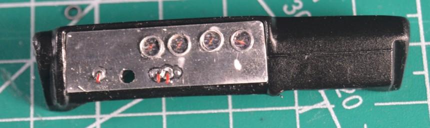

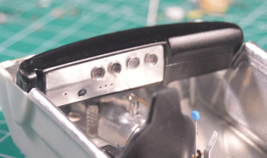

Straightliner59 Posted September 26, 2022 Author Share Posted September 26, 2022 15 hours ago, majel said: Your level of detail on this model is fantastic Daniel. Love the linkage and the belts, very impressive! Thank you, kindly, Jim. I appreciate it! Here's an update with the dash/gauge panel. Dash is Krylon Semi-Flat Black. Gauges are from Auto Meter's website. I sized them, and printed them on photo paper. I'm currently working on the switches, and starter button. I'm hoping to get the interior wrapped up in the next couple of days. Thanks for looking! Quote Link to comment Share on other sites More sharing options...
Straightliner59 Posted September 27, 2022 Author Share Posted September 27, 2022 Well, the dash is almost done. I use almost, because, now that it's really big, I can see that one of my bezels is out-of-round, and will likely need to be replaced, since I thought I had it "straightened" out. I'll wipe up some of the ink wash around the switches. The discs are punched from aluminum duct tape, while the toggles are brass wire. The starter button is a short length of .030"-ish aluminum wire; I polished the end of it using a 4-way nail board. I'm beginning work on the steering wheel, which is a Detail Master item. Your comments are always welcomed. Thanks for looking! Quote Link to comment Share on other sites More sharing options...

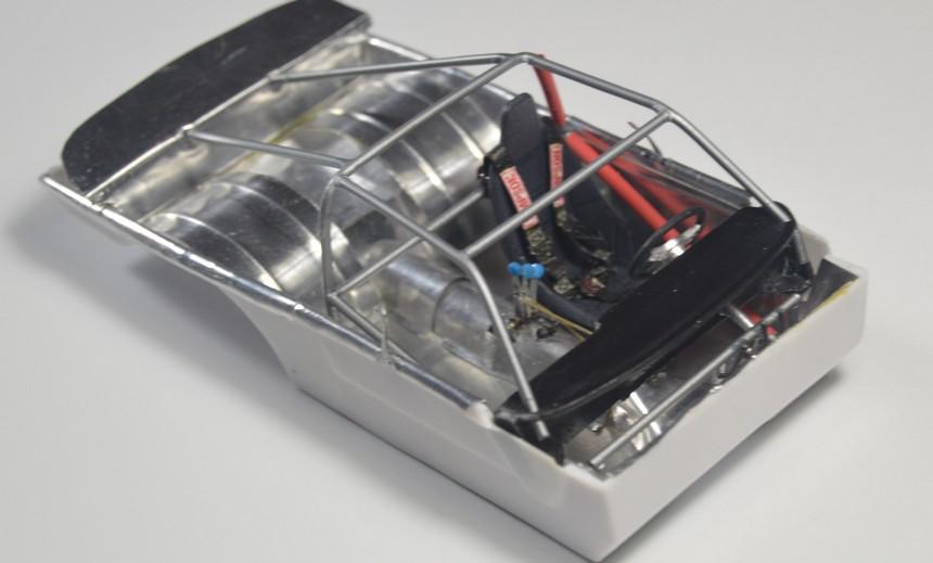

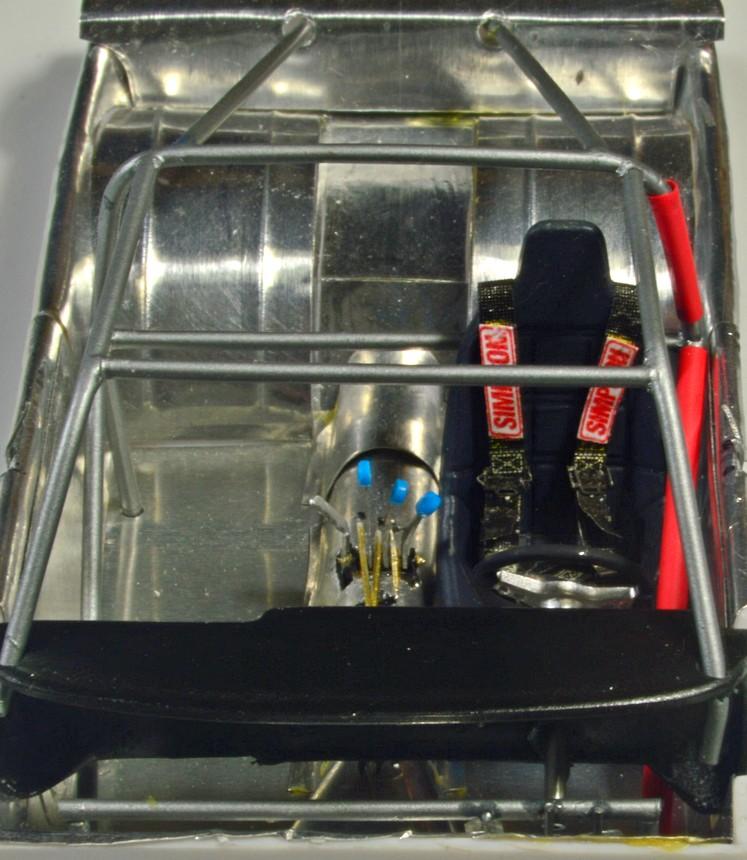

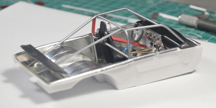

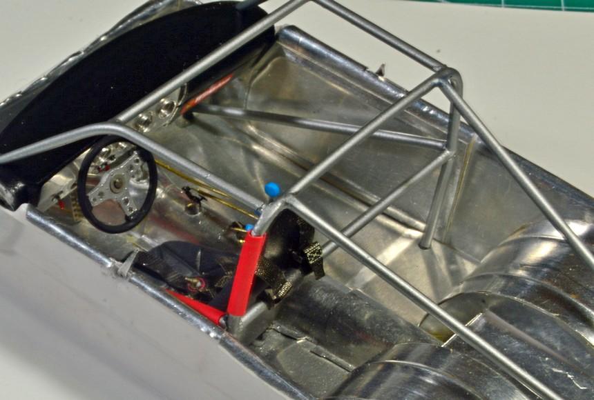

Straightliner59 Posted October 1, 2022 Author Share Posted October 1, 2022 I guess I finished the interior ahead of schedule! Sorry the photos aren't great, the camera didn't want to focus on anything, in particular, so it was all real hit and miss. I was too lazy to get out the tripod...😁 Comments are always welcomed. Thanks for looking! Quote Link to comment Share on other sites More sharing options...

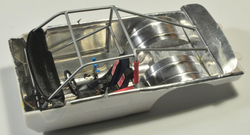

Straightliner59 Posted October 2, 2022 Author Share Posted October 2, 2022 (edited) I got started on the body work. I'm doing a fiberglass front end, so I sanded off the side marker lights. I also scribed in the @Snake45lines, below and behind the door. I had ordered and received a sheet of PET. To test it, I thermo-formed a windshield. It worked out pretty nicely! I began grinding off the gas cap and wipers, as well. I got out the tripod, and took some better shots of the completed interior. I'm pretty happy with the interior and with the pictures! Your opinions are always welcome. Thanks for lookin'! Edited October 2, 2022 by Straightliner59 1 Quote Link to comment Share on other sites More sharing options...
