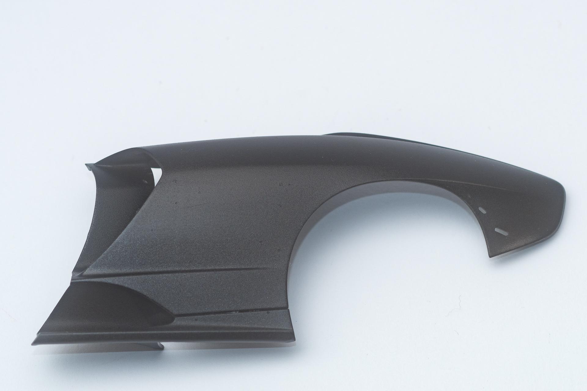

Then I assembled and painted one of the rear fenders. After the experience with the rear body panel I clear coated it (after that picture was taken), hoping the decals would be easier to move around.
