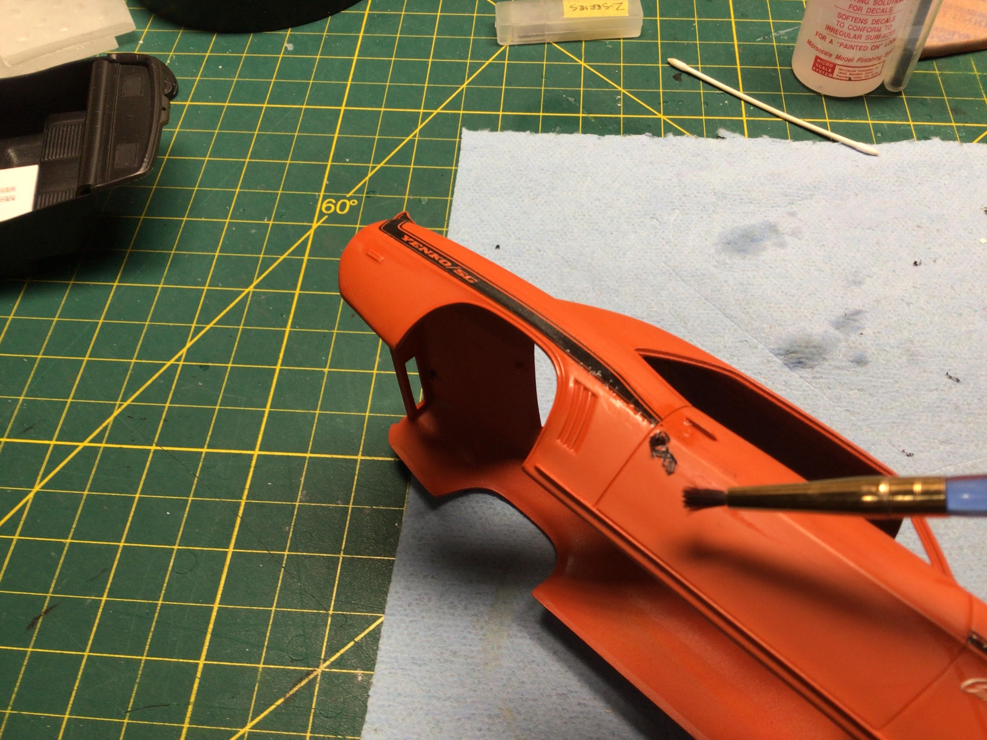

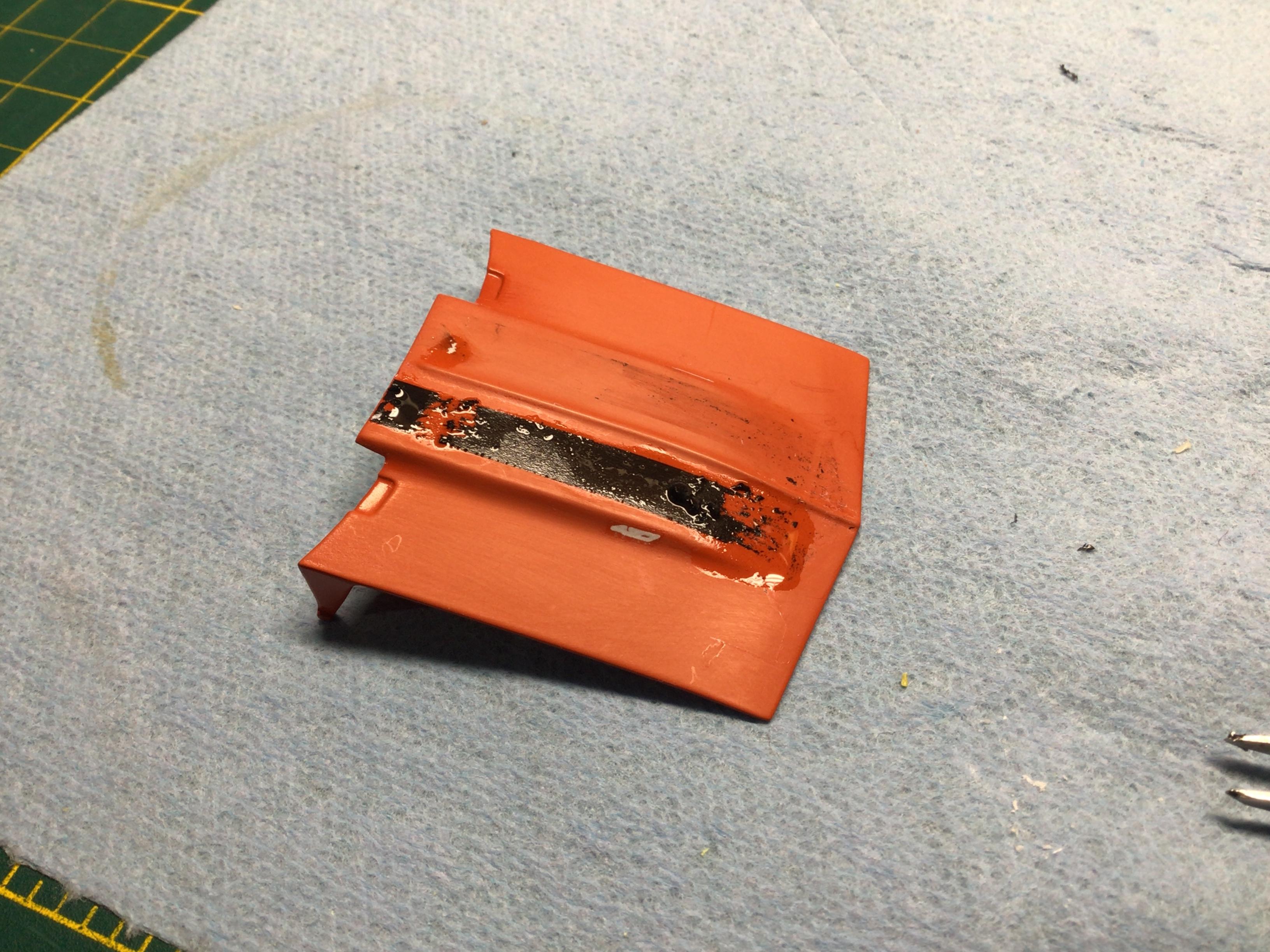

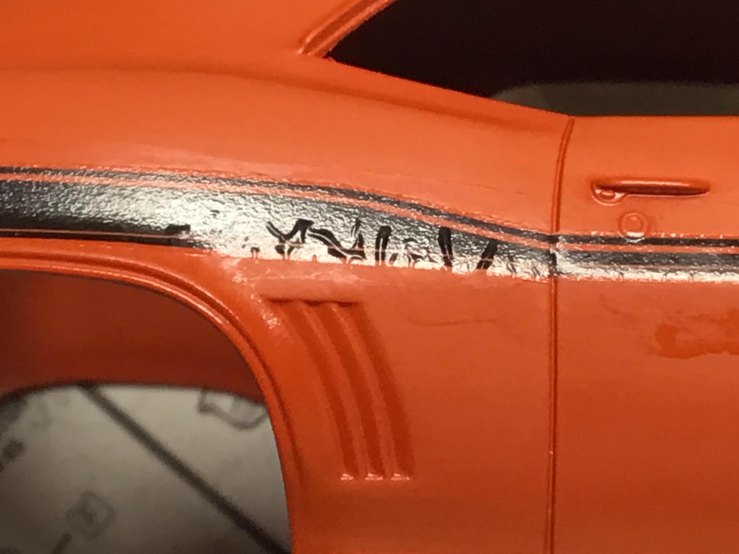

NOBLNG Posted August 27, 2022 Author Share Posted August 27, 2022 (edited) Well I’m not sure that the dull finish contributed to me wrecking these decals. I did go over the entire thing with #3000 before applying the decals. In some spots I just could not iron out the wrinkles, even with copious amounts of micro sol and gently rubbing it with a tamiya swab. Then I screwed one of them up badly and decided I had to remove them, but I wanted to save the paint job if possible. I found the best way was to soak it with Micro Sol and use a short stiff bristled paint brush to jab at the decal and remove it. I saved the paint job and gave it a couple coats of acrylic clear. Now I will try the white decals and see if they lay down any better.😕 Edited August 27, 2022 by NOBLNG Quote Link to comment Share on other sites More sharing options...
espo Posted August 28, 2022 Share Posted August 28, 2022 For removing decals with little or no damage to the paint, try masking tape. The Scotch Blue stuff seems to work great. Quote Link to comment Share on other sites More sharing options...
maxwell48098 Posted August 29, 2022 Share Posted August 29, 2022 One of the best products I've used for decades for removing decals that haven't been sealed to the surface with clear coat is plain, old Scotch Magic Tape, the frosty appearing tape. Press it down firmly, then do a quick pull. Repeat if necessary. A.J. Quote Link to comment Share on other sites More sharing options...

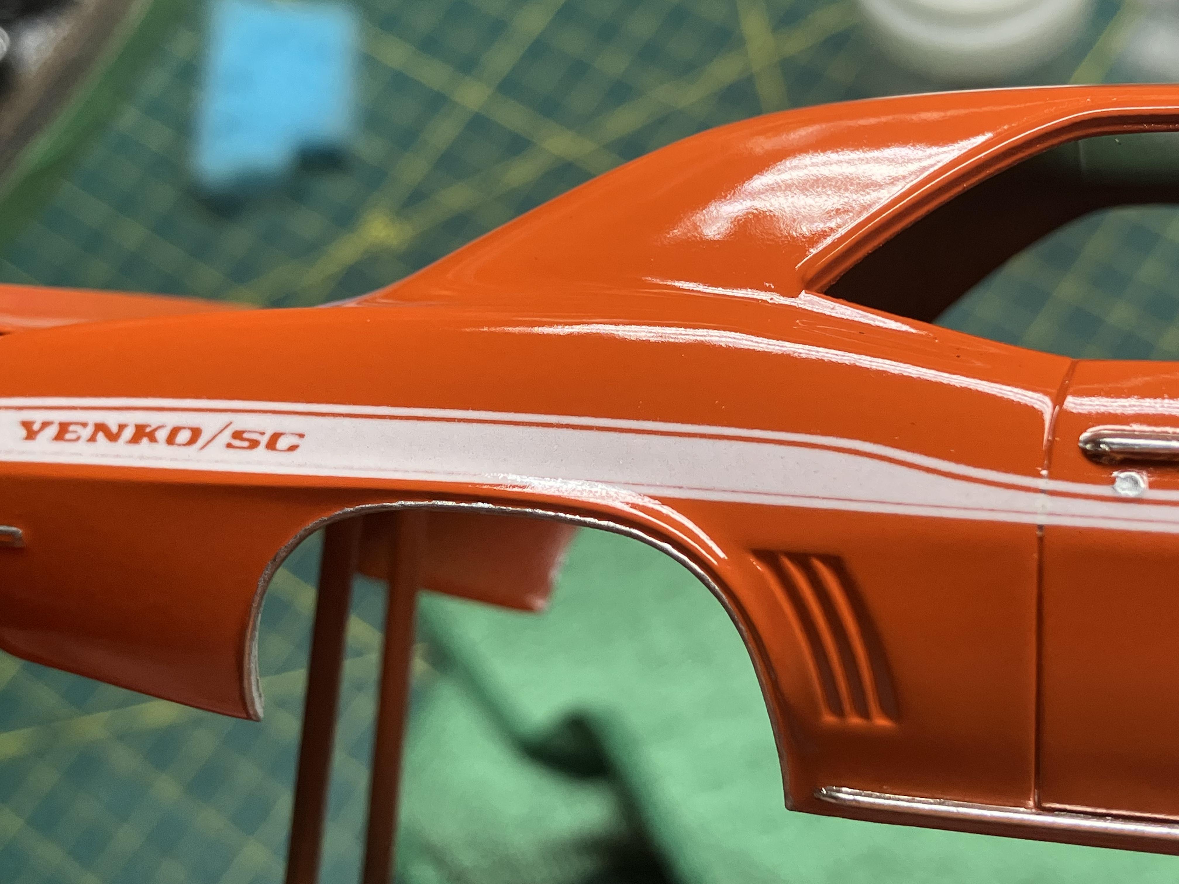

NOBLNG Posted August 31, 2022 Author Share Posted August 31, 2022 On 8/29/2022 at 10:24 PM, Michael jones said: Looks like you needed to use a softening solution for the decals 1 hour ago, Chariots of Fire said: Try Micro-sol under the decal before you lay it down. It might help with the wrinkle problem. Another bit of it on top afterward is ok too. I did use micro set before applying the decal and micro sol afterwards. I sanded with #3000 before attempting the decals….maybe not slick enough? I did manage to iron out most of the wrinkles, but these big ones just would not disappear. Anyways, the white decals laid down much nicer, but I did lay down a coat of clear first. Too bad, because the black stripes had a lot better definition than the white.😕 Quote Link to comment Share on other sites More sharing options...
Chariots of Fire Posted August 31, 2022 Share Posted August 31, 2022 That looks nice, though. Are you going to cut through the decal at the door line? Use a fresh blade and then hit it again with Micro-sol. 1 Quote Link to comment Share on other sites More sharing options...

espo Posted September 1, 2022 Share Posted September 1, 2022 While it's only my opinion, I like the white stripes better than the black ones on this color, a little less Halloween looking. Quote Link to comment Share on other sites More sharing options...
