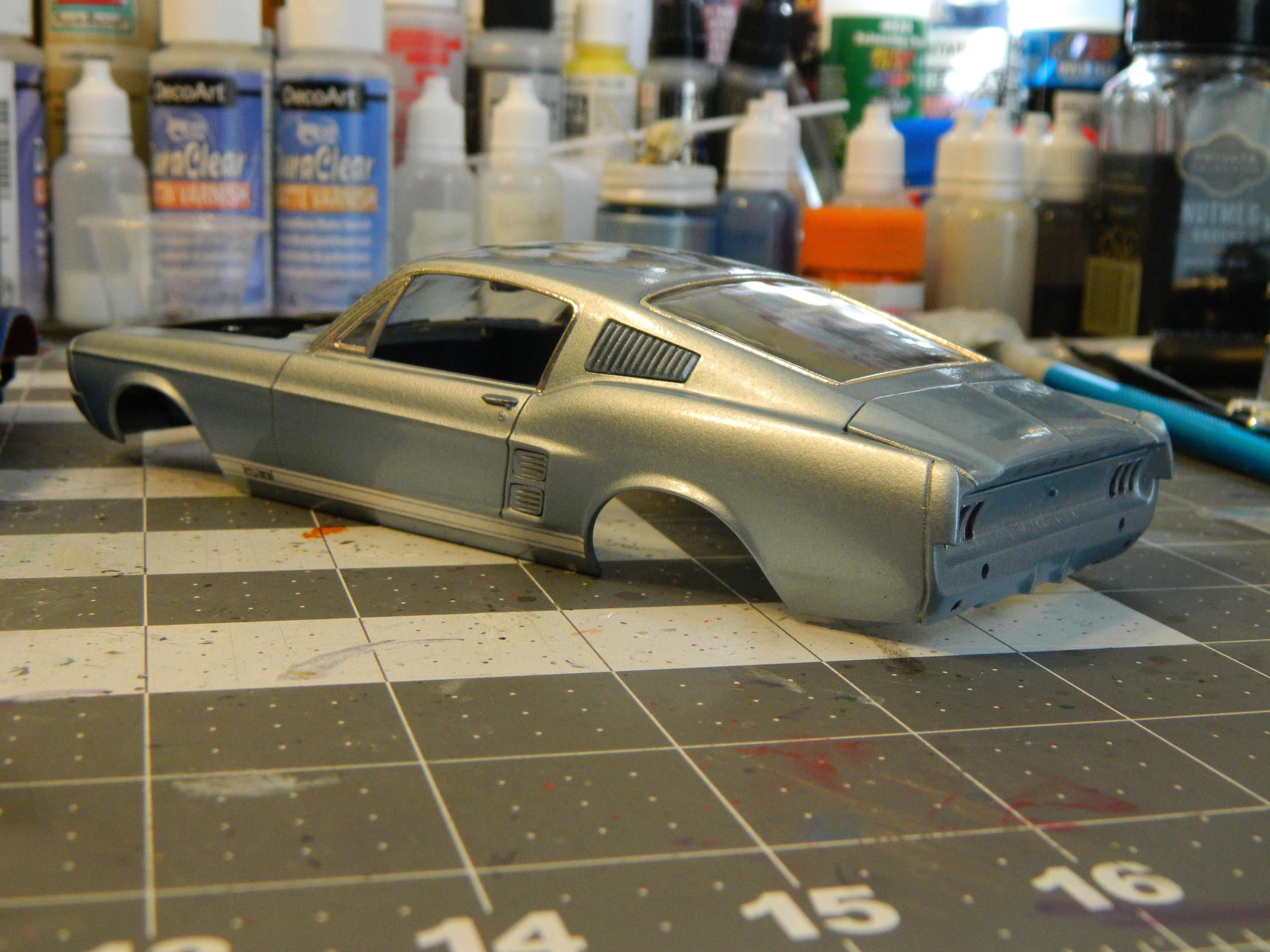

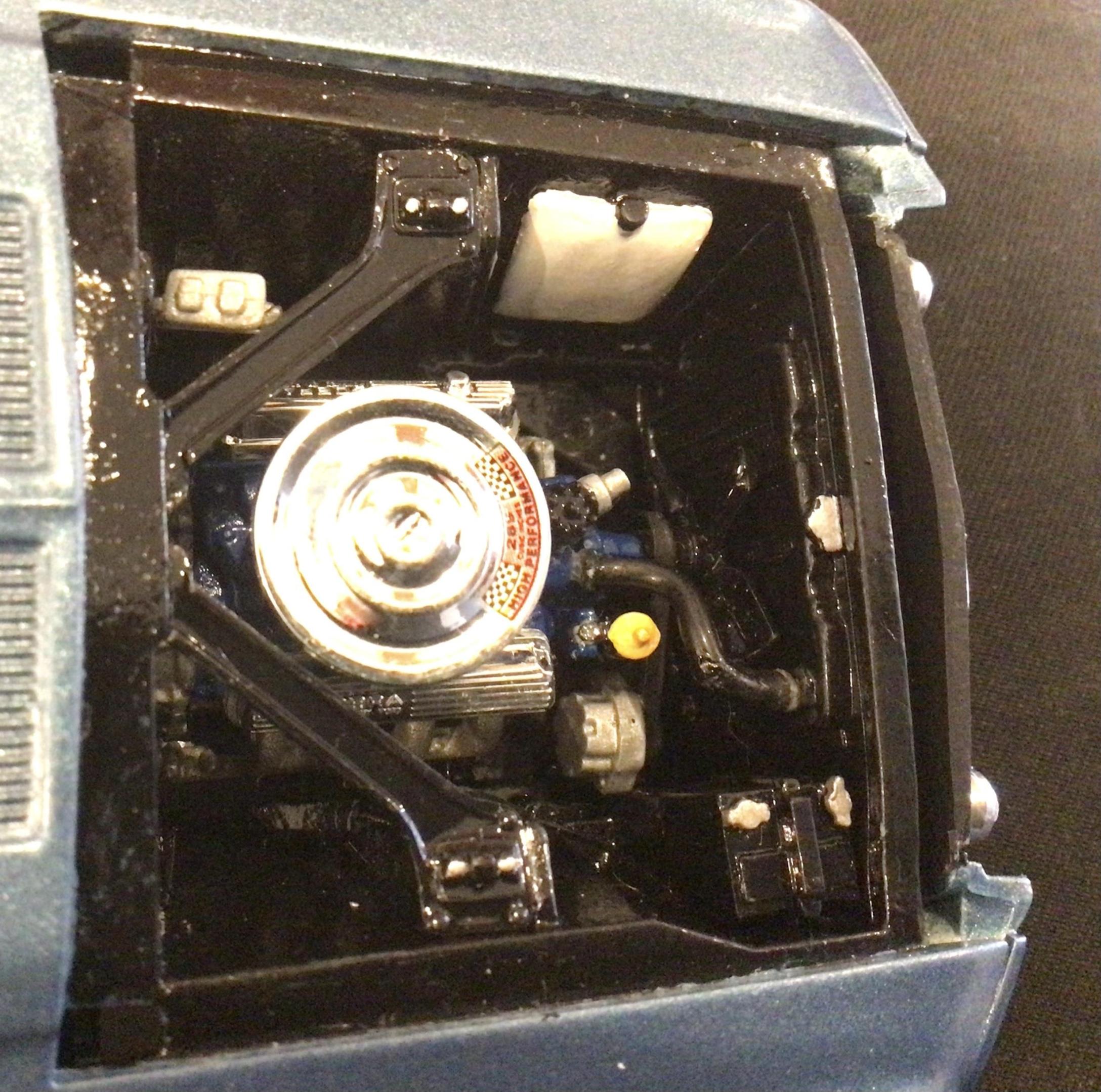

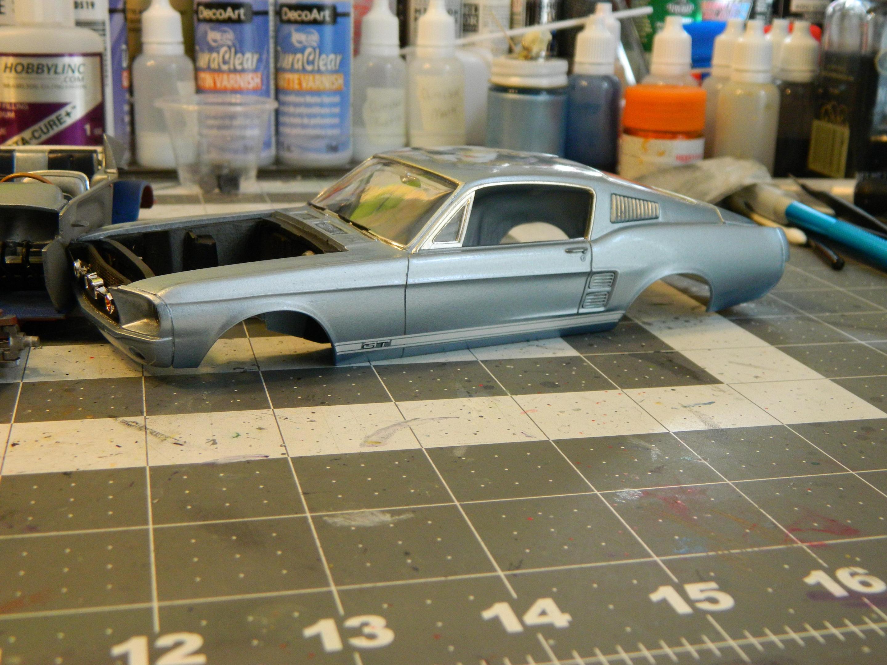

With these kits (67 SHelby and fastback) I have glued the front and rear sections together and paint the entire body as one piece.  It’s a little trickier getting the chassis in the body.  This way you can fill in the gaps where there are not supposed to be any.  I cannot remember about the radiator but it should be attached to the radiator support.  Ignore the red reflection on the chrome in the pictures.

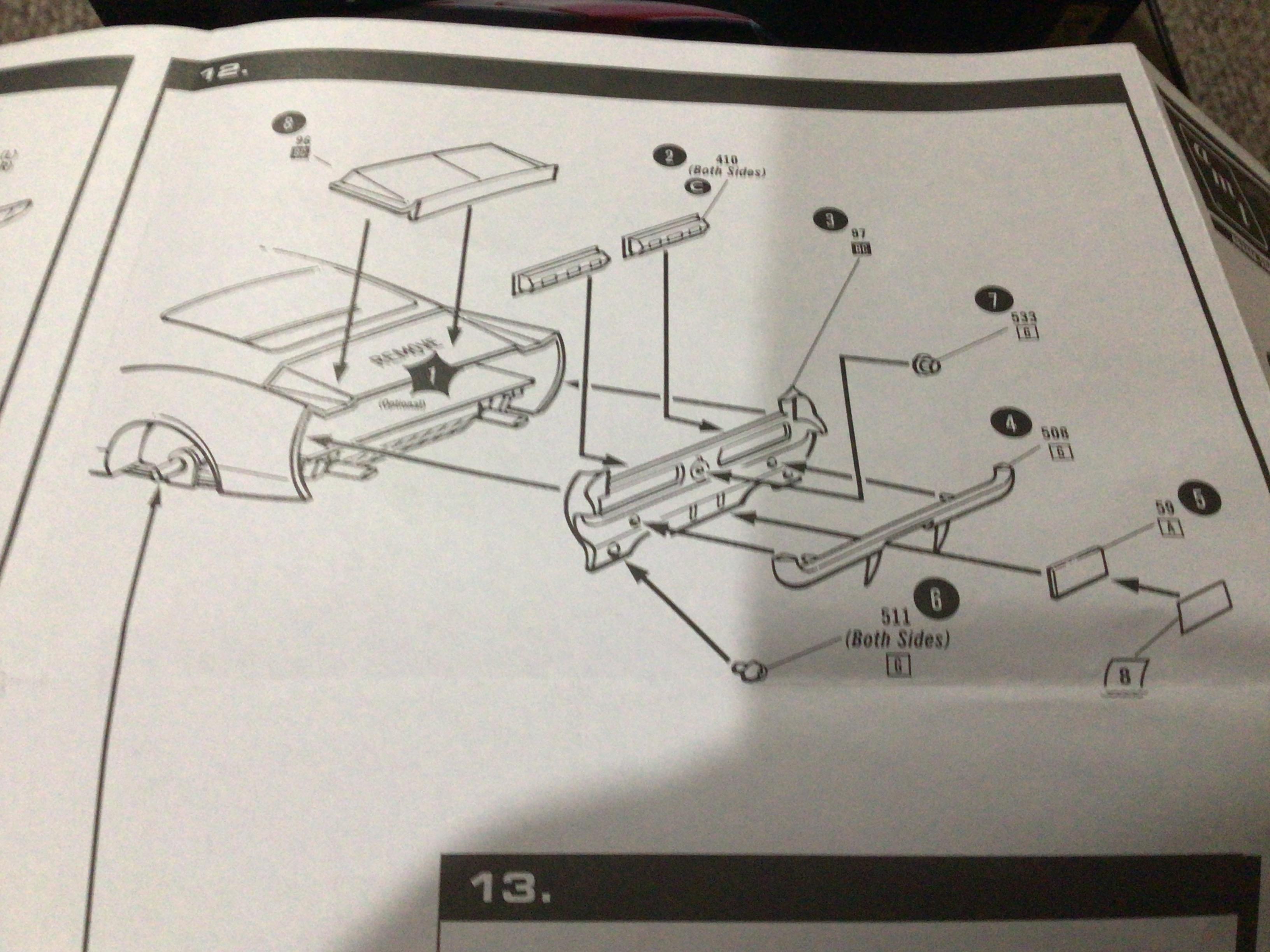

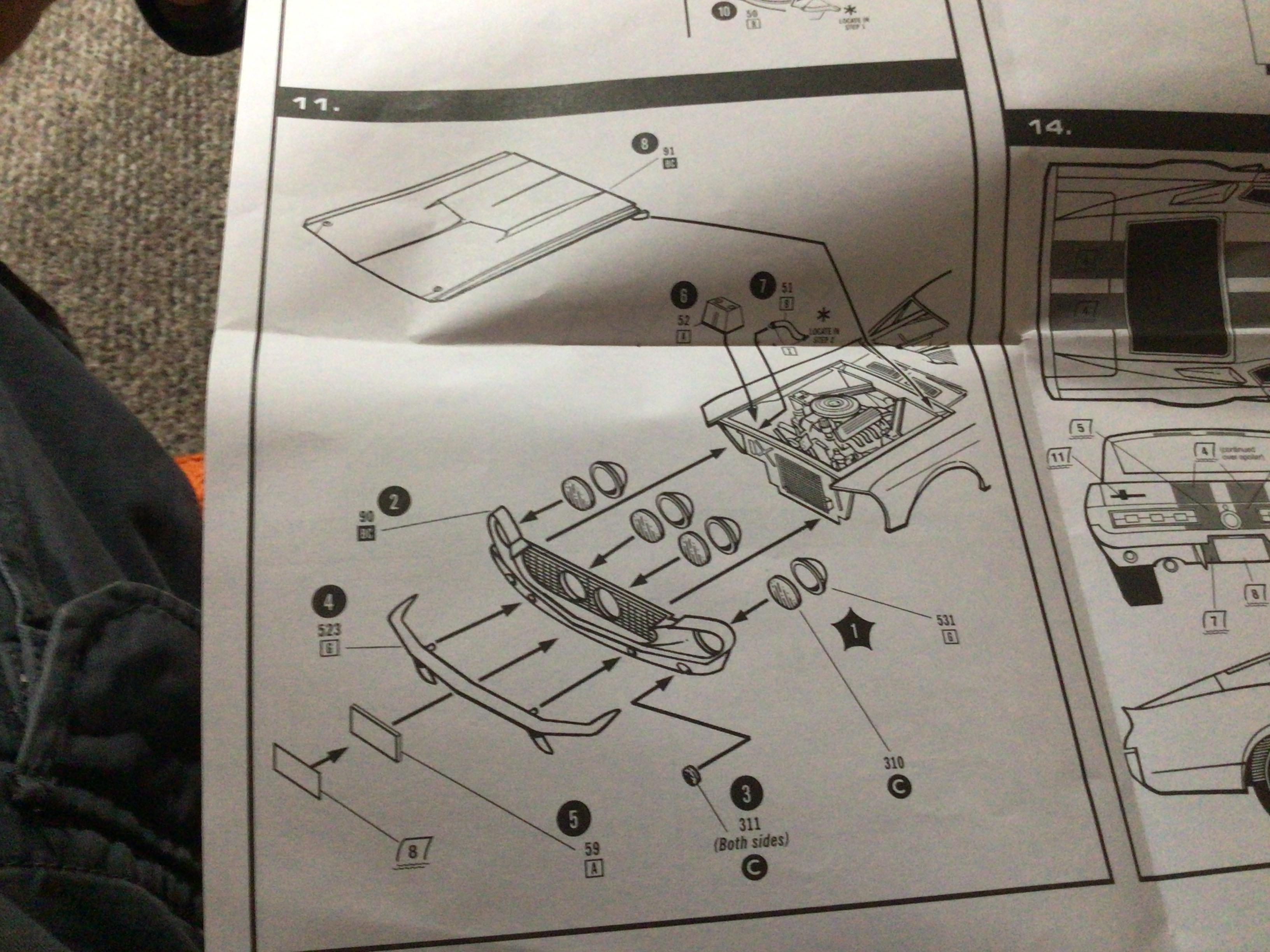

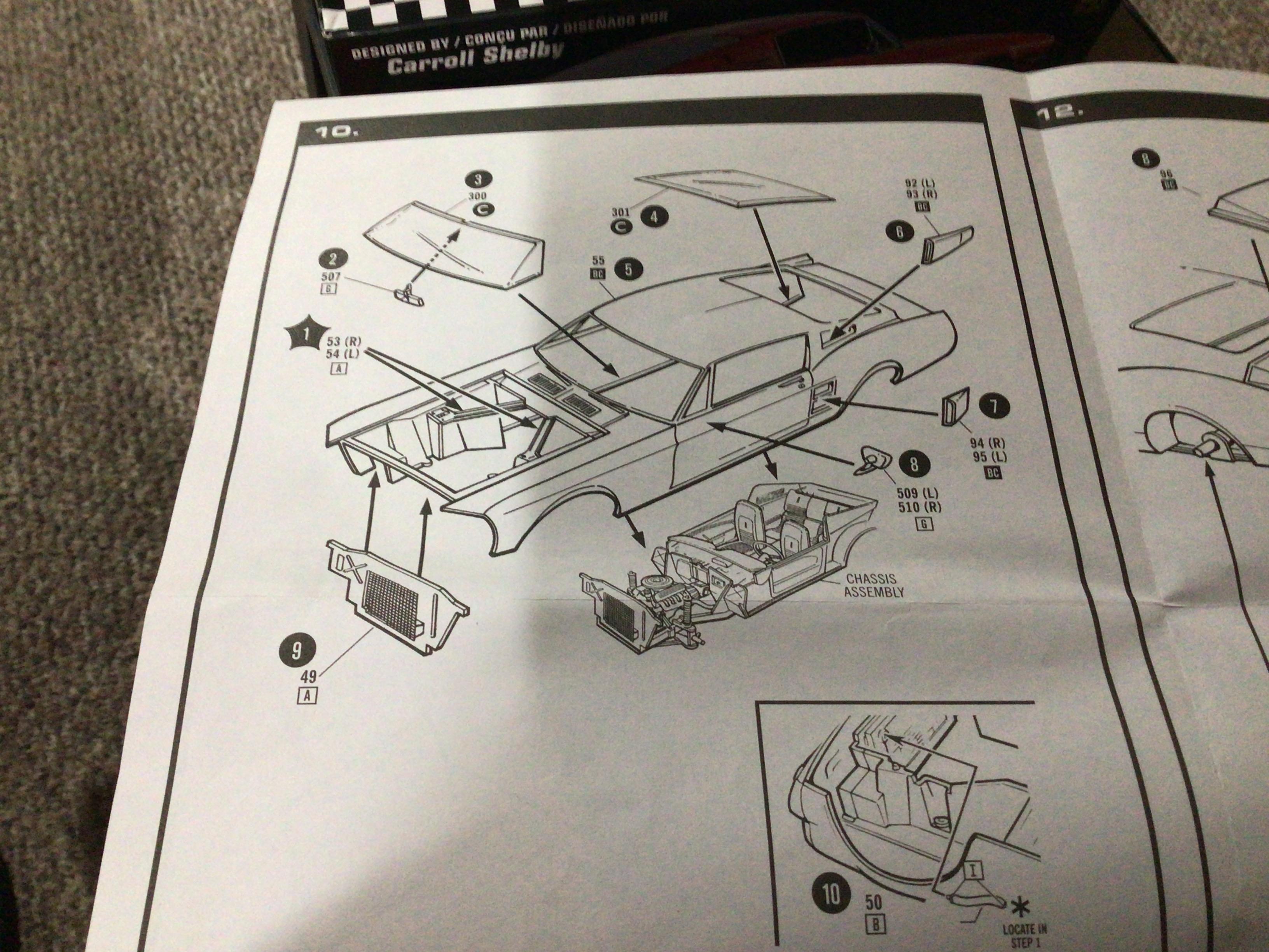

I haven’t built mine yet, but step 10 shows the rad cradle getting fastened to the body, then the body to the chassis. Steps 11 & 12 show the bumpers going on pretty much last.D30BFF34-C114-4D99-9C1C-9EE4E575A9C0.thumb.jpeg.0a6bcc9203c3a733161d9760583c4ca9.jpeg

Well, I'm thinking I agree with the instructions......the radiator is affixed to the body shell first.
I'd love to put the bumpers on first and "blend in" , but I'm concerned I'll have a serious hassle getting the body onto the chassis.
I nice YouTube video shows one with the bumpers applied to the body first and then painted as a whole.  But did the modeler have a problem getting it on the chassis?
I know its a different world out there (compared to my car model building of the 60s-70s), but I do miss the WRITTEN step by step instructions.  I think they are history, now that most (all???) kits are built elsewhere.

You definitely want to glue parts 90, 96 and 97 to the body before paint. The chassis will still fit. But, it will be a little tricky. Insert the rear of the chassis first and the front will slide right in.

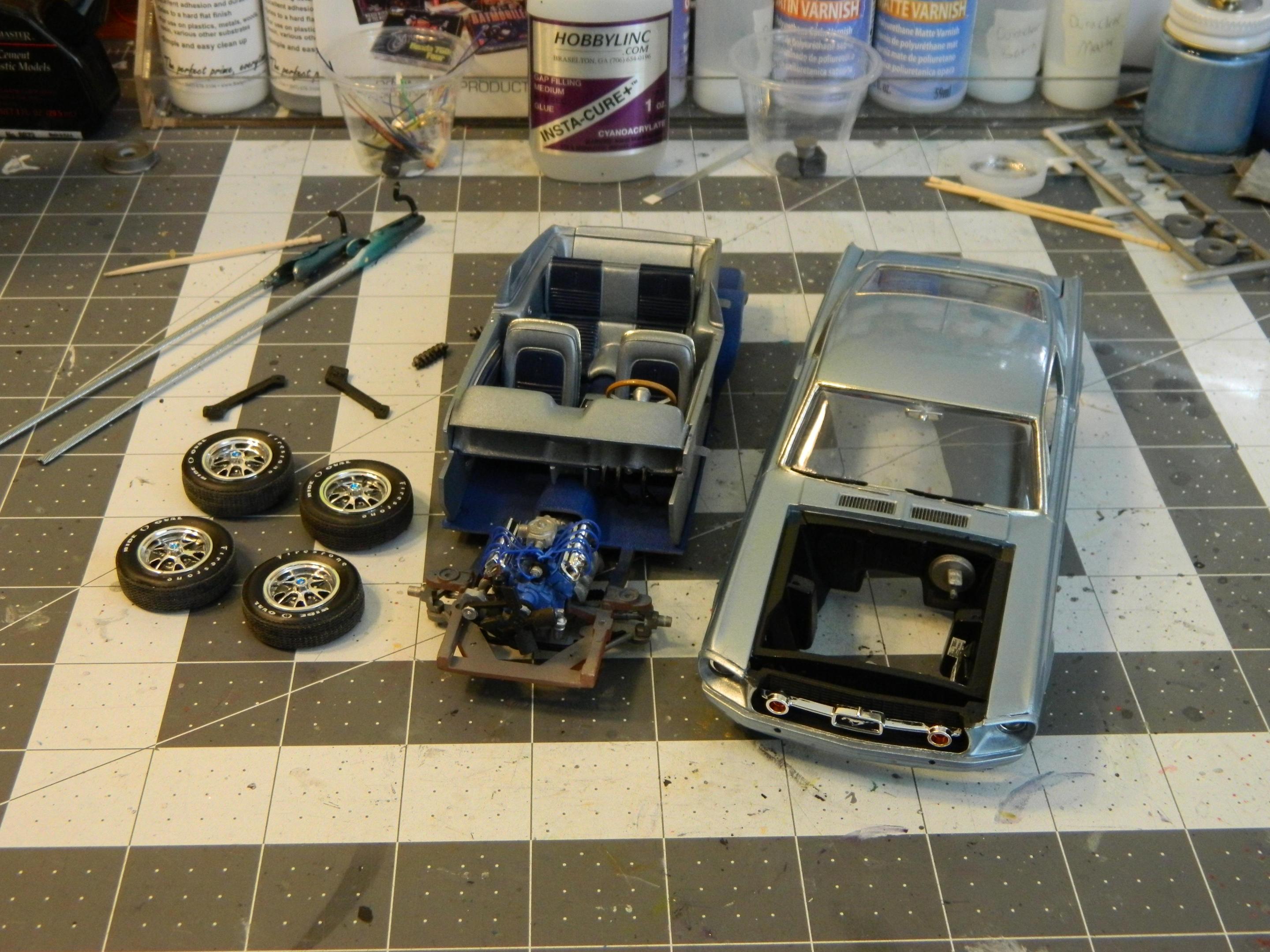

This is an early photo of a '67 coupe conversion I did with the chassis under it. Same basic body as your GT-350. Just different fascia and tail panel. Installing those pieces first works much better when it comes time to paint. Trying to glue them on after paint is a recipe for disaster. Especially if they happen to not fit quite right.

Yes, I've come to that conclusion...........  It's proven that the chassis Can be inserted into a bumpered body, and as you all indicated, painted with the bumper assemblies attached will make for a much nicer end result.
I'm thinking I can get the bumpers attached and smoothed out today, and I already have the spoiler piece in place.  So it should be ready to paint tomorrow or Monday.

I built this kit a few weeks ago. I glued the radiator to the frame, not the body. In the instruction diagram it shows it being mounted to the body, but just below that it is already attached to the frame. I also glued the front and rear body clips or bumpers to the body and painted all as one piece.
