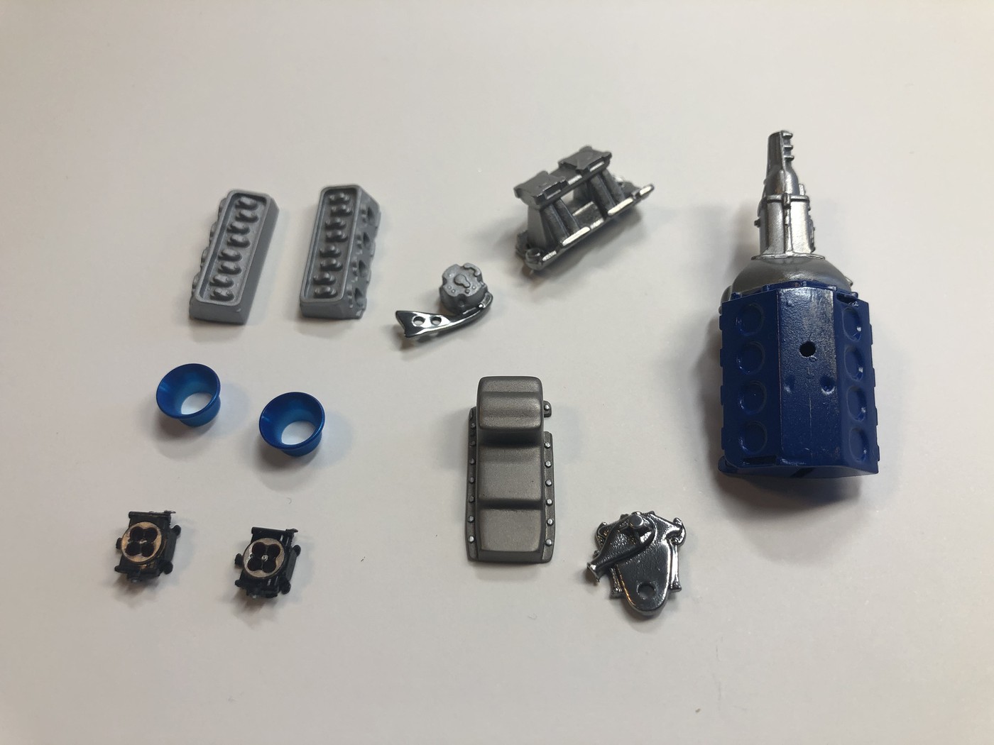

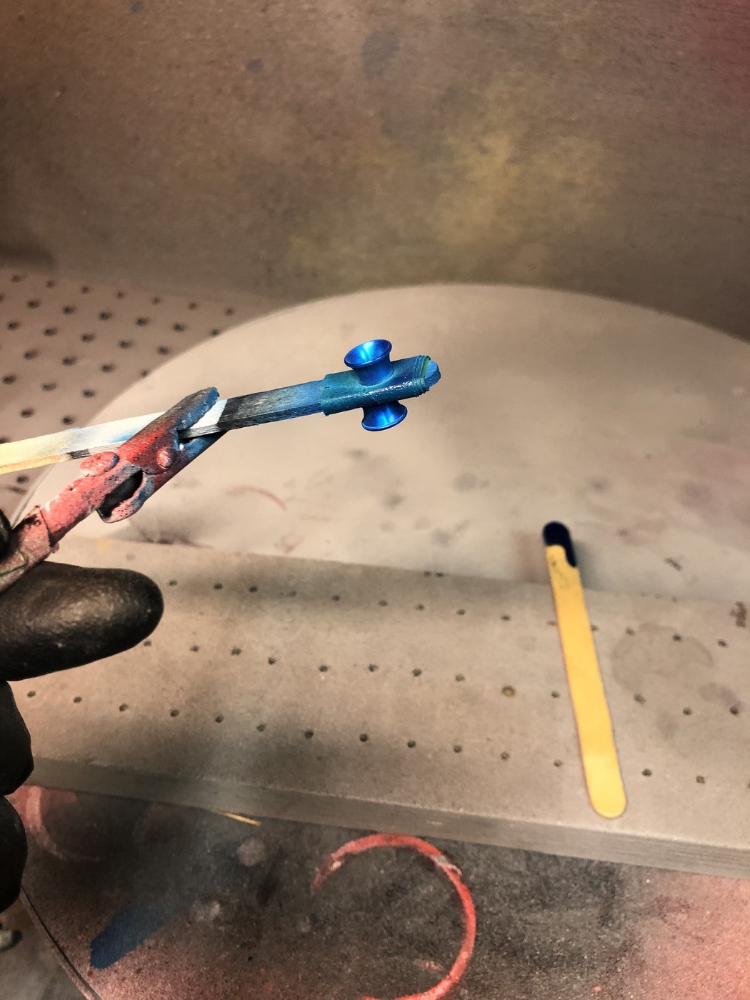

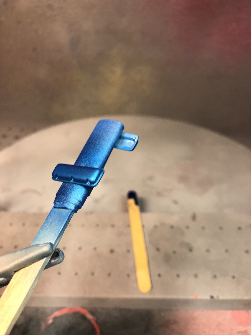

Art Laski Posted October 8, 2022 Author Share Posted October 8, 2022 I went for an anodized aluminum look for the valve covers, so I shot them with Alclad Airframe Aluminum, then Tamiya clear blue acrylic thinned with lacquer thinner. I also applied the clear blue to the injector stacks, but didn’t need the Alclad because they are already machined aluminum. The stacks are Detail Master DM-3295 HOLLY VELOCITY STACKS, from Scale Pro Shop. Here are the engine parts painted up. The alternator and bracket is one piece, so an Alclad shade of aluminum chrome was applied to the alternator, then masked off, and Alclad chrome shot on the bracket. The "carbs" are actually Fireball Model Works FI Tech fuel injectors. 2 Quote Link to comment Share on other sites More sharing options...

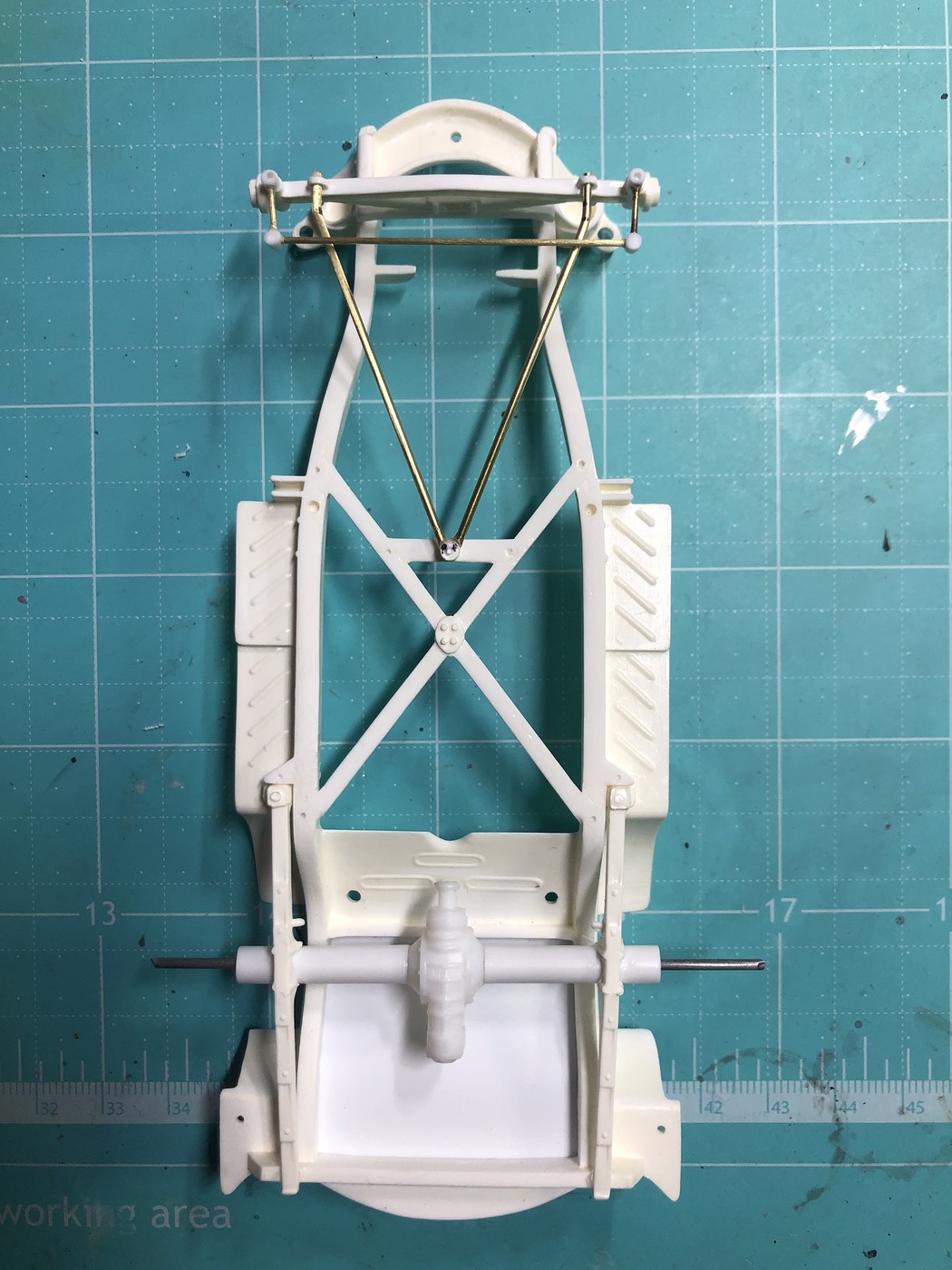

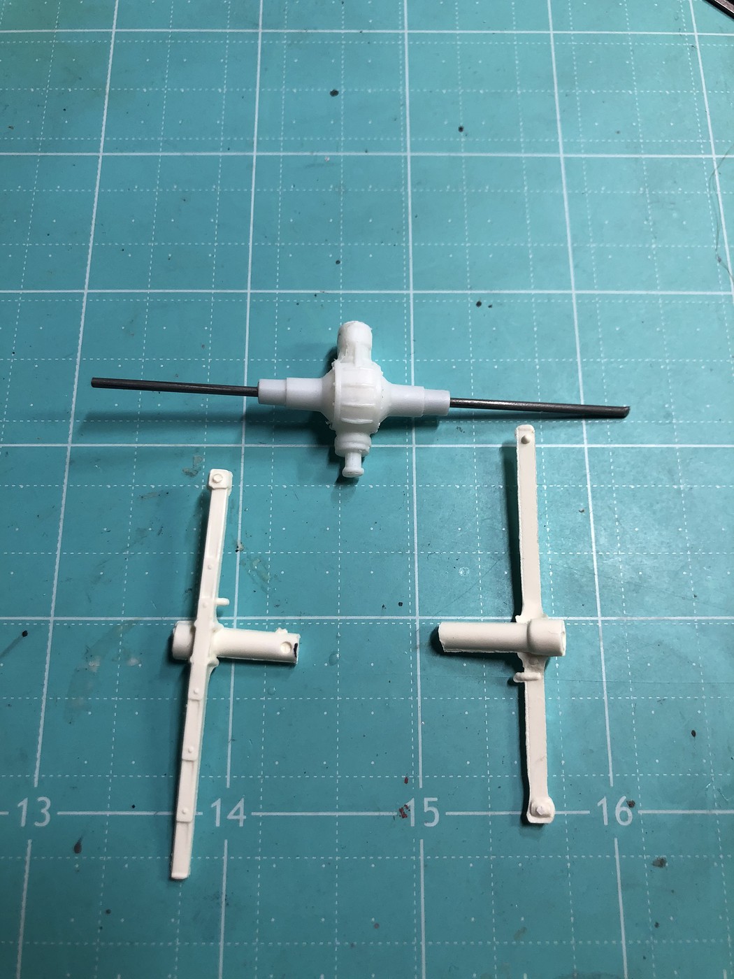

Art Laski Posted February 16 Author Share Posted February 16 (edited) Thanks for all the comments, guys! This model has been completed for a while, so I am going to just speed this up! Here are some shots of the rear end painted up. The side covers and the axle are Alcald chrome, but I tried something different for the center section. I used Testors Magnesium Metalizer, which I buffed, but then I polished it with some C1 chrome powder. I've used it before just as chrome, and thought it was a little dark, but I have found that it can give a real metal look to other colors it is rubbed on as well. I was going for a polished magnesium look, and I think it worked. Edited February 16 by Art Laski 1 Quote Link to comment Share on other sites More sharing options...

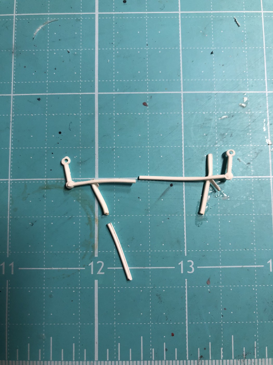

Art Laski Posted February 16 Author Share Posted February 16 (edited) I used the headers from the Chevelle kit, but they needed to be extended to fit. The tips were modified too, but I didn't get any pics in progress. Edited February 16 by Art Laski 2 Quote Link to comment Share on other sites More sharing options...

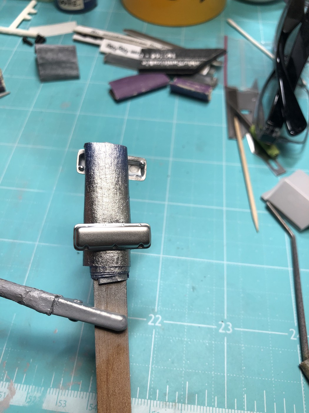

Art Laski Posted February 16 Author Share Posted February 16 I used a lot of aftermarket in the interior, but I also scratchbuilt the steering column- machined hub and aluminum tube. Detail Master Hurst shifter, DM Seat Belt Hardware with medical tape belts below. I also used Model Car Garage flocking on this one. 1 Quote Link to comment Share on other sites More sharing options...

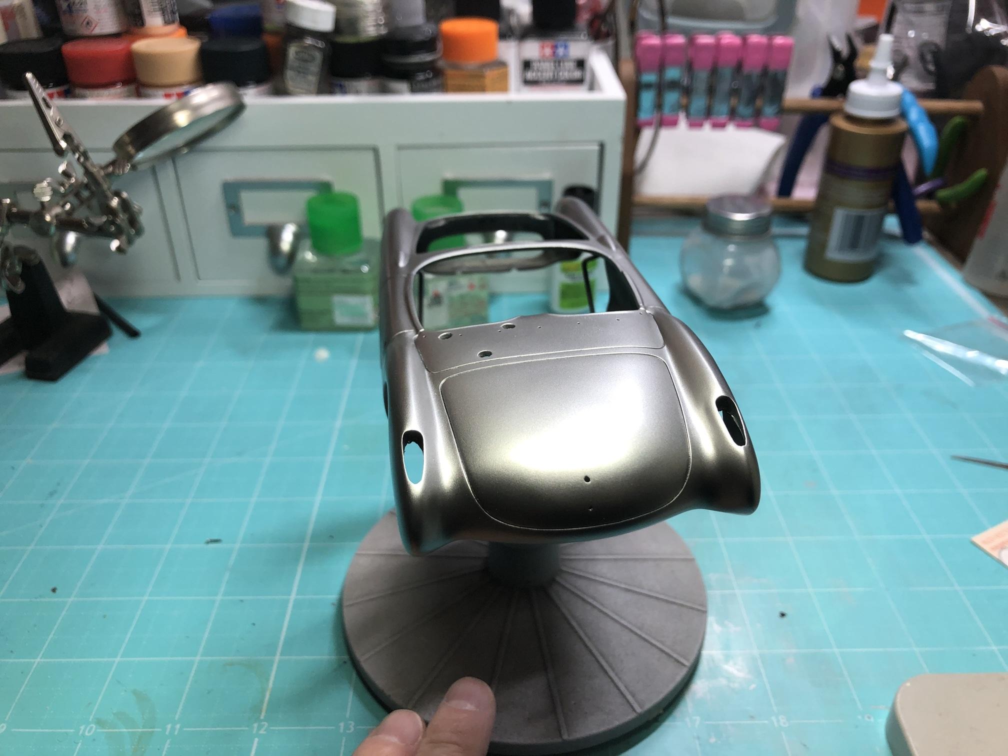

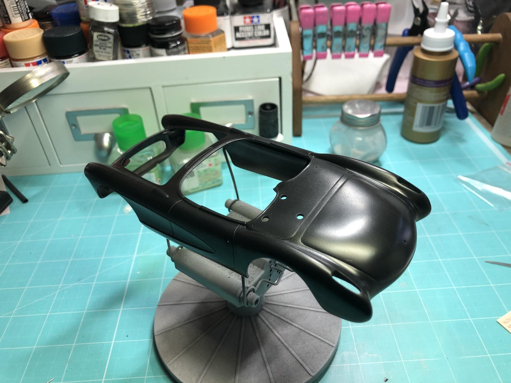

Art Laski Posted February 16 Author Share Posted February 16 The body is painted with Splash Paints Kona Blue and Aluminum. I laid down the black primer, as recommended by Splash, then the Aluminum, and then the blue over it. I was real pleased with the paint. It lays down so smooth! Covered it with 2K Clear. I had some issues with prep on the hood after paint, so I decided to cover it in Scale Motorsport Carbon Fiber instead of repainting it, and added some Detail Master hood pins. 1 Quote Link to comment Share on other sites More sharing options...

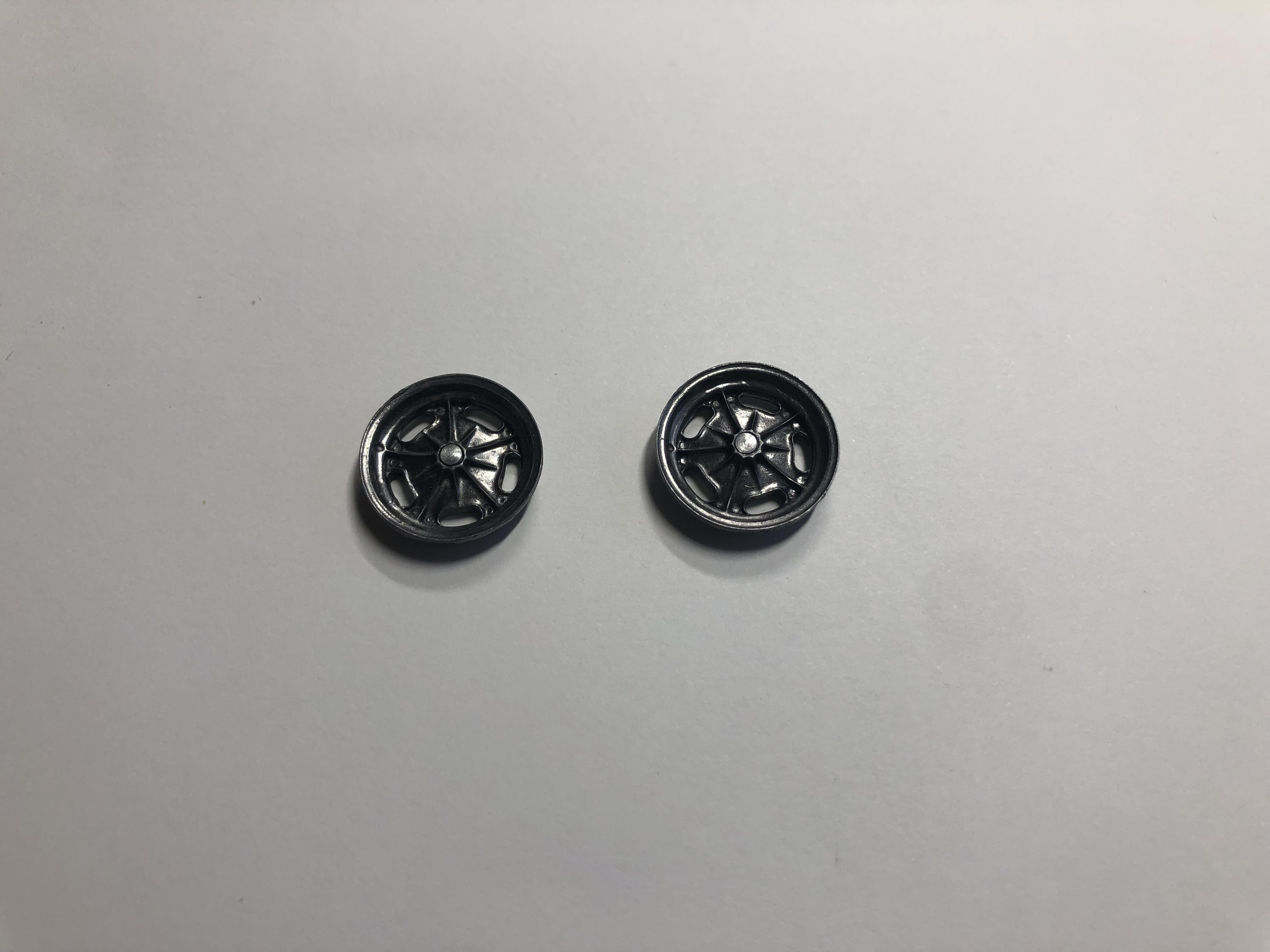

Art Laski Posted February 16 Author Share Posted February 16 I ended up using the kit front tires with some resin Halibrand wheels, painted with Magnesium Metalizer polished with C1 chrome powder like the rear end. I also machined some hubcaps to fill the hole in the center. Rears are one of the tire sets that come in the Chevelle, with the pad printed lettering toned down a bit with a Tamiya weathering kit, with wheels form an MPS funny car. I checked up the rears in the lathe to sand them down and get the right shape to them. 1 Quote Link to comment Share on other sites More sharing options...
