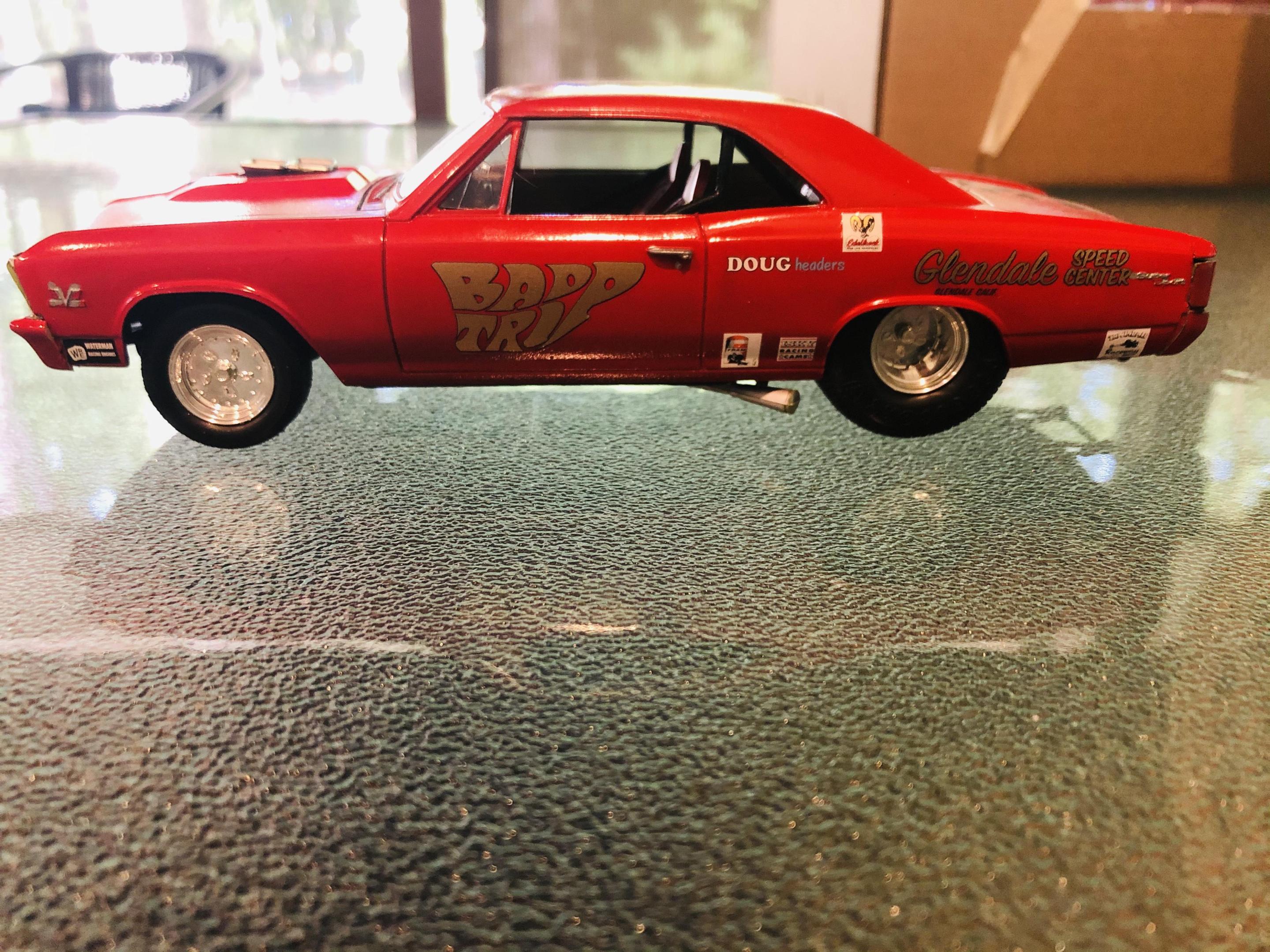

JerseeJerry55 Posted September 3, 2022 Author Share Posted September 3, 2022 2 hours ago, Straightliner59 said: The answers to most of your questions are highly dependent on things like what era and type of race car (ie. what class? street/strip or race car only?). The roll cage or roll bar style will also vary based on the previously mentioned variables. I haven't studied any of the NASCAR cages n quite a while, but, one might work in a mid-'80s-on car, if you cut away the door bars and replace them with a diagonal bar. Whether you're building a replica, or something from your imagination, there can never be enough said for research! Fortunately, that's much easier today than it was in those aforementioned 1980s.😀 There are a lot of folks who are willing to help, but we'll need something a little more specific, to be of much help. This what I want to more or less replicate. My 1967 Chevelle SS. So I guess it would be classified as a match racer. Someone suggested the Revell 1967 Camaro. However can’t find one reasonably priced. Quote Link to comment Share on other sites More sharing options...
