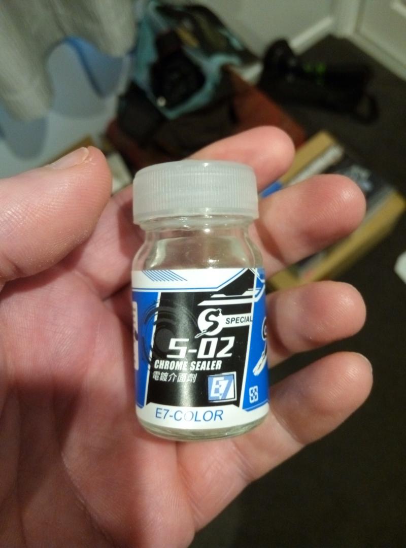

Tamiya enamel clear also works very well surprisingly very similar results to S-02 chrome sealer.

20 hours ago, stitchdup said:
x2 on the s-02 or theres also gauzy shine enhancer

I've used both and they did the job. The gauzy can be overpainted with other paints after it has dried. I haven't tried it with the s-02 but it works on the molotowe. With both of these the molotowe needs to sit for week before overcoating as it will marr the chrome

Gidday, I wouldn't comment if I hadn't used it(on molotow). I believe I even posted results about the S-02 over molotow a couple of years ago on this forum (the picture posted above is my hand even!) The tamiya enamel is equally as good(maybe even slightly better), but may be hard for you to find as you are from the USA....
Another alternative I heard works is testors enamel clear. I guess it is very similar to tamiya enamel so might have a very similar result. - Not tried by me however, but just a thought as you probably have some or can get some easily.
