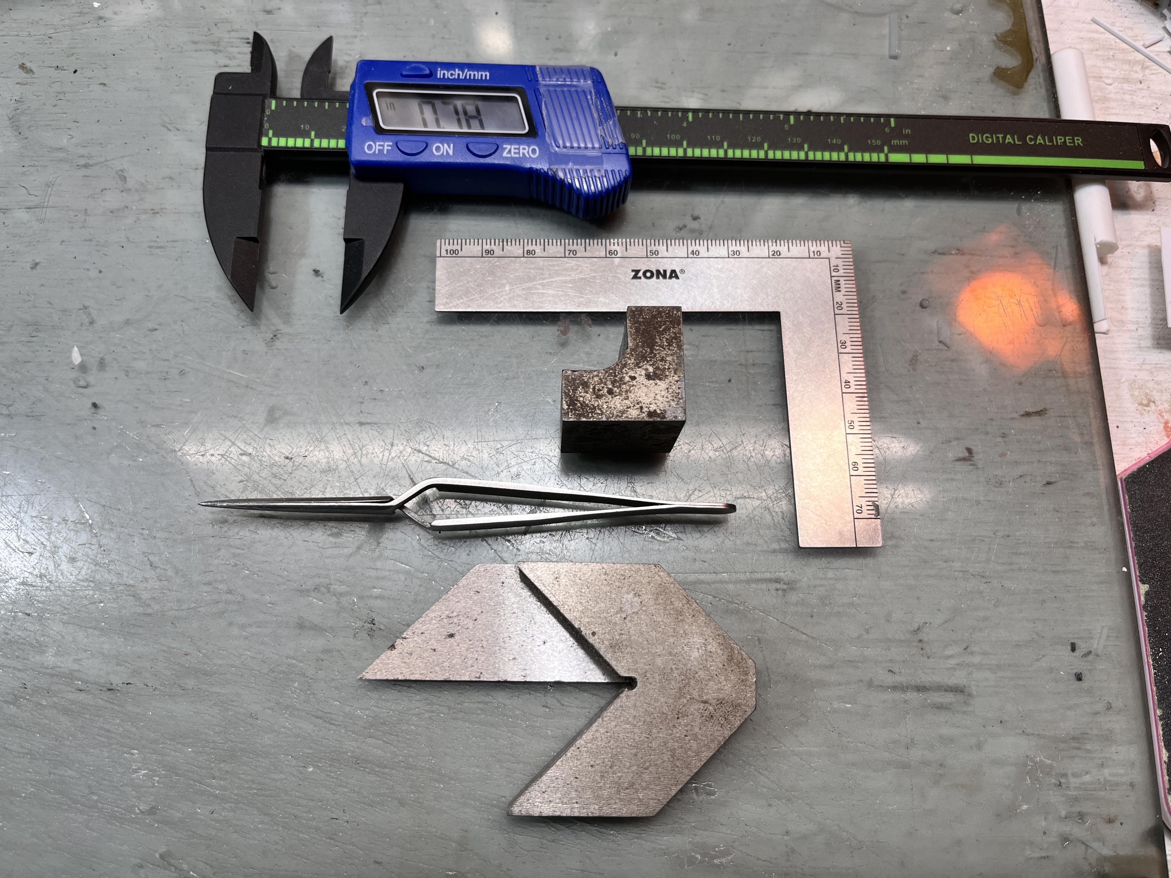

Rocking Rodney Rat Posted October 6, 2022 Share Posted October 6, 2022 (edited) Ya gotta have the right tools for the job!!! A digital caliper is a must for accurate measurements. 'L' square and this little 1" square block is invaluable. The 'grabber' that holds parts. This is the tool I probably used the most, besides the trusty X-Acto knife. The bottom device is used to find the center of a circle, great to find the center of a wheel, etc... Then the usual assortment of the normal stuff, a box of 100 count #11 X-Acto blades and handles, files, rulers, saws and whatnot.... -RRR Edited October 6, 2022 by Rocking Rodney Rat 1 Quote Link to comment Share on other sites More sharing options...
