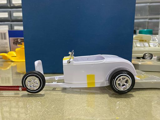

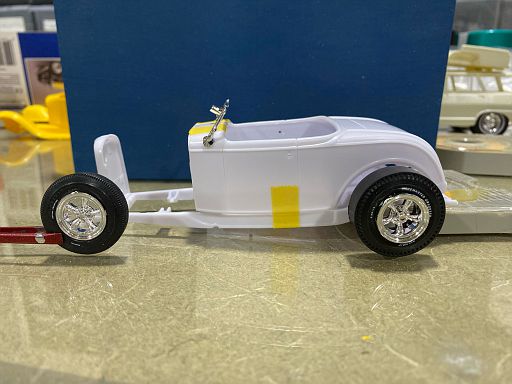

Mr. Metallic Posted October 17, 2022 Author Share Posted October 17, 2022 First thing I needed to address was the rear height. For the initial mockup I simply flipped the axle over so the airbags were hanging down out of the way. Well apparently when I snapped the above pic the flanges for the shocks were still holding the frame artificially up in the air. Once I got into properly modifying the rear everything settled down where it belongs. See new mockup below For those of you wanting to keep things simple you can find a different way to go to backdate the rear suspension, or simply keep the airbags. Totally your call. I decided to steal the transverse buggy style spring from a Revell 30 Ford touring, and pinned it to the axle. Then I created a faux crossmember around the spring by adding a piece of .080 x .080 Evergreen strip between the frame rails. This has an added benefit of covering up the mounting holes for the kit airbags and shocks. Here's a quick summary of the minor mods I made to some of the front wheel components. To get the drum style brake to fit in the wheel without widening the track I had to remove the wheel boss from the wheel back. I also sanded off the outer edge to fit the narrower AMT tire. To get the cycle fender to fit the tire I had to remove the molded on brake disk, while retaining a portion of it to act as the bracket. I then thinned down the front side to help the bracket snug up tight against the tire. Lastly I sanded off the raised portion on the back of the Revell A sourced brake backing plate to allow it to set in the wheel assembly. If you do this take care not to sand too far because you could sand through (note how thin the plastic is in the finished piece) And now, the final stance with everything in it's true position with no supports underneath. Right where I want it. I also dug out the sweet chopped convertible top mastered by Dennis Lacy and offered by Drag City Casting. I did get some of the mods made to the engine (which will be shared later). It's sitting crooked because there is no trans crossmember yet. 3 Quote Link to comment Share on other sites More sharing options...

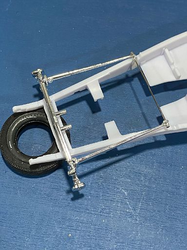

Mr. Metallic Posted October 21, 2022 Author Share Posted October 21, 2022 Suspension update Since I'm using the I beam axle from the Revell A kits, I may as well use the suspension arms from that kit. The nice part is that to accommodate both highboy and channeled versions in that kit, there are 2 sets of front arms included, that leaves a second set of arms to modify for use on the back and so everything matches. To get the front set to fit the 32 frame I sanded down both sides of the mounting bracket. Then I drill a hole through where the 1:1 bolt would attach the arm to that bracket. Once that is done and I test the pin fitment I remove the pin and then, using a very small saw, sever the mounting bracket from the arm. I have done this mod several times now, and find that a photoetch blade removes the smallest kerf. Those blades come in handy for so many other things, so if you don't have one in your arsenal I would definitely invest in one. Clean up your cuts, glue the pin to the hole in the arm and then after the glue is dry slip your bracket on the pin. Now you're ready to mount the bracket permanently to the frame. Put the arm in position on the axle and then use a clamp to hold it in place. Now swing the arm up into it's proposed final location so you can see where you need to glue the bracket. I usually wait to trim the pins until final assembly, but you can do it anytime now that we have the bracket mounted. The rear is even less involved, but if you want to do the same mods to the brackets you can. I am using the molded in brackets intended for the shocks on the rear axle as my brackets for the arms. As you can see the rear spring is now pinned to a location in the faux crossmember I made earlier. This is a huge aid for repeatable mockups and a secure final assembly. Take the arms and sand off the pin that would have attached to the front axle and sand flush. Then drill a hole and insert a pin in the very center of the arm, and drill a corresponding hole in the center of the bracket on the rear axle. Sand the backside of the mounting flange on the other end of the arm, and then it's ready for mockup. I may add some small bits of plastic to either side of the brackets on the rear axle to make it look more realistic. I need to figure out a shock setup as well. 3 Quote Link to comment Share on other sites More sharing options...

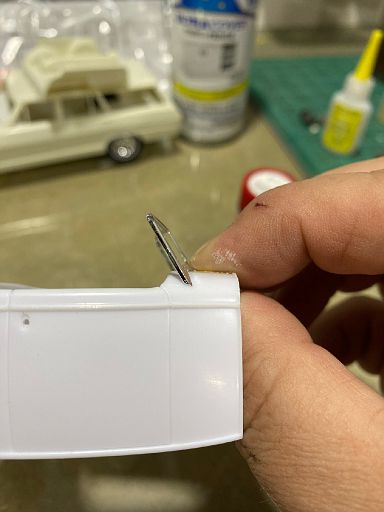

Mr. Metallic Posted November 9, 2022 Author Share Posted November 9, 2022 Progress has been slow. Performing fall cleanup/winter prep has taken precedence. Also, the insurance company finally decided to pay out for all new siding after a hailstorm a couple months ago, so we've taken the opportunity to make some improvements (windows/trim/etc) before they come. Anyway, enough about that. I did grind some small indentations in the sides of the cowl to allow the windshield to sit better. Any further sanding on the underside of the stanchions would have altered their appearance. 10 seconds of gentle grinding yielded just enough clearance. Second up, I started making provisions for removable air cleaners. This is mostly just for fun, but there may also be a clearance issue when I run the hood, so I'm giving this a whirl. I purchased some small neodymium magnets and have made holes to glue them in the top of the carb and underside of the air cleaner. I also modified and installed the headlight/shock supports up front, but no pics. Hoping to finish the little bit of fab and prep this weekend so I can start paint. Too many projects stacked up behind this one to let this simple build linger much longer. Quote Link to comment Share on other sites More sharing options...
CabDriver Posted November 10, 2022 Share Posted November 10, 2022 On 10/21/2022 at 6:30 AM, Mr. Metallic said: The rear is even less involved, but if you want to do the same mods to the brackets you can. I am using the molded in brackets intended for the shocks on the rear axle as my brackets for the arms. As you can see the rear spring is now pinned to a location in the faux crossmember I made earlier. This is a huge aid for repeatable mockups and a secure final assembly. Take the arms and sand off the pin that would have attached to the front axle and sand flush. Then drill a hole and insert a pin in the very center of the arm, and drill a corresponding hole in the center of the bracket on the rear axle. Sand the backside of the mounting flange on the other end of the arm, and then it's ready for mockup. I may add some small bits of plastic to either side of the brackets on the rear axle to make it look more realistic. I need to figure out a shock setup as well. That’s such a neat and tidy solution to setting up that rear end - looks great!!! Love it! 2 Quote Link to comment Share on other sites More sharing options...
