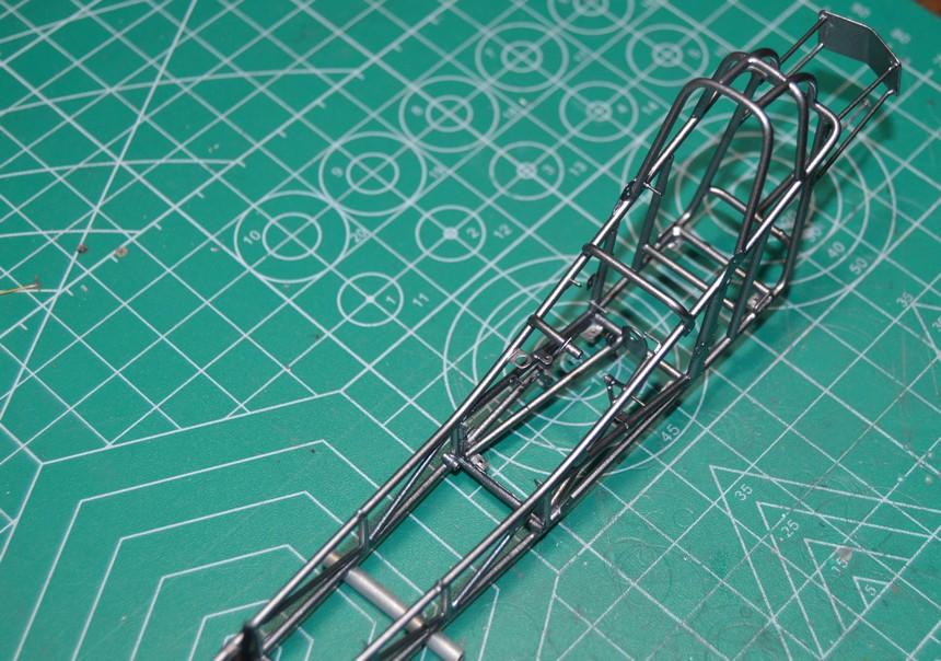

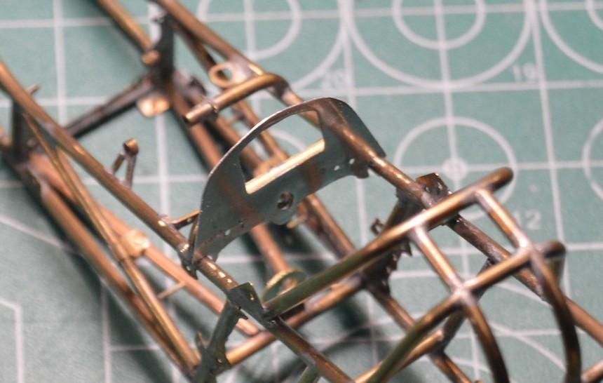

Straightliner59 Posted March 7 Author Share Posted March 7 Okay. I got the final trimming done on the dash panel. I like it! 1 Quote Link to comment Share on other sites More sharing options...
absmiami Posted March 7 Share Posted March 7 Me too … Quote Link to comment Share on other sites More sharing options...
AmericanMuscleFan Posted March 8 Share Posted March 8 I join the group that loves it very much! 😁 Quote Link to comment Share on other sites More sharing options...
John B. Posted March 8 Share Posted March 8 Incredible workmanship, sir! Quote Link to comment Share on other sites More sharing options...
Tortuga Kustomz Posted March 8 Share Posted March 8 That is awesome, love the detail, can't wait to see some color on that Quote Link to comment Share on other sites More sharing options...
Straightliner59 Posted March 8 Author Share Posted March 8 15 hours ago, absmiami said: Me too … Thank you, Mr. Sapiro! 9 hours ago, AmericanMuscleFan said: I join the group that loves it very much! 😁 Thank you, my friend! 8 hours ago, John B. said: Incredible workmanship, sir! Thanks, John. 4 hours ago, Tortuga Kustomz said: That is awesome, love the detail, can't wait to see some color on that Thanks, Marcos. I just have to figure out what colour(s) it's going to be!😂 1 Quote Link to comment Share on other sites More sharing options...

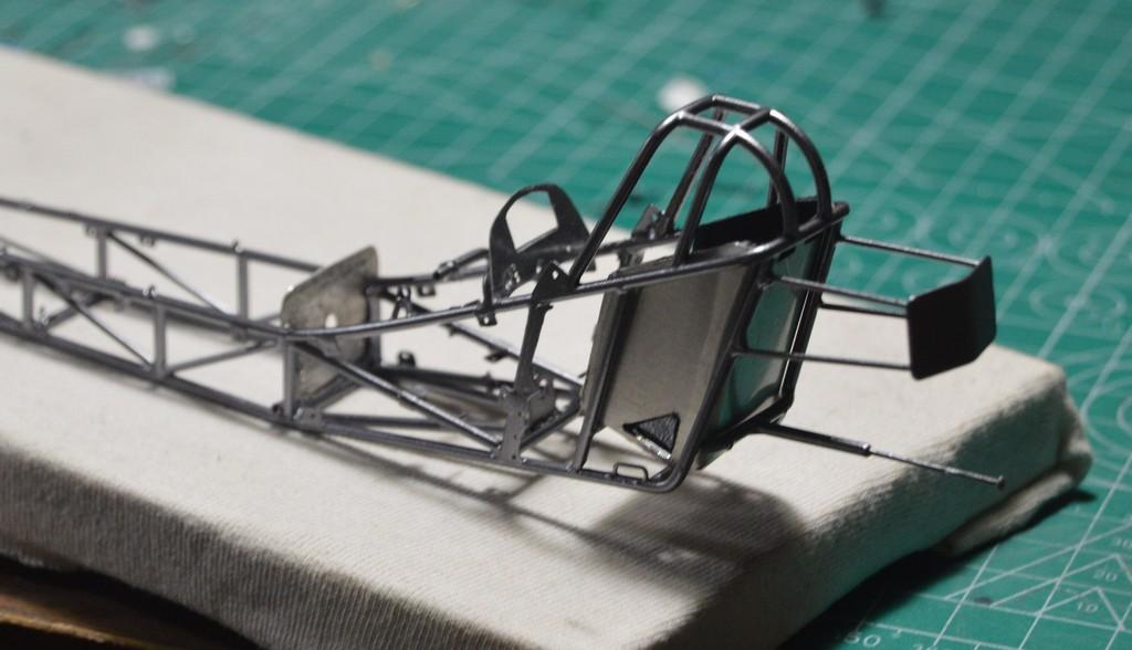

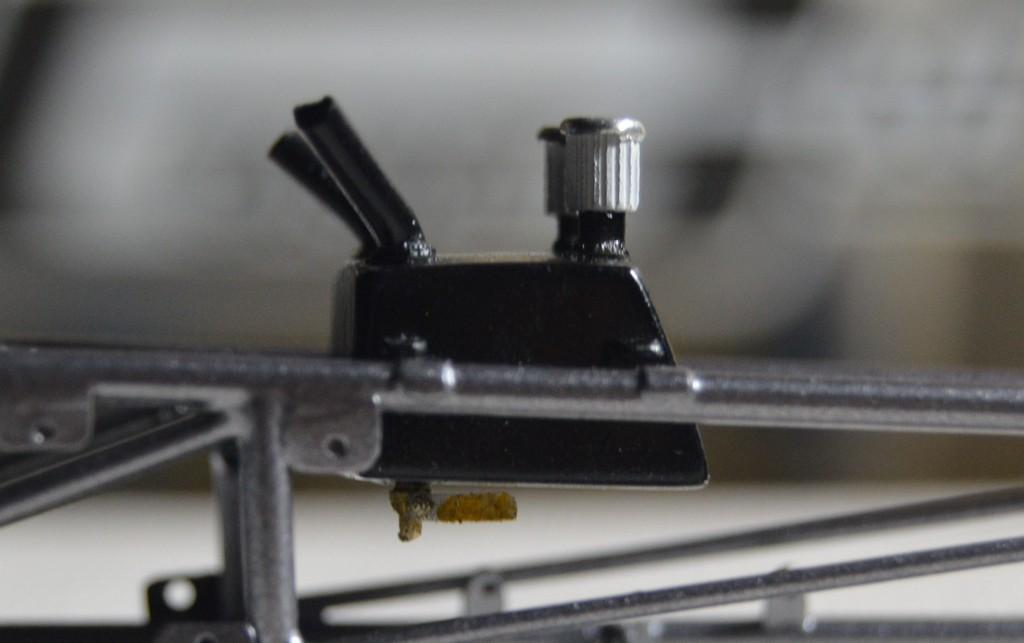

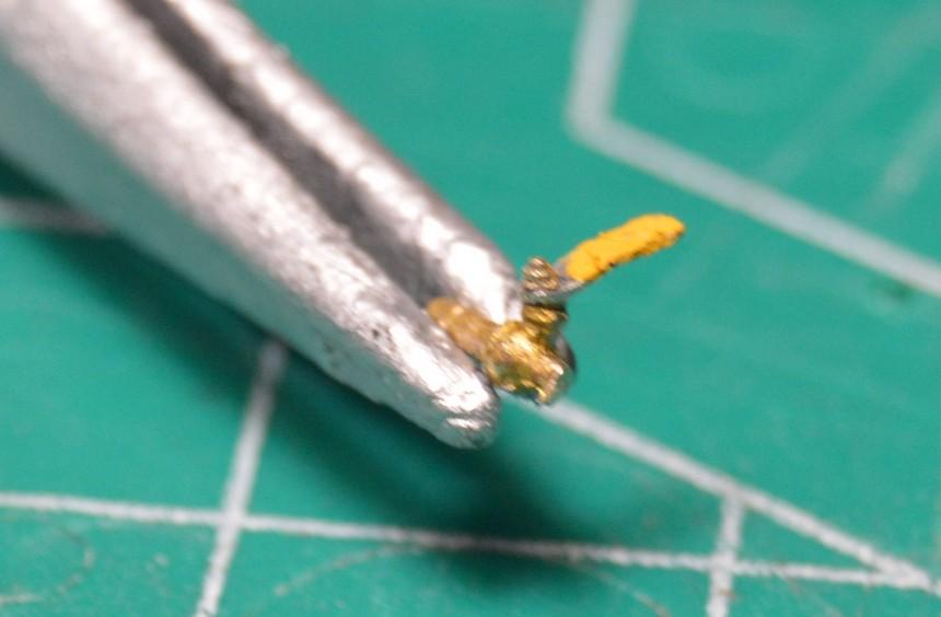

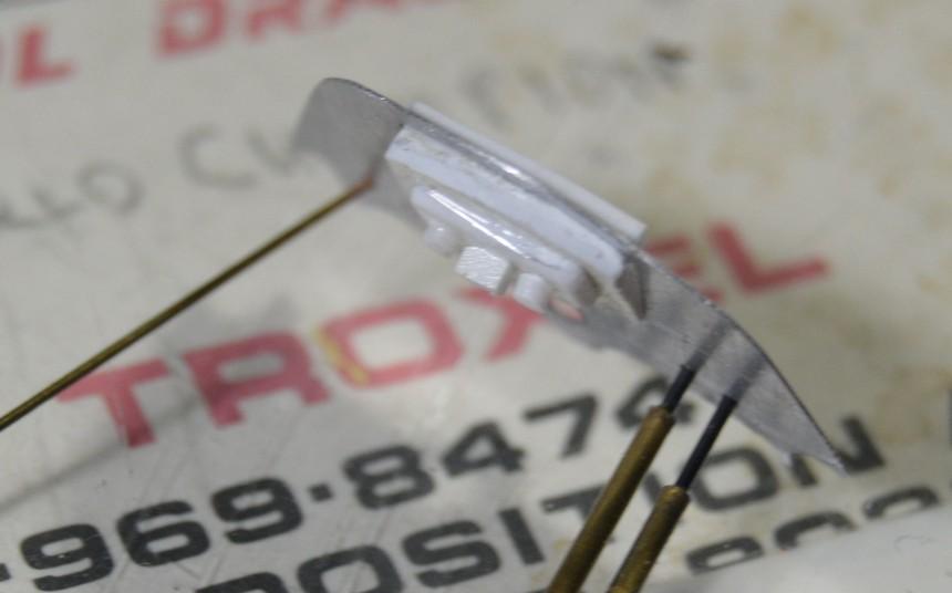

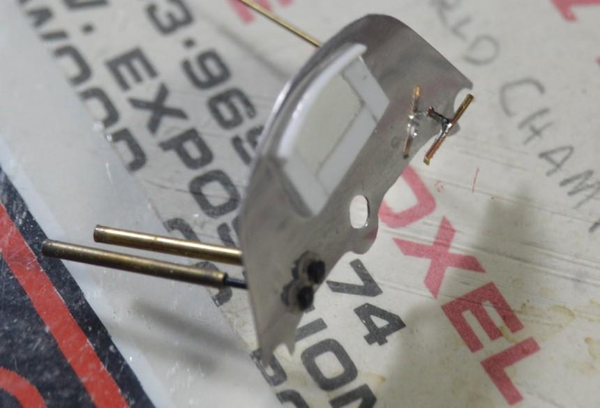

Straightliner59 Posted March 9 Author Share Posted March 9 I have done more work to the dash. I made the 'T'-handle with .010" brass wire, soldered using my Weller iron. The iron works much better in these instances, because all it takes is a touch of the tinned tip, to heat the wire sufficiently to fuse. I plan to do some shaping, to it. I think I will use the black nails for the knobs for the hi-lo and manual hi-speed. Mag kill will go in the hole next to the fuel shutoff. I'm still collecting reference for the data collection/readout wiring. I don't anticipate it being too horribly difficult! I also made a draincock for the puke tank. It will go roughly one-third of the way across the rear-bottom of the tank--offset so that it doesn't dump on the main fuel line. It's a model railroad part, with a handle scratched from aluminum. The chassis is ready for paint. I'm going to paint it this weekend, as the weather's supposed to be beautiful. I would paint it in the booth, but, since I knew the nicer weather was coming, and because I can see and maneuver it better, out in the open, I've decided t wait. I'm also planning on entering a few things in a contest, this weekend. We'll see how that goes! Questions, critiques and comments are always welcomed. Thanks for looking! 2 Quote Link to comment Share on other sites More sharing options...

Straightliner59 Posted March 10 Author Share Posted March 10 4 hours ago, Tortuga Kustomz said: WOW, what i nice work man, that panel is going to be top notch Thank you, my friend! I am going to rework/fix the hi/lo and manual hi-speed knobs, where they go through the dash. The drill slipped, and they aren't square, to each other. I've got a fix figured out. 1 Quote Link to comment Share on other sites More sharing options...

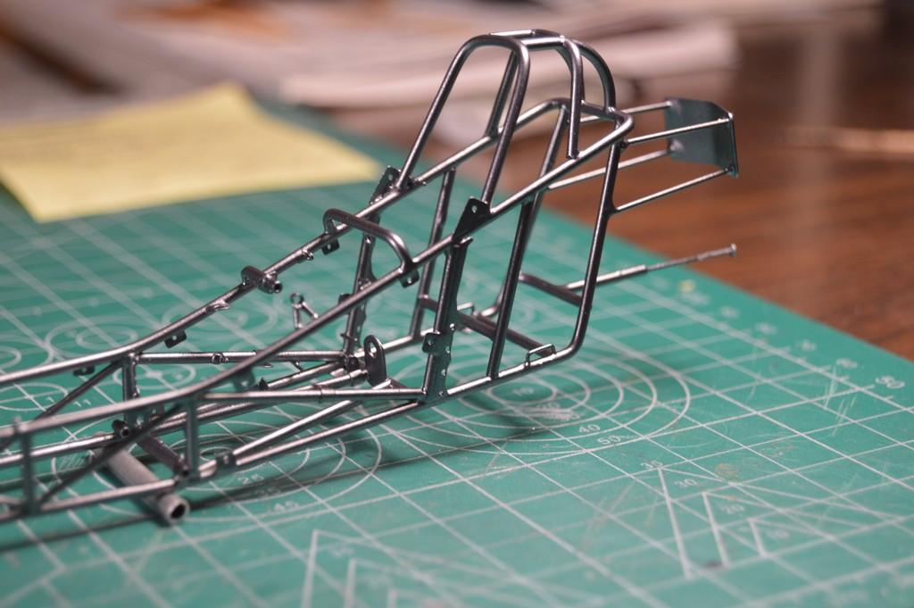

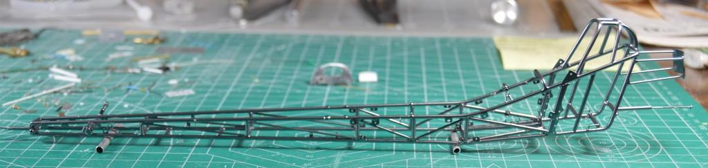

Straightliner59 Posted March 10 Author Share Posted March 10 13 minutes ago, AmericanMuscleFan said: Great job as usual Daniel, the dash and drain valve are both superb! Do you use a special type of "etching primer" like Ian used on the brass frame of his last project? I have never applied paint to brass and was wondering how a conventional primer or paint would adhere to this type of surface. Well, Francis, my friend 😃, thank you for your kind words. Also, your timing in asking is impeccable. Here it is, in its freshly-minted glory! This is Tamiya Light Gun Metal spray over Krylon grey primer. I haven't ever used an etching primer, that I recall. The first time I painted this I used Krylon primer, as well. It lasted 25 years! I didn't have any adherence issues. I think a clean surface is most important. Anyway, I really love the sheen of this paint! Now, I can use the area behind the seat, inside the tail section to determine whether, or not, I want to "discolor" the welds!😁 4 Quote Link to comment Share on other sites More sharing options...
AmericanMuscleFan Posted March 10 Share Posted March 10 6 minutes ago, Straightliner59 said: Also, your timing in asking is impeccable. Good timing to ask and enjoy this fantastic result! Simply gorgeous!!! 👌 In 25 years we will probably put away our tools... 😁 1 Quote Link to comment Share on other sites More sharing options...

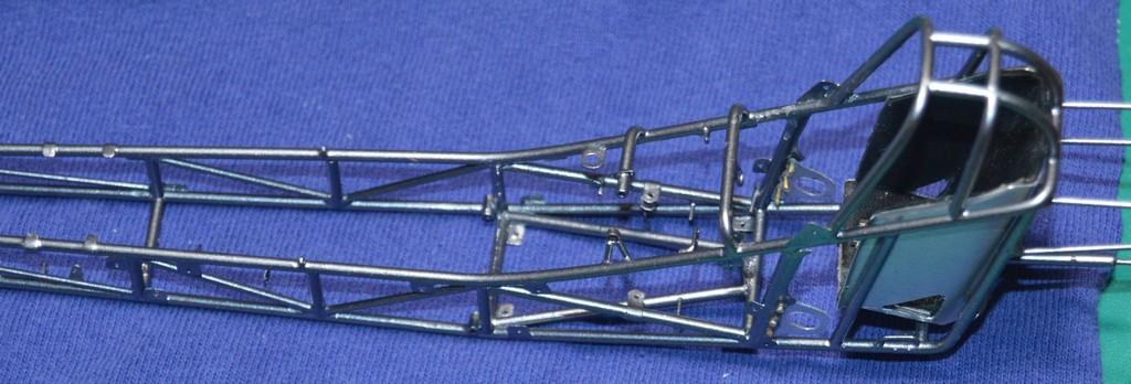

Straightliner59 Posted March 11 Author Share Posted March 11 I knew it wouldn't be long after it was painted that I'd be installing the seat. I should be installing the third member, before long. I guess I'd better figure out what colour(s) this thing's going to be! 3 Quote Link to comment Share on other sites More sharing options...
Tortuga Kustomz Posted March 11 Share Posted March 11 Looks amazing man 1 Quote Link to comment Share on other sites More sharing options...
bytownshaker Posted March 11 Share Posted March 11 Daniel your frame is absolutely beautiful !!! Quote Link to comment Share on other sites More sharing options...
Joe Nunes Posted March 12 Share Posted March 12 When you have a scratch built metal frame that looks this good at this stage you know the rest of the build is going to be outstanding. 👌 Joe Quote Link to comment Share on other sites More sharing options...
Straightliner59 Posted March 12 Author Share Posted March 12 10 hours ago, bytownshaker said: Daniel your frame is absolutely beautiful !!! Thank you, Edgar! I feel like I need to rub some pastels into it, to tone it down a bit, but the color and sheen are fine, as they are. 4 hours ago, Joe Nunes said: When you have a scratch built metal frame that looks this good at this stage you know the rest of the build is going to be outstanding. 👌 Joe Thanks, my friend! I was pleased with how well it was cleaned up, once I could tell how much it was cleaned up.🙂 It's pretty hard to tell, before paint, with the metal's shine. Fortunately, I didn't have to touch it, after the primer. Thanks for your kind comments! 1 Quote Link to comment Share on other sites More sharing options...
Ian McLaren Posted March 12 Share Posted March 12 The chassis looks fantastic Daniel I agree with the color you used. The McLaren themed ND I started months ago has the same color frame in it (just a cleaned up kit chassis) and it suits the design. I'm looking forward to seeing yours come together, it's going to be quite the model when finished! Quote Link to comment Share on other sites More sharing options...
bobthehobbyguy Posted March 12 Share Posted March 12 The frame is stunning. An amazing project. Quote Link to comment Share on other sites More sharing options...
Straightliner59 Posted March 12 Author Share Posted March 12 9 hours ago, Ian McLaren said: The chassis looks fantastic Daniel I agree with the color you used. The McLaren themed ND I started months ago has the same color frame in it (just a cleaned up kit chassis) and it suits the design. I'm looking forward to seeing yours come together, it's going to be quite the model when finished! Thank you, Ian. It really is a nice color for bare metal chassis. I'm not surprised that you used it, as well! It really feels like it's getting somewhere, now. I'm putting the anti-sub belt together, now. Once it's installed, I can install the third member! Quote Link to comment Share on other sites More sharing options...
