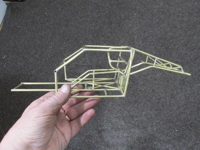

Ian McLaren Posted December 7, 2022 Author Share Posted December 7, 2022 Slow but sure, funny car inner bars installed, unlike a full-size car you can't just get inside the cage to install a bar, therefore the order of fabrication is from the center out. Lesson learned LOL 4 Quote Link to comment Share on other sites More sharing options...
Straightliner59 Posted December 7, 2022 Share Posted December 7, 2022 That's coming along, beautifully! Indeed, the more stuff we add, the more critical the build order! Quote Link to comment Share on other sites More sharing options...

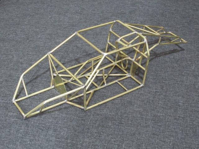

Ian McLaren Posted December 9, 2022 Author Share Posted December 9, 2022 (edited) More bars installed and I had to build the four link front brackets as I could not find any in 1/12th that were being produced. Edited December 9, 2022 by Ian McLaren 3 Quote Link to comment Share on other sites More sharing options...

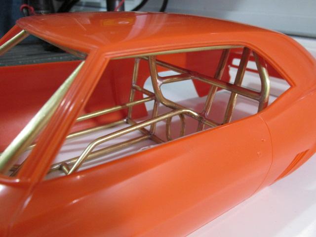

Ian McLaren Posted December 13, 2022 Author Share Posted December 13, 2022 This weekends progress, the body is now pinned in place on the chassis (still removable) rear suspension has been trial fitted, and ride height, stance and driveline alignment has been checked with representation of the 33 inch slicks. Rear motor plate is mounted. 3 Quote Link to comment Share on other sites More sharing options...

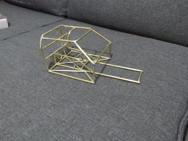

Ian McLaren Posted December 14, 2022 Author Share Posted December 14, 2022 Front upper bars are in, allowing the supports for the front motor plate and upper strut mounts to be added 3 Quote Link to comment Share on other sites More sharing options...

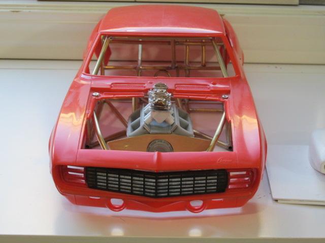

Ian McLaren Posted December 15, 2022 Author Share Posted December 15, 2022 6 minutes ago, Straightliner59 said: You are making excellent progress, Ian. It's looking great! I'm feeling like a slacker!😃 You a slacker? Not a chance, I am amazed by your productivity on all of your projects especially when your quality is never affected. I have been in a bit of a groove lately but that stops tomorrow. I am involved in a new restaurant project that we hope to open Jan 1/23 so tomorrow I'm off to work on the interior trim (stainless and polished aluminum) and the main cashier kiosk. Apparently being an assistant manager involves more than just standing around. LOL So this photo is about as far as it's going to go at least for the next little while. Unless I can steal a little me time here and there. 4 Quote Link to comment Share on other sites More sharing options...

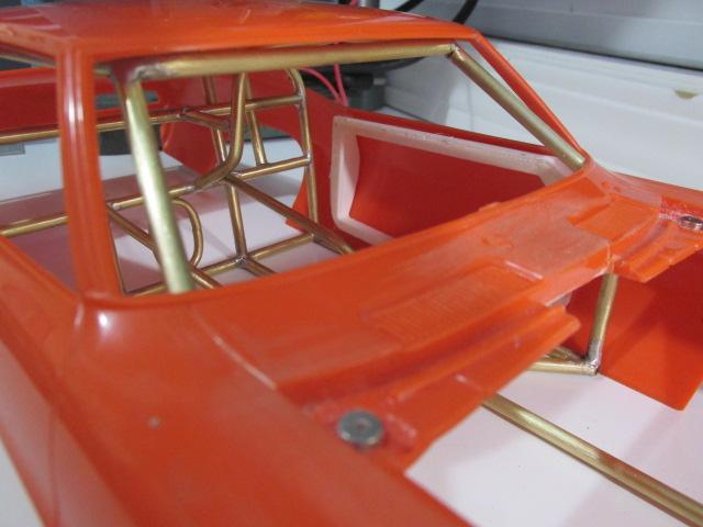

Ian McLaren Posted December 22, 2022 Author Share Posted December 22, 2022 Wishbone fabricated and installed to check clearances, temporary four link bars still in use for set up only, rear end set in place temporarily to check drive line angles (silver tube in center of the car front the crank centerline to the pinion. MVI_0138[2].MOV 3 Quote Link to comment Share on other sites More sharing options...
